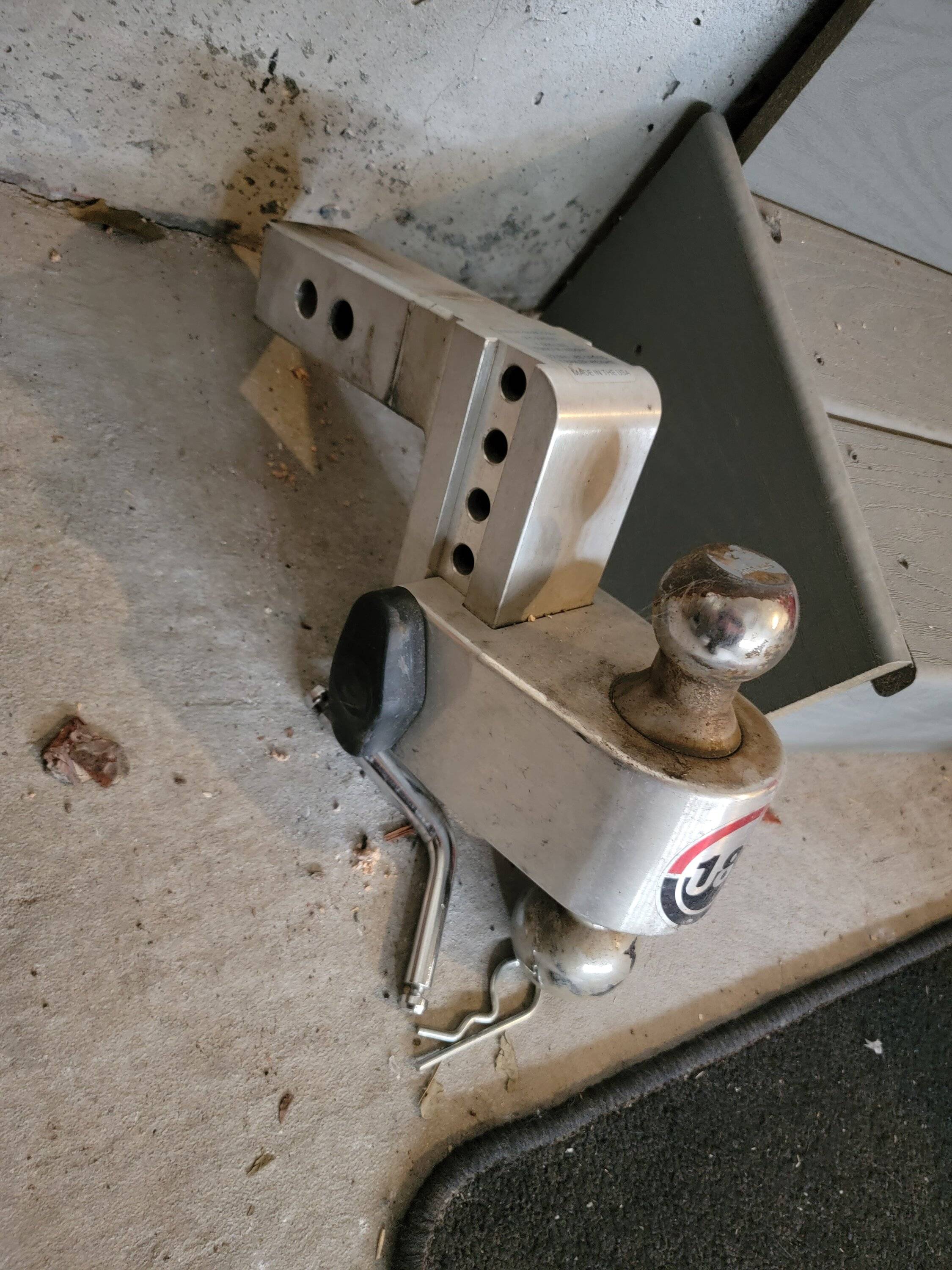

Best hitch on the market. Have had it for quite a while, and it has worked out to be the best for me.
GEN-Y HITCH

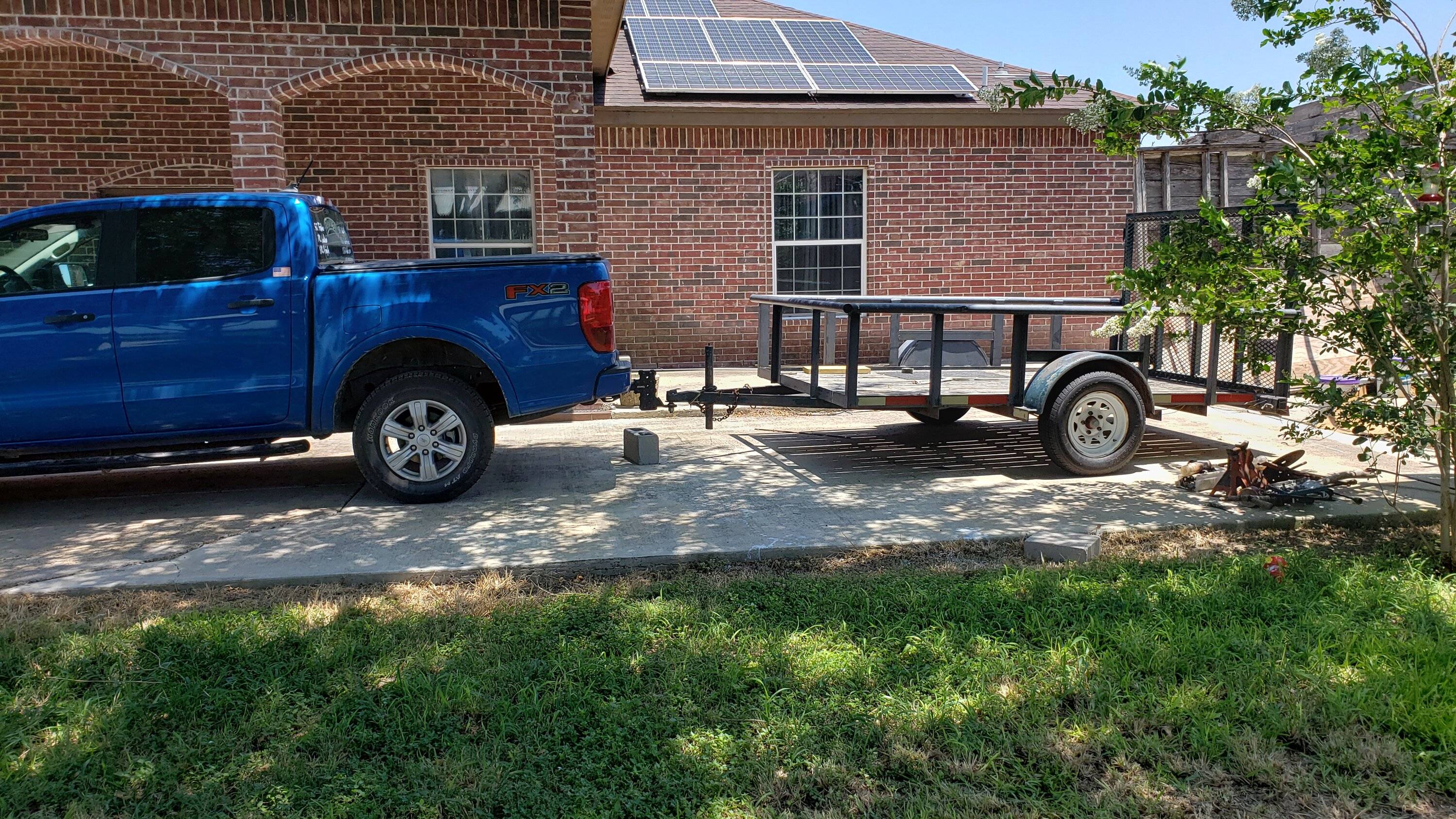

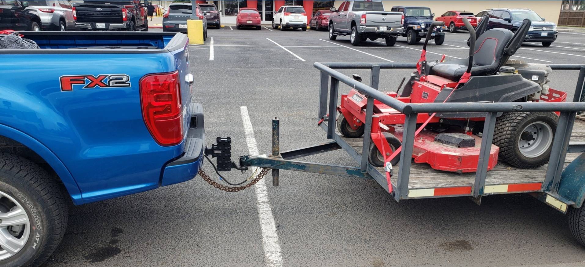

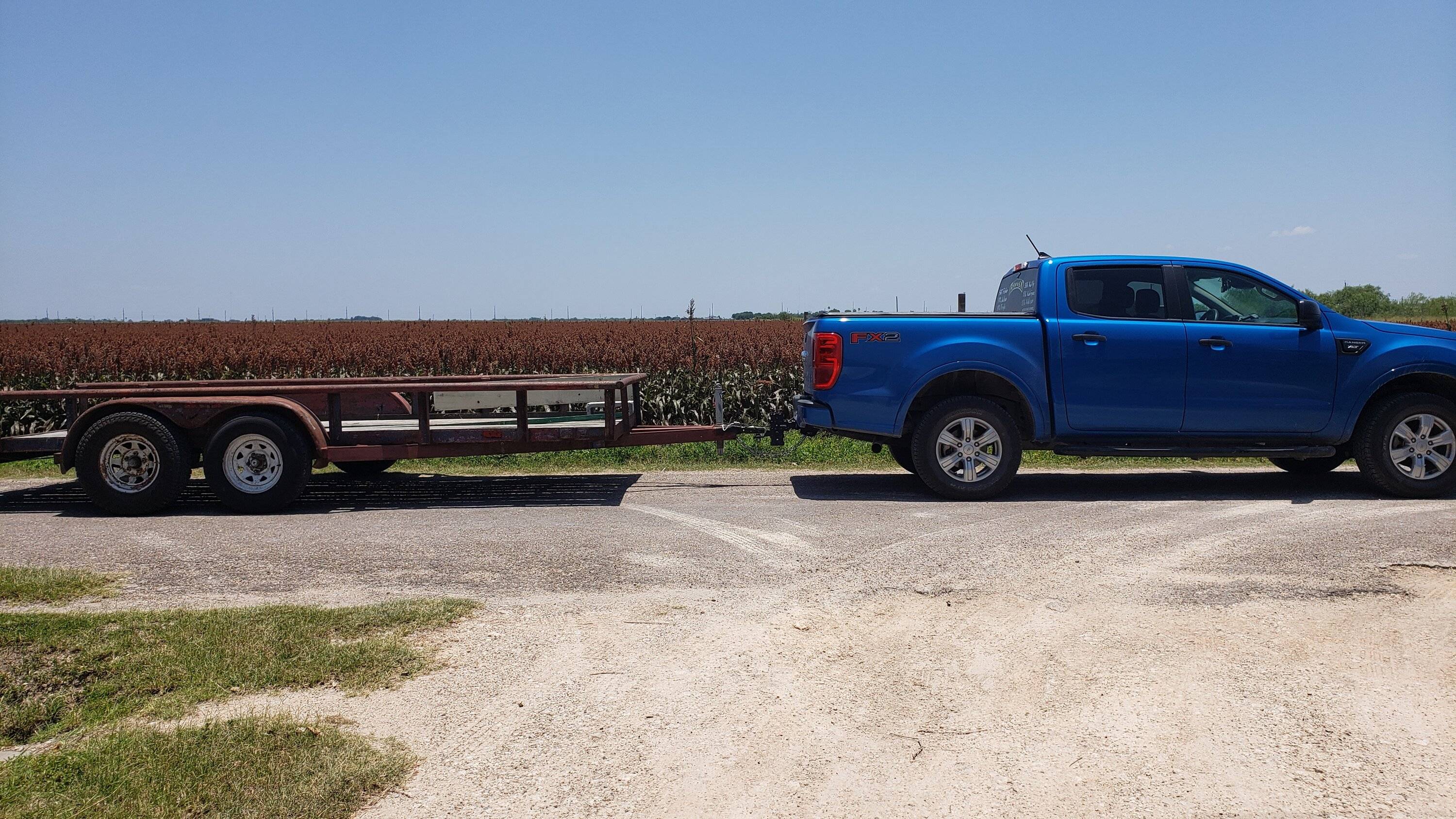

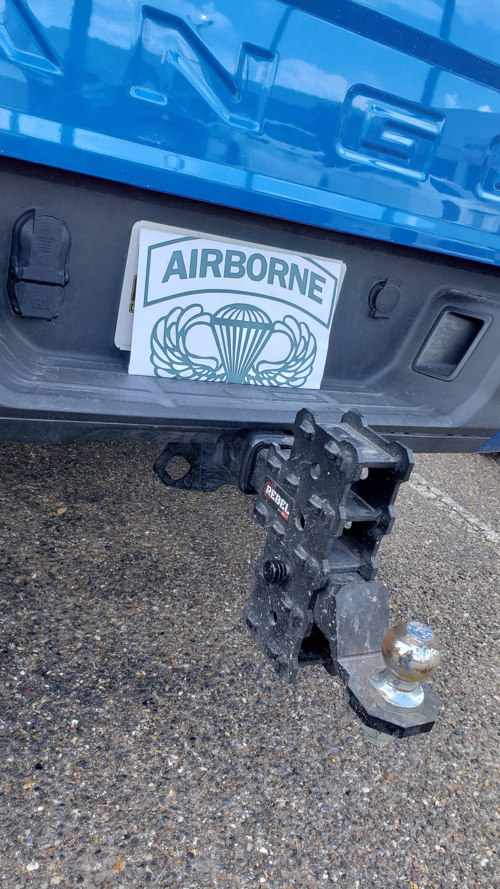

When i pull my uncles trailer, the smallest of the bunch, my
GEN-Y REBEL HITCH
levels it perfectly. Similar trailer as you describe. use the very bottom adjustment point on it. Works like a charm. Have a pic of it on a previous post. I do not keep it on the truck as it destroys your departure angle to negative 20 degrees.
GEN-Y REBEL HITCH

Ill do pics of the hitch with a few different trailers. On Saturday, have class tomorrow.

Here is how i adjust the small lawn trailer. It is just a single axle trailer, not much weight, empty the touk9nge rests in the air! Haha. So i dont know the exact drop in inches, but it is on the lowest part of my
GEN-Y REBEL HITCH.

This video shows the hitch height at about the 1 min 30 seconds mark. That's a 6 inch drop curt dropped to the bottom. I need 3 more inches down to level it so I ordered a 10 inch drop. I won't buy a hitch that doesn't adjust in 1 inch increments so your type isn't something I would buy plus I don't like the look of the big heavy plates on a little truck. I like the clean look of the aero along with the tongue weight feature that will be very useful with all the different stuff I haul. This trailer with the toys will always be below 5000 pounds so I don't need my weight distribution hitch but need proper adjustment for longer tire life and handling.
