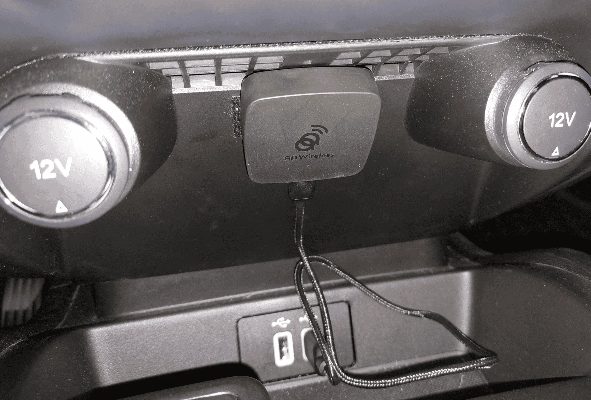

So here is how I have the AAWireless module. A little Velcro tucks it up out of the way nicely. I have a 4inch right angle USB cable on order and will post a link when I confirm it the correct handed angle!
Pardon the dust! ?

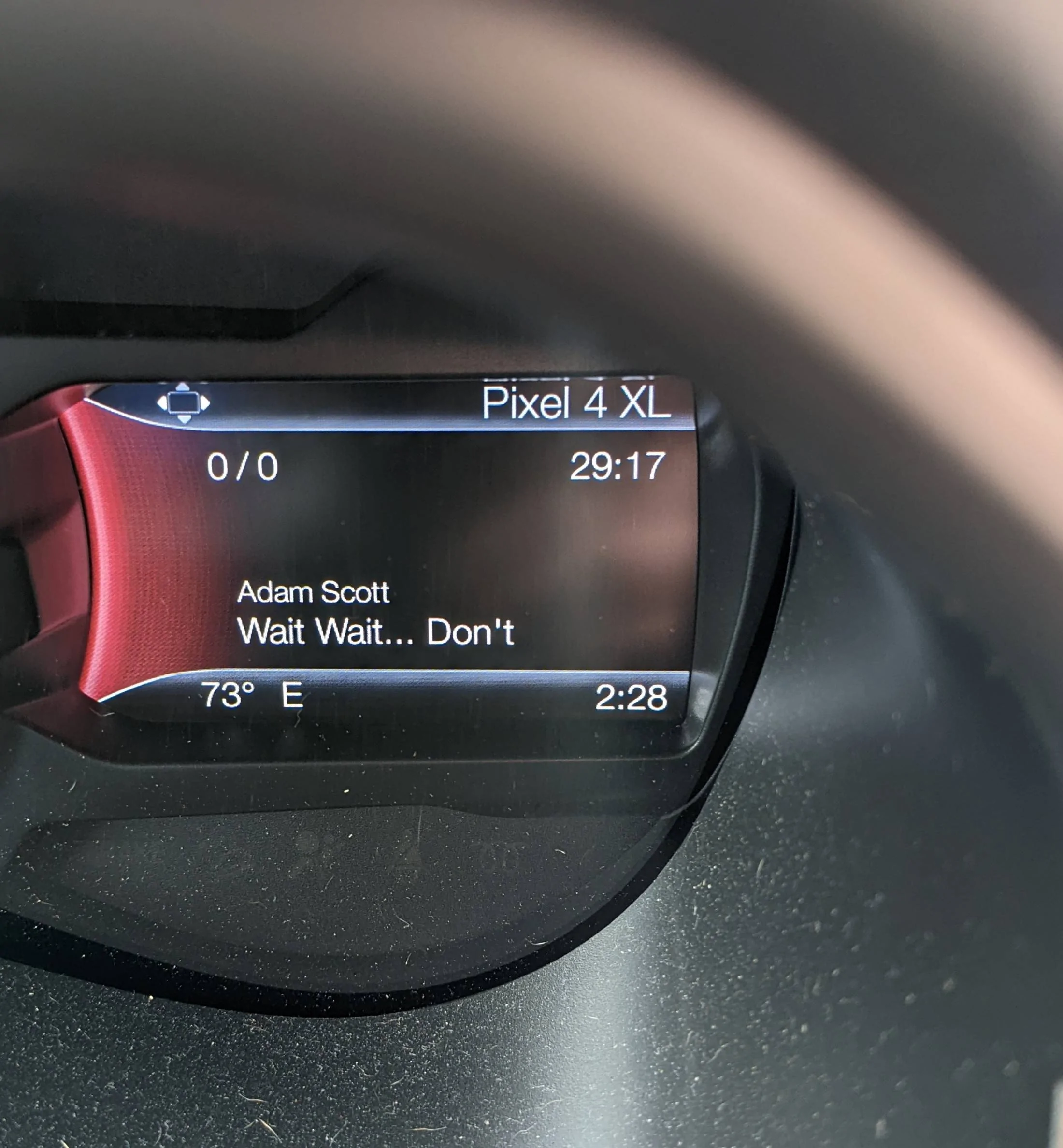

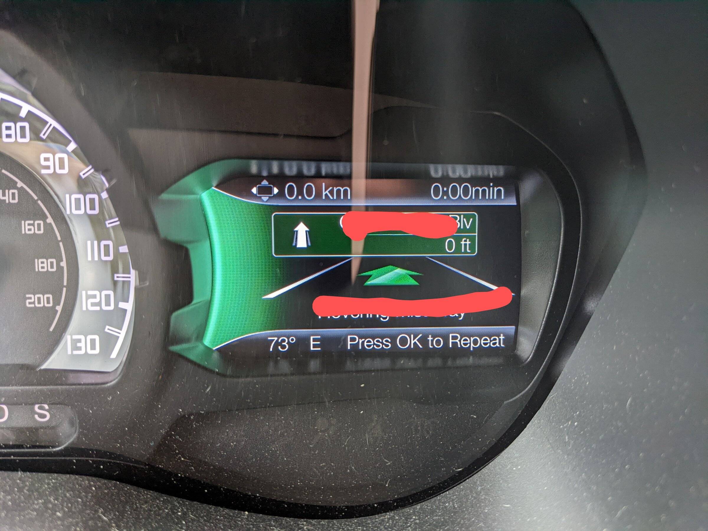

Does aawireless retain the right screen info on the lariat guage cluster? I bought dirks charging mat, have a hardwire USB charger I'm wiring into the fuse box just attempted to use a ottocast with issues. Sound quality had issues at times, was a little buggy, and biggest of all if you have the right screen on audio it says audio detected but doesn't show audio and the turn by turn is gone on the navigation screen just see navigation screen. Drove me nuts, sent it back today.
TechnicallyReal
TechnicallyReal
Ryan
Aug 20, 2020
460
609
Eh?
'19 Ranger Lariat 4x4
Software Engineer / IT Admin
Yes that stuff continues to work exactly as it did when plugged in directly
