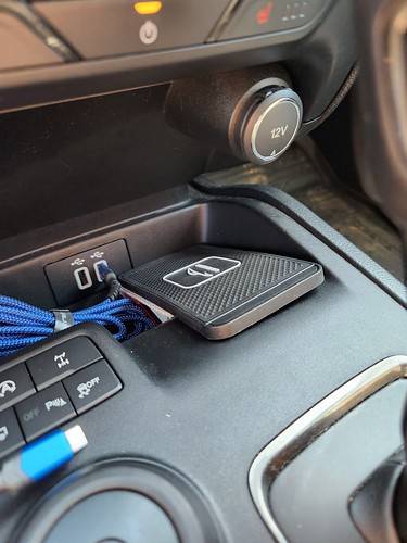

Got mine the other day and set it up today.
Setup was a breeze until I went to update the device to v 2.0.1. That could go better, but it's running again. When using the app to install the update, I get a status message "waiting for restart" and it's not clear if it wants an app restart, a device restart, or a Sync restart. I think it meant a Sync restart. I just needed to wait a bit extra after shutting the truck off for Sync to fully shut down.
Then after it restarted, AA wouldn't fire back up. Went through the app troubleshooting (the blinking green light option) and after restoring the device to defaults, everything worked as expected.
Now that I have a case for my phone that seals off the USB port, it'll be nice not needing to pop open that cover every time I get in the truck and want to use nav.
The device is definitely small. It even fits underneath my hacked together coroplast platform for the wireless charging base.
Before the AA Wireless addition
