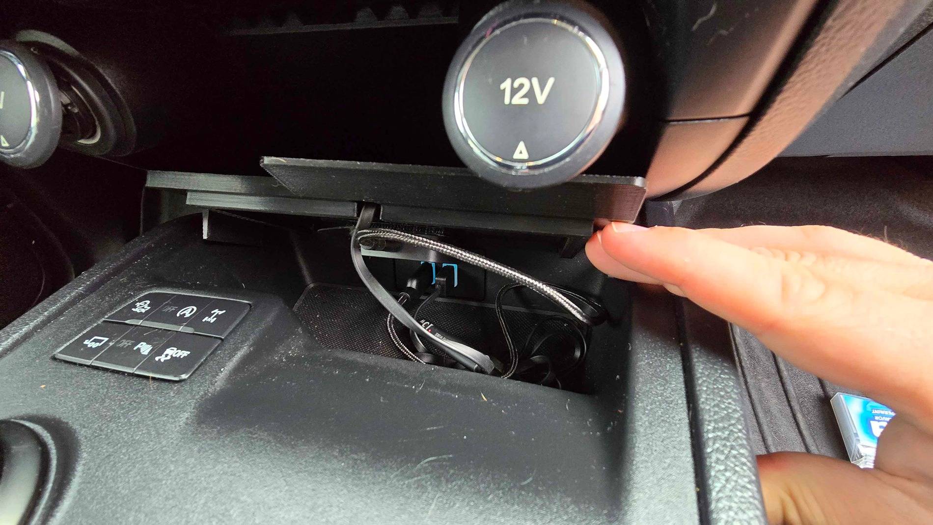

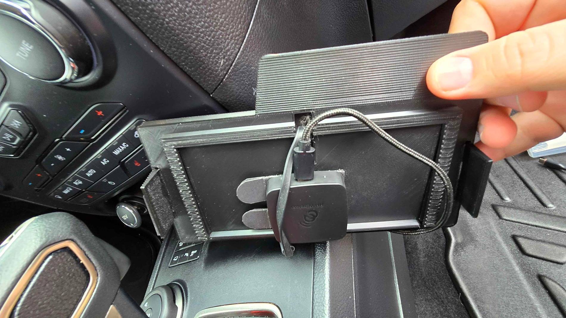

I have had the AA Wireless adapter for 2 years and am using it with Android in my 5G Ranger and it works perfectly. I would not go back.
I have also have bought 3 for other people (One driving a Tacoma with an iPhone, and 2 driving Subarus with Android phones. And they worked well for all 3.
I also messaged DirkM on this forum who made a 3D Print to hold this charging pad. I bought one from him and he printed and shipped it to me: https://www.amazon.com/Wireless-Charger-Charging-Adapter-Airpods/dp/B0BTCW46GN/
I used command strips to attach the AA Wireless adapter to the bottom of the bracket making it so theres no cables visible for the AA Adapter, or the charging pad.
If you want to hide the AA Adapter message DirkM and (if hes still making them) maybe he will be willing help you out and sell you one?

That's a pretty slick setup. I was thinking of plugging it into one of the rear console ports since I have a supercab and people don't really sit back there. Out of the way but still accessible. Probably use Command strips to stick it to the console too.

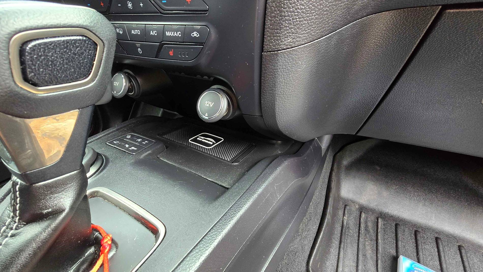

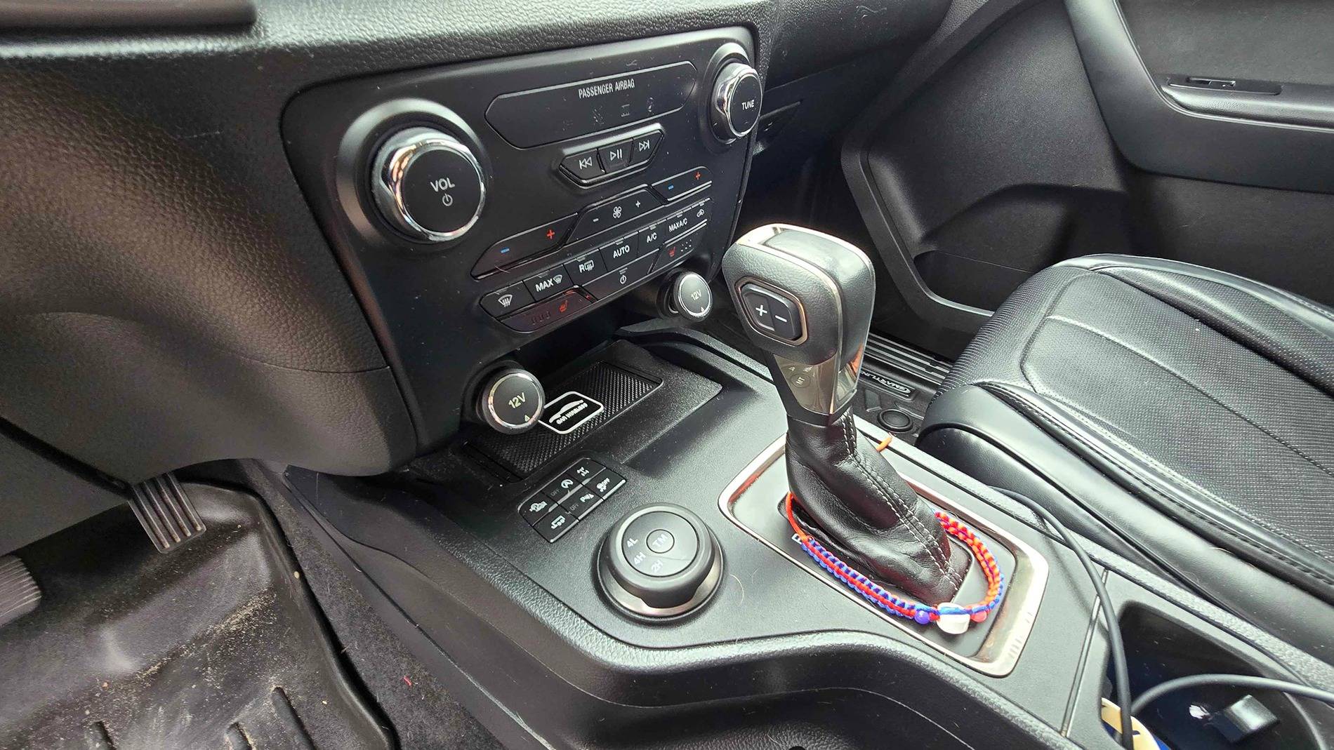

I am here to echo what others have said. The 5G never had wireless as a factory option. The rear ports are PD only. The center console are the only two that provide data to the head unit. You could always wire those ports to the back, but then you don't have data at the front.
I have the CarLinkIt wireless adapter (iPhone, but they have Android) and it works really well. I also have @DirkM's tray with wireless charging. It's a great setup. I always have CarPlay and charging available.
