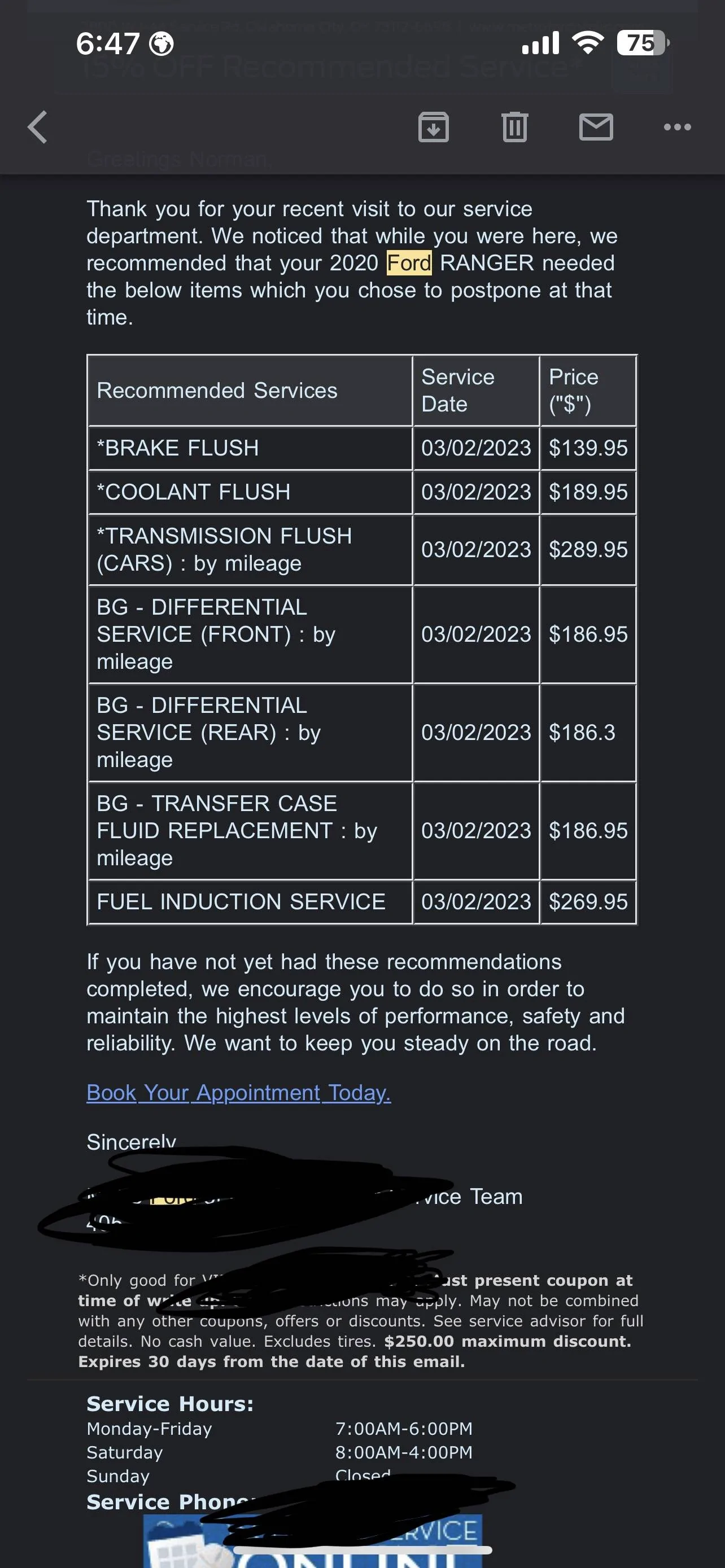

I currently have a 2020 Ford Ranger XLT FX4 that has 60,000 miles on it and the dealer is wanting me to get some service done and I’m trying to figure out what actually needs done at this mileage. My current driving conditions as far as temp and weather is central texas. I drive mainly city with occasional highway for trips. I have been keepeing up with my oil changes but I’ve only owned the vehicle since it was at 42K without much knowledge of service prior.
Look at your owners manual. Also in Fords website they say it all.

the trans isnt too bad to do by yourself, its a 90* rotated diff change if you think about it, just messier, but smells better!
Id also change the trans filter too, with how complicated these 10r80s are, wanna make sure that filter isnt clogged.
depending on the dip stick you can also cold check it, since some genuis thought the dipstick check next to the exhaust was great.
I do know the brake flush is itemized in the book every 3 years regardless of mileage, I did the induction / injection and normal "works" devices last week at 30k because I plan to keep the truck the brake flush was about that price and the induction service? seems like a good idea because these engines are direct injected, like I said I plan to keep it and will follow what the owners manual says as far as other stuff like coolant mine says 150k miles for example.......
