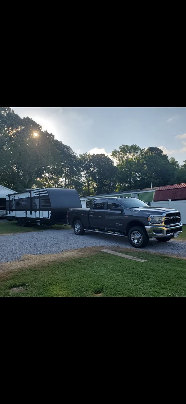

That’s my son’s Ram HD snow plow edition with the bad ass 6.4. He pulls a 38 foot camper with it like nothing is attached back there. People on his camping site said you can’t pull that with a gas engine, you need a diesel. NOT…….
Lots of people are so stuck in their ways they won't ever change.
There are a few on here that pull 26' trailers with Rangers and move along just fine. The Ranger has a fantastic powertrain.

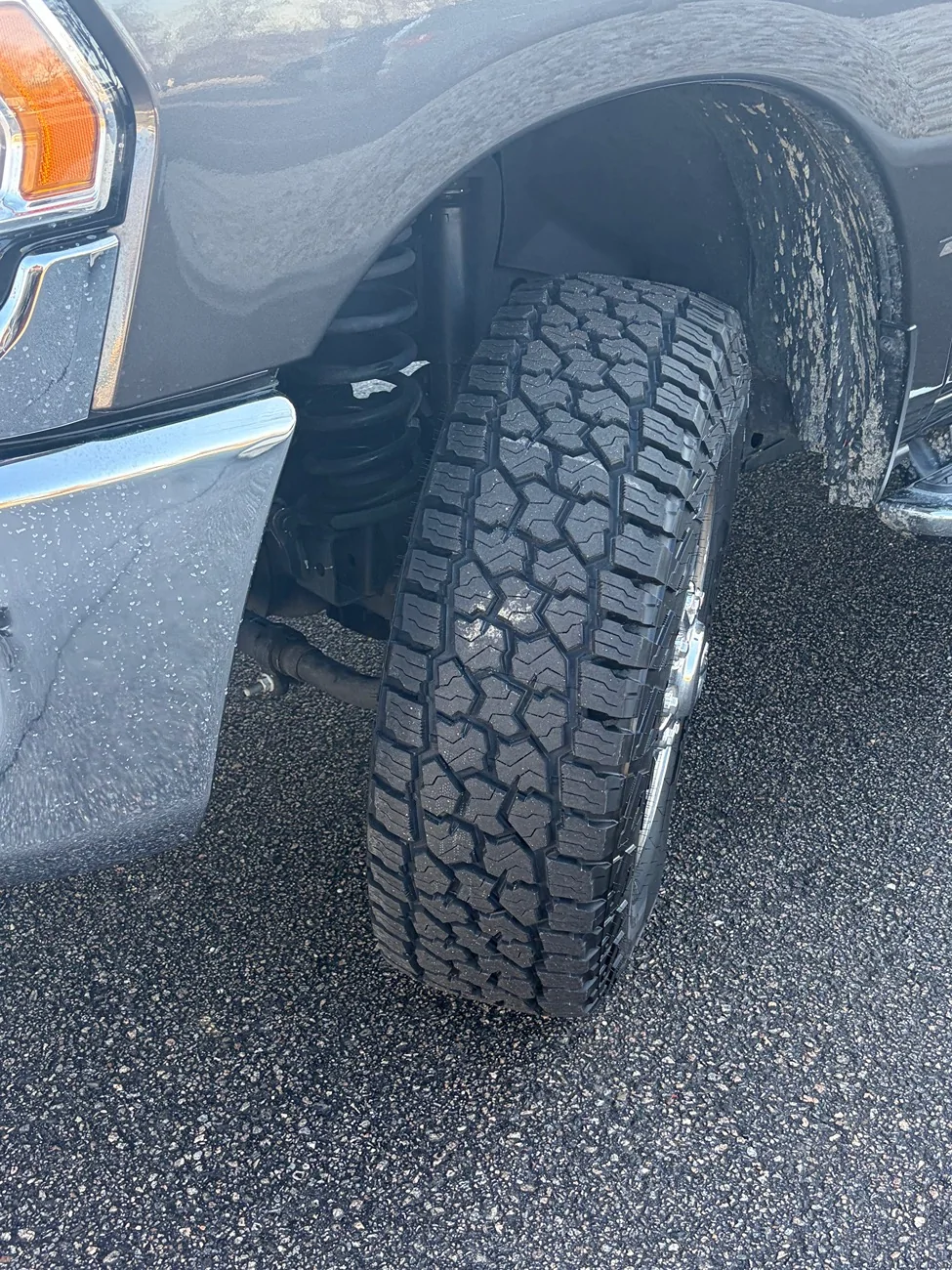

I drove that thing about 40 miles last week to get new tires put on it. That truck will literally light the tires. It will get to 80 so quick it scared me. I made a right turn at a light and hit it a little an it actually went sideways. He had Discount Tire put Coopers on it.
