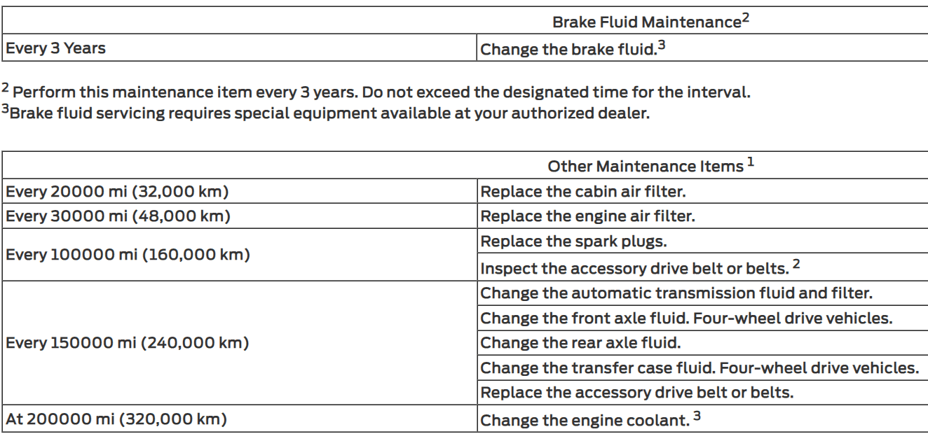

I currently have a 2020 Ford Ranger XLT FX4 that has 60,000 miles on it and the dealer is wanting me to get some service done and I’m trying to figure out what actually needs done at this mileage. My current driving conditions as far as temp and weather is central texas. I drive mainly city with occasional highway for trips. I have been keepeing up with my oil changes but I’ve only owned the vehicle since it was at 42K without much knowledge of service prior.

If it was me I would do the Brake, Transmission, and Transfer case. I know they don't call for the transmission until 150k, but there is no way I'm leaving the fluid in that long. The others I don't know the change interval but would probably due them at 100k

Rear diff fluid seems to be the right choice at this time. @AzScorpion and a couple others have reported it was needed when they did it. If you’re not having performance issues, throwing codes, or having shifting problems, I’m not convinced those other items are needed - check the Ford recommended intervals for those items and be guided by that - Ford tested the bejeezuz out of those components to come up with those numbers.
Dealers are motivated by making money on service - the engineers and techs at Ford simply want your truck to last as long as possible.

Transfer case, front/rear diff...DIY on your back easy job...save your self $$$...the rest have the shop do it...
