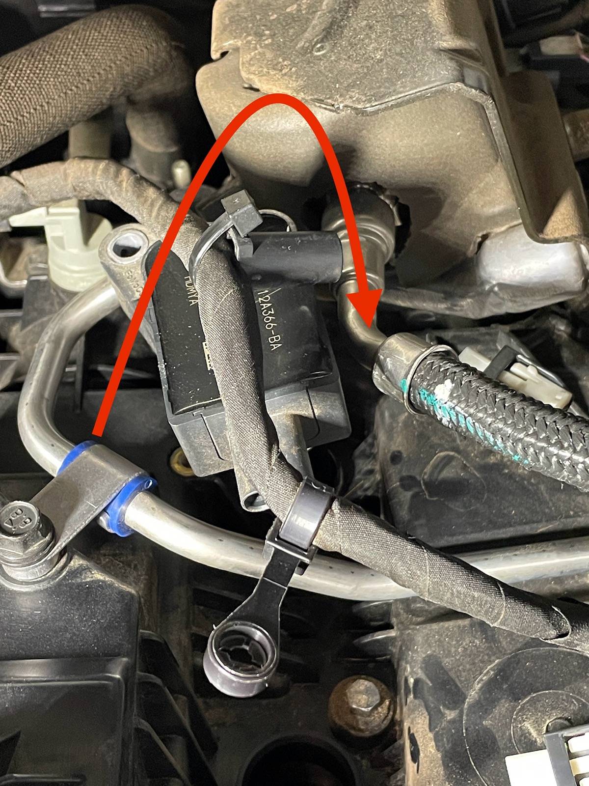

Can number 4 be replaced without removing the fuel line on the high pressure pump?
Yes but you must be very attentive to the feel (vibration) click of the coil boot attachment to the plug, as the fuel line requires you to start the insertion into the well at an angle, this makes it very easy for you to simply slide down the side of the plug and put it all together and then have a heavy misfire.
So when doing the other 3 plugs note the feeling (vibe and slight audible) click it makes when it locks in place for a reference in feel ~ sound for the #4 plug.

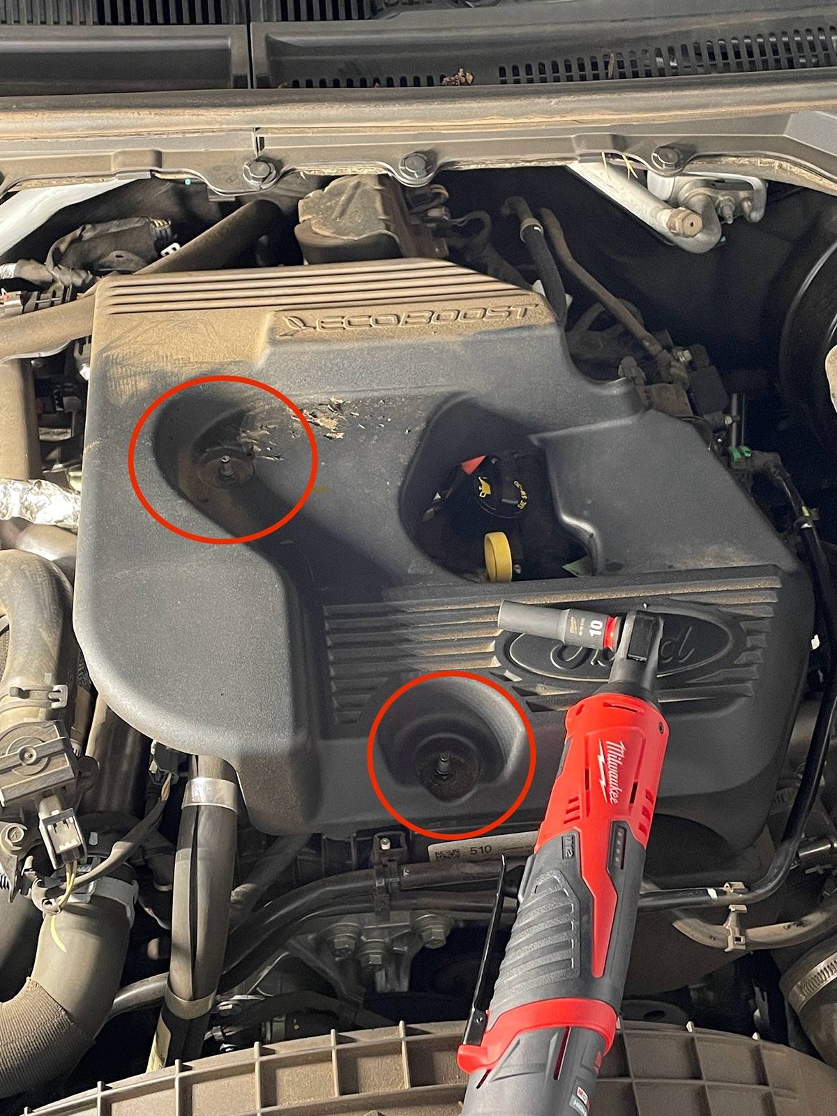

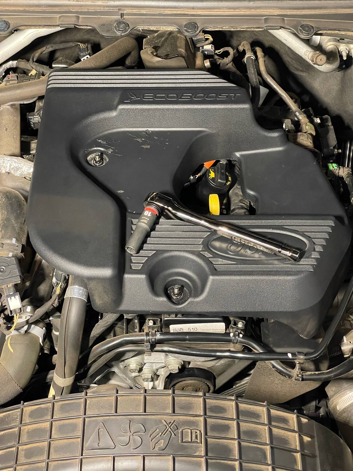

Remove the EcoBoost Engine Cover if equipped (my '19 Lariat came equipped) by removing the 2x 10mm lock nuts and pulling up
*OPTIONAL: Upon removal deep clean the cover and underneath around the spark plugs using a damp microfiber rag or brush

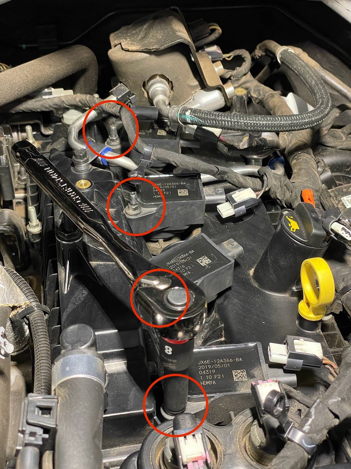

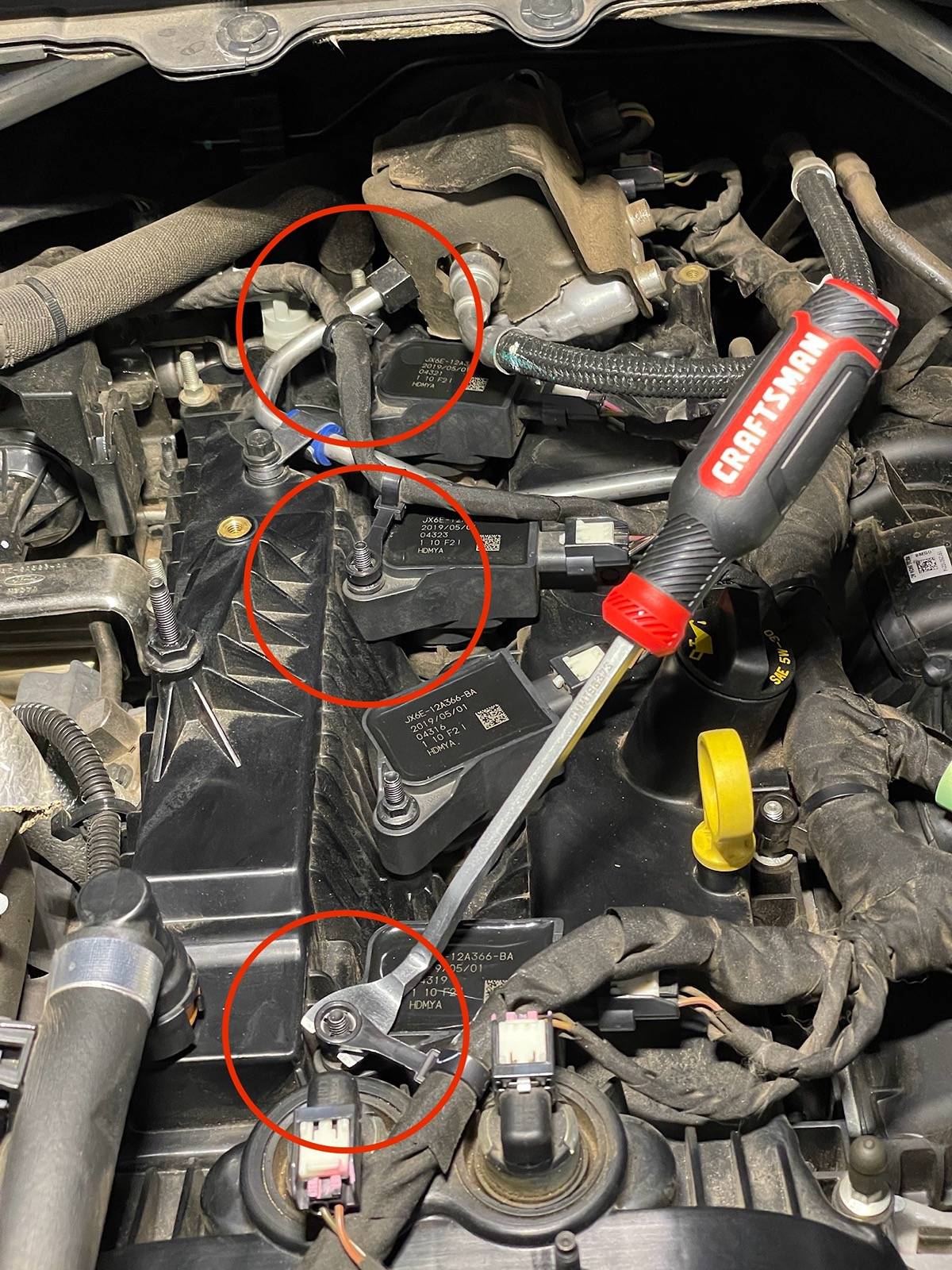

Use your plastic clip removal tool or slotted screwdriver to remove the 3x plastic wire guides/retainers. It is super easy and you do not have to apply much force at all. You can pull the harness away from Cylinder 1 (closest to you) to fully expose that ignition coil now.

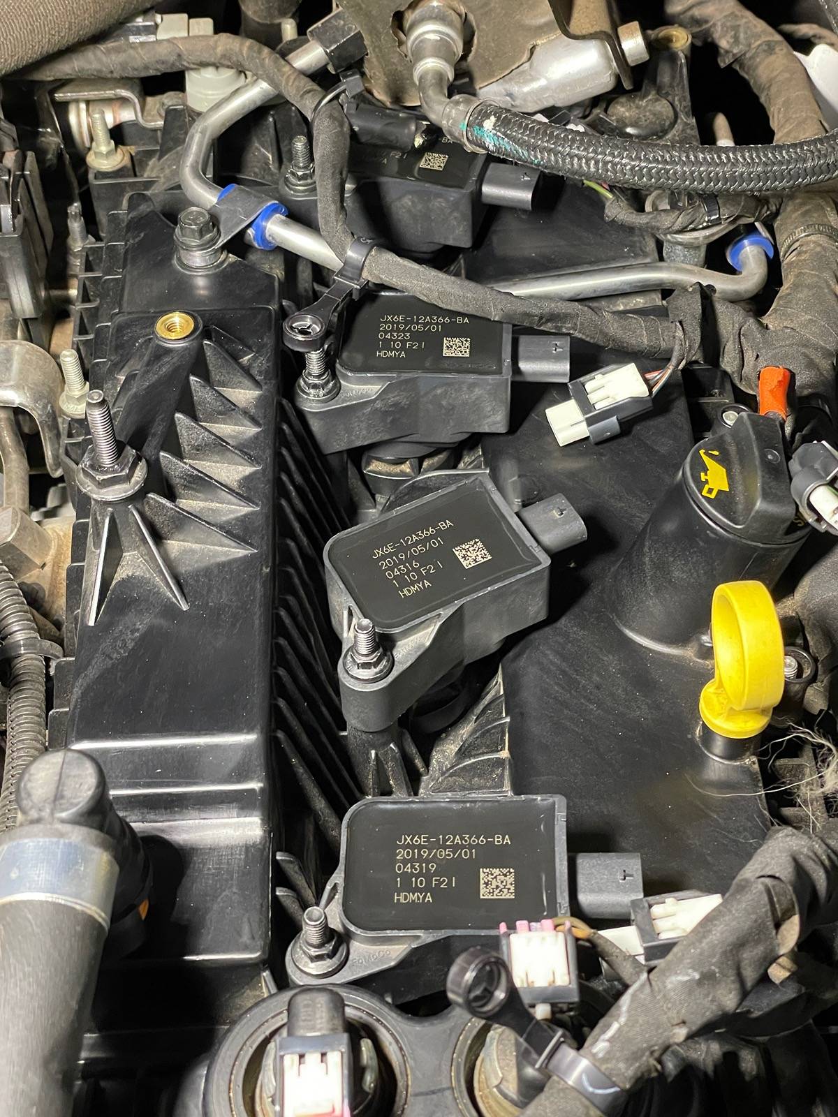

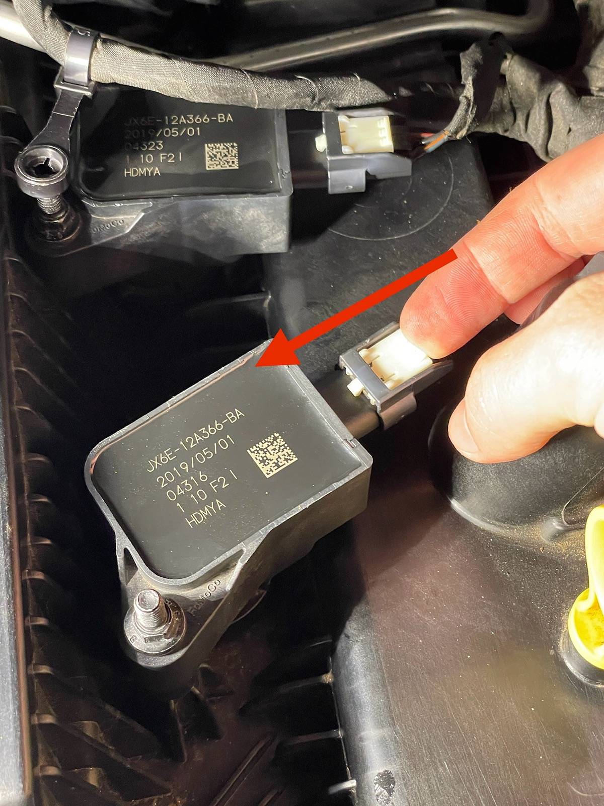

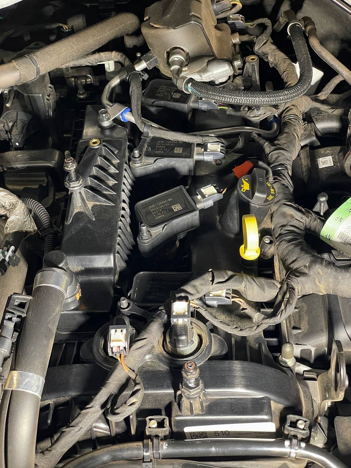

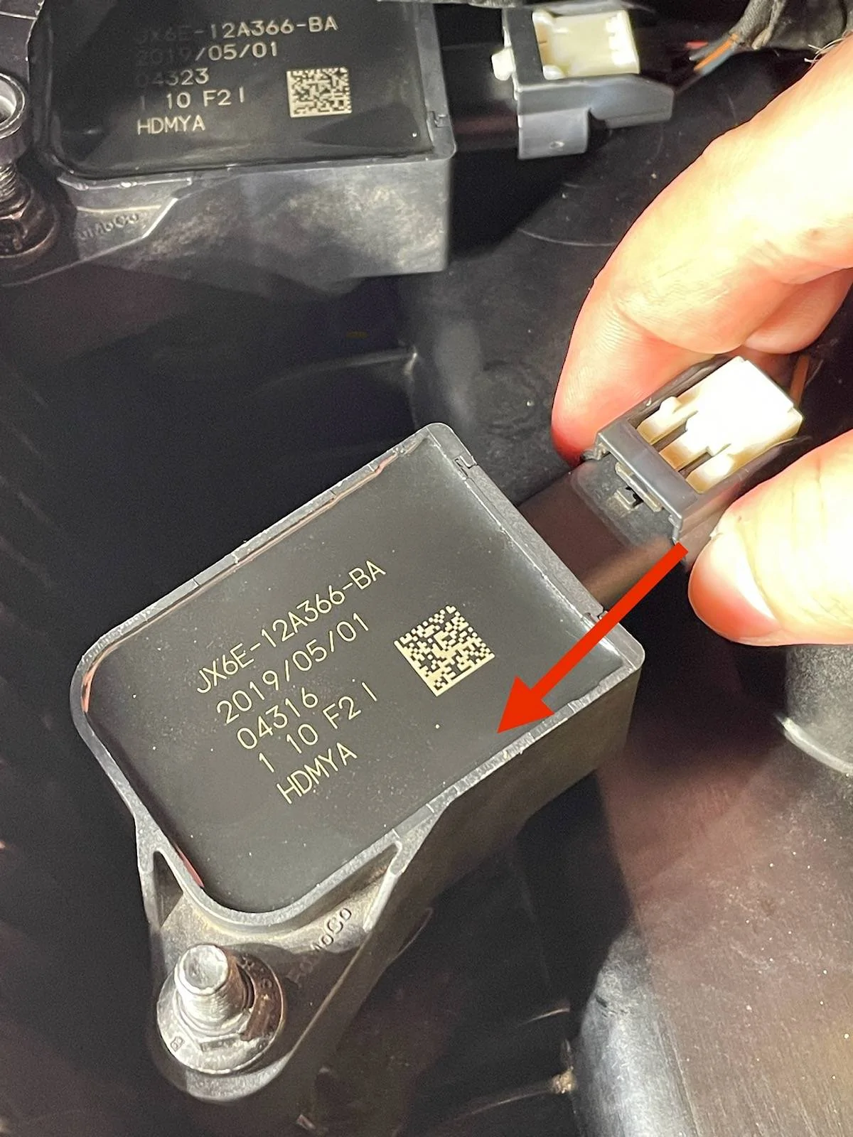

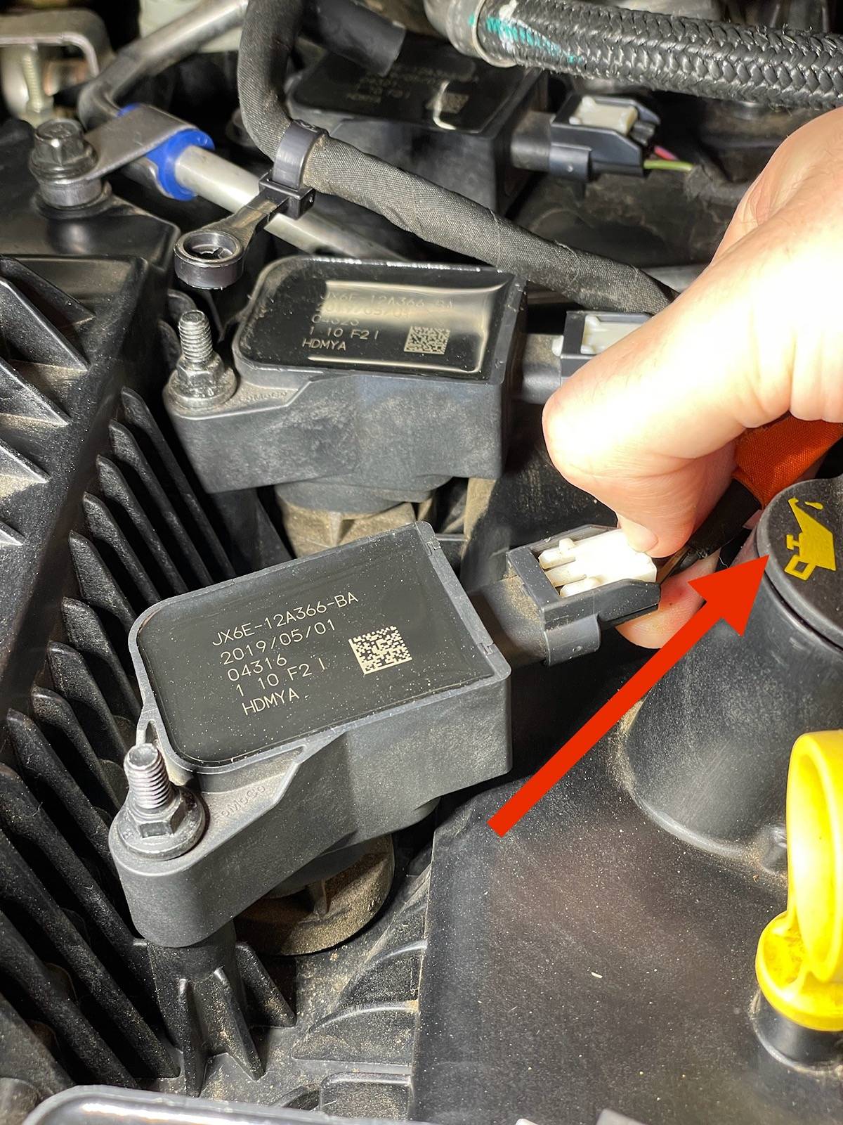

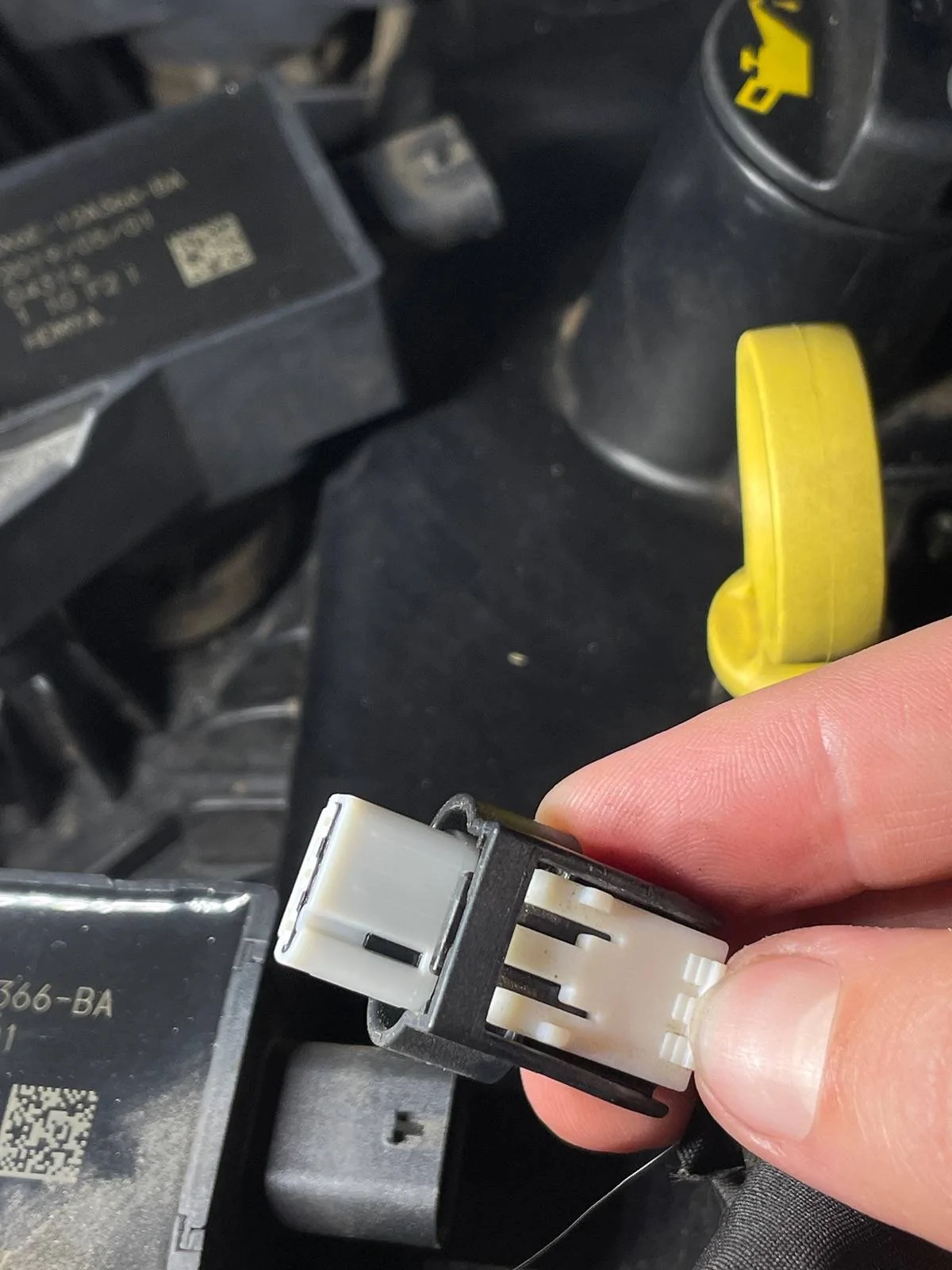

Unplug the 4x Ignition Coil connectors. The design is pretty neat, the white sliding locking tab can be unlocked by using your fingernail and sliding it away from you. Once the locking tab is unlocked, simply wiggle the connector off.
STEP SIX :

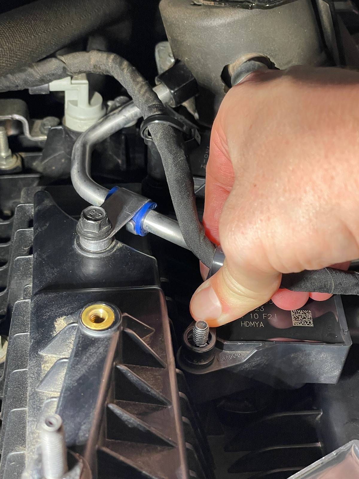

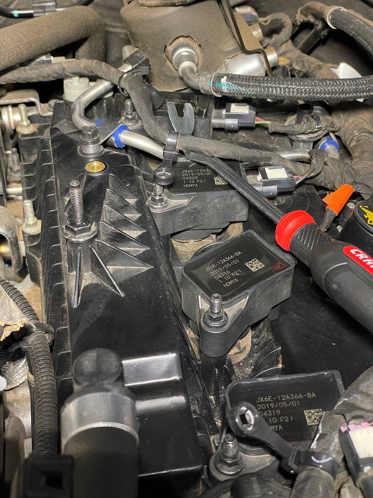

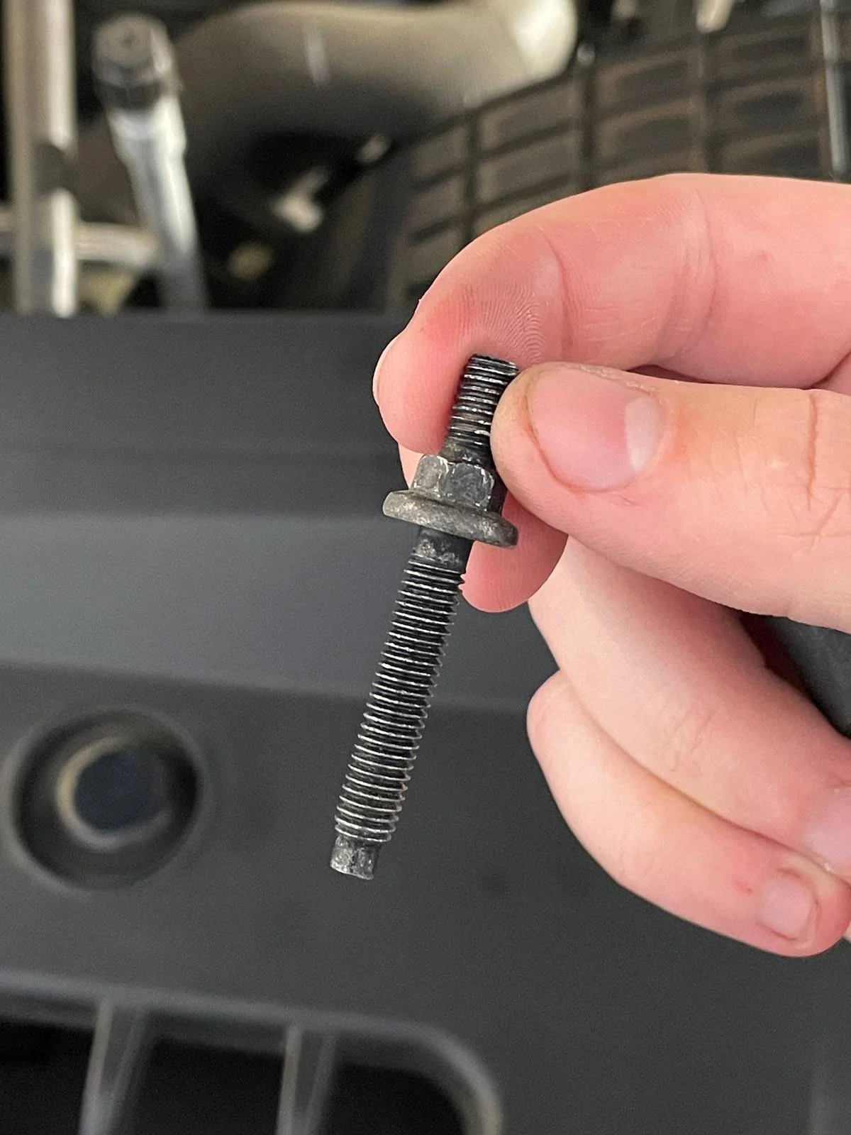

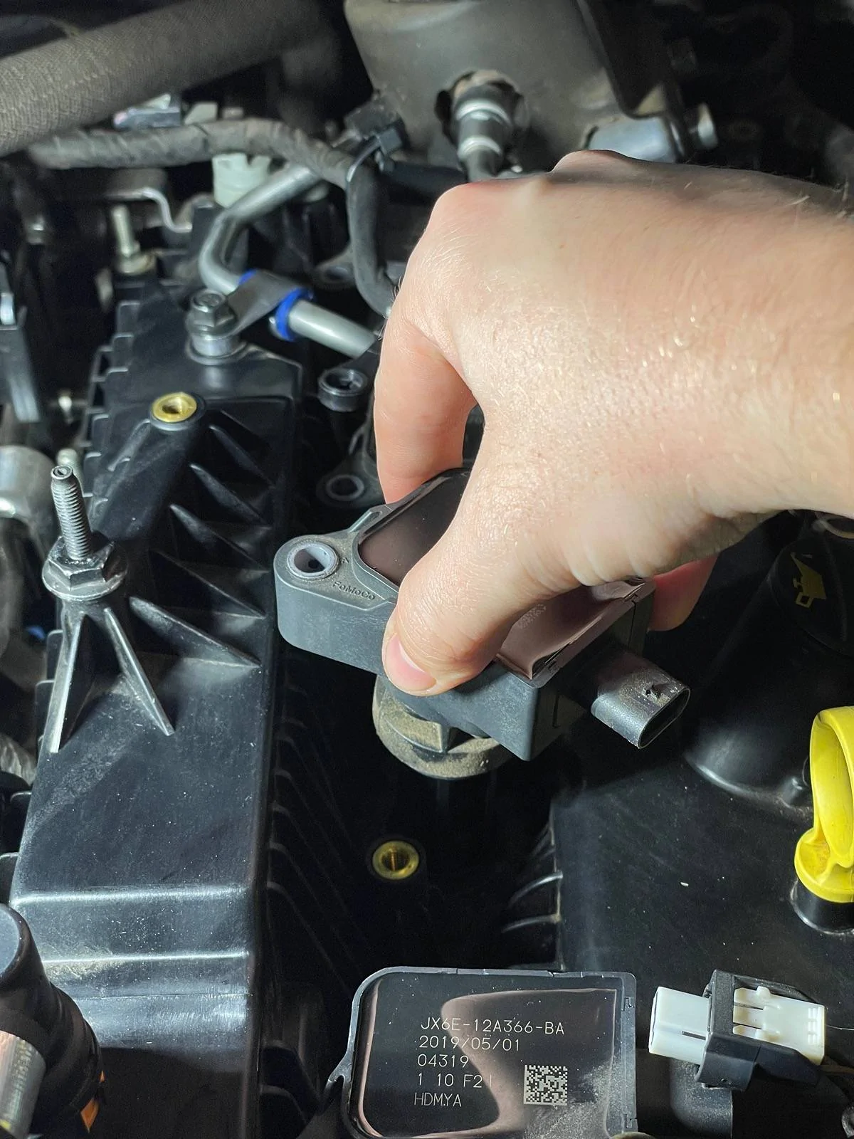

Use your Ratchet & 8mm socket to remove the 4x Ignition Coil Studs and use a twisting motion to remove the Ignition Coils (mine did not take much force at all). The trickiest one is the back one on cylinder 4, but simply rotate the Ignition Coil clockwise where it is not obstructed by the high pressure fuel pump and pull up.

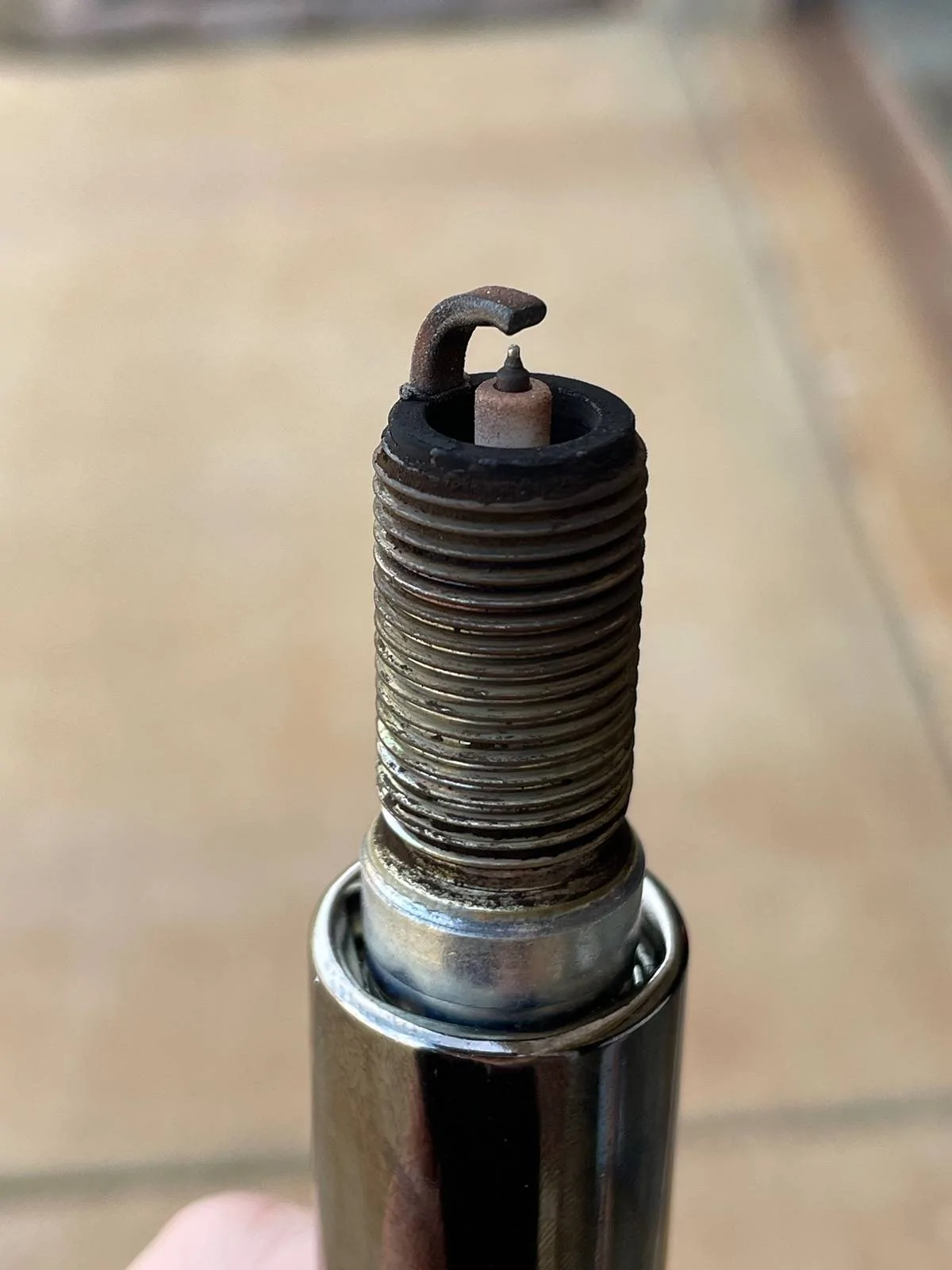

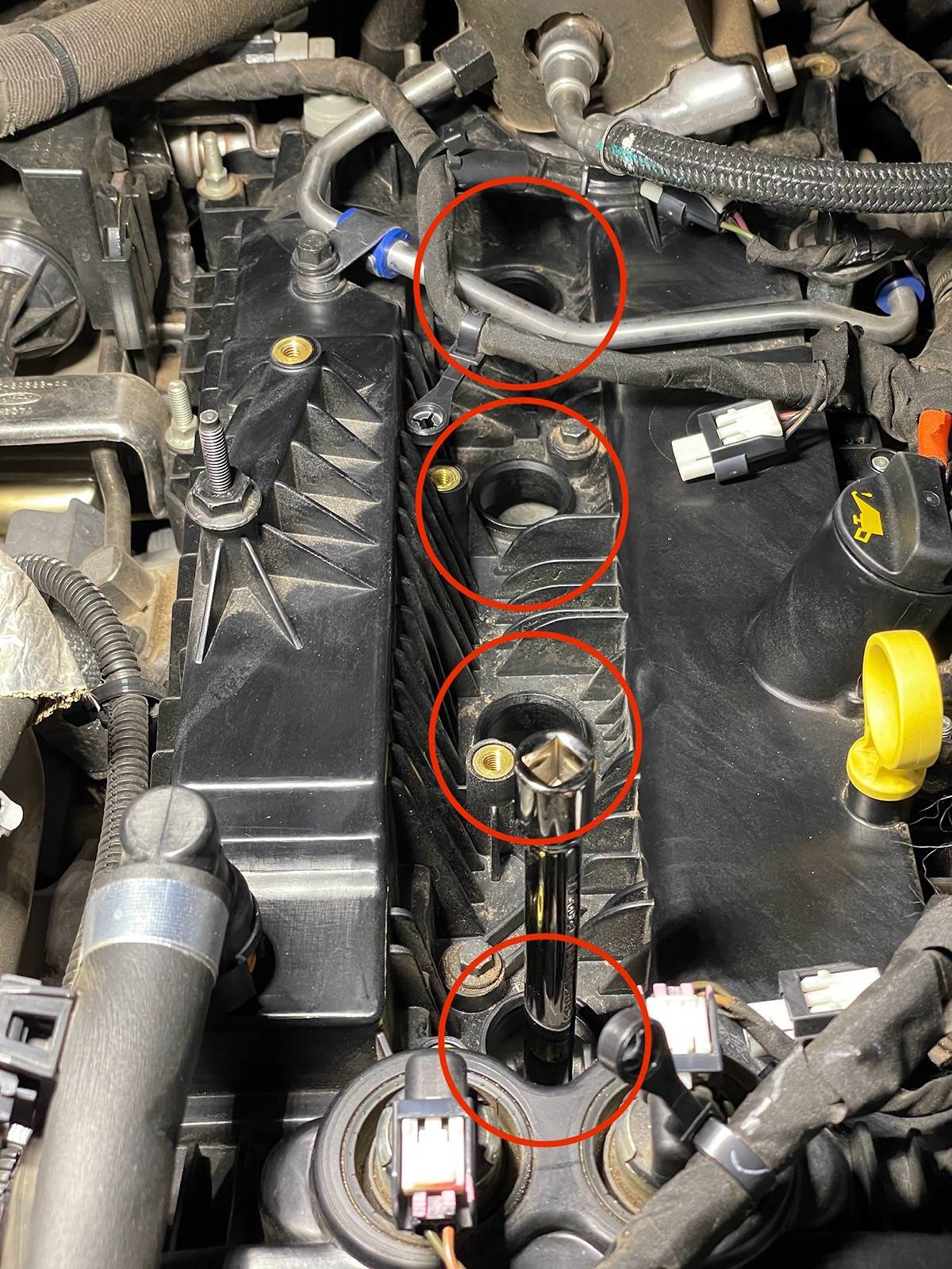

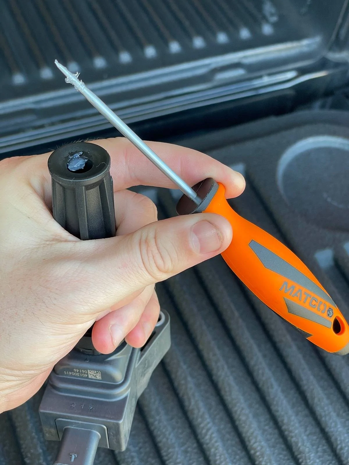

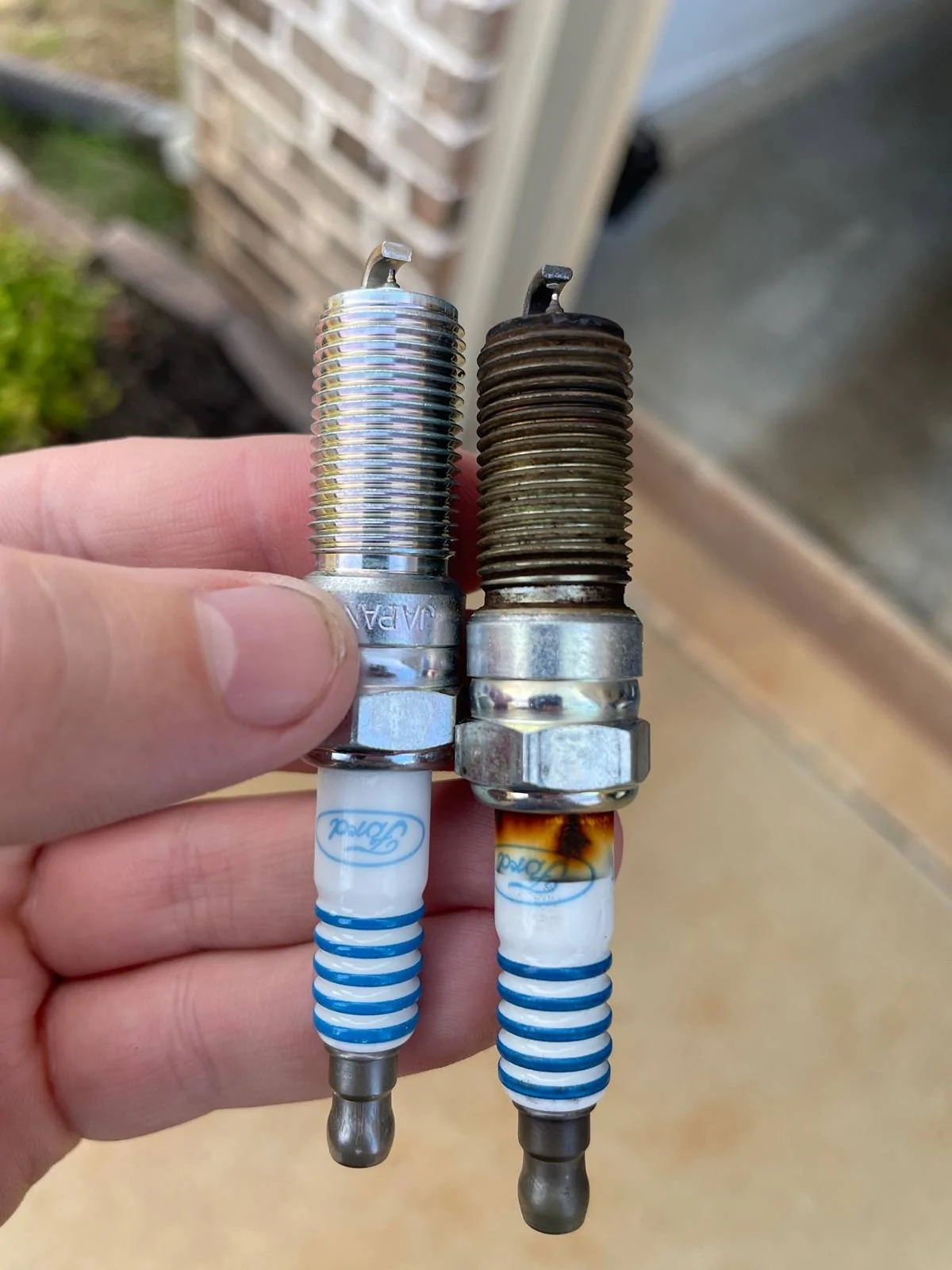

Remove 4x Spark Plugs using a 6" or 8" extension with a 5/8 Spark Plug Socket. Mine were fairly easy to break loose and did squeak a little bit while loosening.
My plugs were in decent shape, but I am probably going to make my change interval 5 Years/60,000 miles. The staining on the porcelain is not rust, it is corona staining and is a completely normal byproduct per NGK.

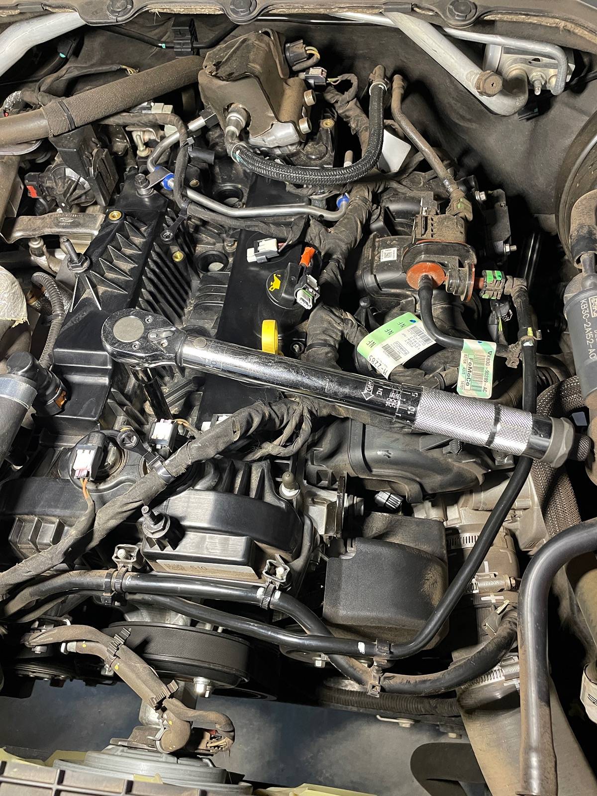

Check gap and Reinstall your 4x new Motorcraft SP-594 Spark Plugs. All 4 of mine were at a 0.029 inch (0.74 mm) gap out of the box so I did not adjust it. I measured the factory plugs I removed and they were between 0.028 and 0.029 inches.
Simply hand thread each plug until it's snug to prevent from cross threading. I was actually able to get it fairly close to the proper torque value by simply hand threading. If you have a knurled extension it makes it easier.

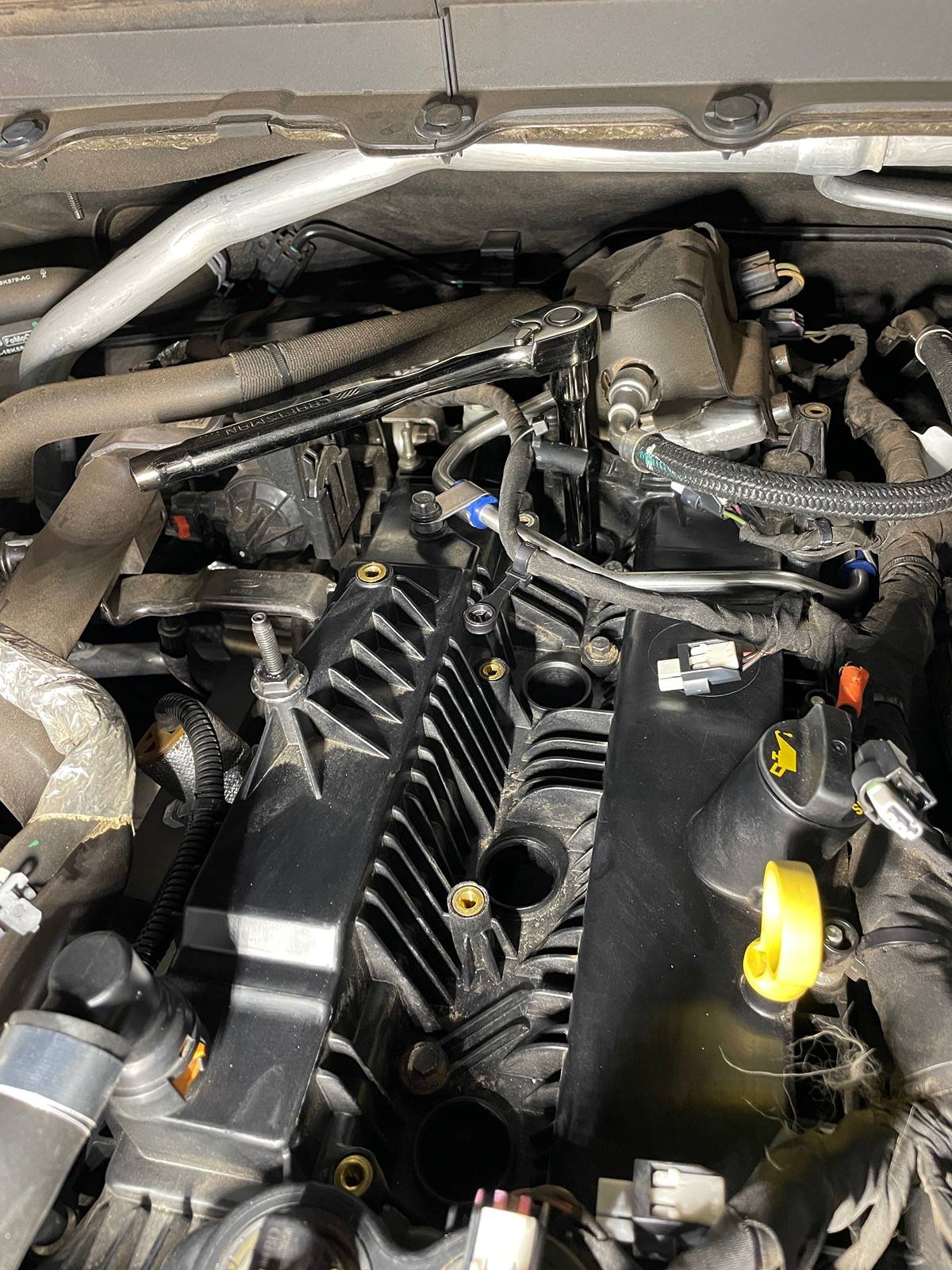

A trick for cylinder 4 is to place your ratchet at around the 8 o clock position to both loosen/tighten the plug so the high pressure fuel pump is not in the way.
*OPTIONAL : Torque Spark Plug to 12 Nm (106 in.lb or 8 ft.lb) depending on which torque wrench you use. I used my 1/4" In.lb torque wrench using a 1/4" - 3/8" adaptor to get mine to 106 in.lb. It did not take much force at all to reach that torque value.

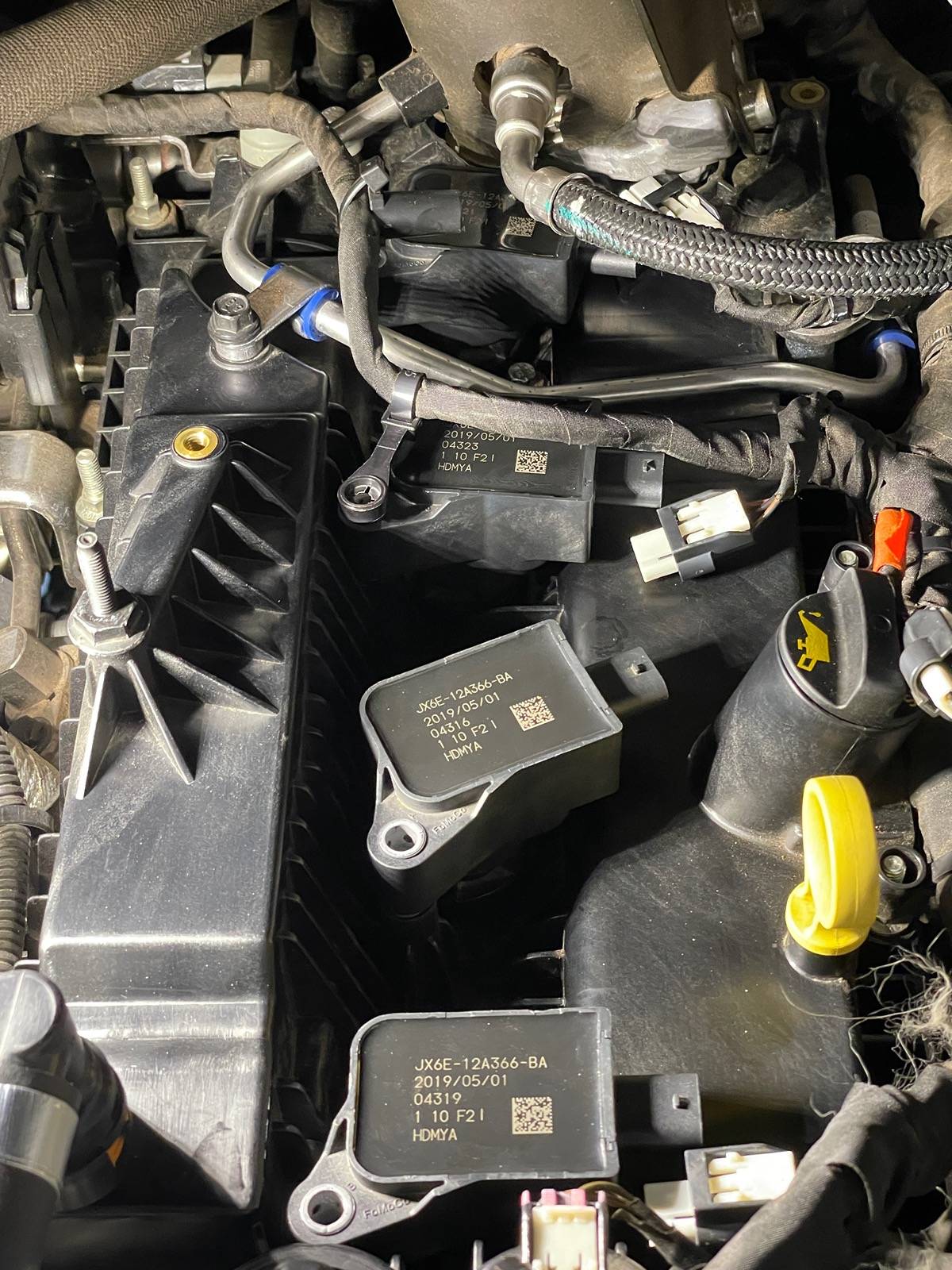

Reinstall the 4x Ignition Coils and snug the 4x Ignition Coil Studs using a 8mm Socket. Reverse how you removed the cylinder 4 Ignition Coil by installing it at the 6 o' Clock position and twisting it counter clockwise.
*OPTIONAL : Apply a pea sized drop of Dielectric Grease on the inside of the Ignition Coil Boot and spread it around evenly using a pick (I used a Matco Straight Pick) and wipe the rim clean.

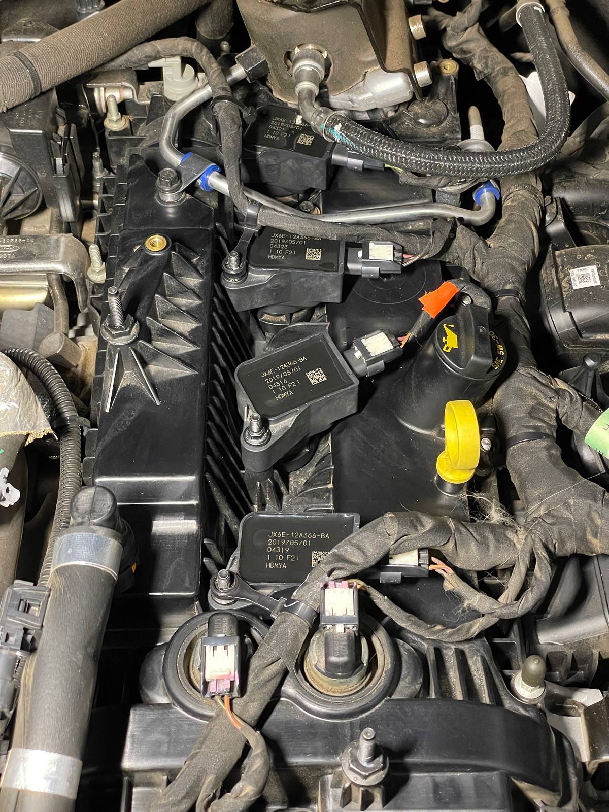

Reposition the wiring harness and reattach the 3x plastic wire guides/retainers. Simply push down on them and they instantly bite on the Ignition Coil Studs.
Reattach the 4x Ignition Coil Connectors. Push on until you hear a 'click' and then use your finger to push the sliding lock tab forward.

Reattach the EcoBoost Engine Cover if equipped by pushing down and reinstalling the 2x 10mm lock nuts. These just need to be hand tight.

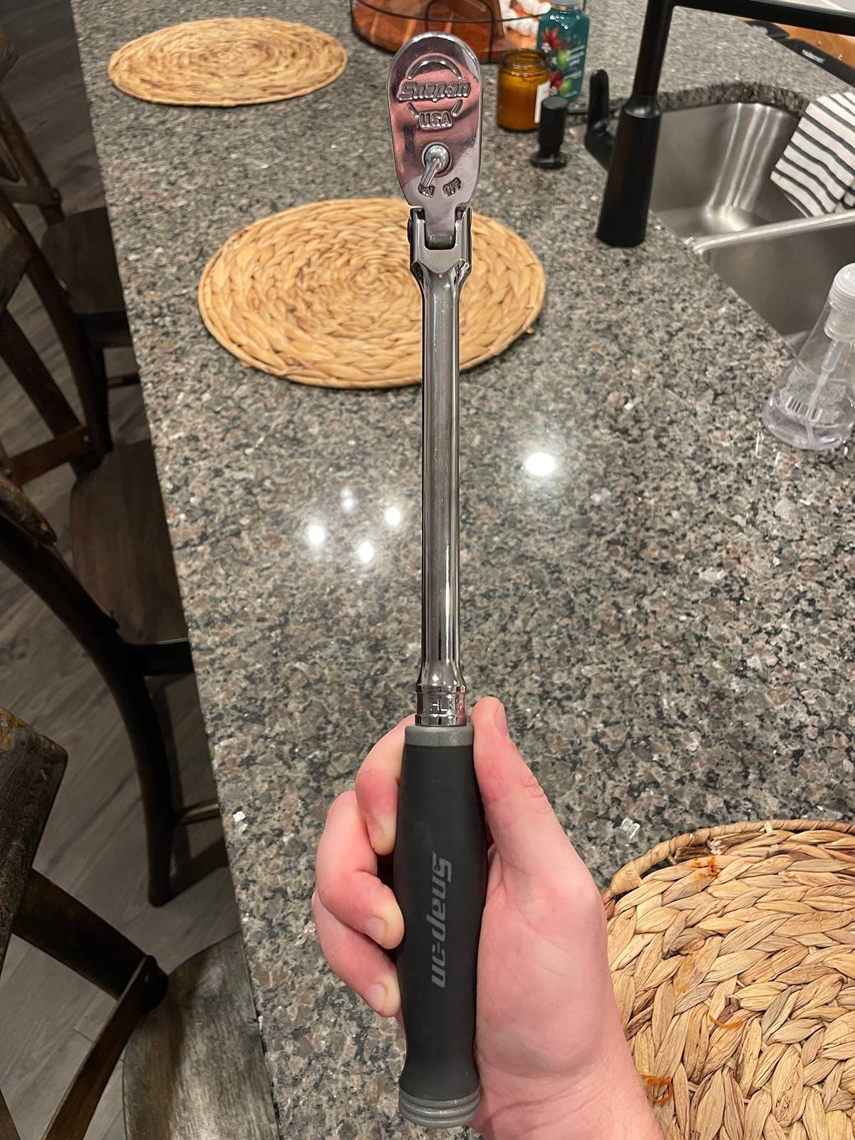

To celebrate, I bought my first Snap-On ratchet with the “savings” from the spark plugs. Follow me for more financial advice. ? :crackup:
