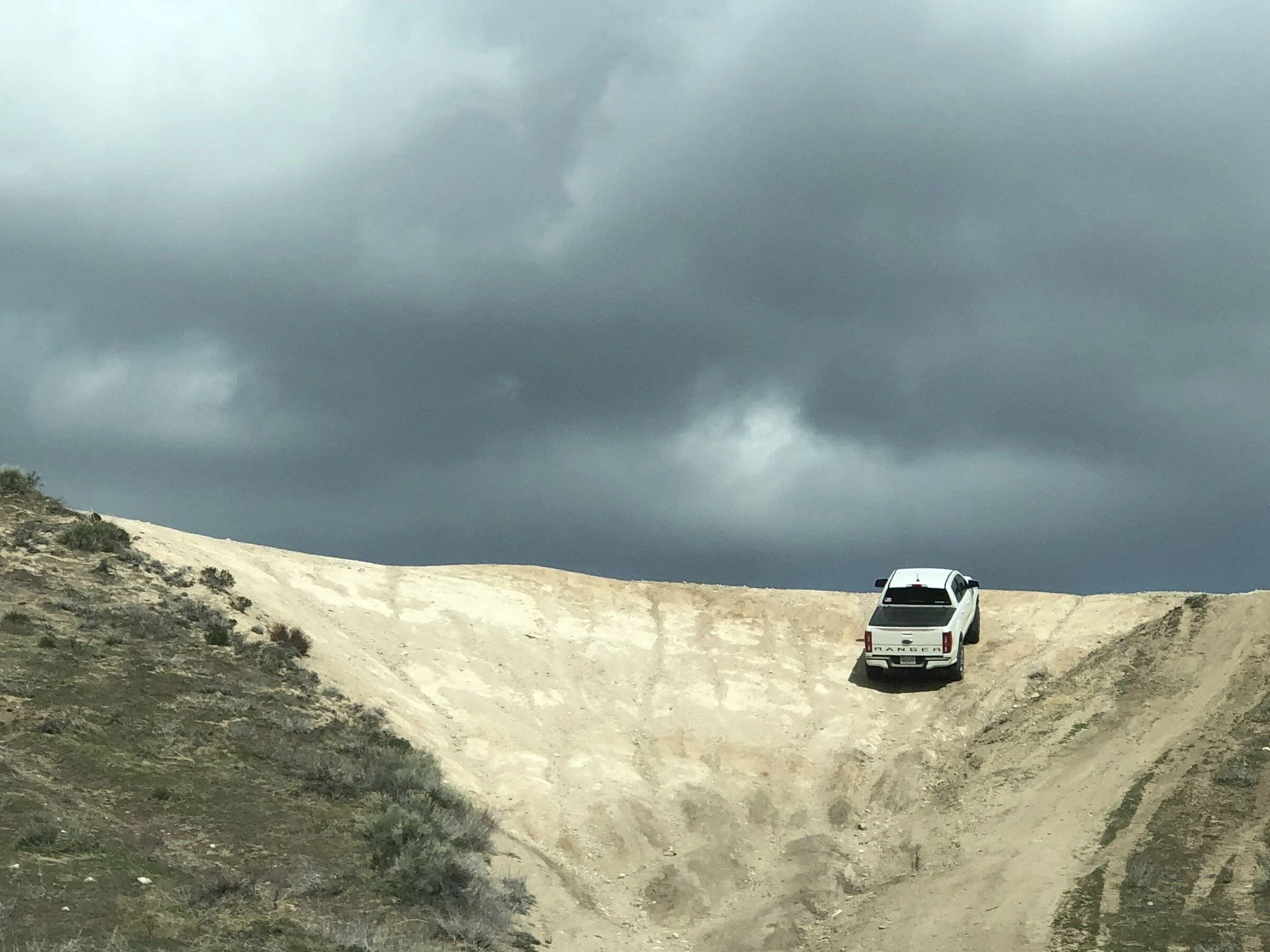

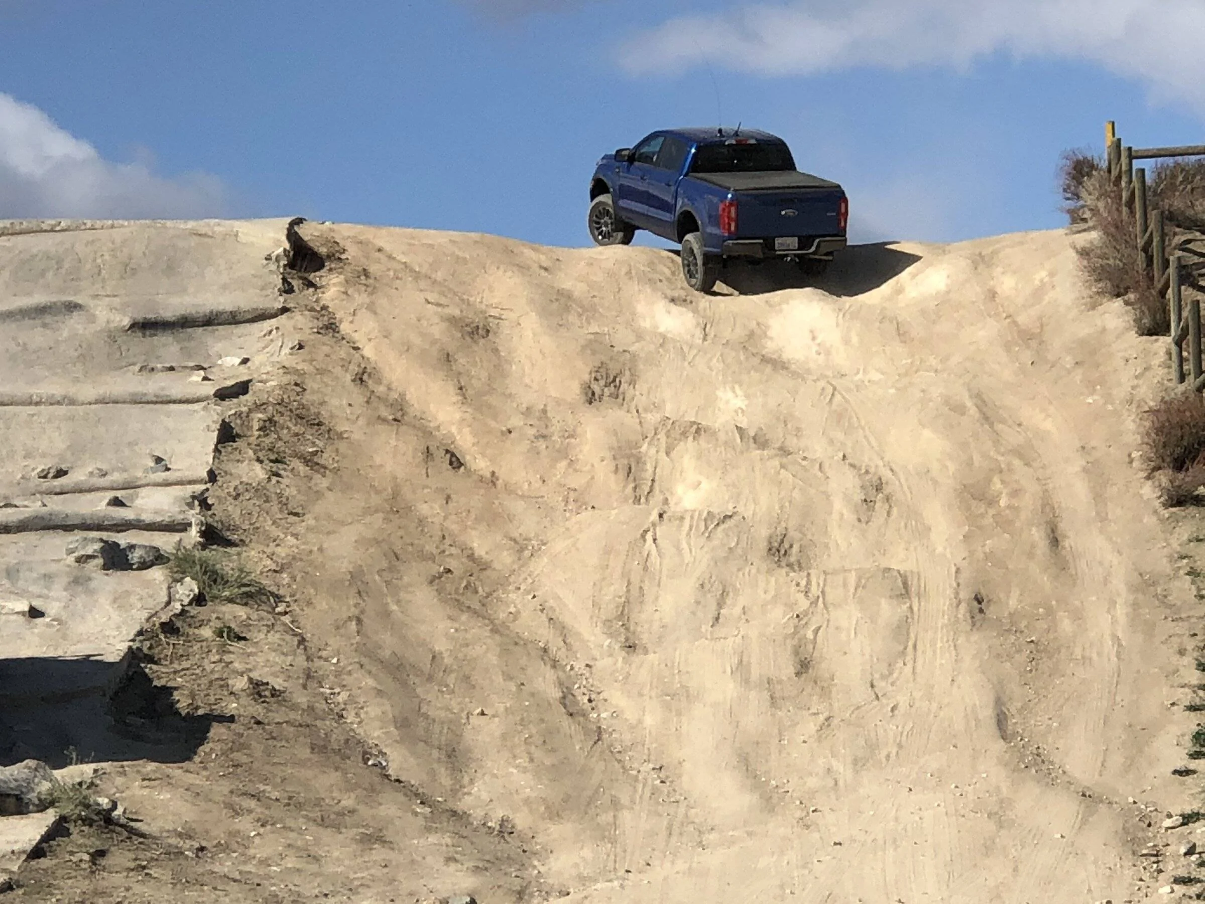

Assuming you have a Locker already(yes its possible to get without FX4) the Ranger will take you very far. If you dont have a locker then you will be a bit limited. In general a leveling kit will only do so much and depending on how far you want to go will.may want to avoid a leveling kit. I myself had a 2019 XLT Sport 4X4. No locker unfortunately but I did put the Old Man EMU basic lift with 285/70-17 Firestone Destination XT'S ON factory sport wheels with no spacers. Only had a little rub at full lock and i was able to go many places with it. There were places I was able to go that others here wouldnt want too(thank yhe leveling kit for that). Whats nice is with that combination the truck was still in a practical height for regular truck stuff including towing. The biggest advantage you will get is the new leafs in the rear that will give you not just lift but more articulation(real big help for OffRoad).
Still your choice what you do but I can promise it will make you happy
