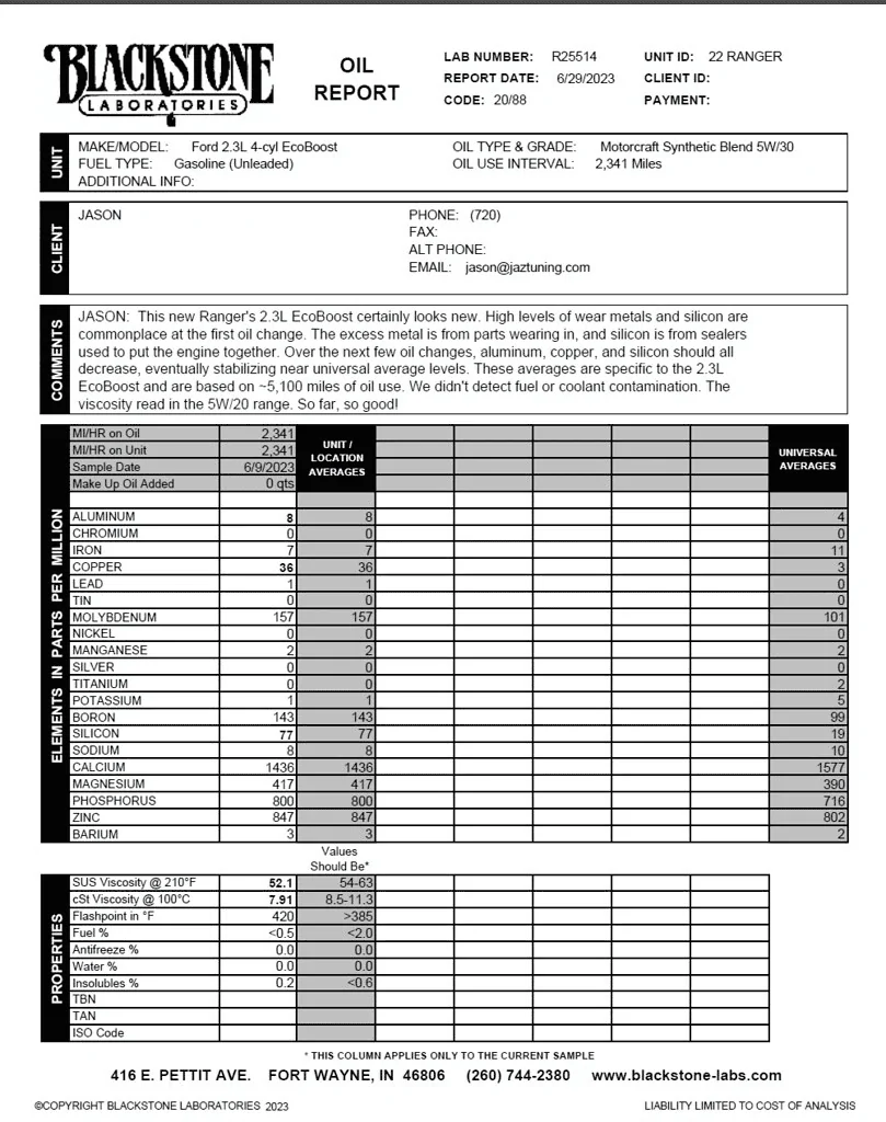

I use testing to monitor things as well as decide on an oil and change interval to use. I do it with my regular cars, race cars, side-by-sides, tractor, etc.
I got this back last week. Original fill with 2,341 miles on it. I will be running roughly the same interval on the OEM oil I just put in and then swapping to a better oil as I will be using this under higher stresses.
Yes, I like data and when I make recommendations or comments, I do it based on data...
In my mind the viscosity being down to 5W/20 with so few miles isn't a great endorsement for the wonderful Motorcraft syn blend oil.
