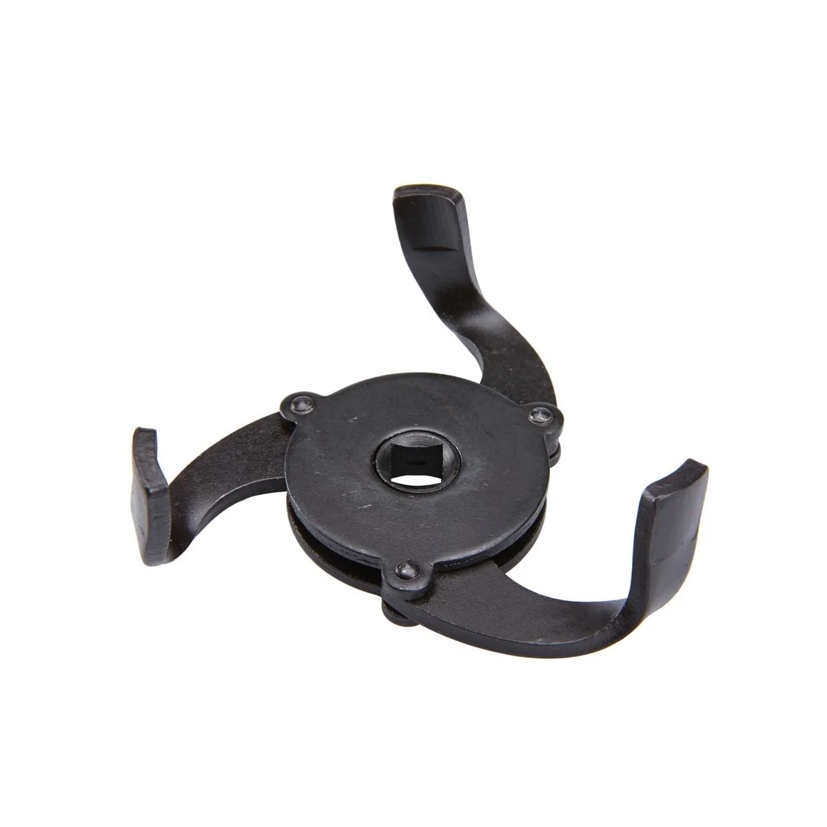

I have a few size an style oil filter wrenches an had to buy one like this to get the filter off my ranger. $8 at harbor freight an it works great.

I did mine today, My only concern was the factory Filter is smaller than the replacement which I bought a wrench for. That was an "Awe crap" moment as I had already drained the oil. But a good friend went and picked me up one of those 3 finger adjustable filter remover tools.
A riding buddy was doing an oil change on his FatBoy an asked to use my filter wrench. There's an electrical connection right by the filter. the HD brand wrench has a cutout to remove the filter without worrying about pulling on the wires. I took that over an it didn't fit. the shop he had do some work put an aftermarket filter on...I ran back an got the 3 jaw an said I should have just taken it with me to begin with. Lesson learned: when going to a buddy's house that is limited on tools, take more than you think you need.
