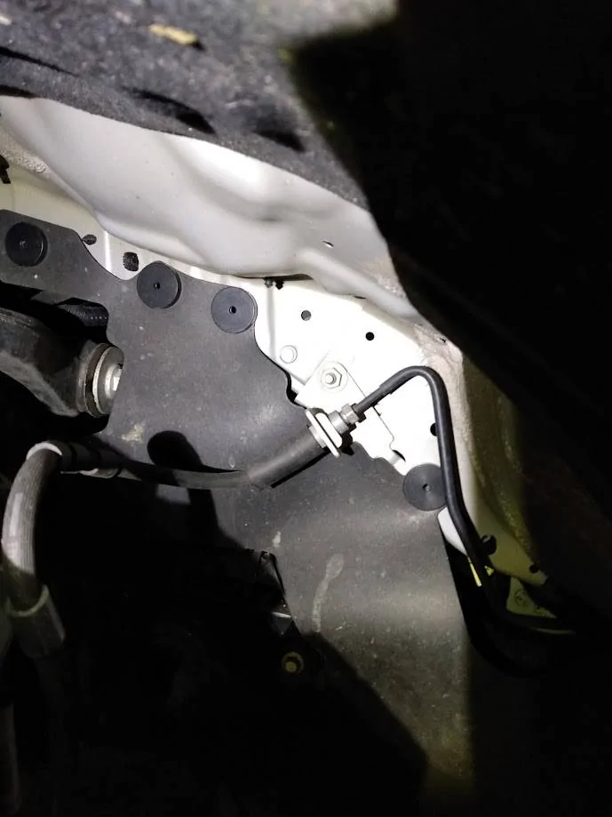

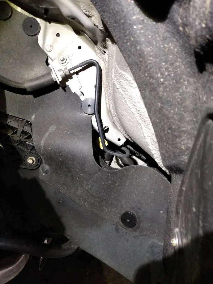

Just peel the flap back and stick it back on. Literally cuts the time to change the oil in half.

I ordered stick on magnets from ebay. Just searched stick on magnets. Cleaned metal surface behind flap. Stuck on one. Cleaned flap, stuck its opposite on. PERFECT. Someone here recommended magnets.
Speeds up change. Can change filter with tire turned to right, or tire removed.
Engine oil drained first. No mess, but like another post, I put paper towels beneath filter.
