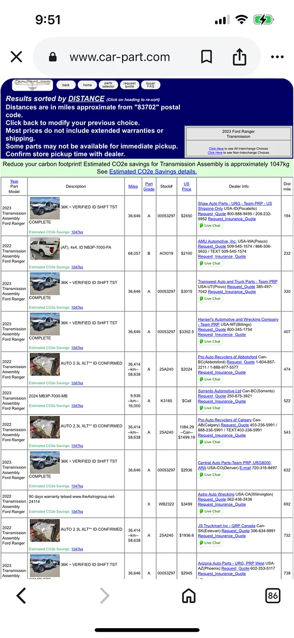

*sigh* I am going to hit a well-reviewed tranny shop in town to see if they have better news. Doubtful, but I gotta try.
Here’s some used transmissions of 2023’s near you that will have the updated cdf drum in them. Just have to find someone to do the swap. I’m assuming yours is a 4x4.
