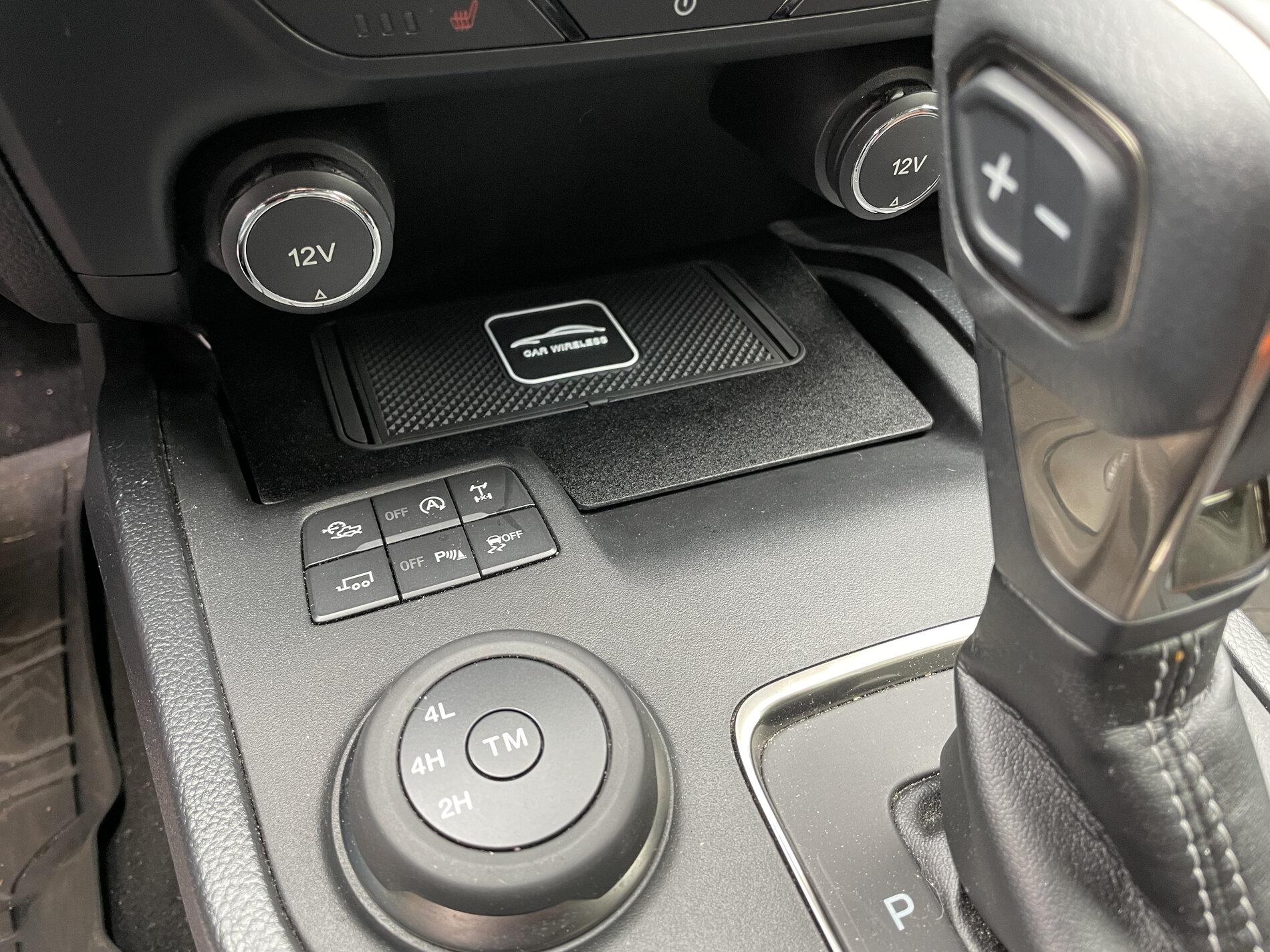

I think I never posted an installed picture of the painted bracket, so here it is. The color of the Rustoleum Truckbed Coating is a deeper black but by looking at it with your eyes it's not that obvious.

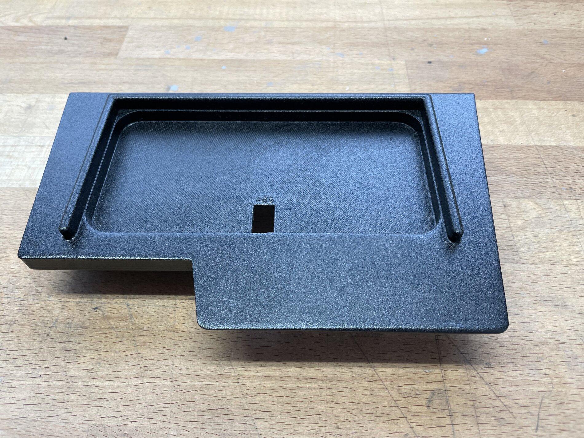

I had some free time and printed more brackets (some of them are painted), I also have a few spare wireless charging pads so you don't have to order them on your own.
Please message me for details.

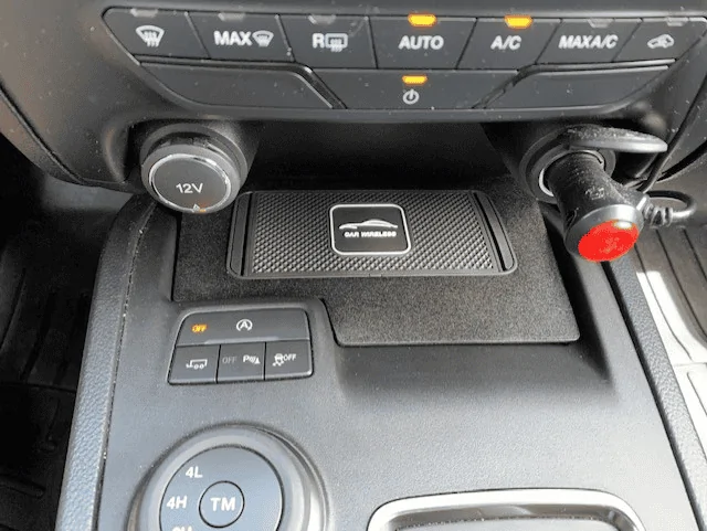

Guys - if you are on the fence, PULL THE TRIGGER! Dirk has done a great job on this and it really does look stock.
One bit of flexibility to clear up if you want to also have access to a wired connection (for AA for example). I asked early and Dirk posted a picture, but until I tried to to run a cable I did not quite understand. There is a gap at the back of both corners between the center console and Dirk's Wireless charging insert. I have a coiled USB cord so I needed a rt angle USB plug to make it work. I used THIS and it works great! Probably don't need for a straight cord.
Oh, and a another feature! Its fully removable, leaving no scars, holes, etc. Truly plug n play

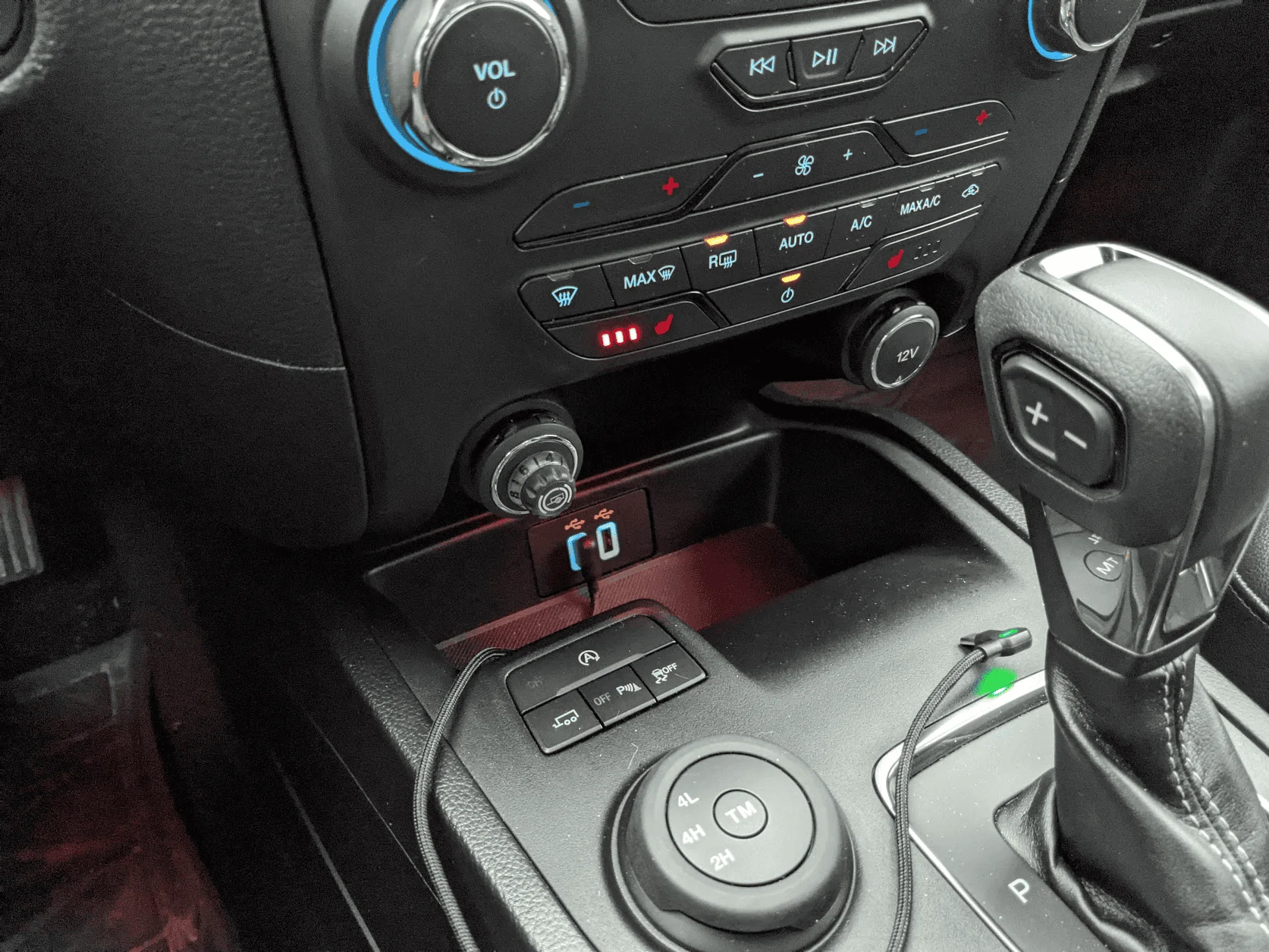

I didn't want to use the provided USB ports to power my wireless charger either, so I relocated the driver-side 12v socket to below the paneling that houses the built-in USB ports. Then I simply plugged in a 12v socket QC 3.0 adapter and plugged my wireless charger into that. In my case, my wireless charger was not a pad on top, but a coil hot-glued to underside of the panel.
Relocating the 12v socket achieves the same end-result as @SVTPaul 's method above. My way is plug and play (at the expense of losing your driver-side 12v socket), while his way is hard-wired (and you keep your driver-side 12v socket). In either case I'm not sure how one would get the USB cable back up to the charging pad. Something to think about, I guess.
I put my brake controller knob into the empty 12v socket :D
