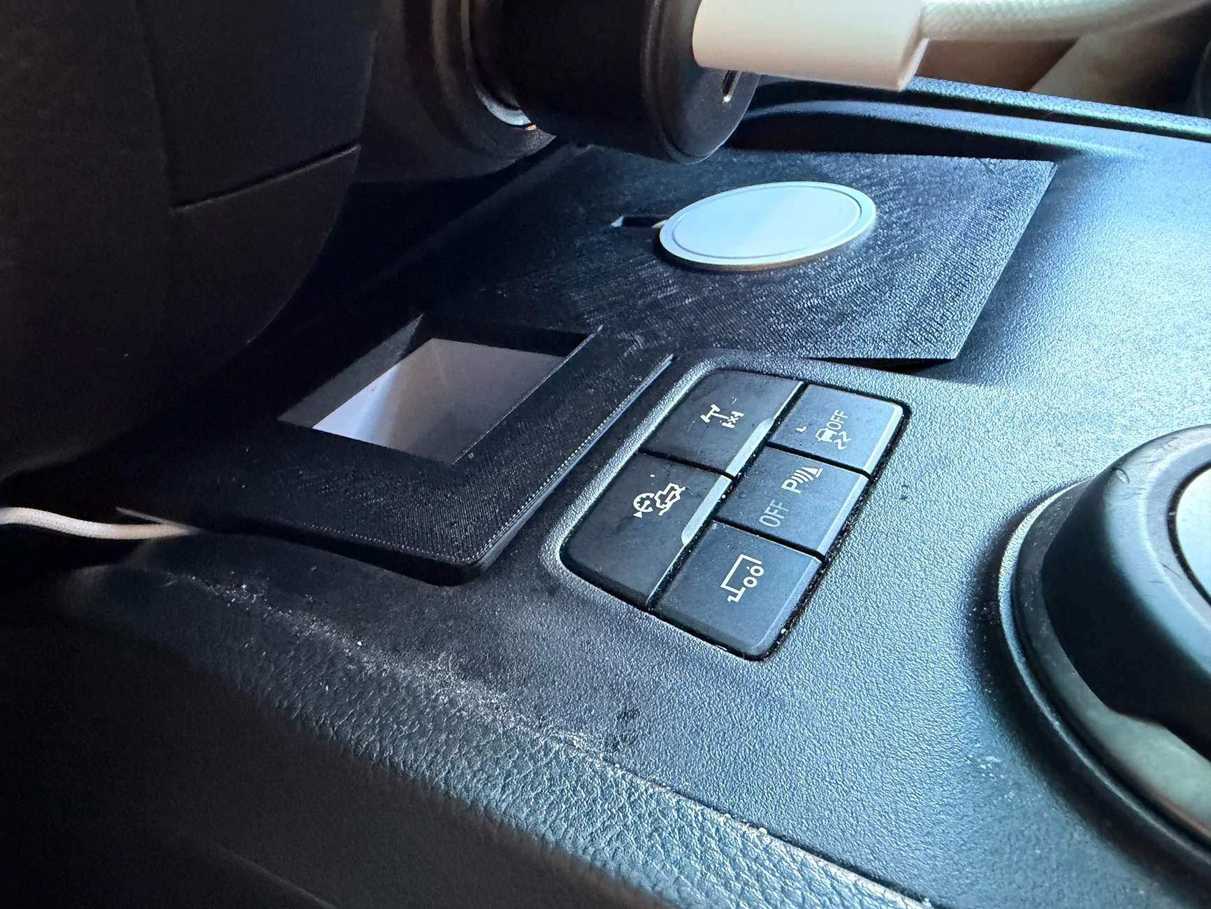

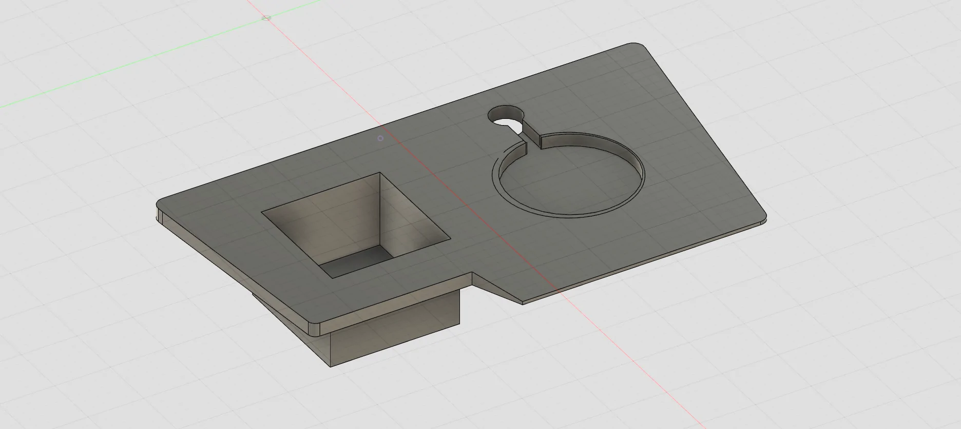

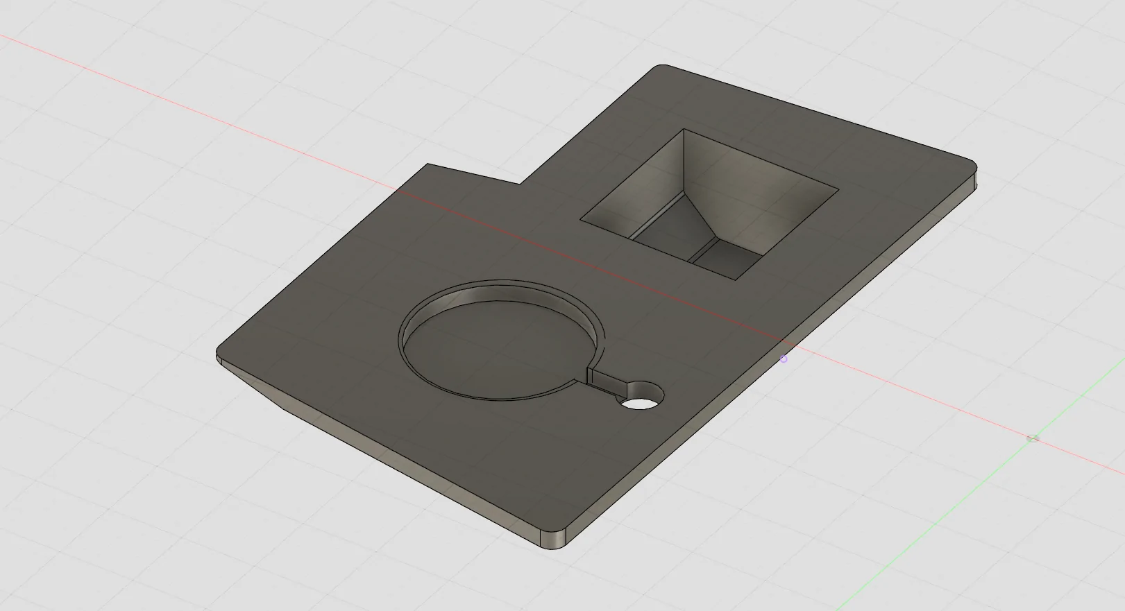

playing with a couple designs, I am also looking at a couple different chargers, and seeing how it would be to adopt this design to use other chargers.
I am on the fence about the tension design, there are complex tabs that make you push it down to grip the sides of the interior tray.
But I scaled down the original design about 3% (so it can fit on more build plates) and also it still sits on the ledge on of the cubby.
And it stayed in placed when testing slides, still fine. My concern is picking up the phone, and the magsafe strength might pick up the print. I was thinking maybe just run 3M double side tape on the bottom and call it good. Still deciding.

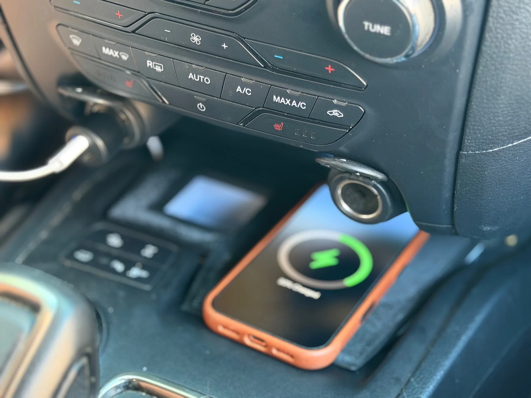

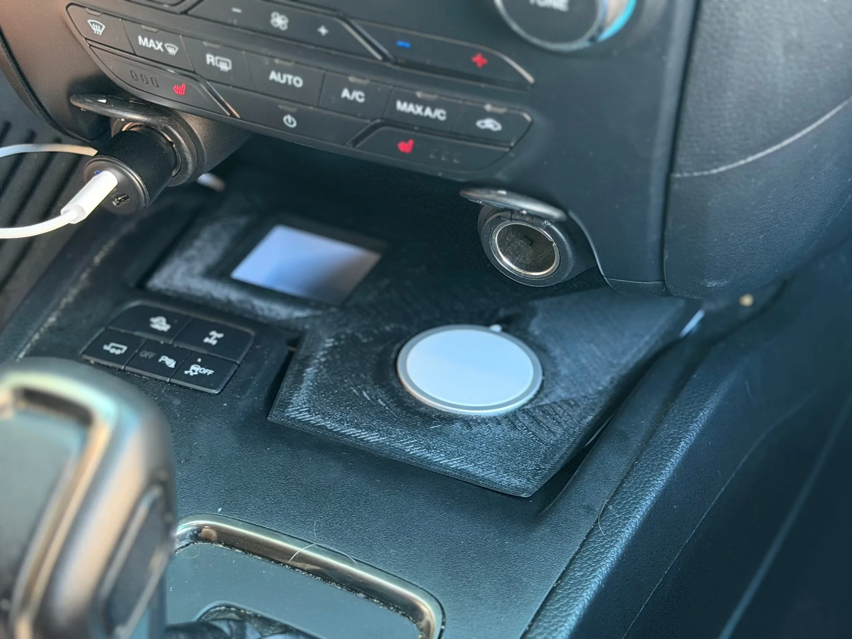

I extended the arm to more up the hump. And pushed the puck out more, that is pretty close to I think the “good enough to try it” phase.
at this moment I put one piece of 3M double sticky tape right at that slope. Just a little more hold when you pickup from the plate.

Also one thing to note, I have been testing with the newest generation of magsafe puck, its type C charging, and has a braided cable. The generation before that is slightly different size. My design can be adapted to match any of these chargers pretty quickly. I have been thinking about doing the best qi2 one I can find. I havent looked too much into them, seemed like the anker ones are good. I am interested in the idea of them being active cooled but will have to see if that changes how I can press fit them in.

Yeah, no access to the ports has been on my mind. I personally have had really good luck with their wireless carplay, I havent had to mess with it months, so my use case doesnt have a reason for it. Also I believe that is why the last design was an attempt of a press fit.
I was thinking of three options
- USB toggle switch, they make them in short runs, I could have the button on the 3D pad, and its plugged into the car USB port, and the other end the wireless adapter. But that will only let you basically do a power cycle, not a swap or anything.
- I could also surface mount a couple USB ports to the 3D tray, that plug in out it. That will solve the issue of port access, however that eliminates the clean look.
Also I would strongly suggest against the upper tray, that thing is a heat magnet, and it will cook that phone, when current phones already have issues with thermal management. That spot would be an easy place to test it, set a pad up there, and then sticky it and test it, and use it awhile.
