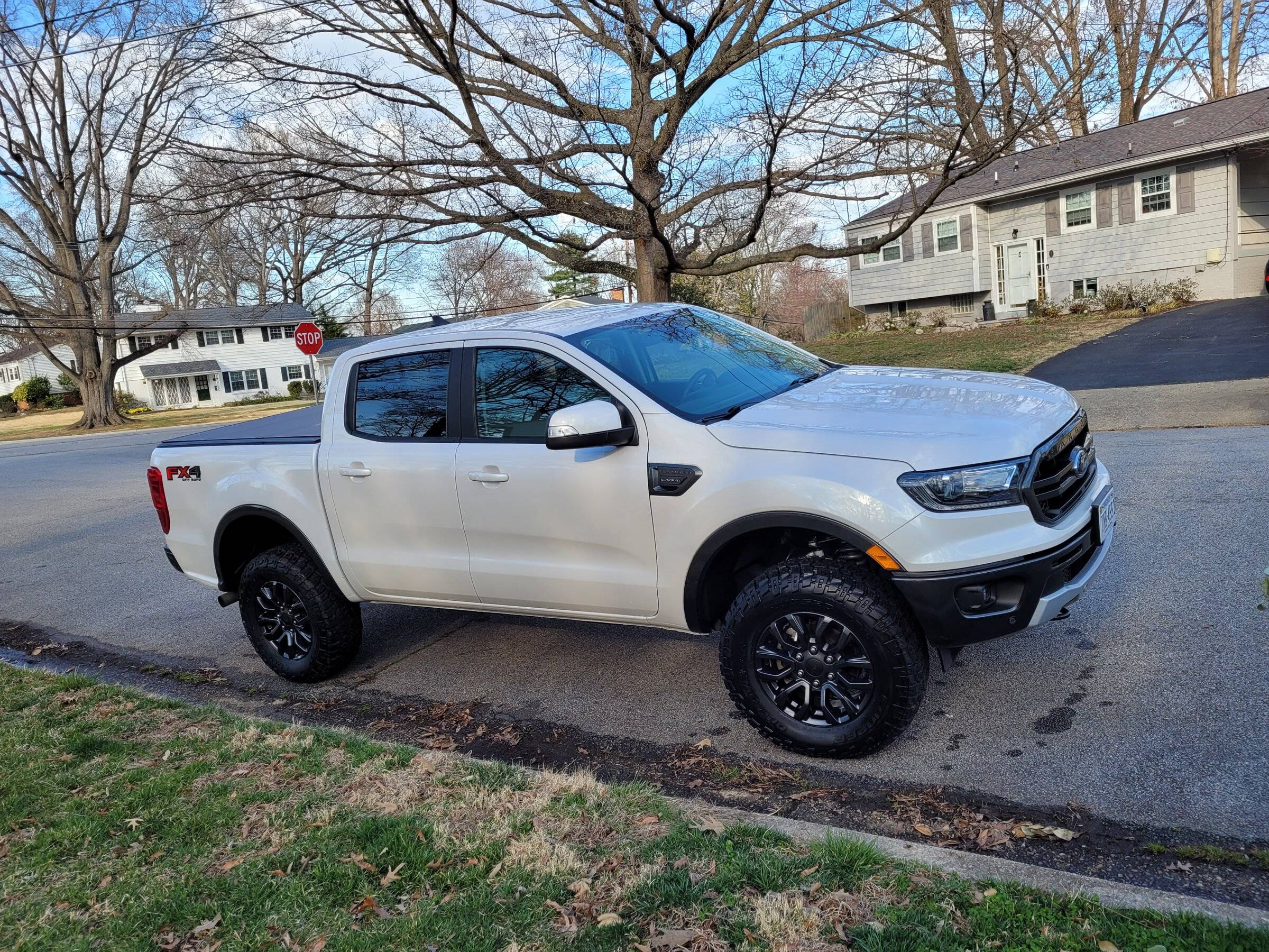

Icon UCAs, Eibach 2.0 pro truck coilovers front set at 2.5 inches of lift, extended Eibach shocks with 1" blocks in rear to keep some rake. I may upgrade to
multileaf down the road but the current setup is working very well for me now. Rides 200% better than stock fx4 . Firm but controled, minimal body roll and brake dive.

Todd, thanks, I figured it was either Icon UCA or the multi-leaf springs. I am still hoping to hear from somebody who installed the multi-leaf springs and how things worked out. Your truck looks great and, as you say, rides great now too!

Nope, just the shocks and 1" blocks. But if I was to do it today I would upgrade the leafs instead of blocks. But the blocks gave me the stance/rake I wanted and do let me use the extra inch of shock travel the Eibach have over fx4 stock.
