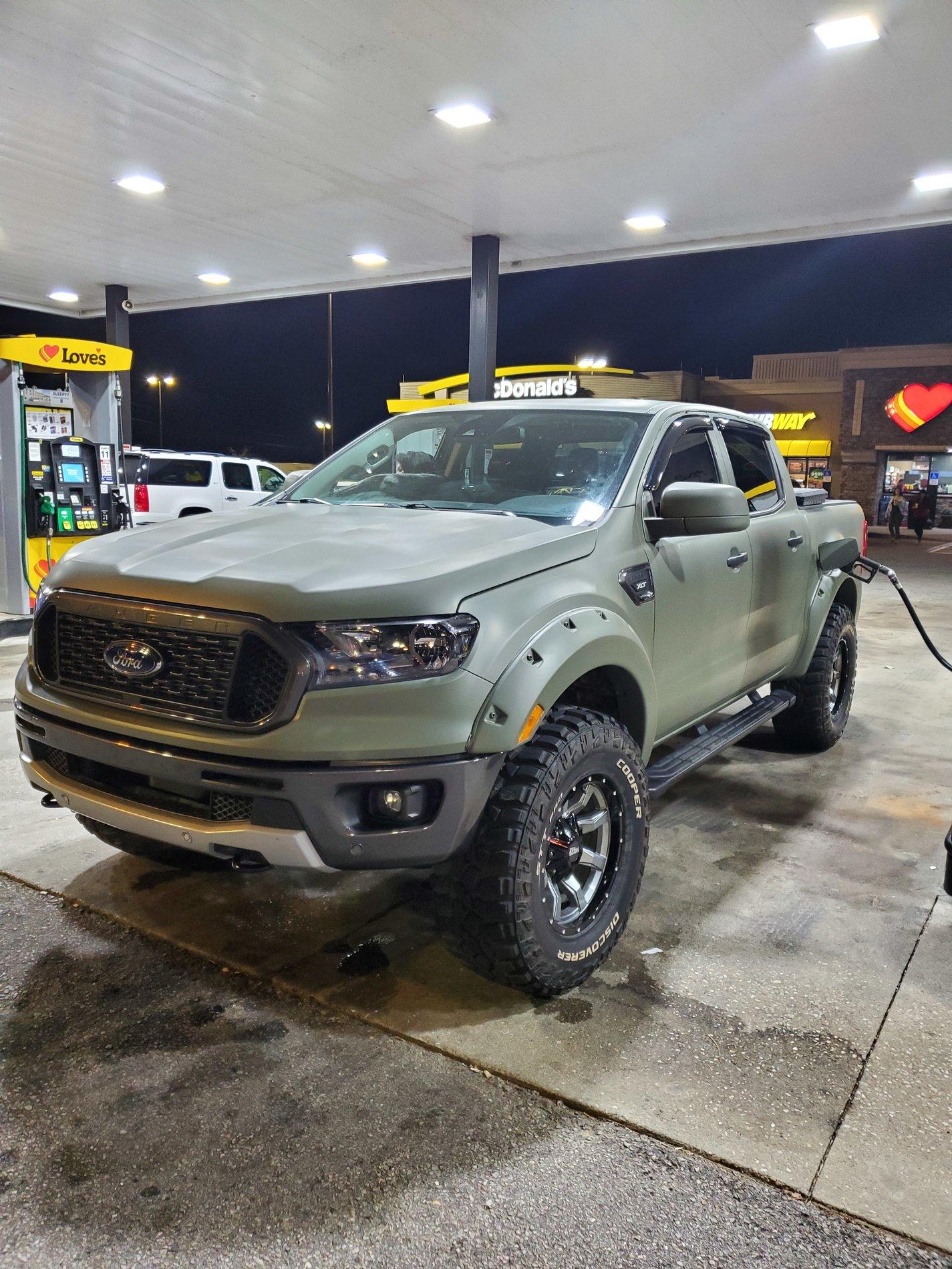

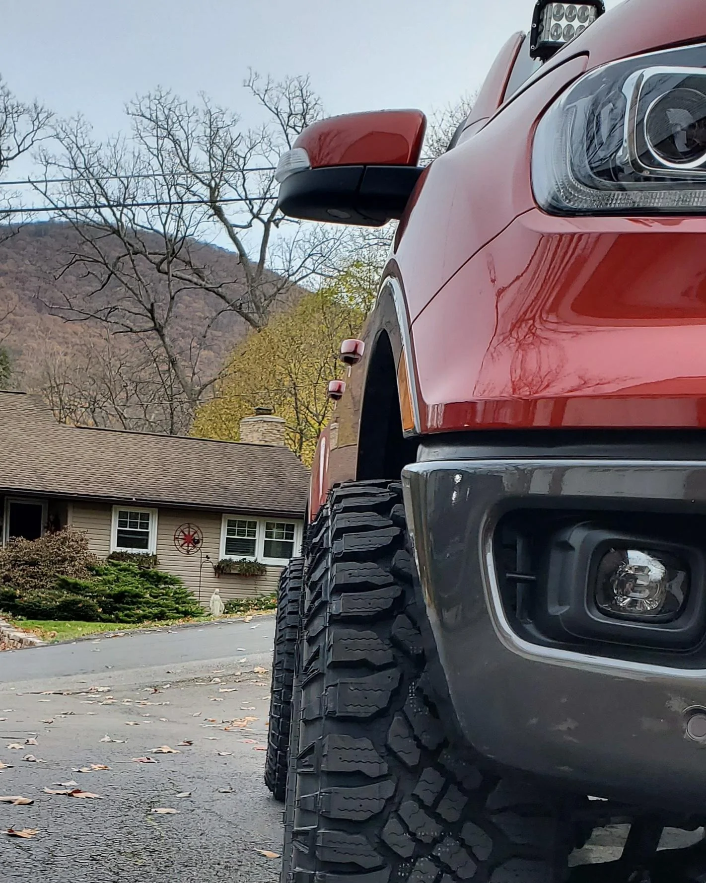

Here's 17x9 on a negative 12 offset venomrex wheel. I personally love it.
Any rubbing or trimming? How close of a tolerance before a rub?

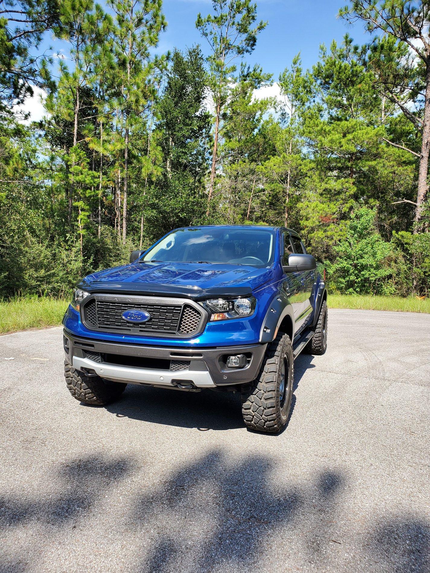

I’ve got a -12mm offset for my 17x9 wheels with 285/70R17 tires and think it looks great, especially with the Bushwacker fender flares. Had to do some minor trimming but gives it an aggressive, Raptor-like look in my opinion.
Trimming? Are we talking crash bars only?

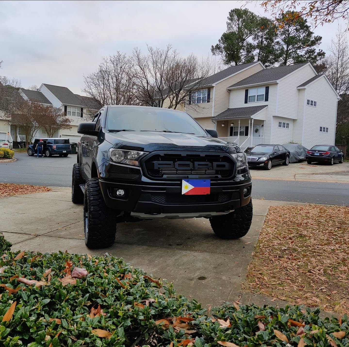

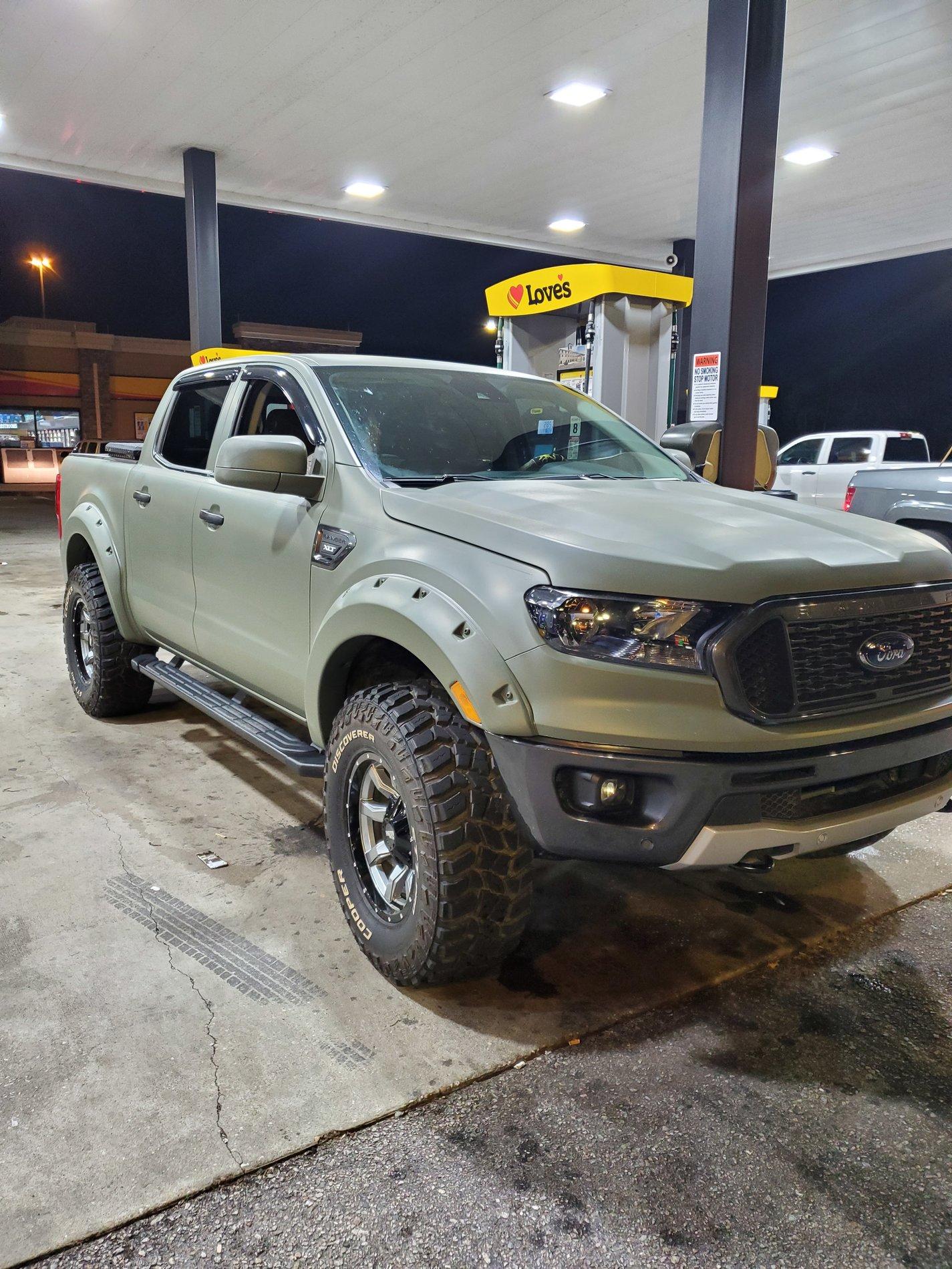

20Ă—10 -24 offset Moto Metal Mo970
285/55/r20 Patagonia Milestar M/T
Front crash bar delete
Front fender liner slight trim towards rear
Slight trim on the rear bottom inner fender flares

I'd say a couple inches from the fender flares. Wanted to go with something aggressive but not to aggressive.

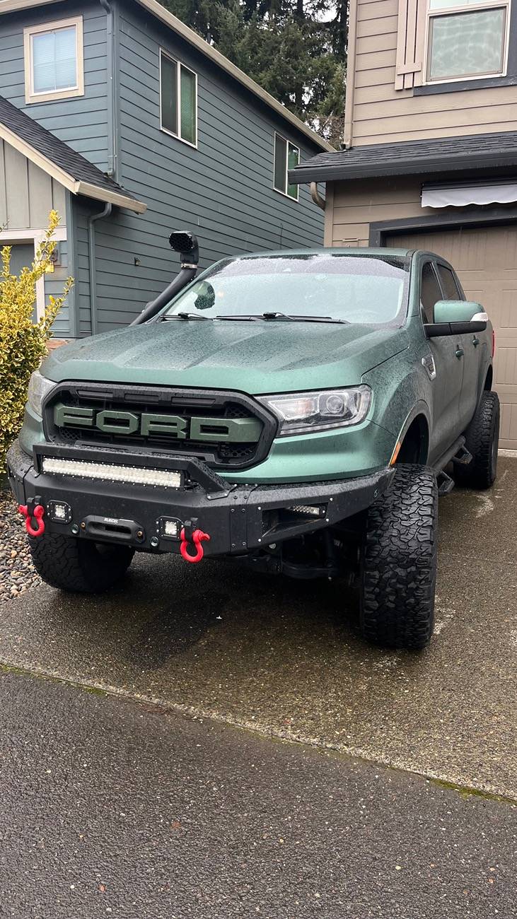

Here is my 35” on fuel 17” with RC 6” and 1.5” wheel spacers. Thinking about going with 17x10 -40 35”x13.50, next without wheel spacers. Hoping for them to not stick out as much without spacers but over all pretty good set up. It’s nice to be able to see your wheels when wheeling.

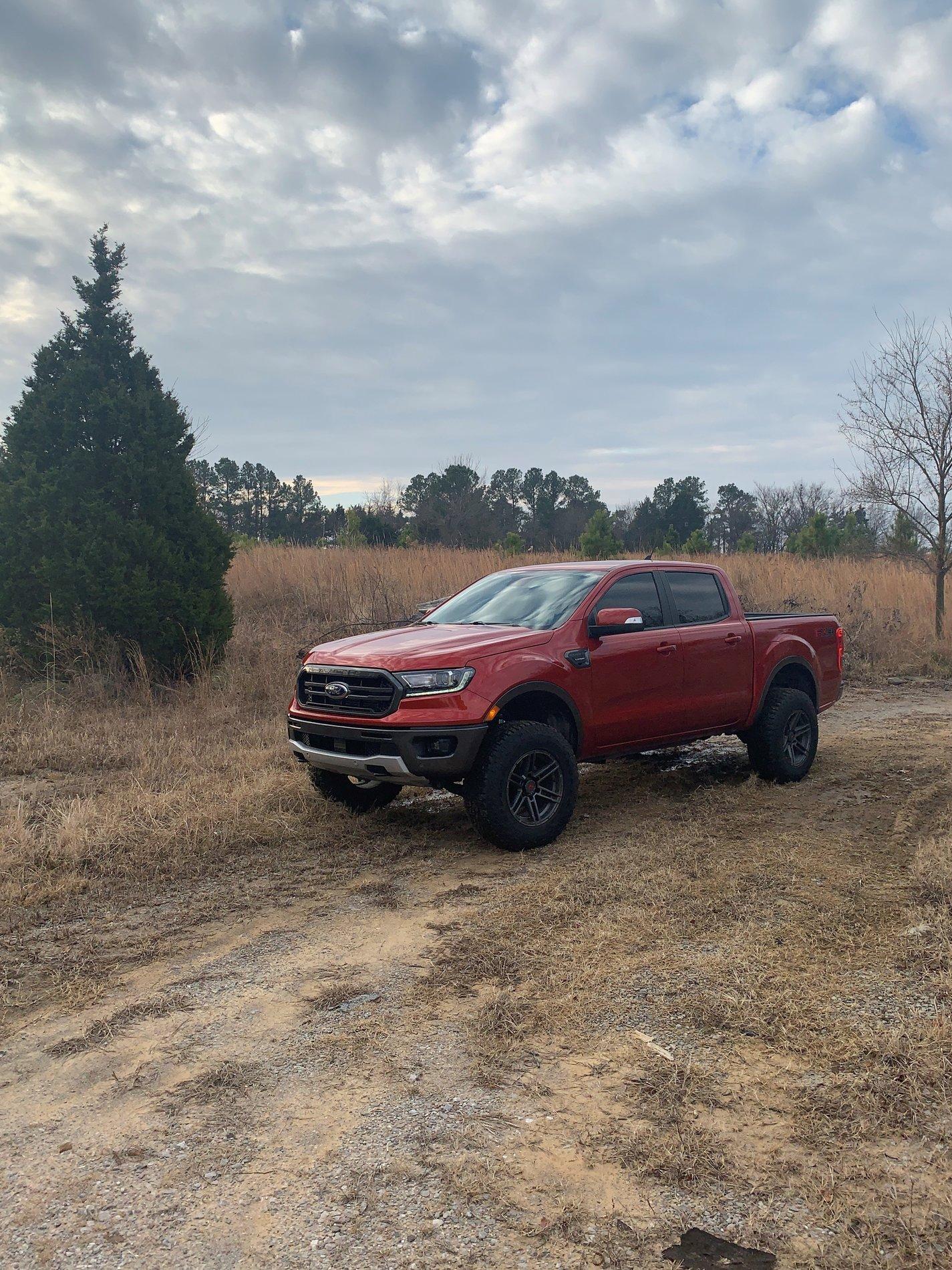

Agree… When I was looking at wheels, I was told if you go much past 0 offset you negate the affect of having offset wheels at all. You go from gaining clearance to losing clearance. I have a 3.5” lift and went with +12 offset on 33” tires, they stick out about 2” past the fenders. Any more and I’d have to downsize tires because they would rub the bumper when turning.
I put +25 offset wheels on the wife’s Ranger and the tires are pretty much flush with the fenders. They stick out maybe 1/2” at most. Hers has a leveling kit and 32” tires.
(Disclaimer: I’m not a wheel expert lol I’m just going by what I was told at a wheel/tire shop.) I’m happy with my setup. Gives the truck a more aggressive look but the tires don’t stick out obnoxiously far. Guess it really depends on personal preference and what you want your truck to look like.
