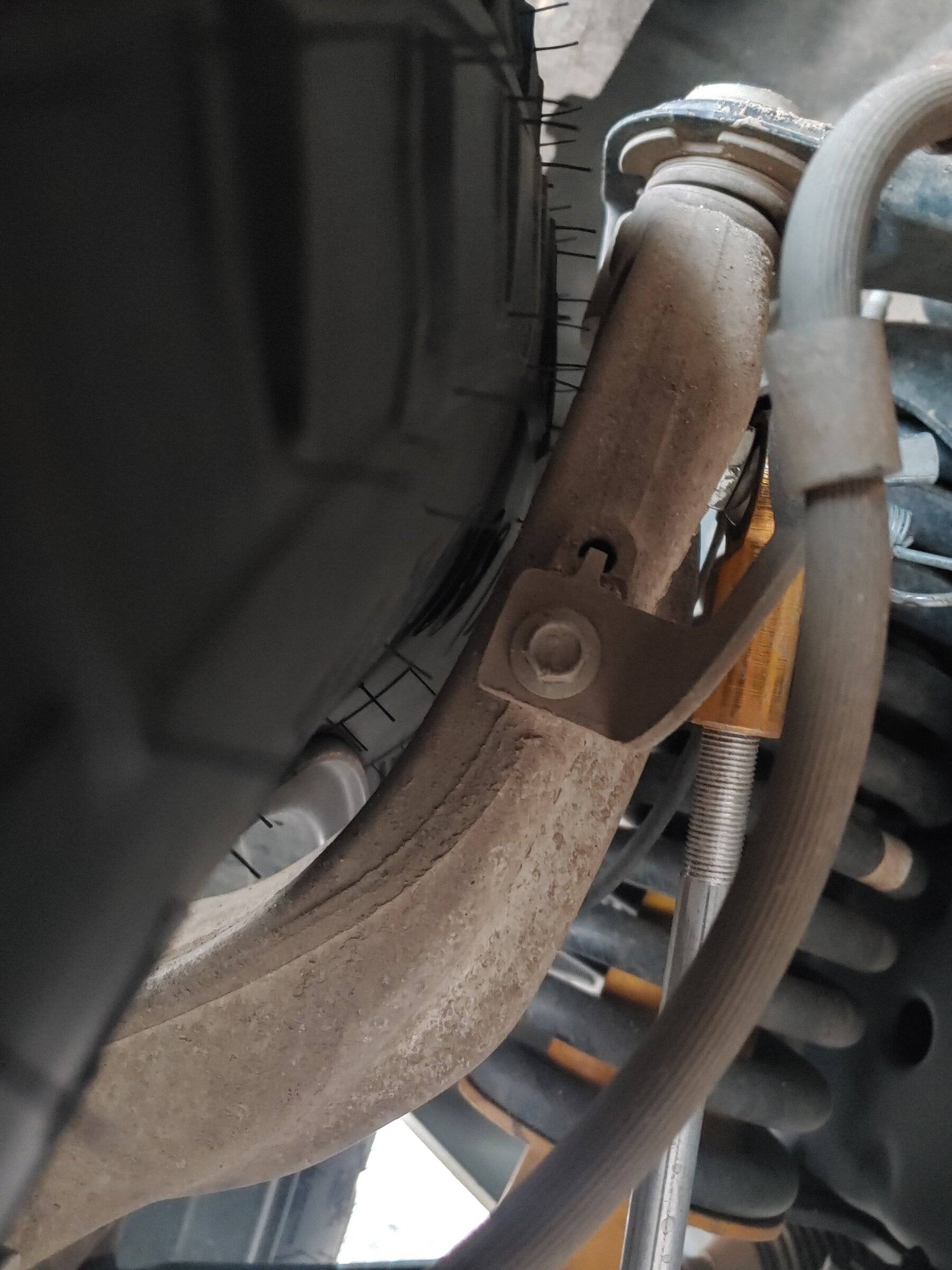

With a tire that big and a wheel offset like that even with a chrashbar change or delete you still run a big chance of rubbing.
Mind you I have 285/70-17 Firestone Destination XT's on the factory sport wheels with no spacers and the Old Man EMU lift. Do I rub when turning? Only at full lock. Did I do anything to the crash bars? Yes. I removed the plastic covers up front and pushed the bars forward. It worked well too.
Thanks for the pics
