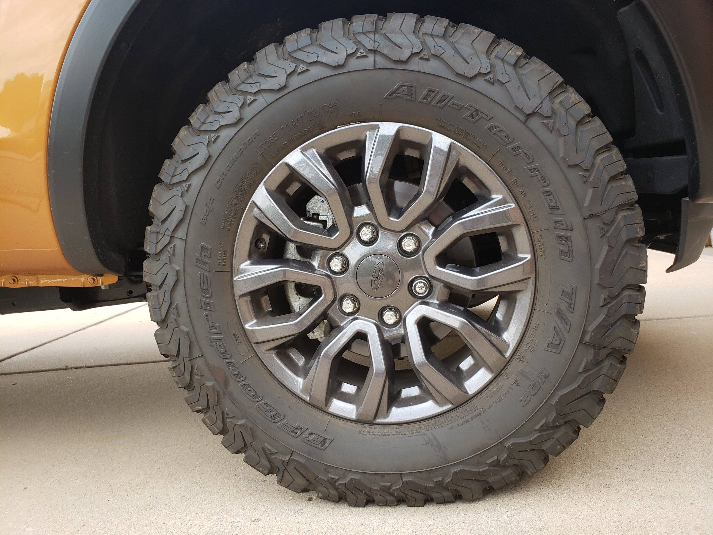

Lots of pros and cons about using wheel locks. Some use, some don't. Everyone knows that a thief can get a wheel off if they choose to. I use Gorilla locks with the hope that they will be a deterrent for stealing. My 1st safeguard is to always park in the safest appearing place possible to help detract theft.
