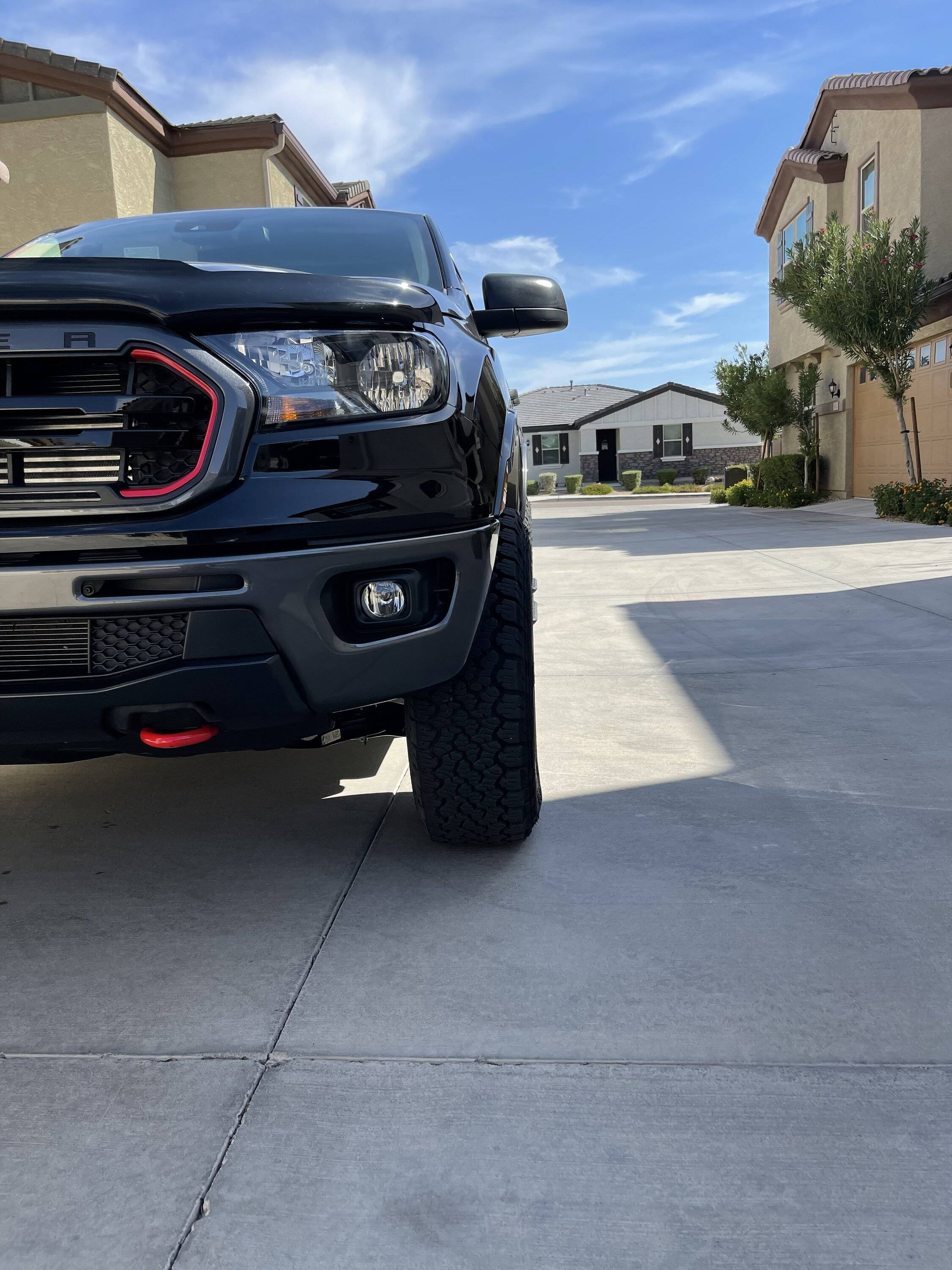

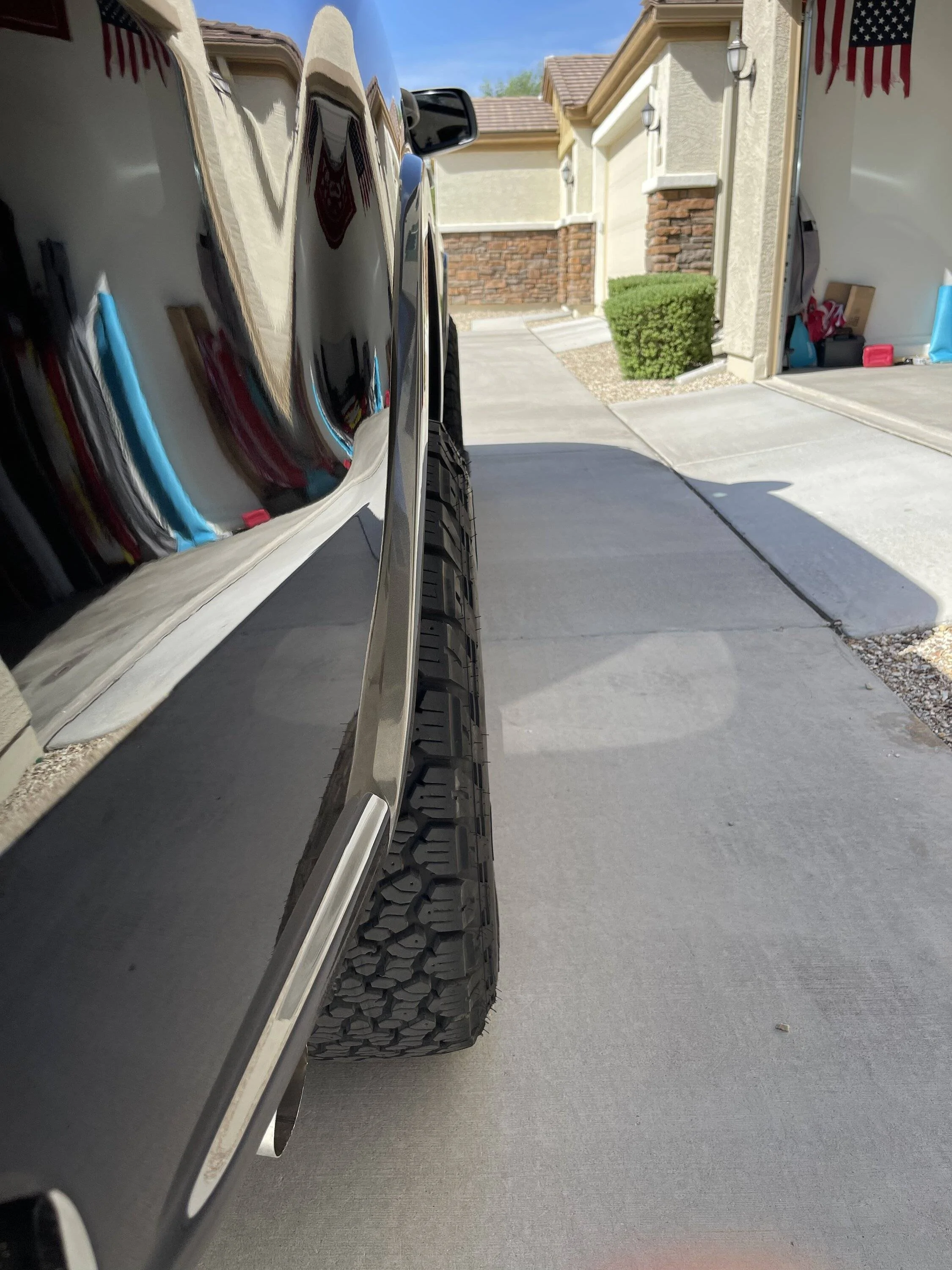

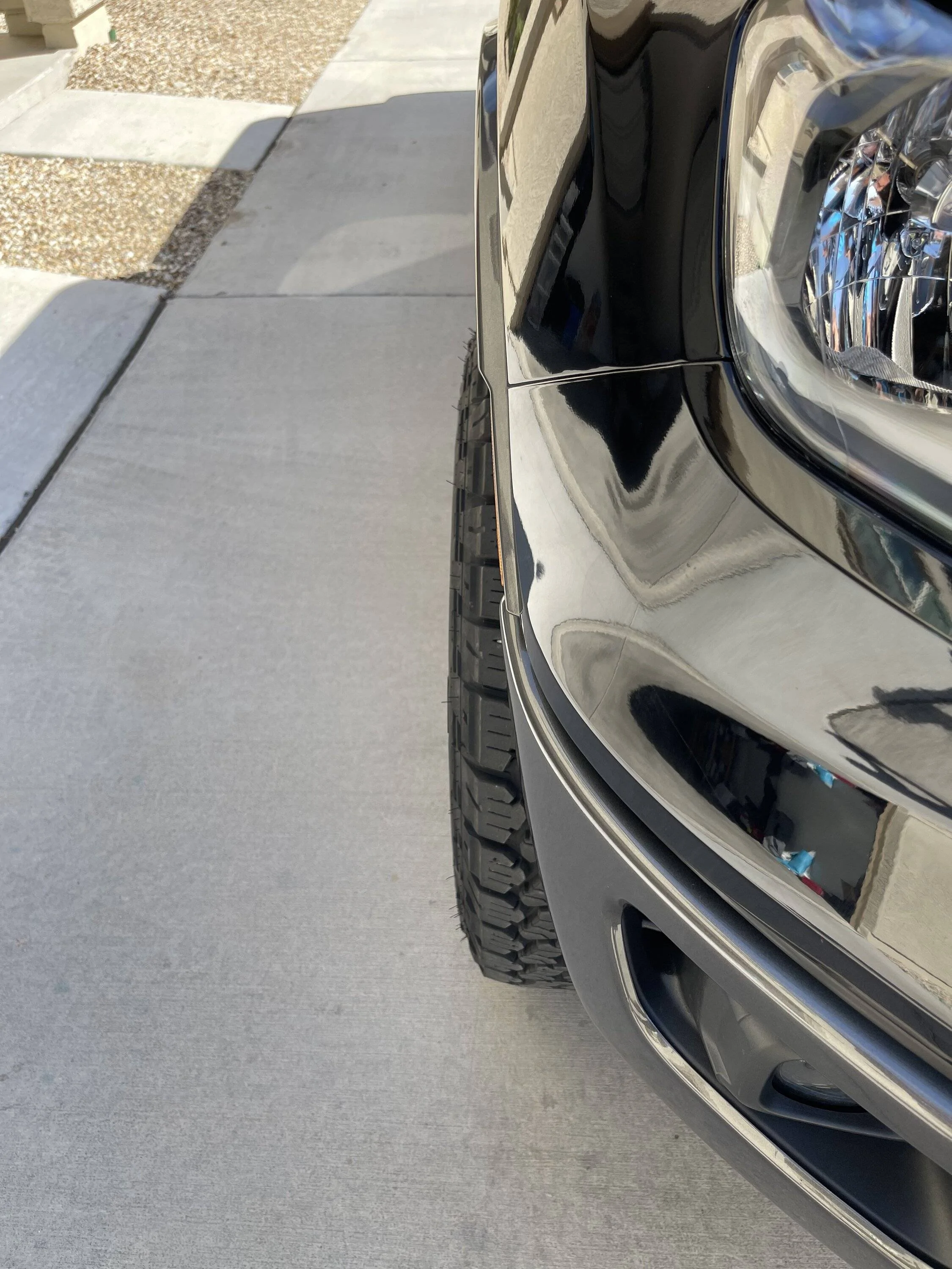

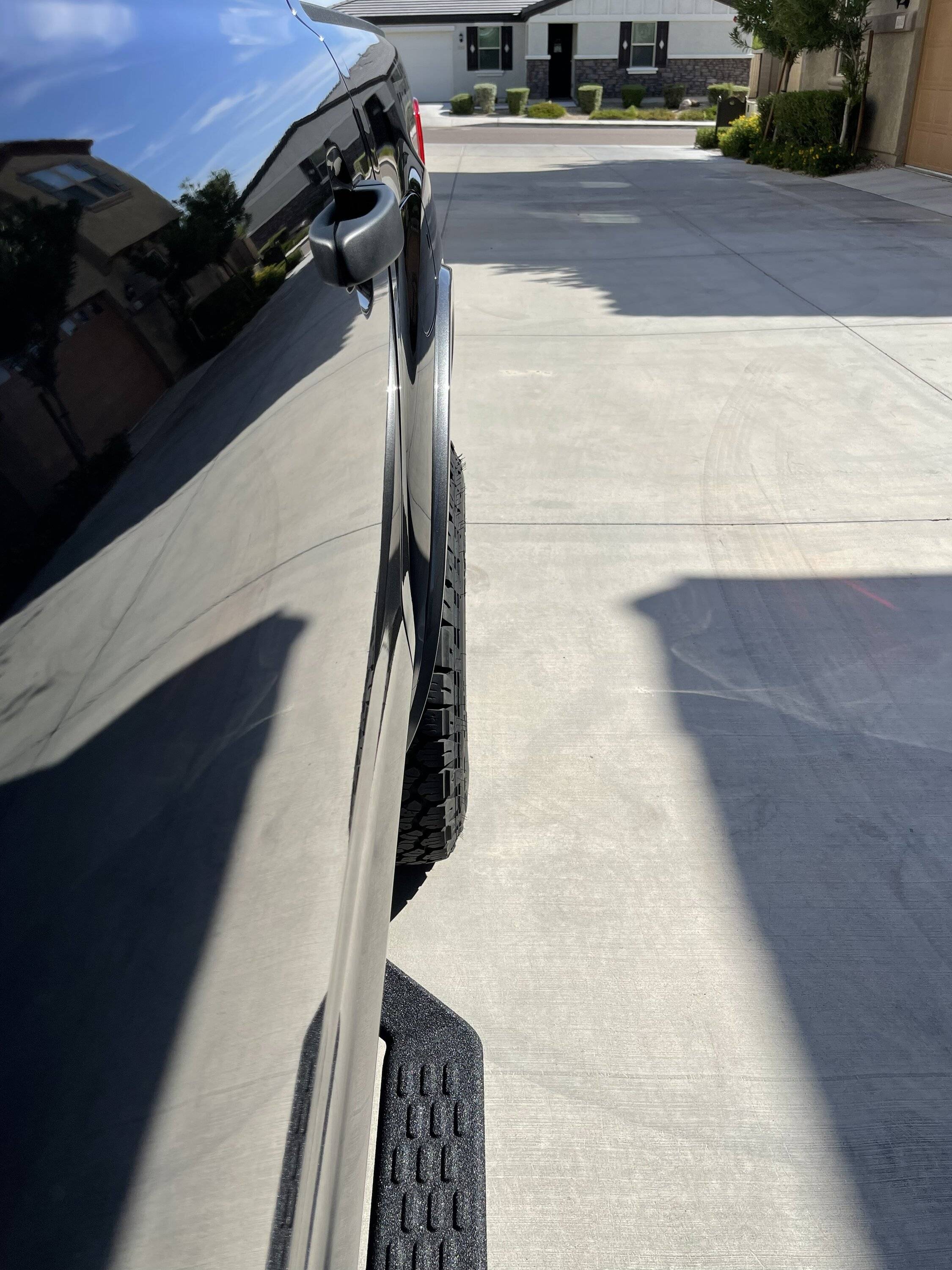

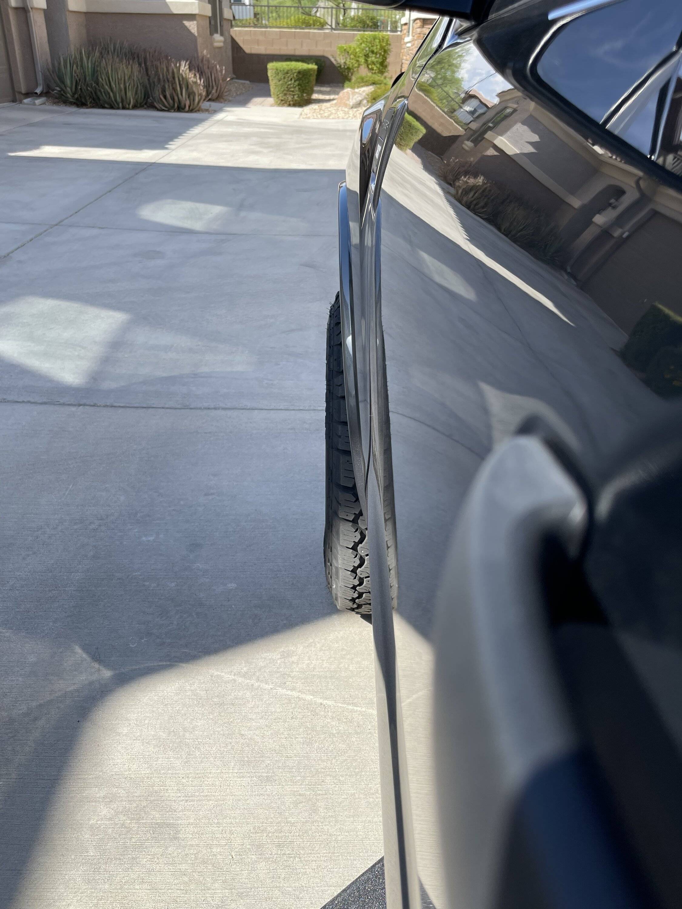

Slapped some new shoes on it that I got from @Ian-NH the end of last week.
-18 offset 18x9 method mr316s wrapped in 275/65 general grabbers.
Got a wicked good deal, thanks man!
I’m pretty sure you meant +18mm offset, right?
