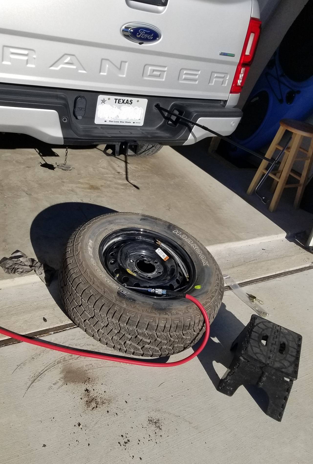

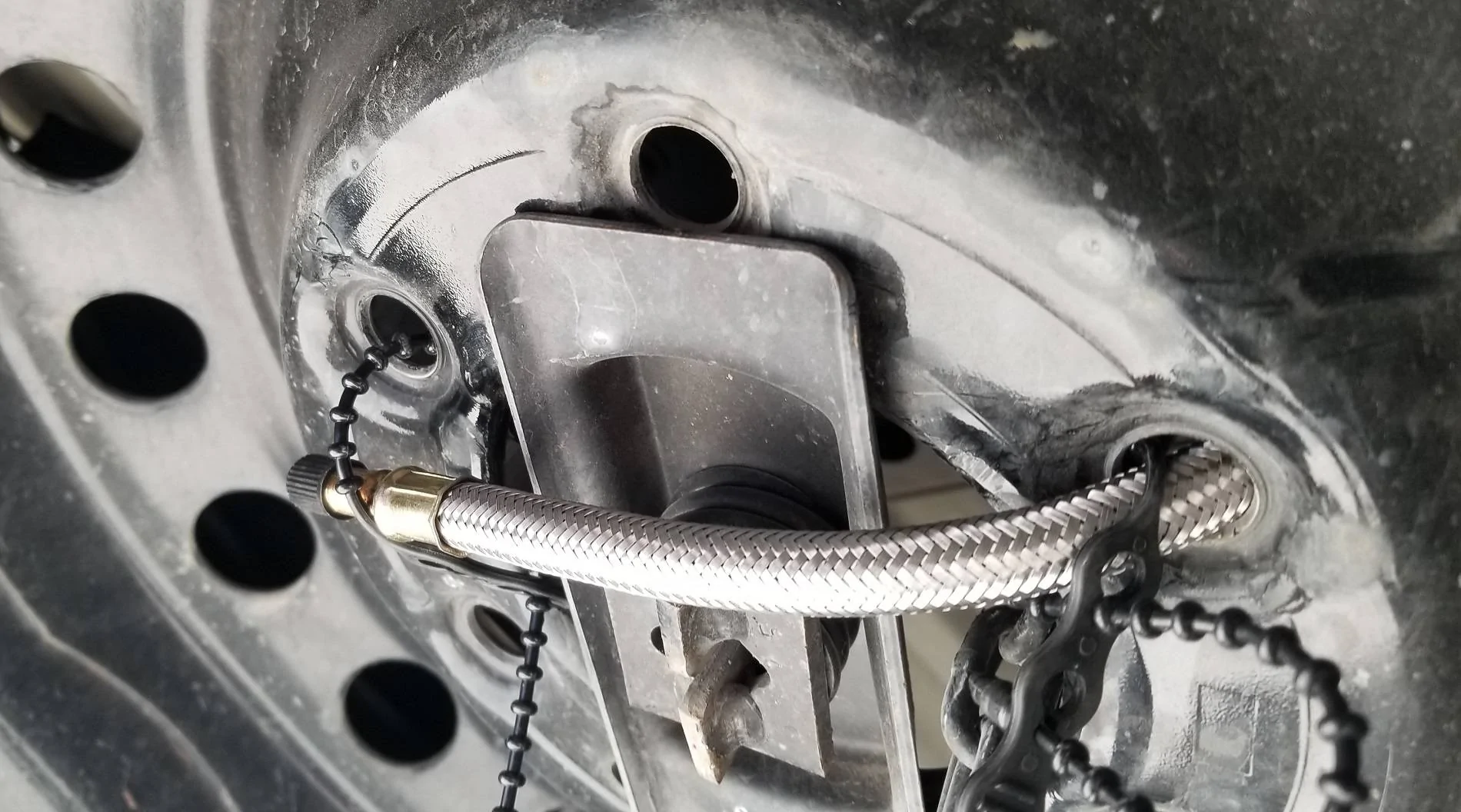

I've never lowered my spare tire and was curious how the process worked. I also thought it was time to see what the pressure was in the spare. I was surprised to see that it was only at 20 psi. So, regular checking of spare air is now on the schedule.
I'm guessing that Ford wants that valve stem stowed upwards to keep it safe from road debris impact. But, that means having to lower the tire to check the air. So, I bought a 12" braided extension and routed it through a lug hole. So, I can now check the air pressure easily and that valve stem remains tucked up in a safe, impact-free area. Temporary zip ties keep the extension from flopping around. Nifty.

Great, simple and very well thought mod. I am thinking to reverse my spare, use that wheel for some storage but now I have to protect the stem, never thought of that reason the rim is facing upside, other than Ford reducing cost on a few chain links.
Like others have done on here, I flipped mine over when I upgraded wheels and tires. We get a lot of gunk on our roads especially in winter and I really didn't like how the stock orientation is perfectly suited for holding a lot of it in the wheel. I figure the risk of valve stem damage is almost nil, and would rather have that as the con.

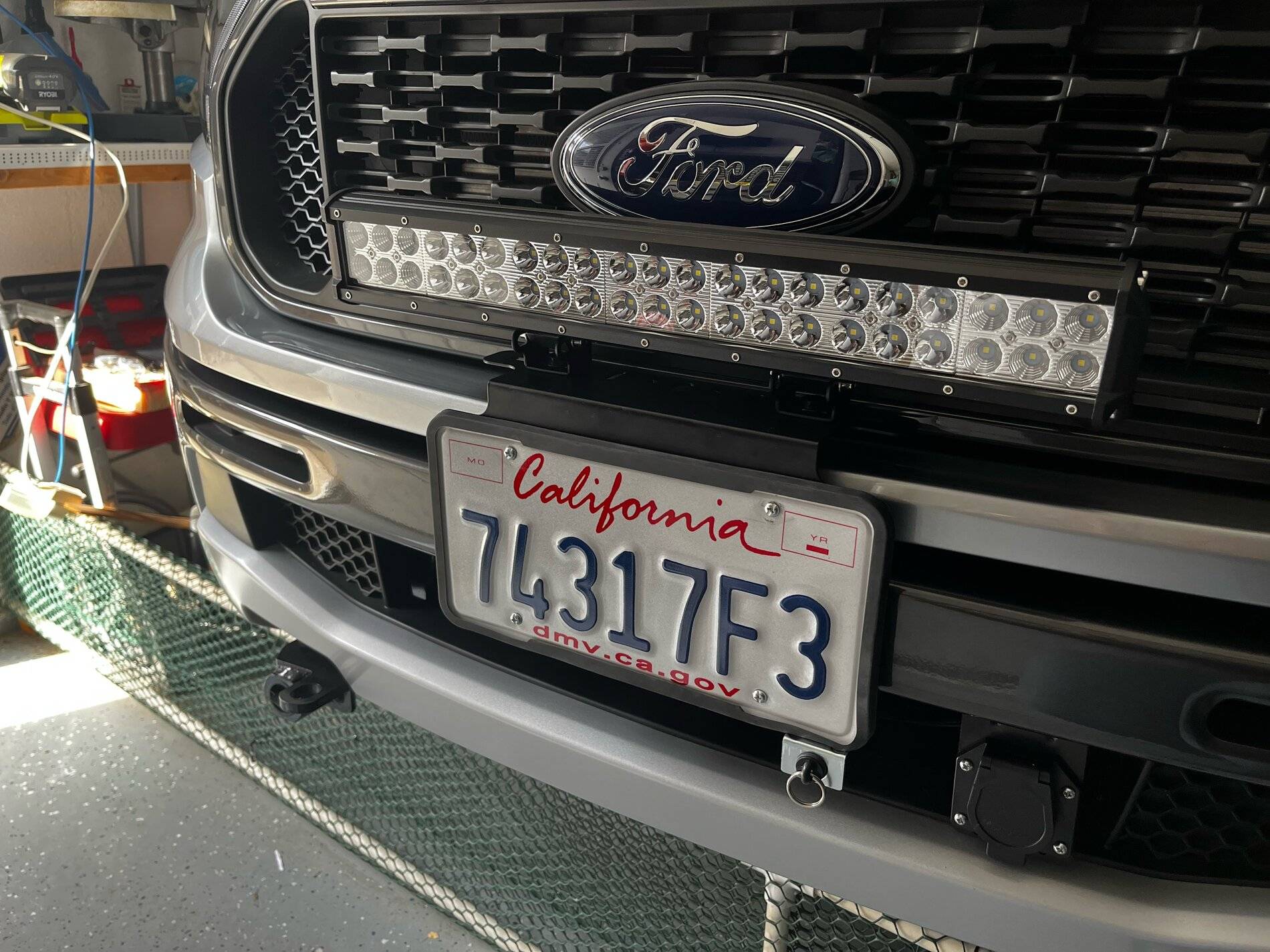

Got my Lightbar on, used a Lic plate bracket, I was surprised at how strong it was. still have fog and ditch lights to install. Using a wireless remote switch with 4 circuits so have to use them all!
Hey Jesse,
Is that some kind of towing Dead Man switch at the corner of the license plate? Also, what’s that low “guard“ for? Leaves? Critters? Mother’-in-law?
Oh yeah, love that epoxy floor. ?

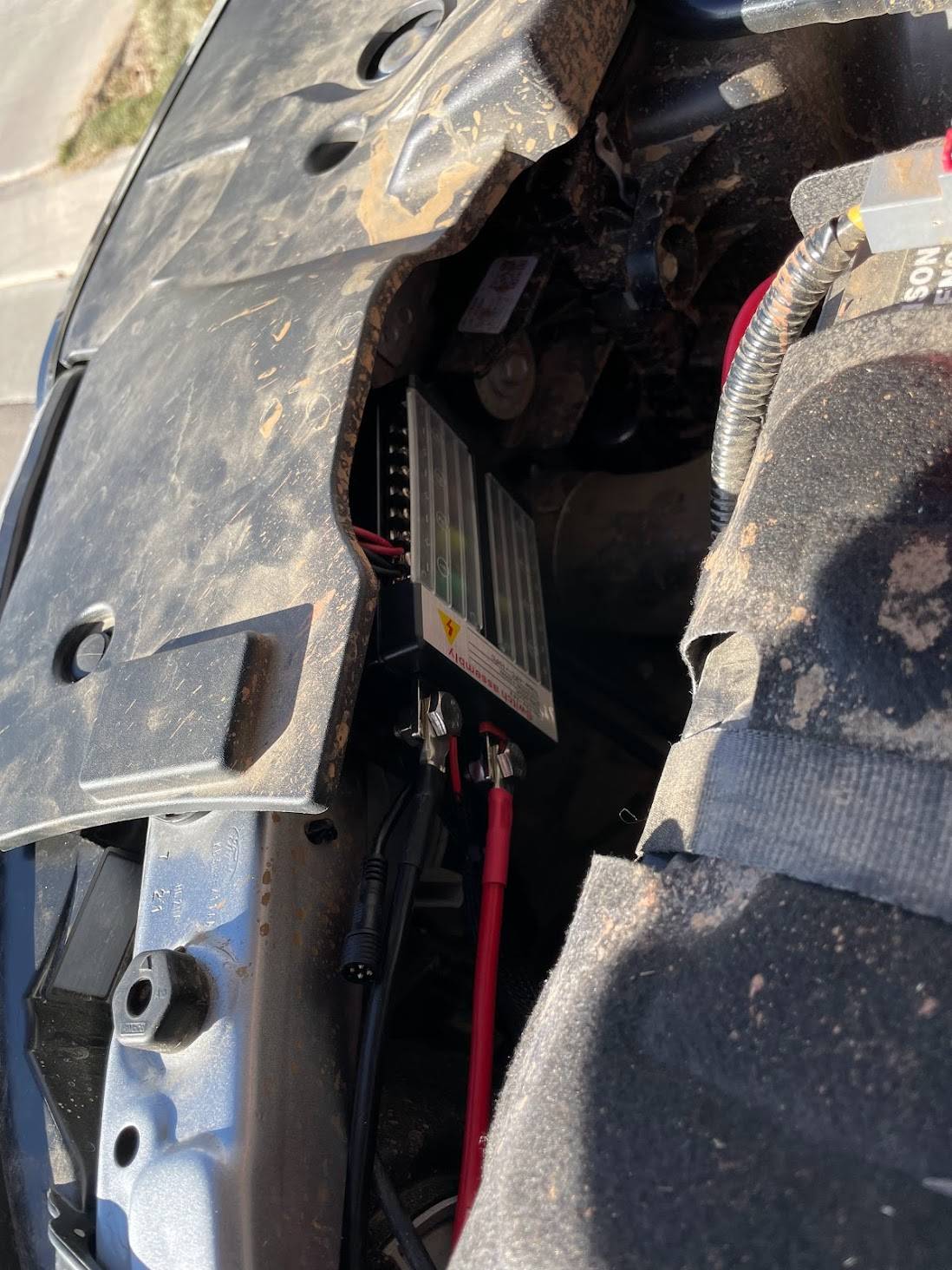

I installed the Auxbeam 8 Gang. This isn't the finished product. I put the cover back on before I took another photo. I also broke the cable that goes to the controller trying to get it through the firewall. Ordered a new one so I can try again...

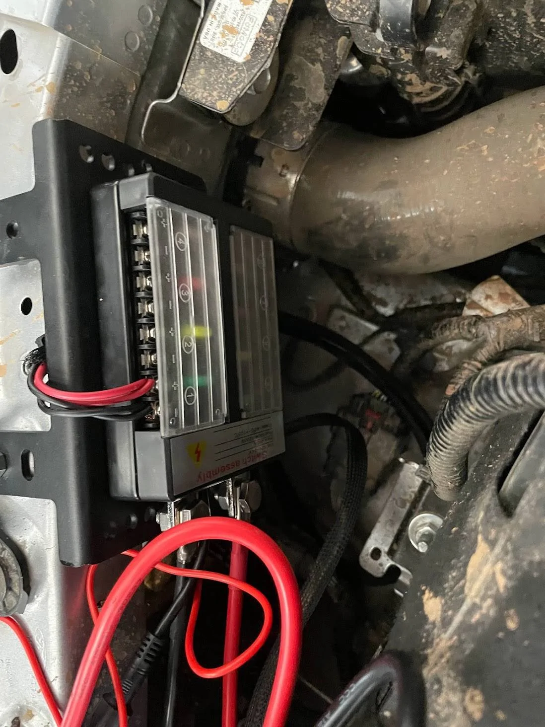

This is how it looks under the cover. I will have to take the cover to wire up new accessories, as I add them, but I think it's worth it.
Hope you spit some fluid film in those exposed connector terminals up top.

Hey Jesse,
Yep, dead man switch, called a break-away switch in RV speak, applies the trucks brakes if the tow bar separates. That 'low guard' is to keep the doggies from running out into the street when I am working in the garage. I did the epoxy floor covering with a home depot kit, has lasted great for several years, nothing will stain it and oil wipes right up.
