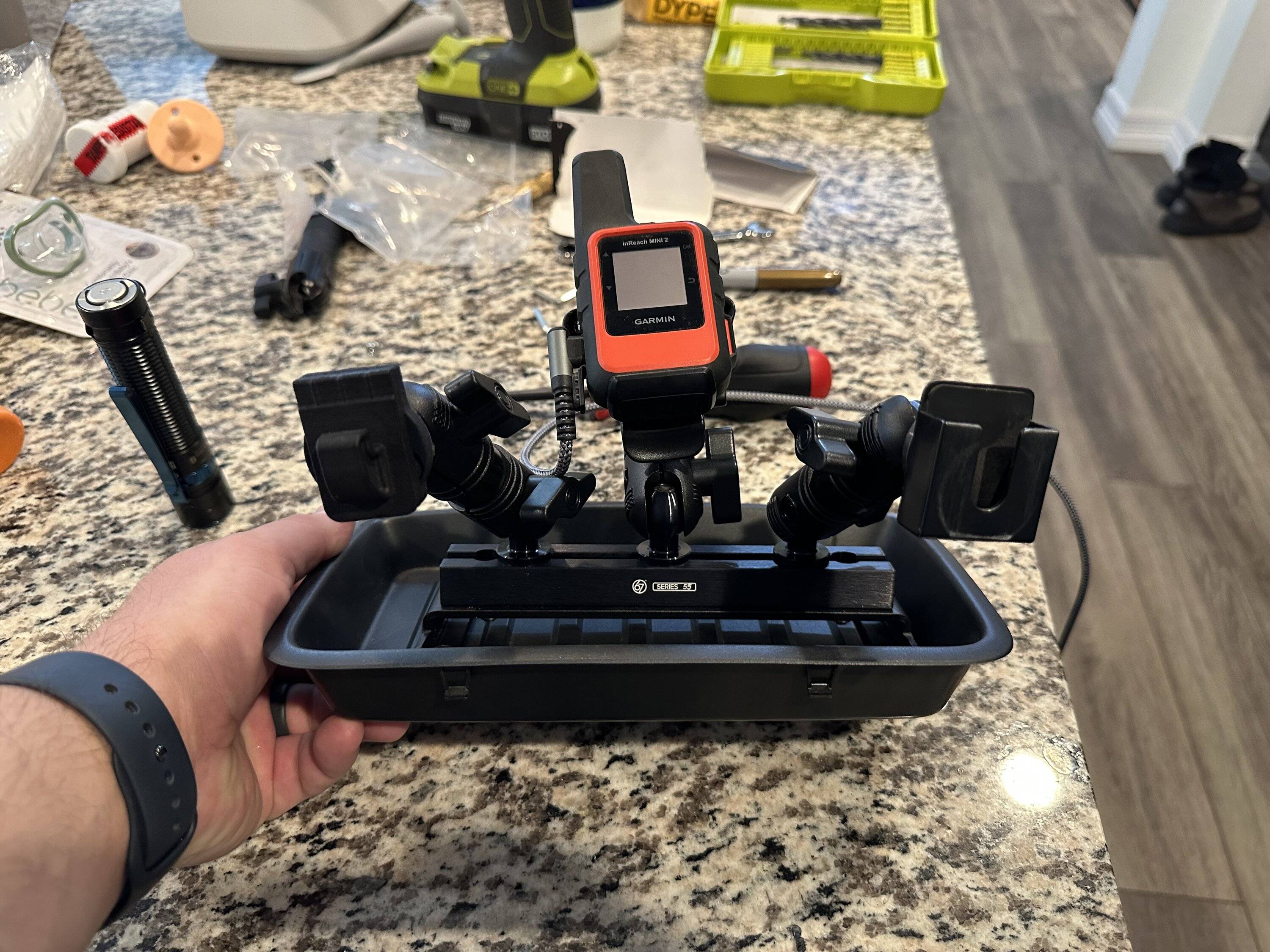

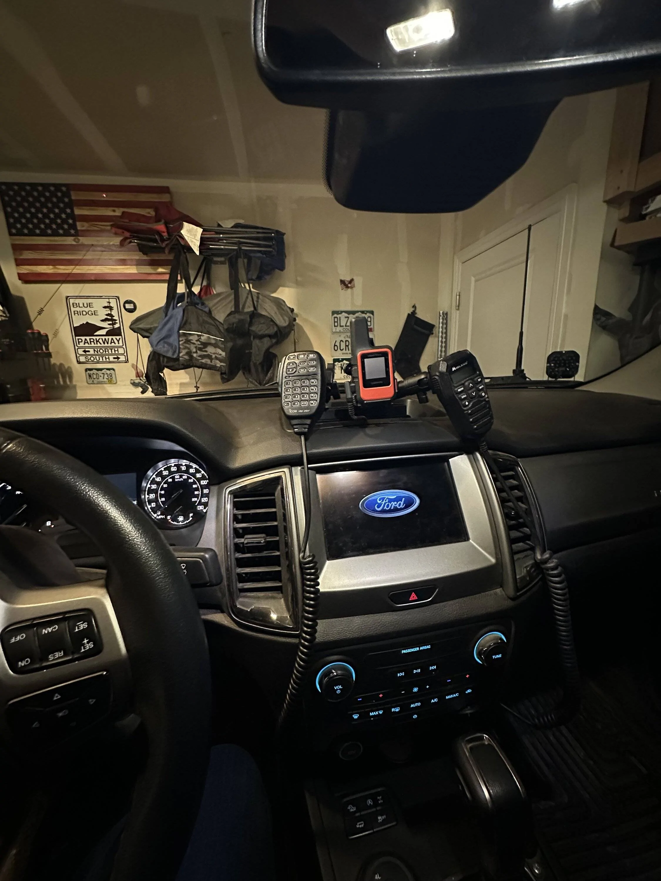

I needed a way to mount my GMRS mic, HAM mic, and inReach Mini 2 out of the way. Dash tray was the only thing I could think of, so... here is the new dash tray. The rail is 67 Designs, the arms are 1 cm Bullet Point Mounting Solutions, the left mic mount is from Jeep Uniq, and the right mount is from Bullet Point. The Icom 2730 uses a hook style mount while the Midland MXT 275 uses a button style mic mount.
Here is the whole setup reinstalled in the truck. The inReach does have power ran to it. This does not obscure my view out the front, even though this picture makes it look like it does. I just took a nice long drive to sell my old bed rack and had no vision concerns.

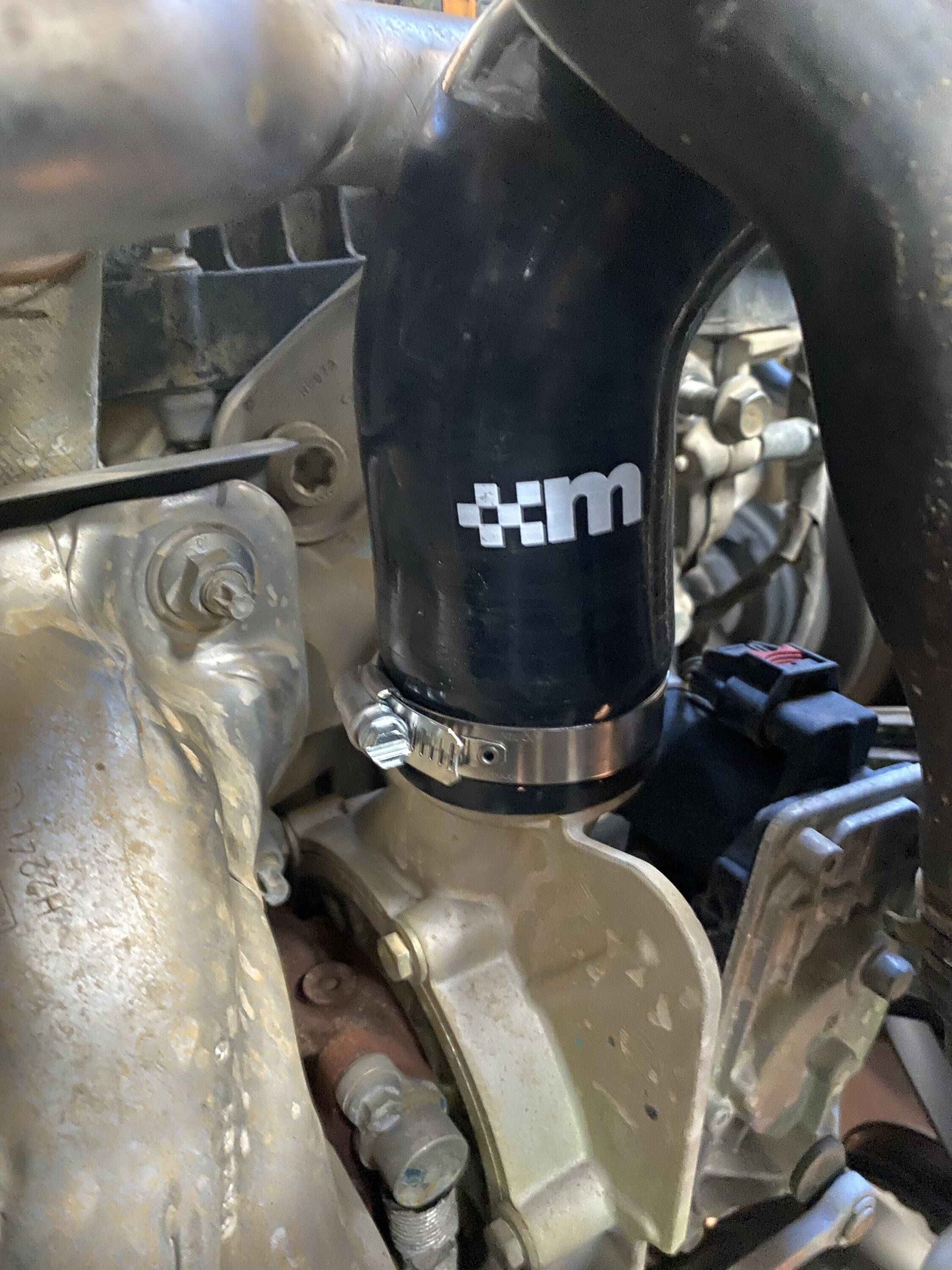

That we are ? Hi today during the install was 77°.
Intercooler came with their boost hoses. Unlike other brands that use a hard pipe on the hot and cold side, the Mountune uses a hard pipe in the section with the BOV. From then on to the Intercooler and the cold side it’ll be a reinforced hose.
I'm interested to hear what you think after you've driven it for a bit. I've been looking at charge pipes.
I don’t think there’s any downside to changing out the factory charge pipes for some aftermarket. Being able to give the air a smoother, less restrictive run to and out of the Intercooler is only a benefit.
I took a short drive yesterday to make sure all the connections held up. Got into boost quite a few times. From roll a as well as almost a complete stop. I didn’t initially feel a big difference until I put the shifter in S. While rolling around 30-35mph I got into WOT gradually and I certainly felt more of a push into my seat. Now everyone’s experience or feel may be different based on how their truck is built. I’m running 33” KO2 on method wheels, steel bed rack with roof top tent, prinsu rack with two awnings, and the Rigd Supply ultraswing with a spare method and KO2. So my truck has quite a bit of weight to it. Sound I couldn’t tell you much since I also run a Mishimoto Snorkel, so my truck already makes quite a bit of noise at WOT.

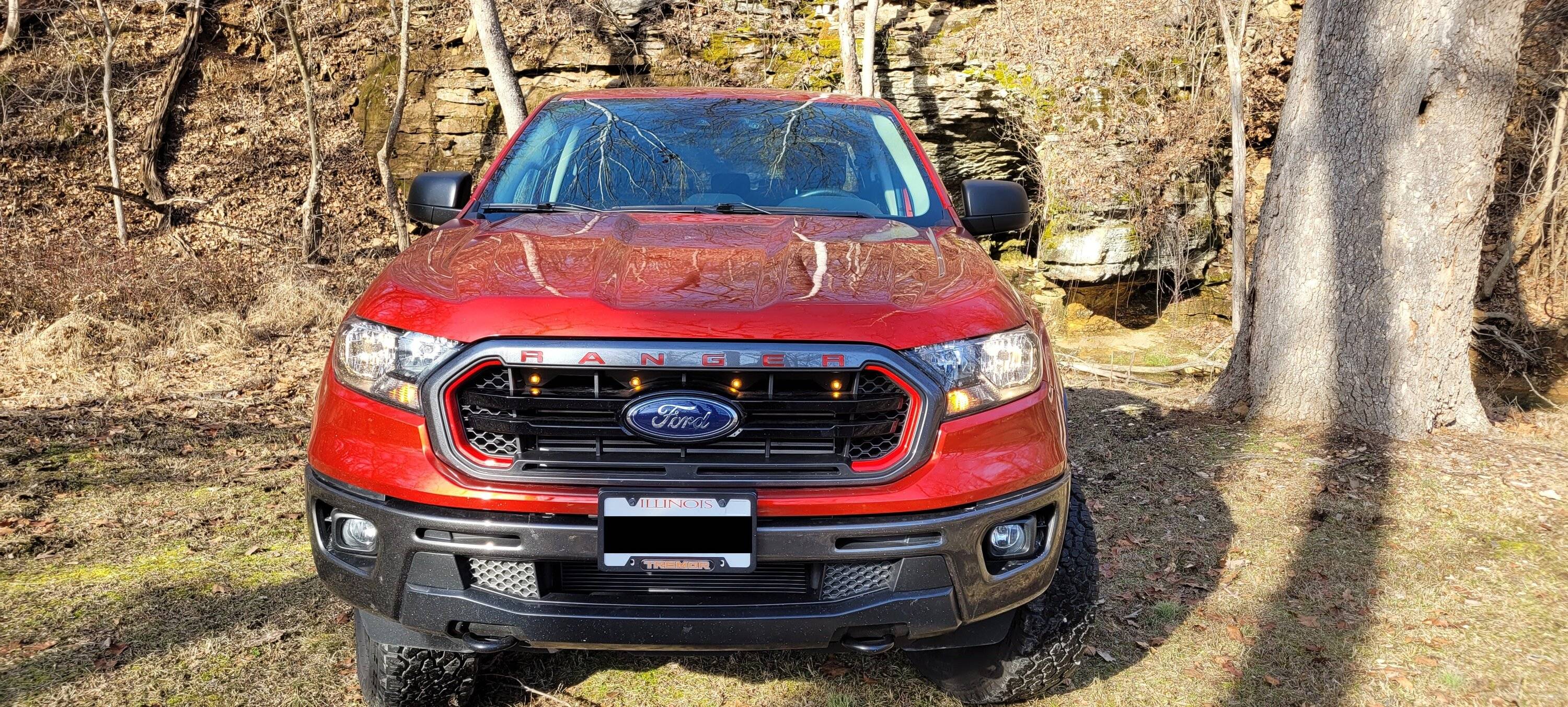

Installed my grill lights. I may repost a pic taken at night. I had to use some 3/4 bushings and new longer screws to get it installed instead of screws that came on the grill. The grill on on the tremor or my model year must be different than what was used to fabricate the lights. Easy to install once I got all the parts from Ace.

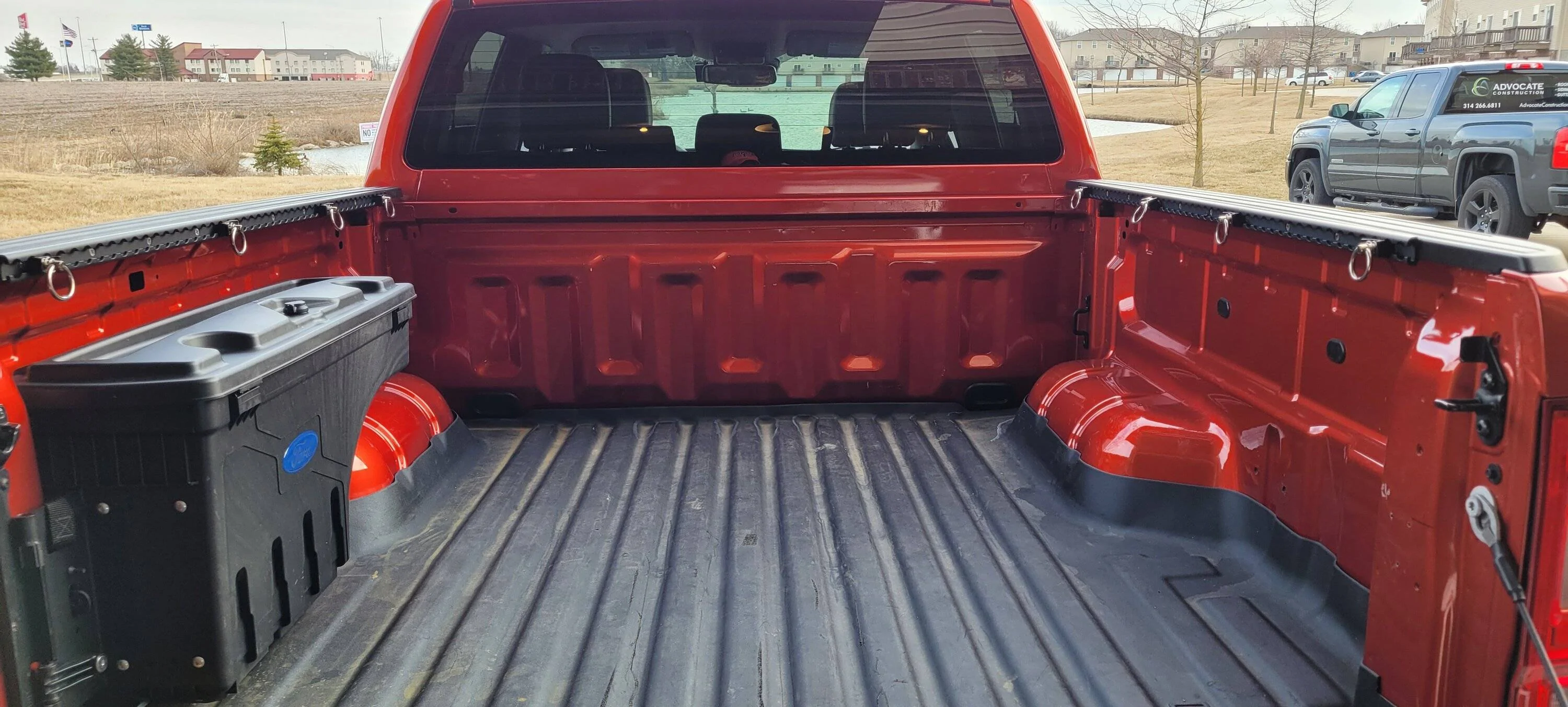

Update: The Swingcases clear the bladder, phew! =)

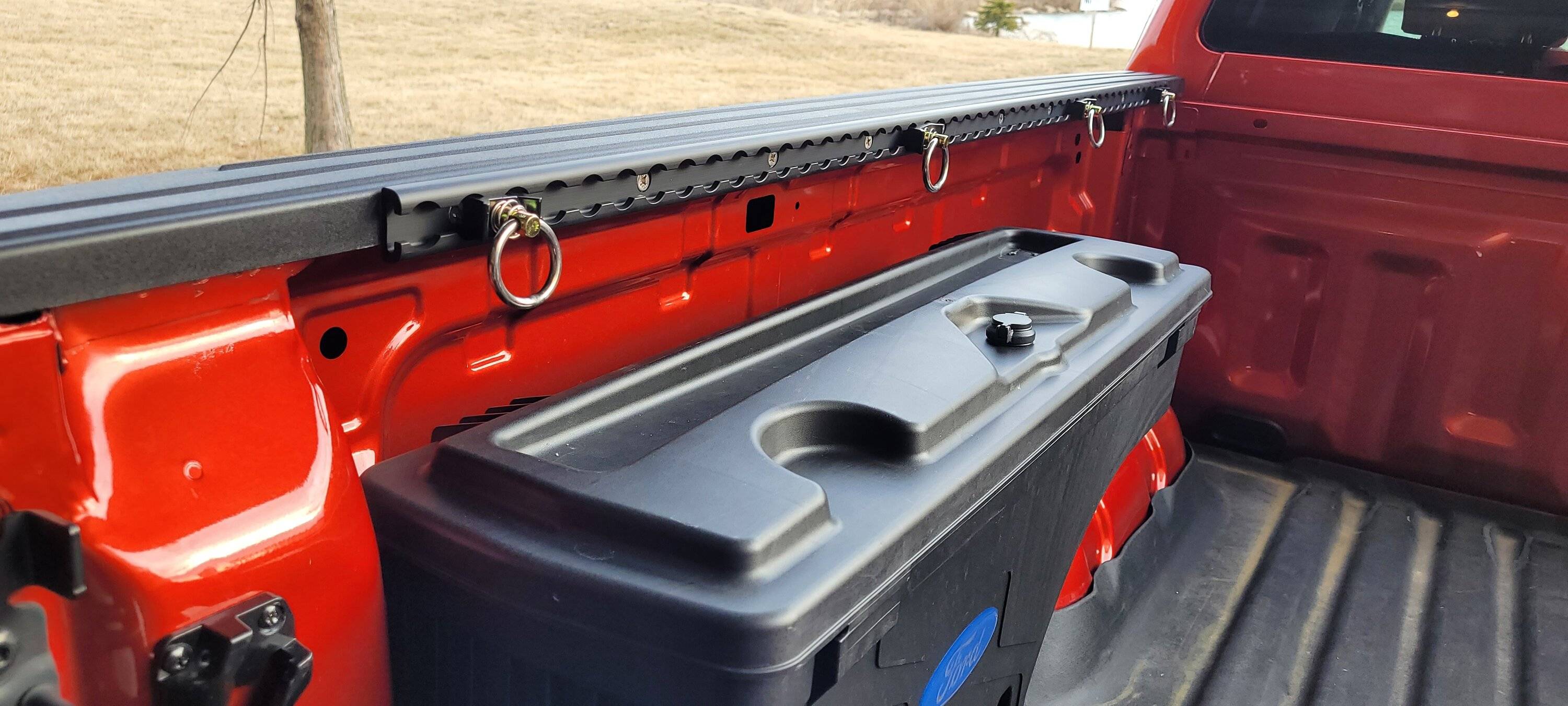

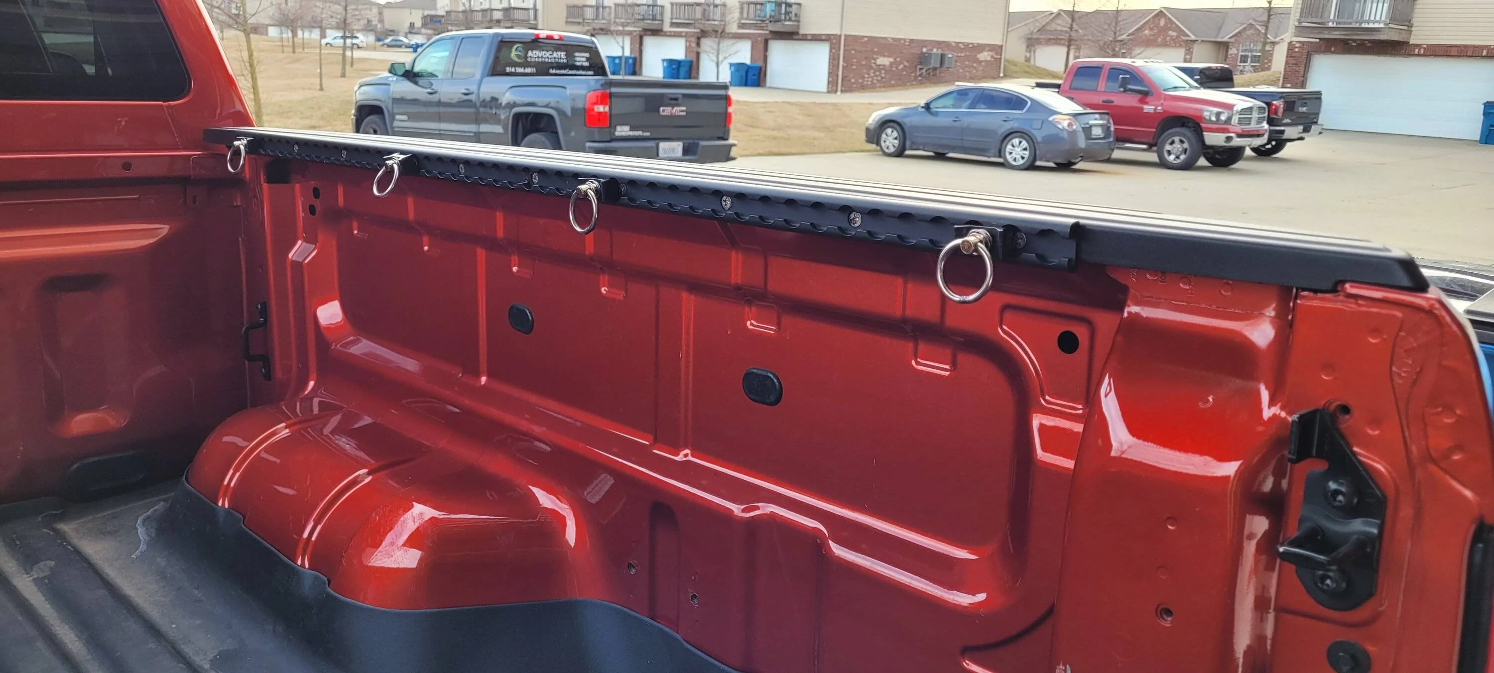

Installed some L track as well. Still waiting on my other toolbox. Mine arrived from Ford with a broken hinge and had to send one back.
Love that L-track! Having ties at the top makes a whole lot of sense. Always envied the European Rangers with those bed hooks.
