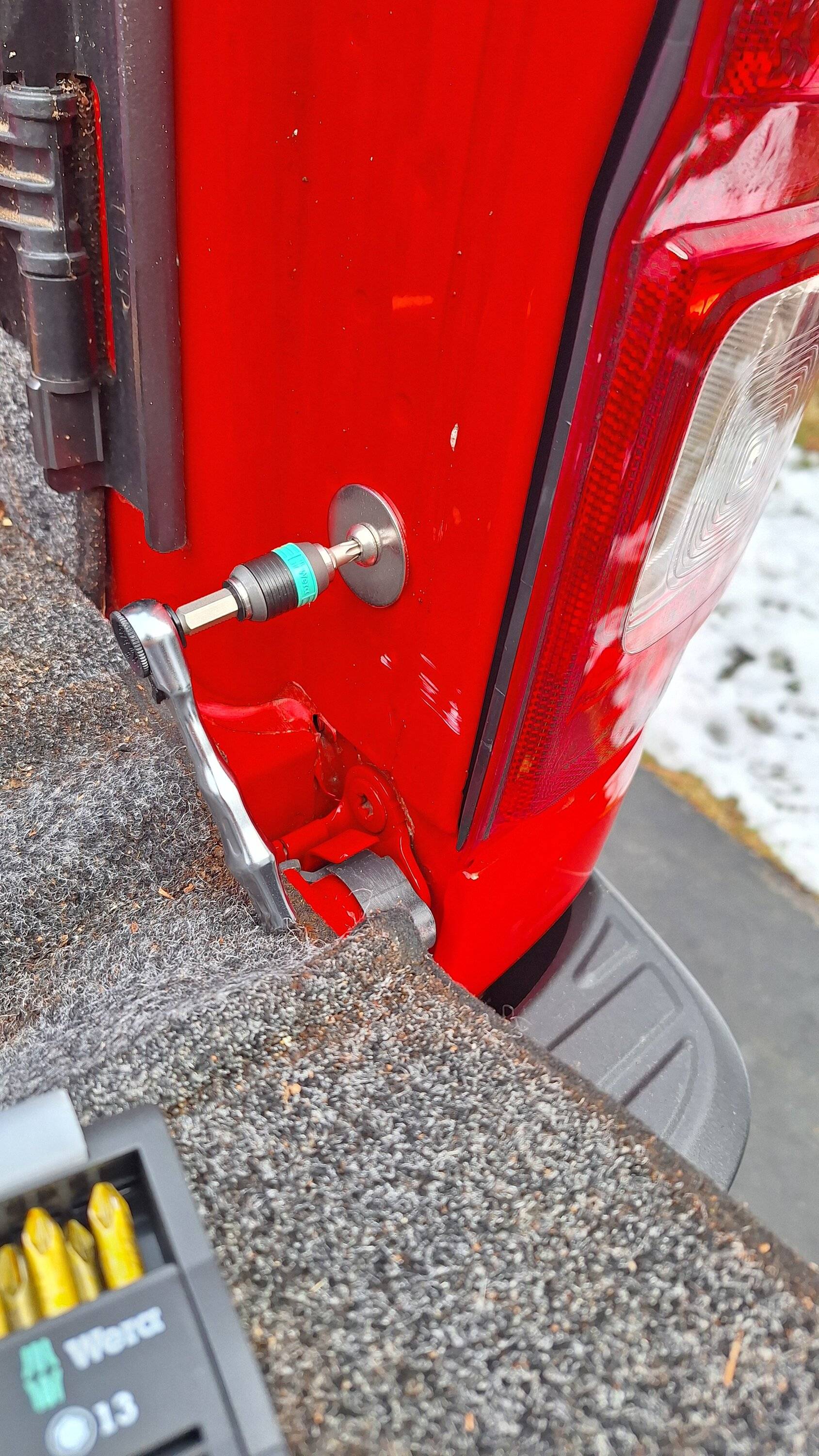

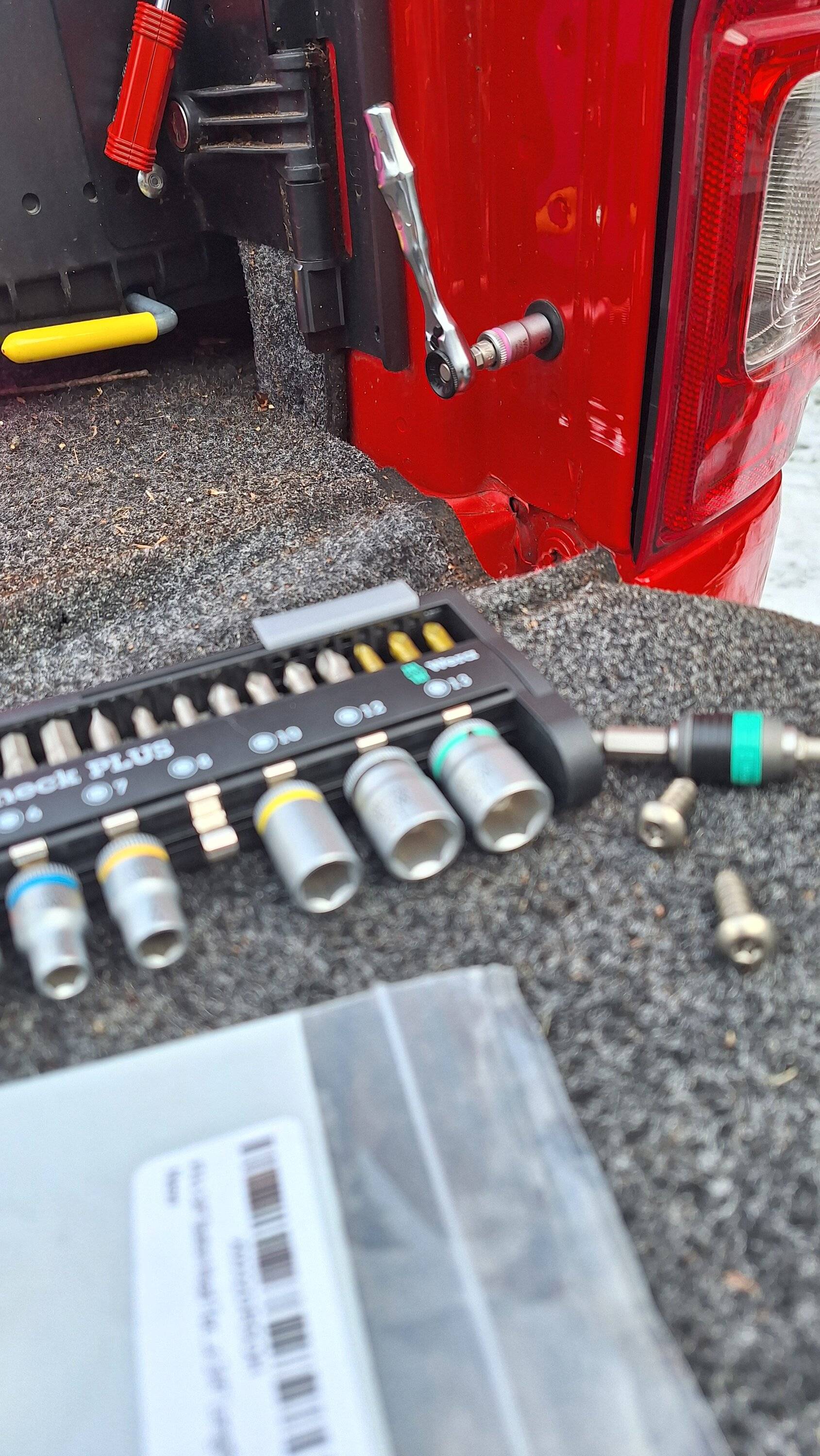

Finally changed the taillight screws but I had become paranoid about theft before realizing my taillights are not very desirable (no BLIS, no LED and far less expensive at like $120 each for aftermarket ones).
As I whined earlier, I wanted spanner drive (snake bite) but couldn't find button heads and I'll probably go to a smaller washer, they are a bit big and will hold dirt ...

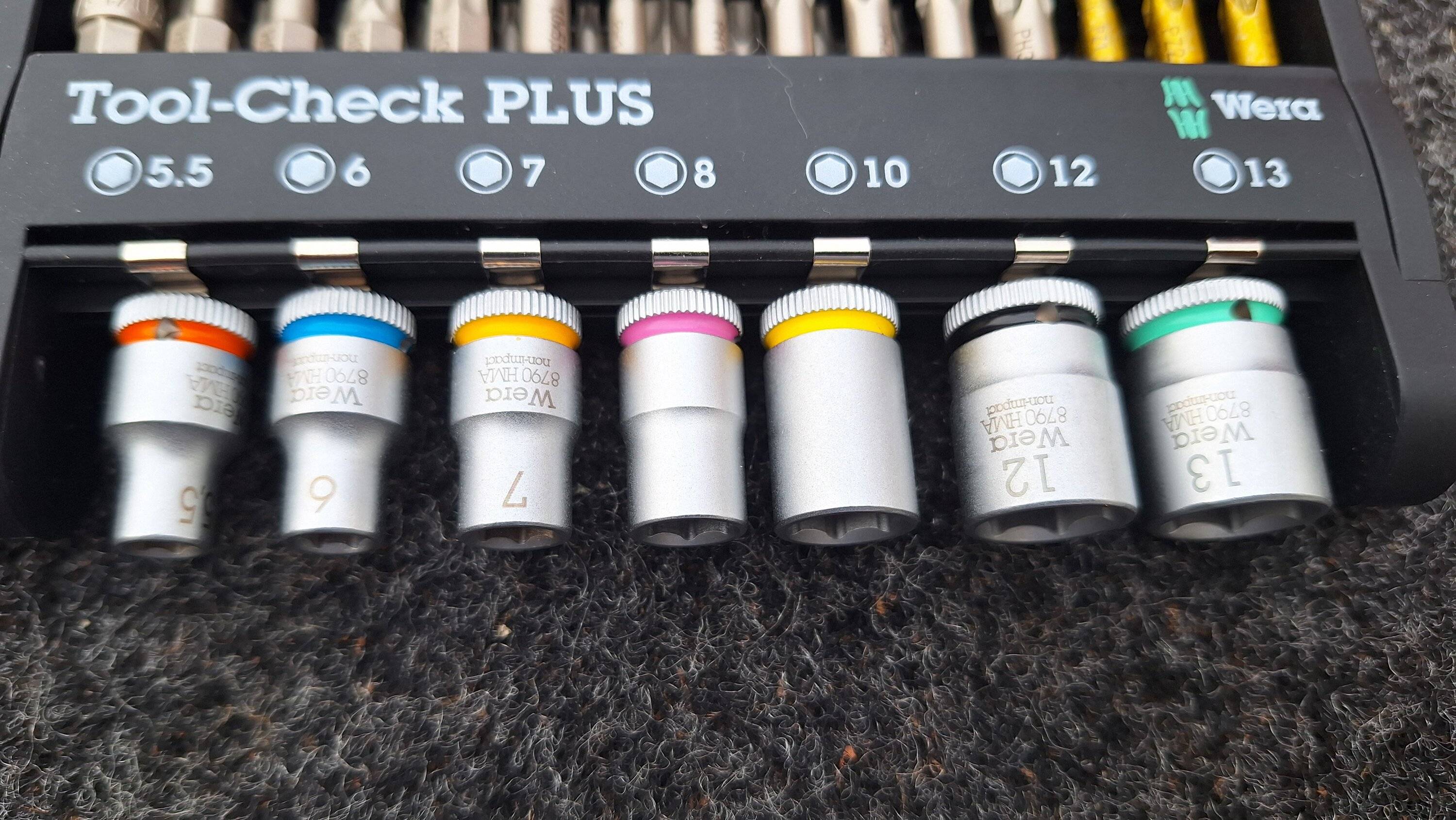

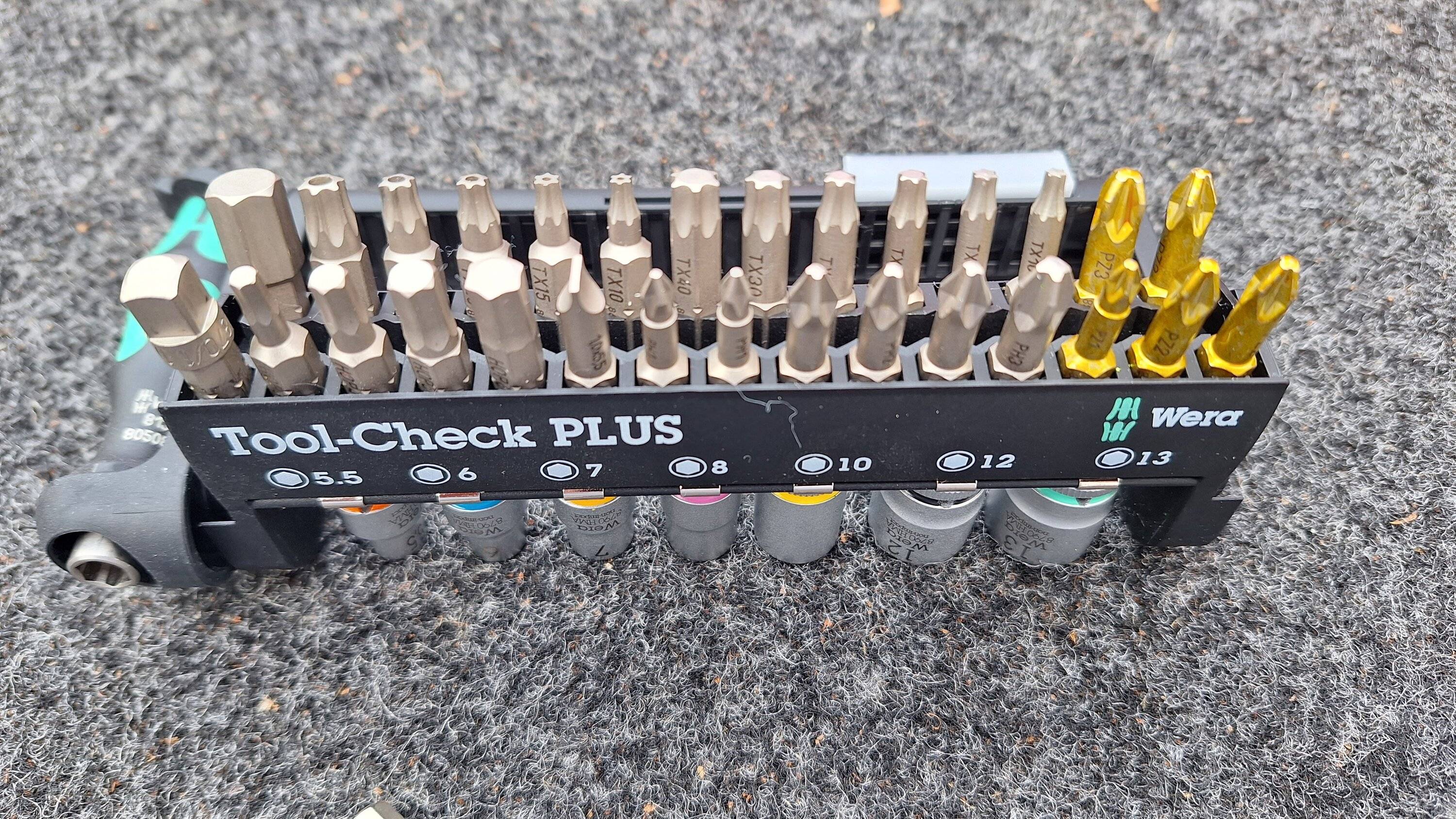

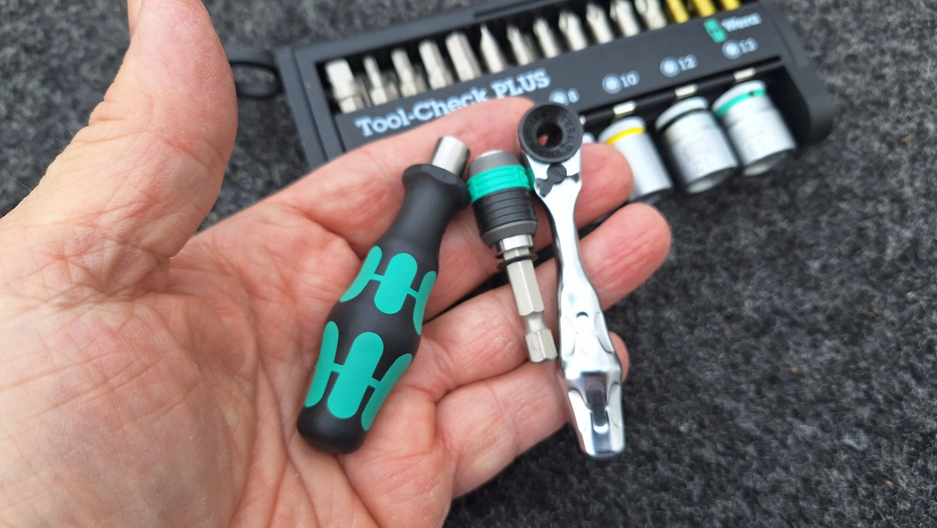

And I love this little Wera tool set, it's so fancy and cute. But nice with knurling on the sockets - the ratchet is pretty tiny for putting any force on anything, this task probably pushed its usability.
be gone ye vile pink 8mm, thief-friendly screw
that's one huge washer! =p

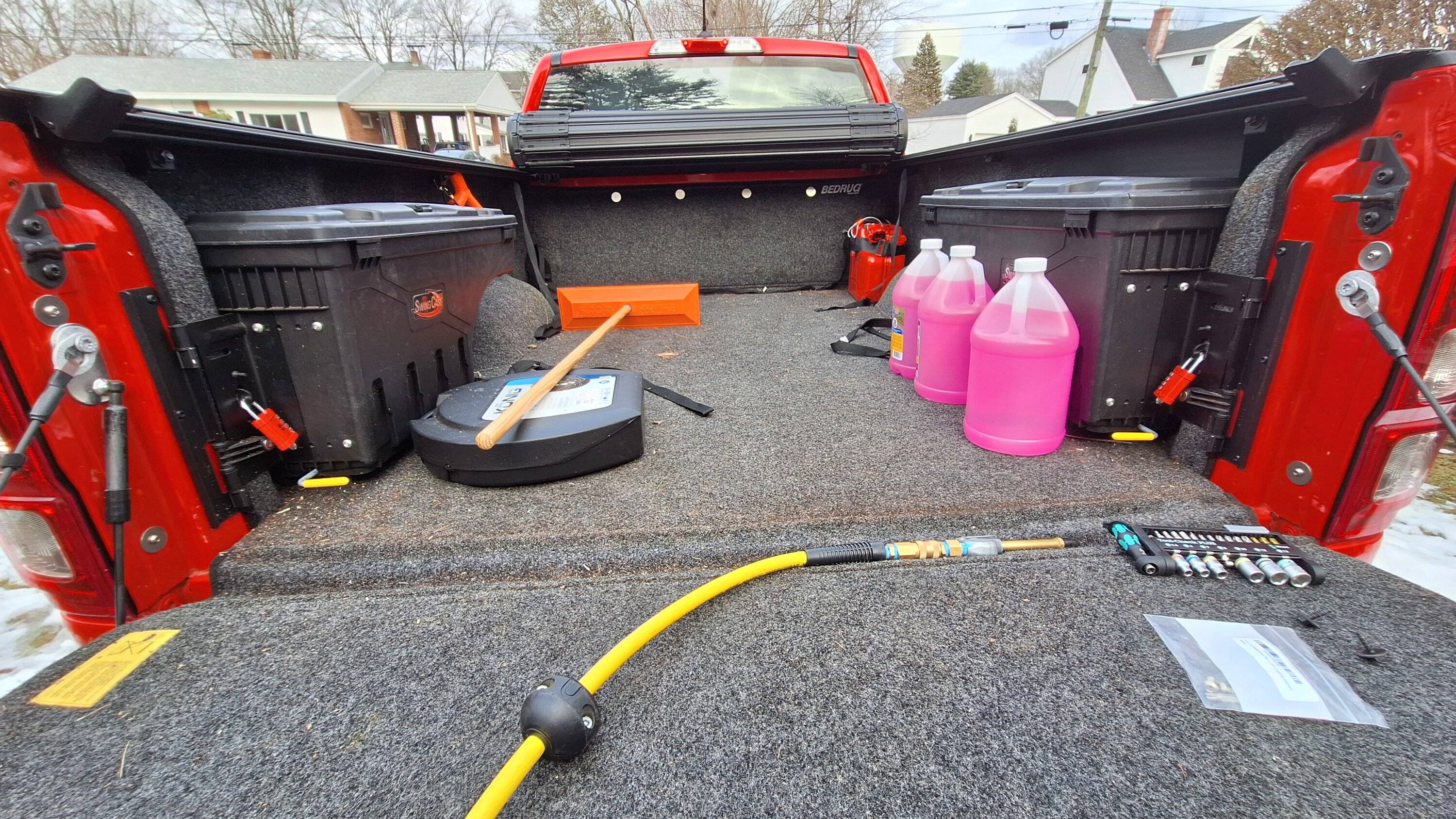

easier to install than the floor mats! air gun to clean bed for possible bladder install later
supposed high-precision bits, I dunno, seem to work like any other ...
hi-viz yellow on the 10mm for easy spotting? =D
pretty tiny ratchet but smooth operating (just like me, Cheech, and Soupie) =)

@subquark - I want you to know I go through an internal struggle every time I post a product, as a digital friend to you, I feel a bit of responsibility because I know you are going to buy these.
I love Wera tools too. I particularly love my Wera 4-in-1 Joker self-setting ratchet spanners.
https://products.wera.de/en/joker_6004_joker_self-setting_adjustable_spanner_6004_joker_4_set_1.html
Enjoy them!
You know, I looked at a few videos of these but couldn't tell how useful or practical they might be.
BUT ... being the enabler that you are (and that's a compliment since I'm always itching to pull the spend-it-for-the-Ranger trigger), I think you just swayed me to get them.
I see them for about $160+ online and, if they're pretty handy, then that's not so bad.
Thanks! =)

@subquark - In all seriousness they're good for when you're having to tighten a fastener you can't look at while you work on it. That's the advantage of the self-setting mechanism. Otherwise you're better off with a nice set of Knipex!
4,544
23,071
Or, even better, a nice set of both! =D
Oh man, I better fertilize that money tree, I certainly spew enough b.s. to do so!

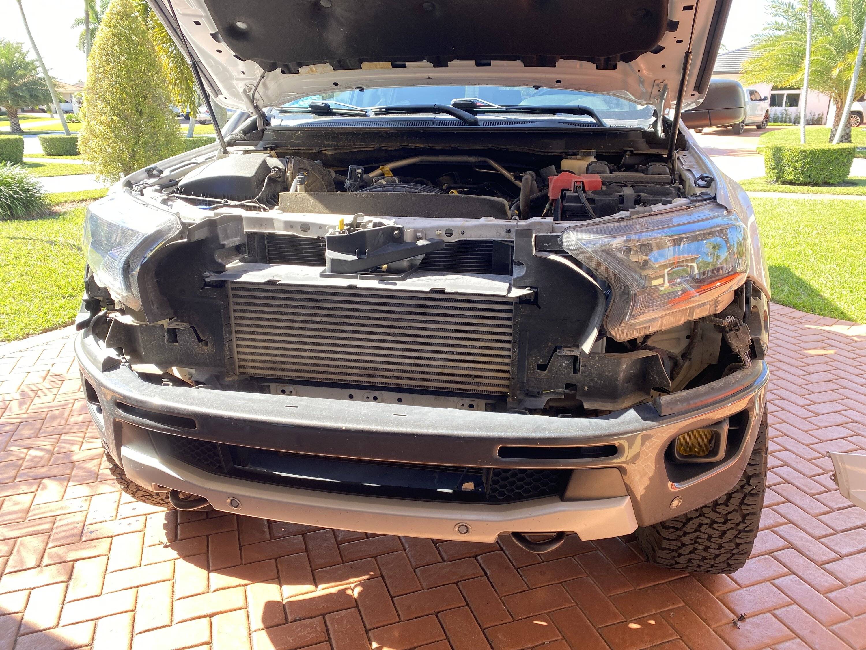

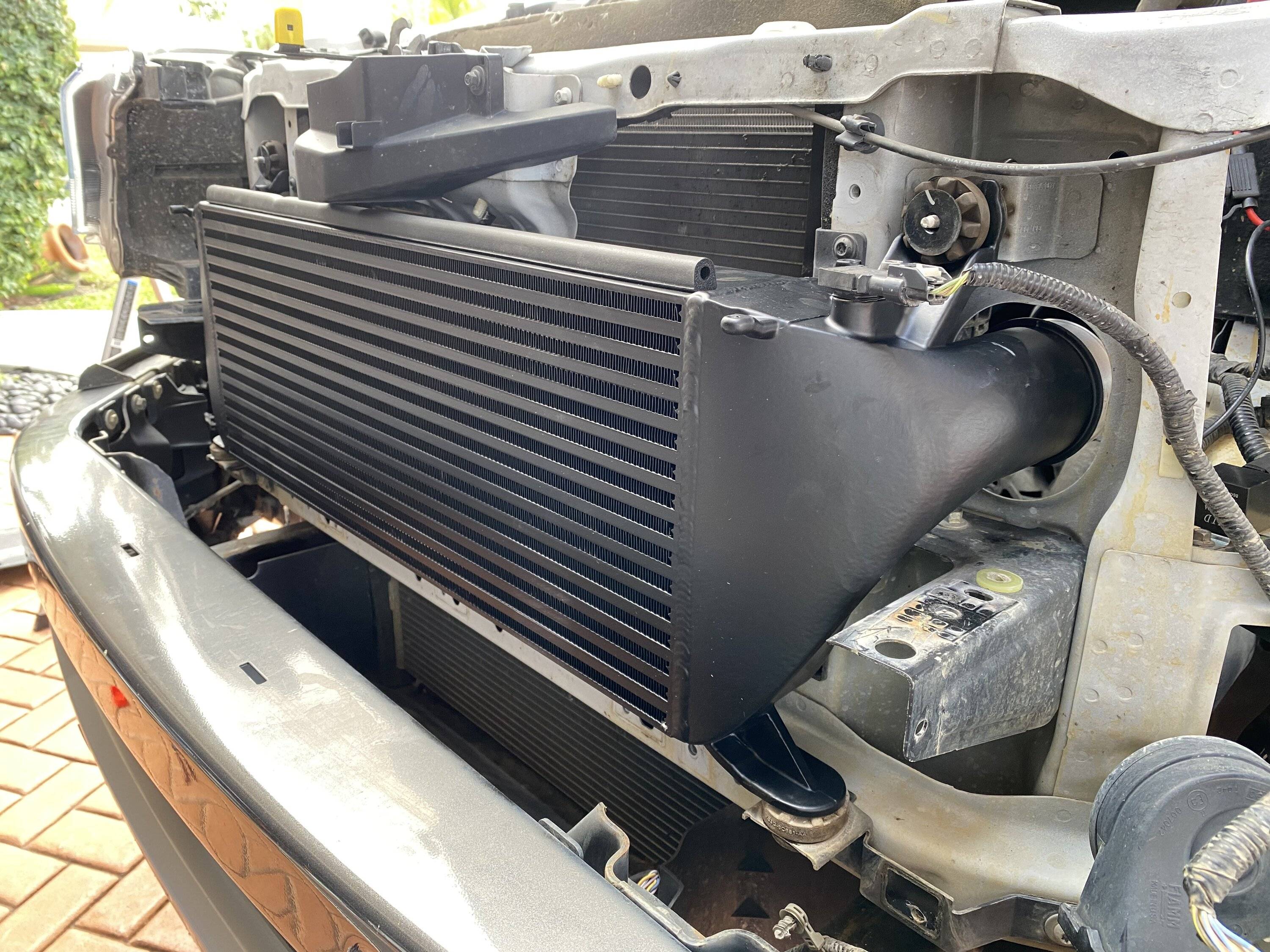

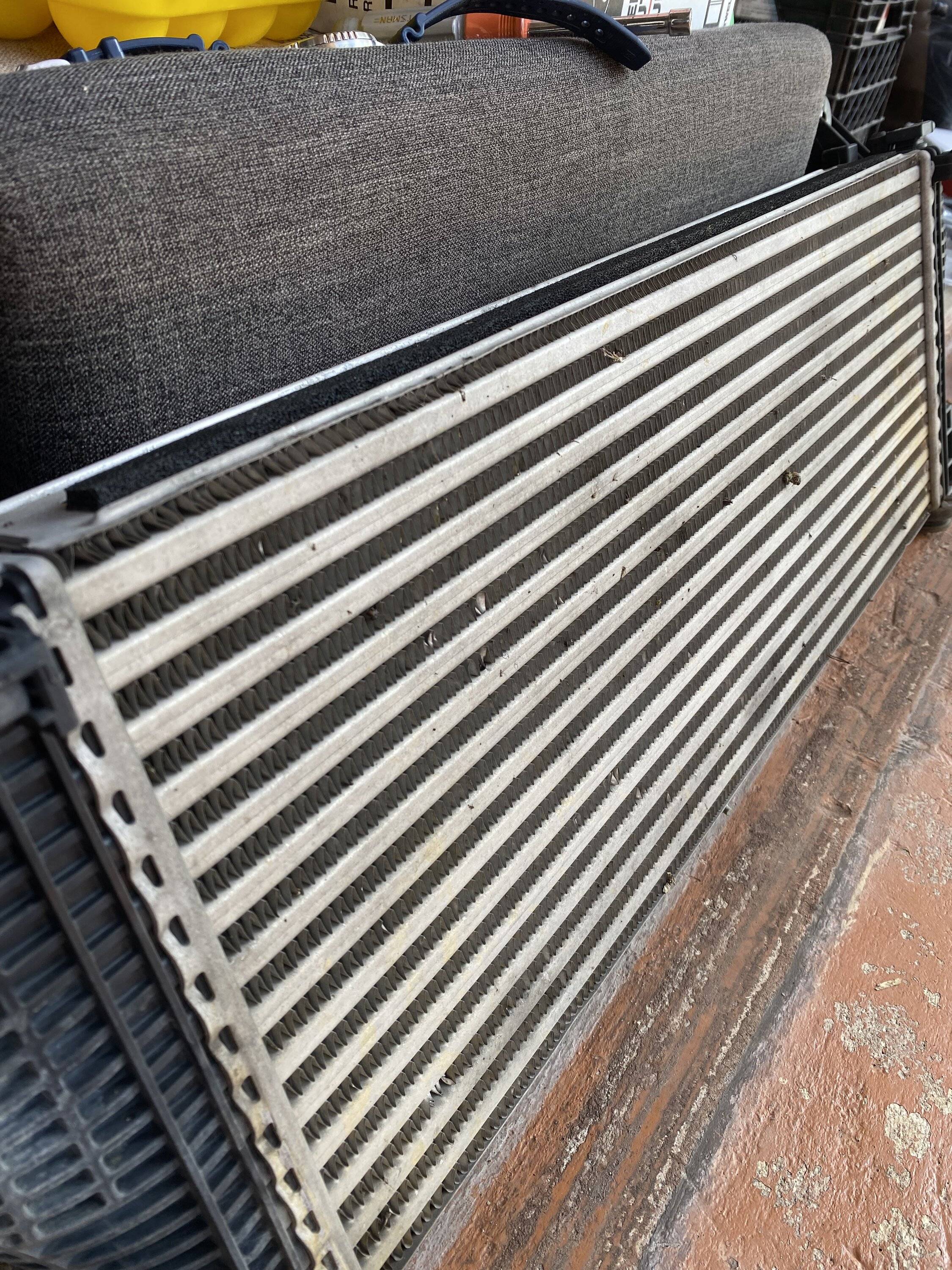

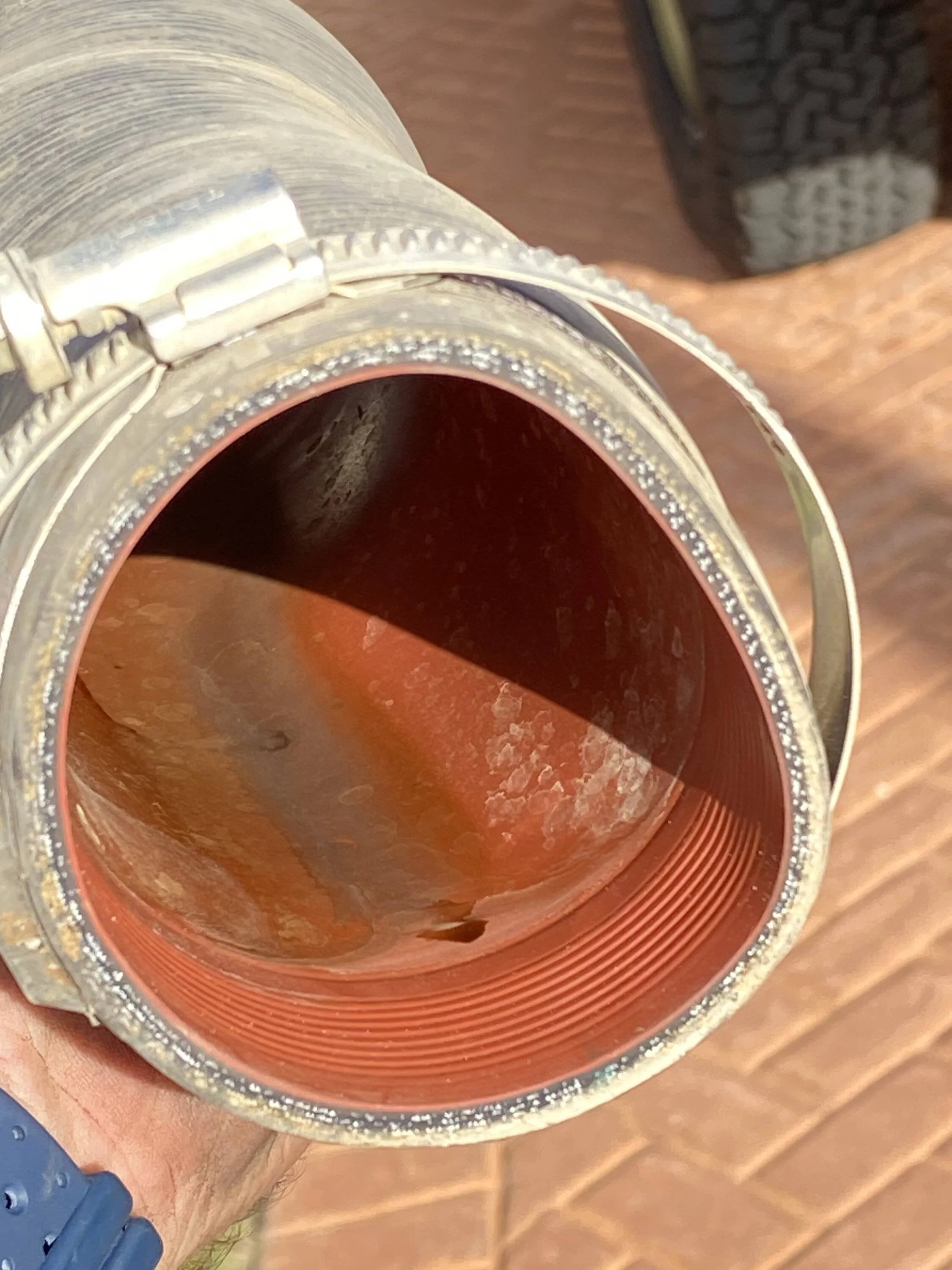

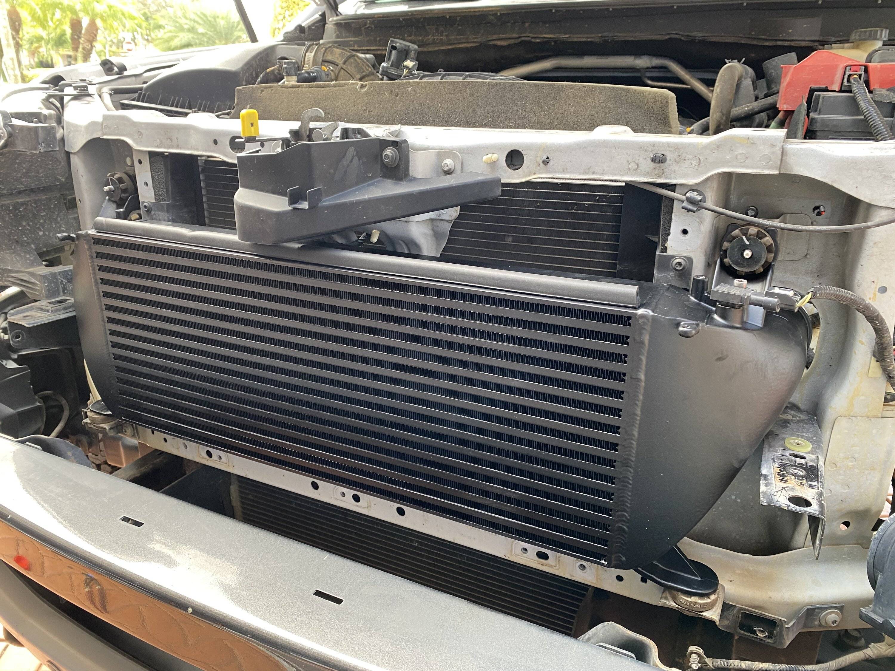

I picked up the Mountune Intercooler back in November and finally got around to install it. Most time consuming part will be the removal of the front fascia. My biggest gripe with the kit is the use of digital instructions. There were no paper instructions. Just a small paper with a QR code. While they are in color and you can zoom in, I prefer just having paper instructions that I can just read, rather than always having it grab my phone.

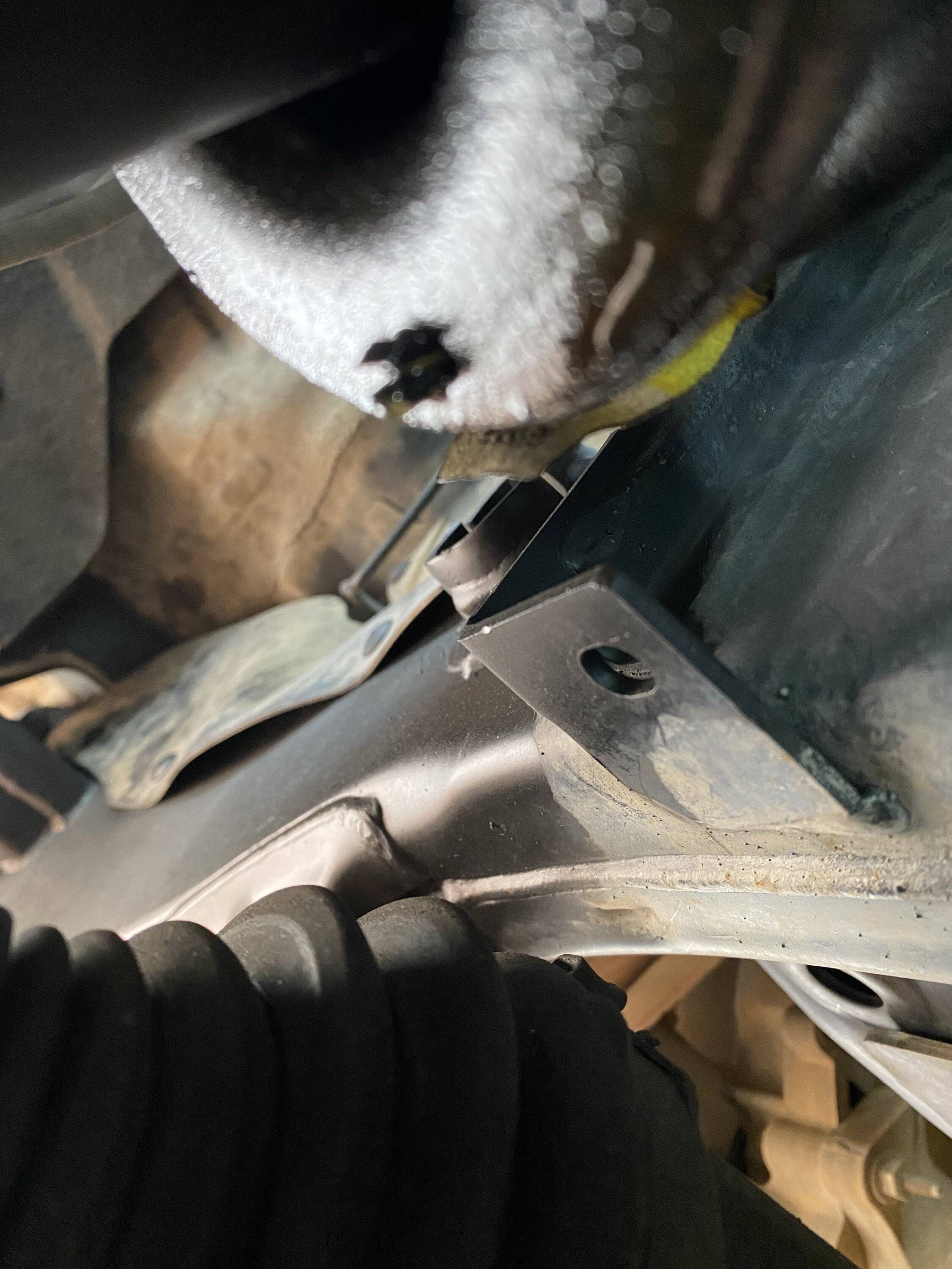

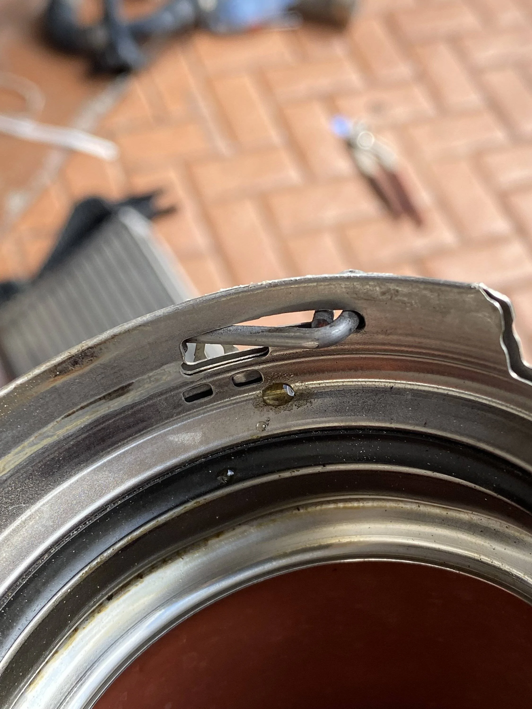

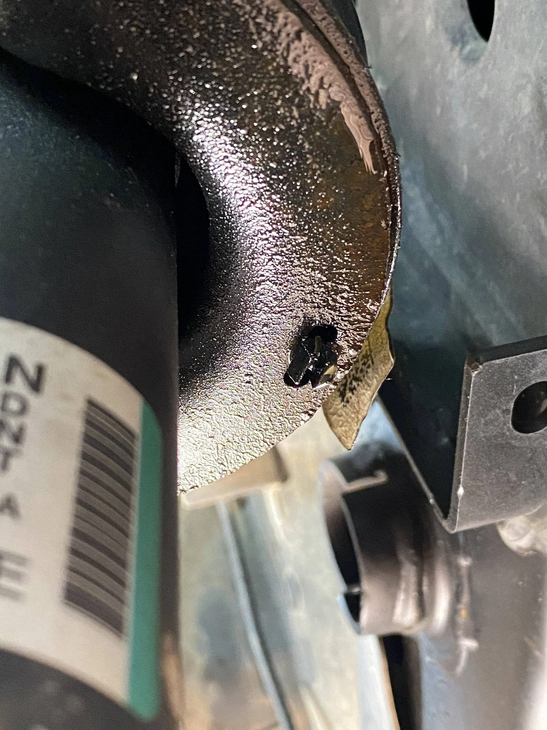

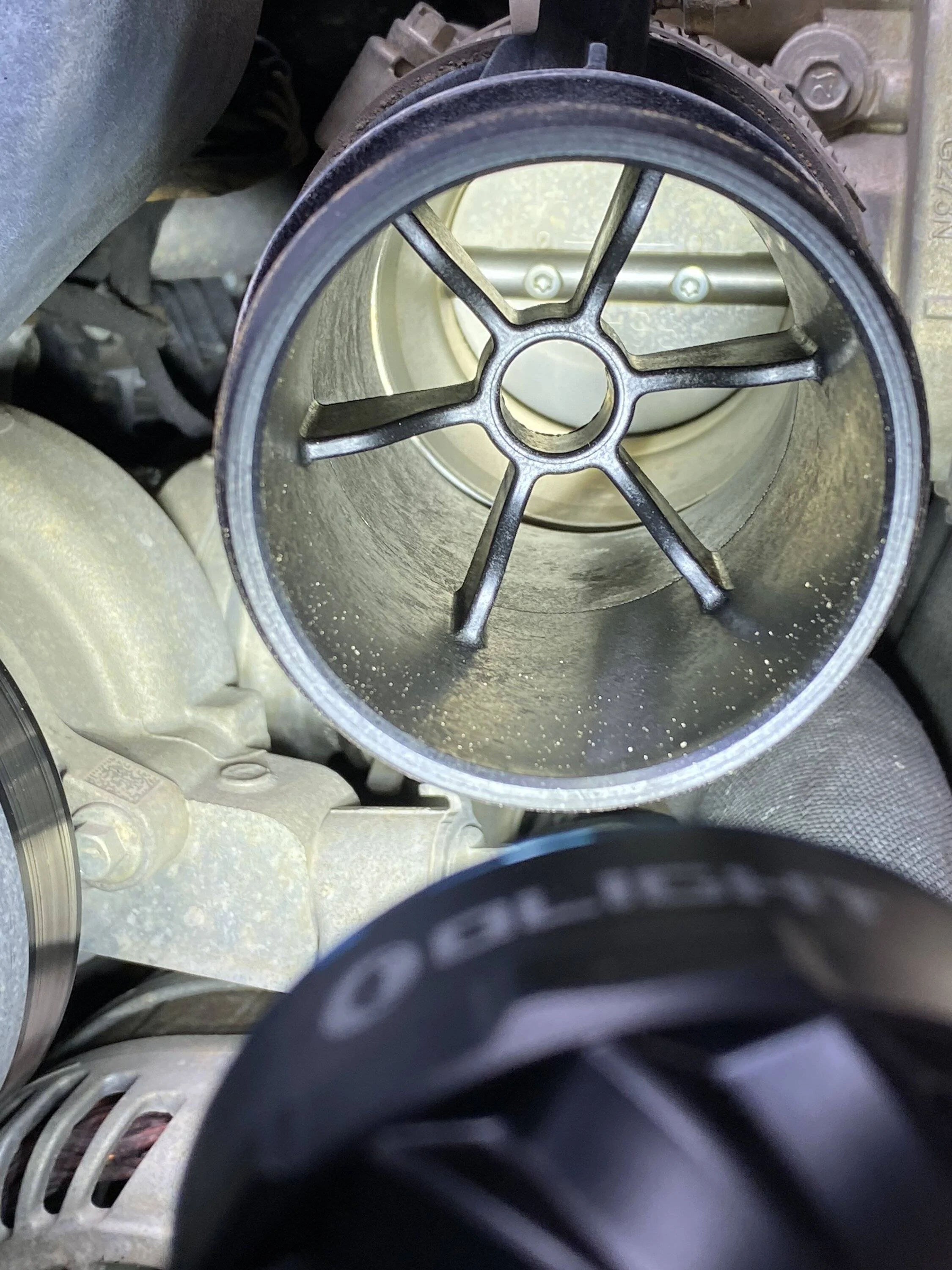

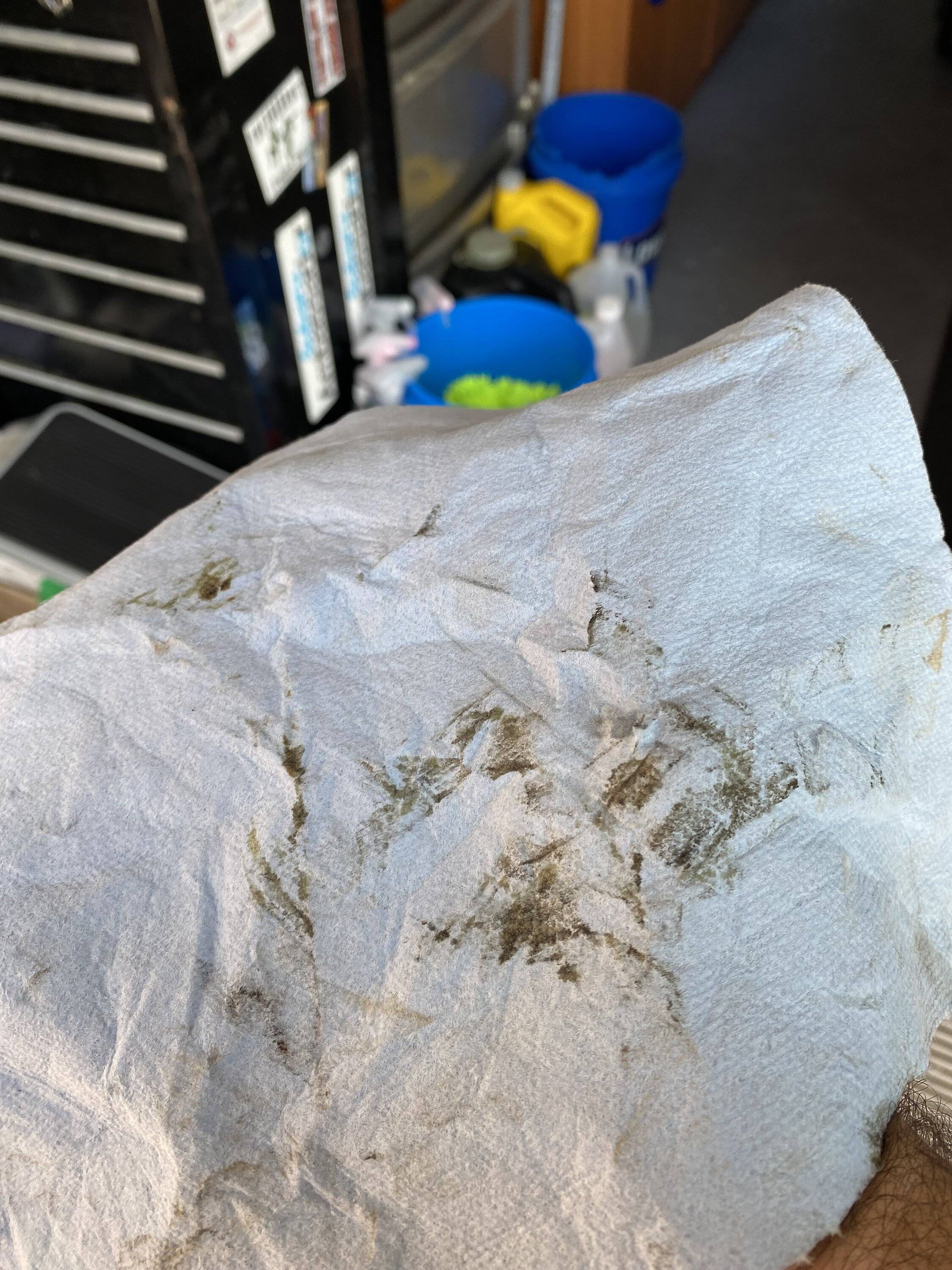

Upon removal of the factory pipes I noticed some of them had small traces of oil in them. I am not running any form of catch can, but may reconsider that. I did notice while I was under the truck that I believe my passenger front shock is leaking/failing. I noticed the underside of it had a coating of oil/fluid on it, as well as the frame area behind it.
We are having very different Februarys. Did you do the charge pipes or just the intercooler?
That we are ? Hi today during the install was 77°.
Intercooler came with their boost hoses. Unlike other brands that use a hard pipe on the hot and cold side, the Mountune uses a hard pipe in the section with the BOV. From then on to the Intercooler and the cold side it’ll be a reinforced hose.
