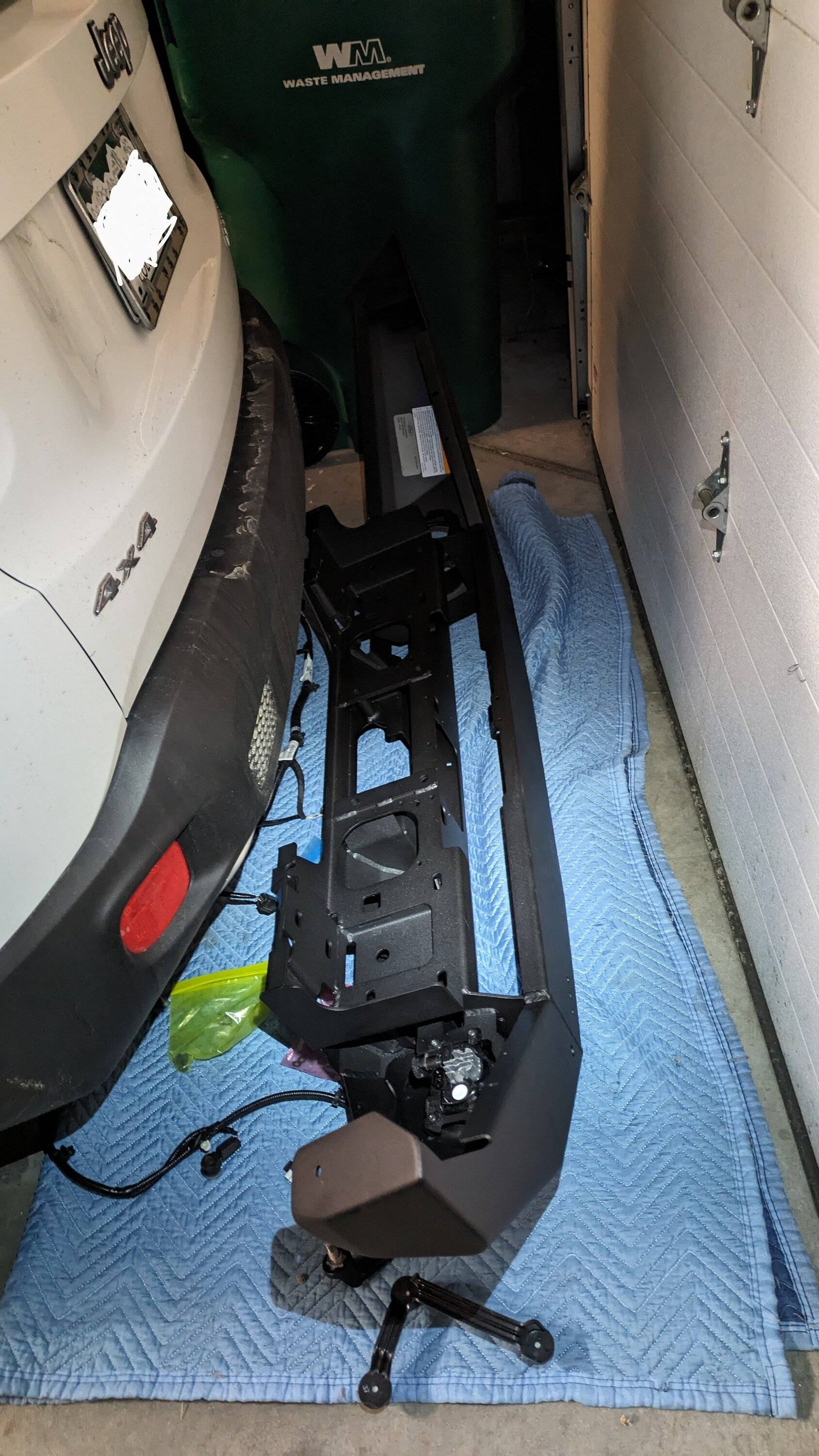

Before the Yeti's facelift

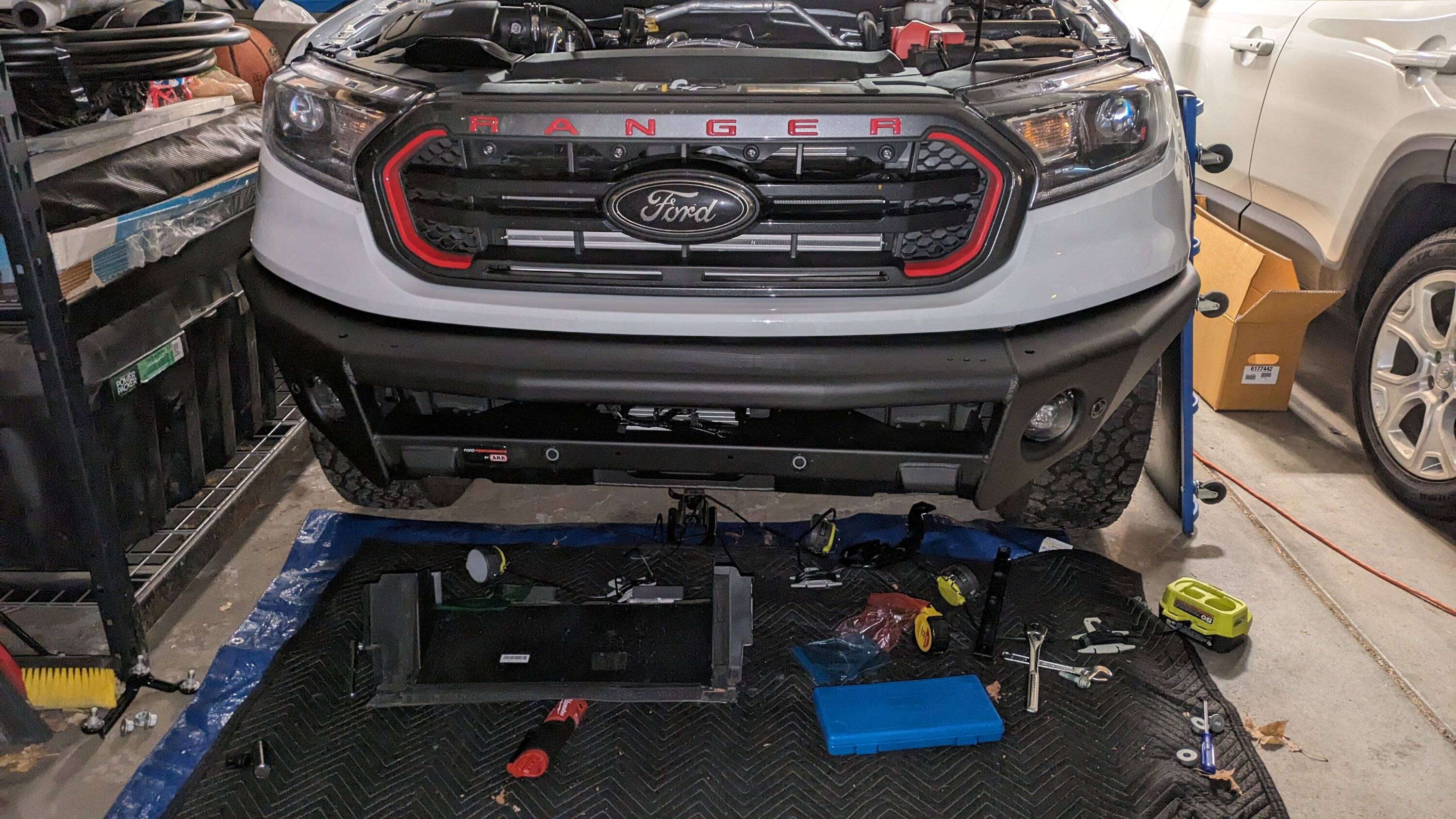

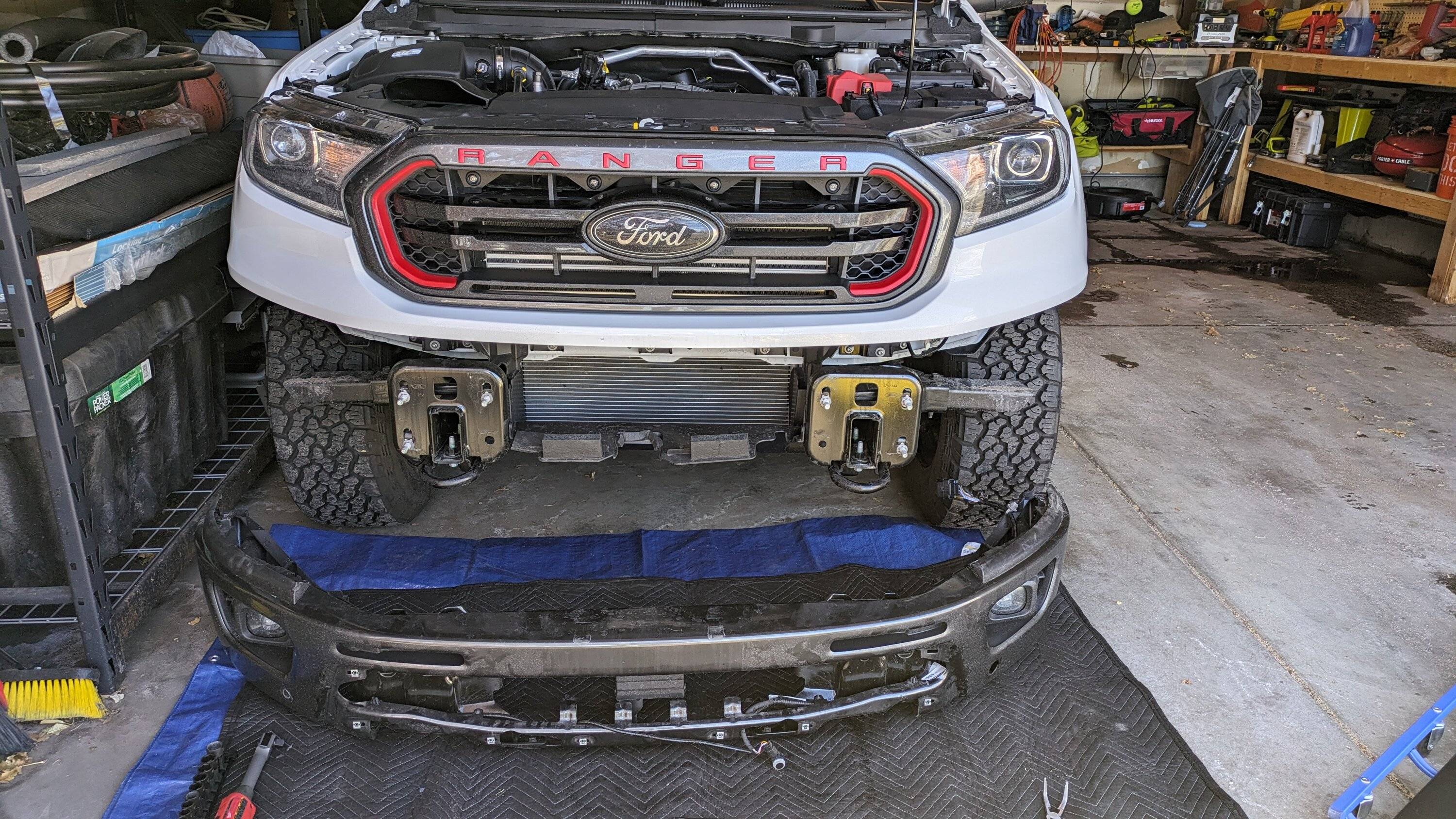

Facelift underway, factory bumper off

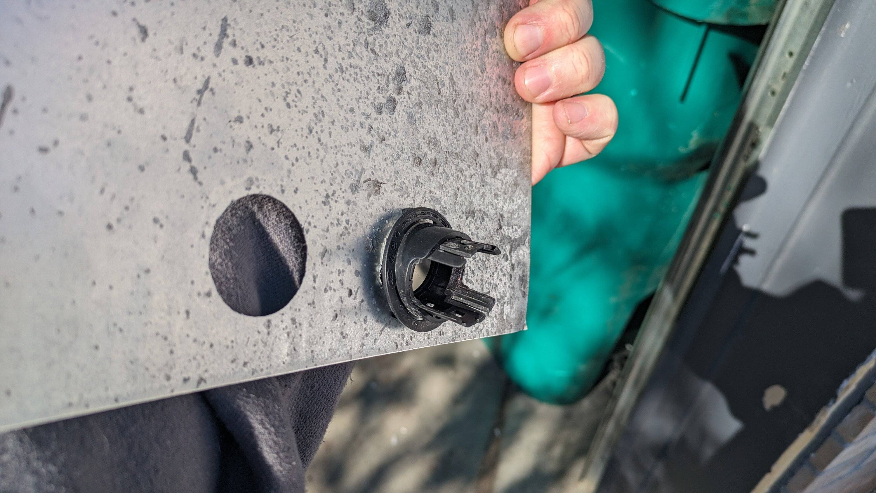

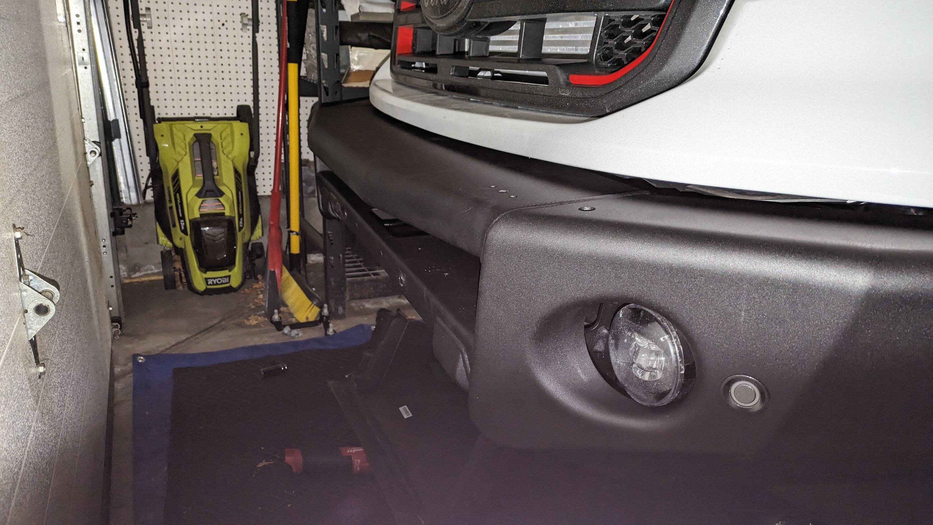

Checking hole size for parking sensors
Snapped in after cutting the housing keyways in the test template with the trusty Dremel
End of day 1, test fitting, head scratching about ACC mounting you name it
Back after it, this was towards the end of day 2
Success, it's hung ? by the second afternoon
Nothing torqued yet
Starting to take shape though
Day 3, it's basically done. It's on, torqued, parking sensors work and passed their test.

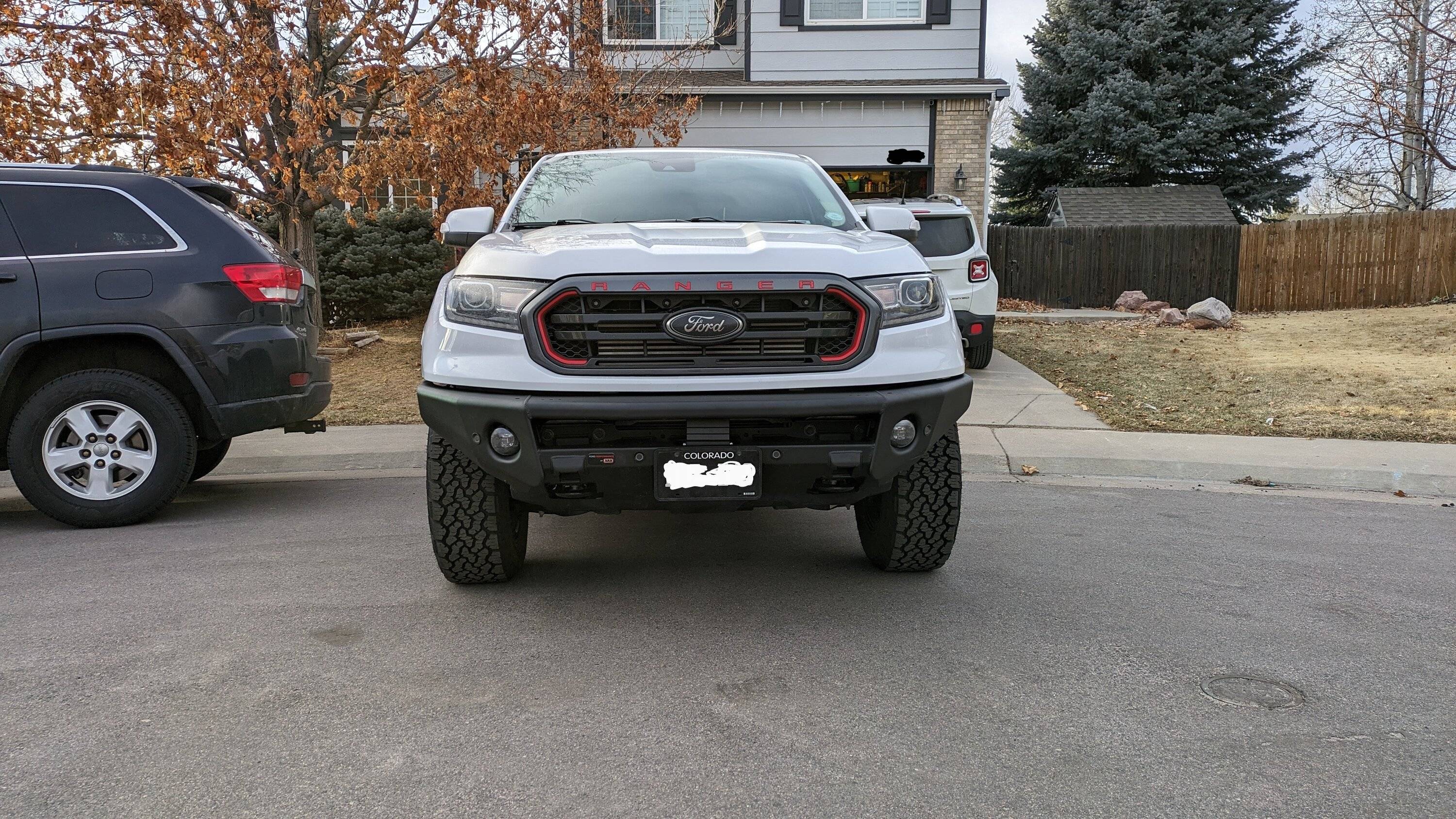

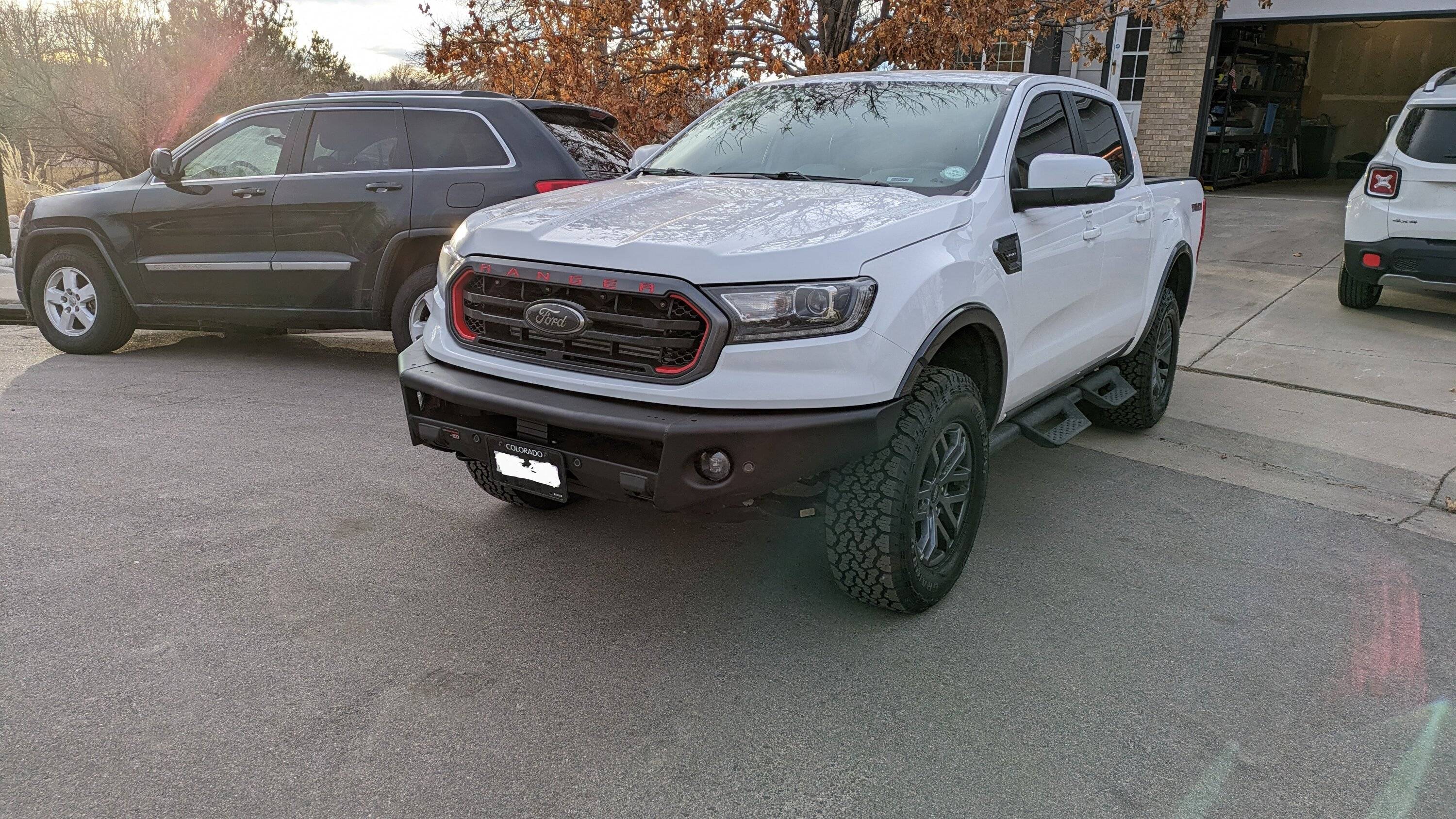

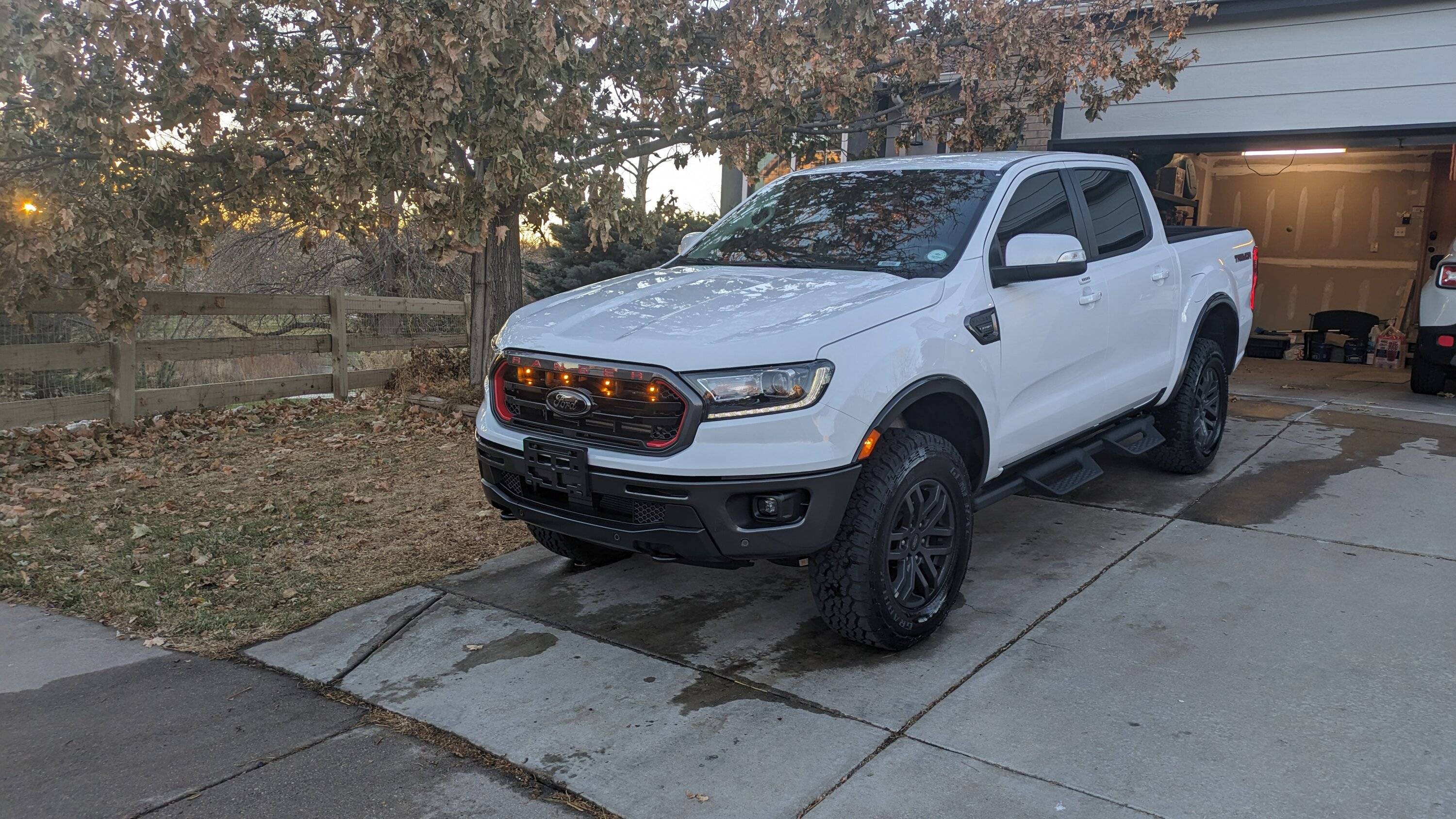

Looks good! I really like the lines from the front.
One thing I don't get about most of these after market bumpers is the stick so far forward at the top. I get it can be used as a mounting location for lights, but there has to be a better way to provide a mounting surface than a inches wide top lip.... Shrug.
I am thinking when I finally "need" a new front bumper it'll be a tube bent custom job or that relentless offroad (I think) tube bumper the have looks slick. With those, the draw back to me ends up being how much of the frame etc is exposed (how it looks)

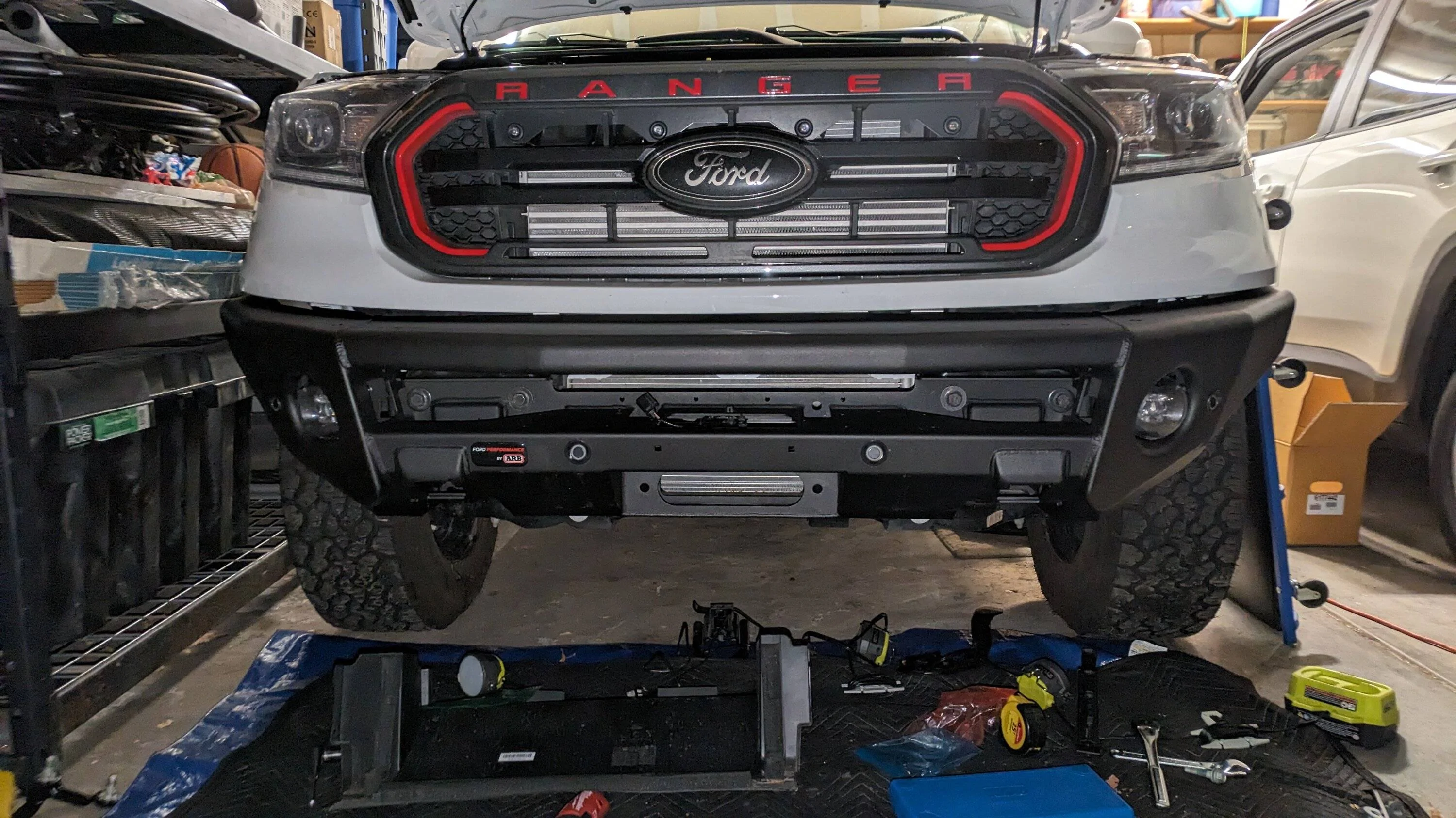

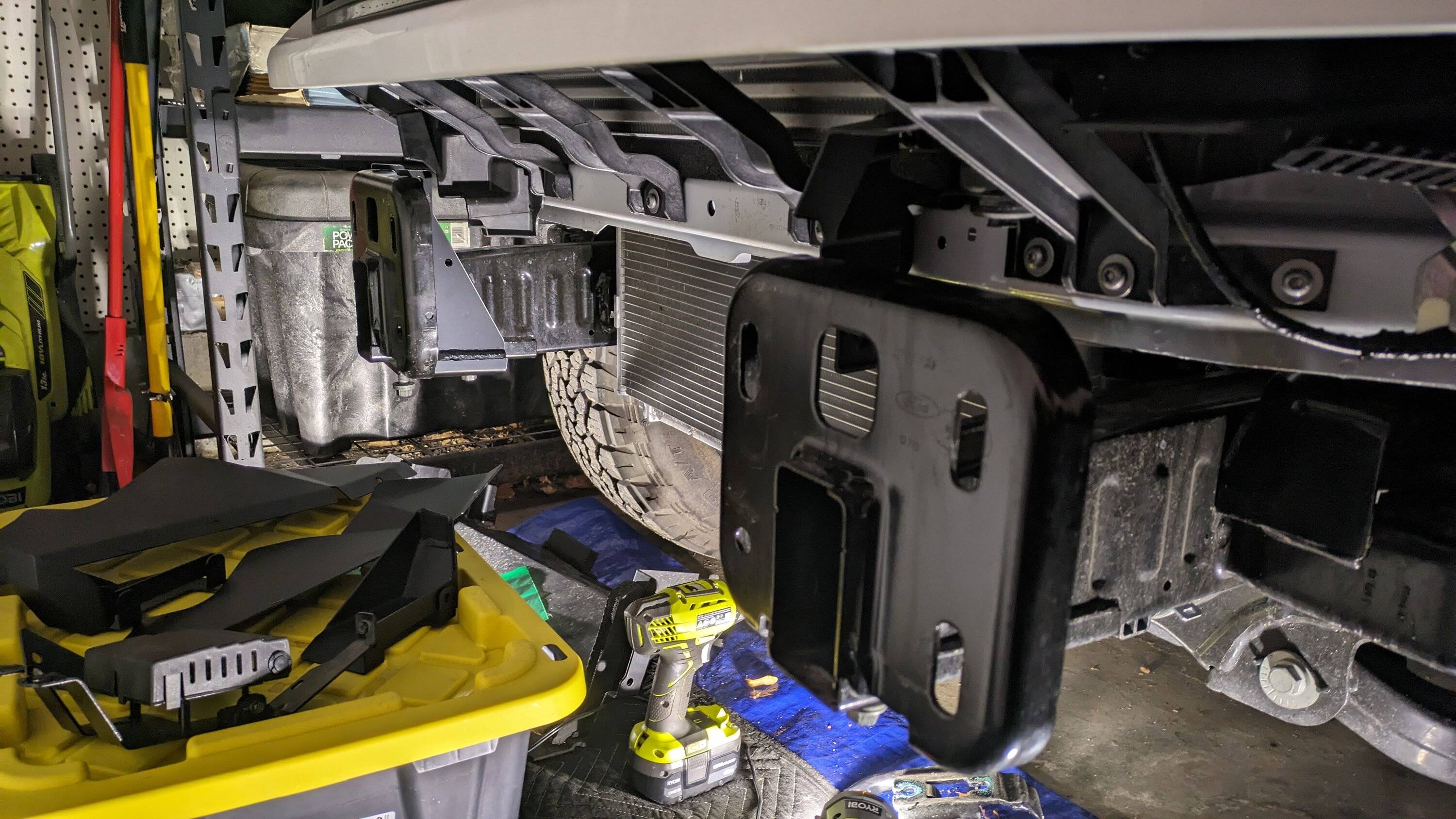

Having been working on it a few days and getting familiar with the inner workings, guessing it's for the winch provision.
I figured (being new to trucks in general) the winch would mount inside the bumper somehow. The FP bumper mounts it to the rear of the bumper in front of the intercooler. So some of that protrusion is making room for the winch if you decide to install it.
Another thing I'd seen said is that this couldn't be mounted with the bumper in place, I don't believe that's the case. You would have to drop the skid plate and the little plastic air duct if you managed to get it back in place, but there's enough access from below to do it I think.
That makes sense - wonder if there is a way to "rearrange the engine bay" to make space for the winch to be further in.
In the Subaru world they move the intercooler from top mounted to front mounted to increase airflow at speed. I will need to dig behind the bumper and see what I find . . . it would probably require a functional hood scoop being added. and that is way more than I am willing to attempt. LOL If I don't like the lip, I am not going to like a hood scoop. lol

It's not as bad as it seems in photos IRL. I'm planning on some aux lighting on top that will clean it up even more.
Actually what you are seeing in front of the lower radiator is the A/C condenser coil. The intercooler is in front of the upper radiator and would not interfere with the winch.
? I'll have to snap some photos today, there's so much shit in there and it ALL looks the same ?

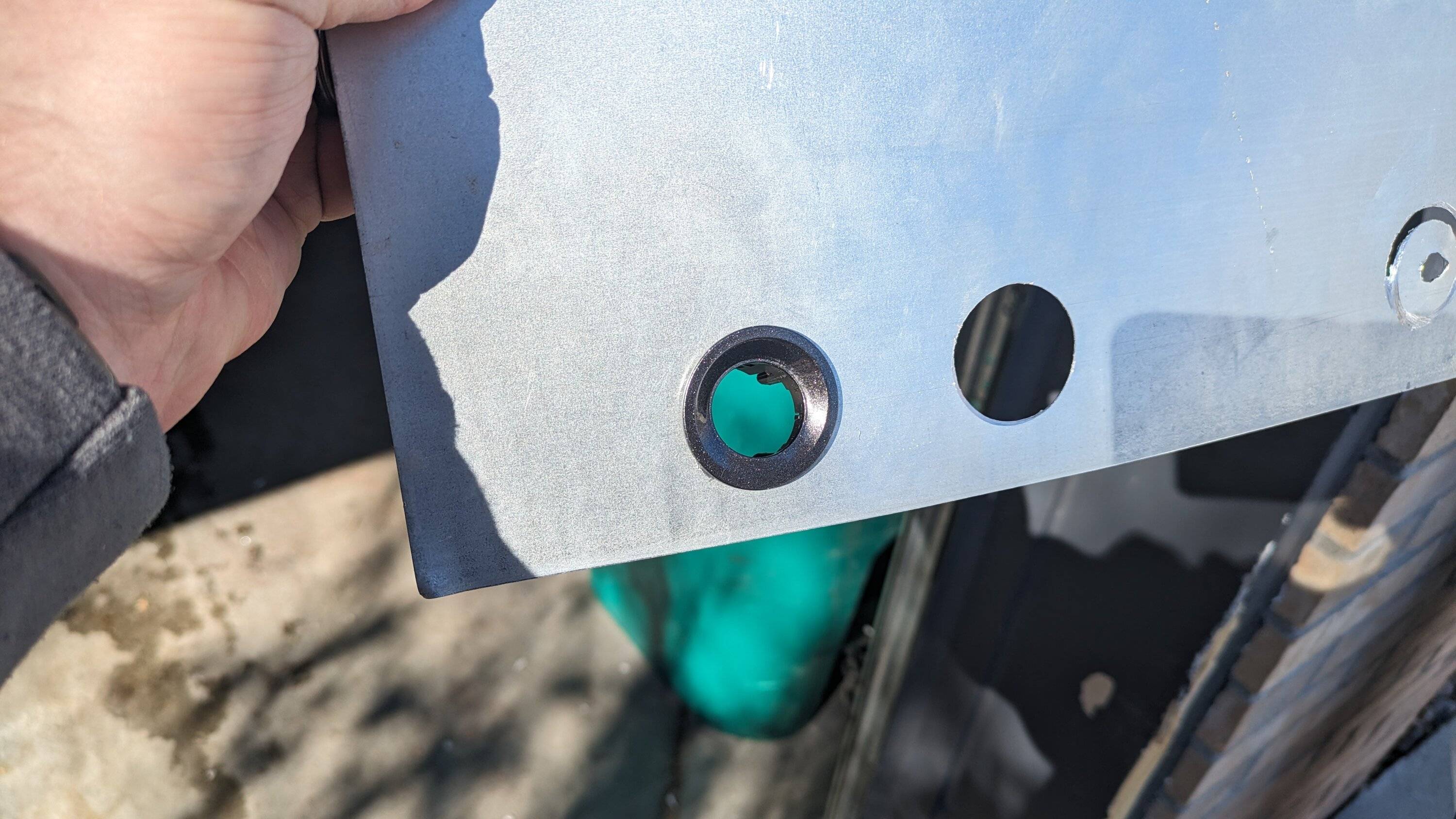

Shackle mounts are on, FYI you'll need some washers for everything to sit right with the FP bumper, the welds keep the brackets from sitting flat and bonus! the Rough Country brackets for the skid plate move it back about a half inch, so you have to deepen the slots in the FX4 skid plate where it bolts to the frame in the rear for it to fit
