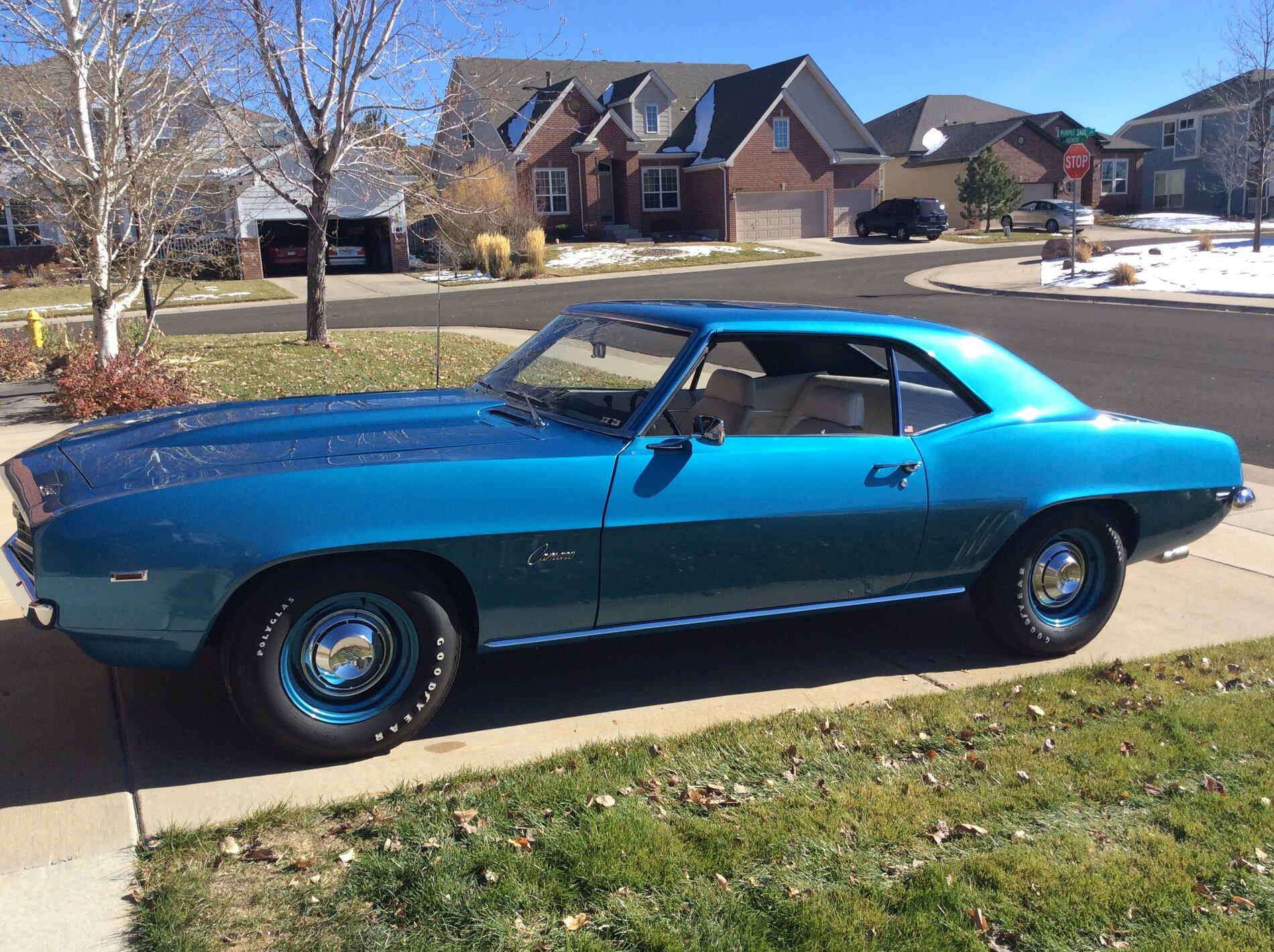

I've got a '69 Camaro and a Model A Ford that has a '72 350 small block Chevy. The AC Delco filters that are sold at Walmart are Chinese knock off pieces of shit.... just saying.
I love that Camaro. :thumbsup:? When we were first married I had a 57 Chevy and wife had a 69 Camaro. Boy would I like to have them now.
Might make a good run.
