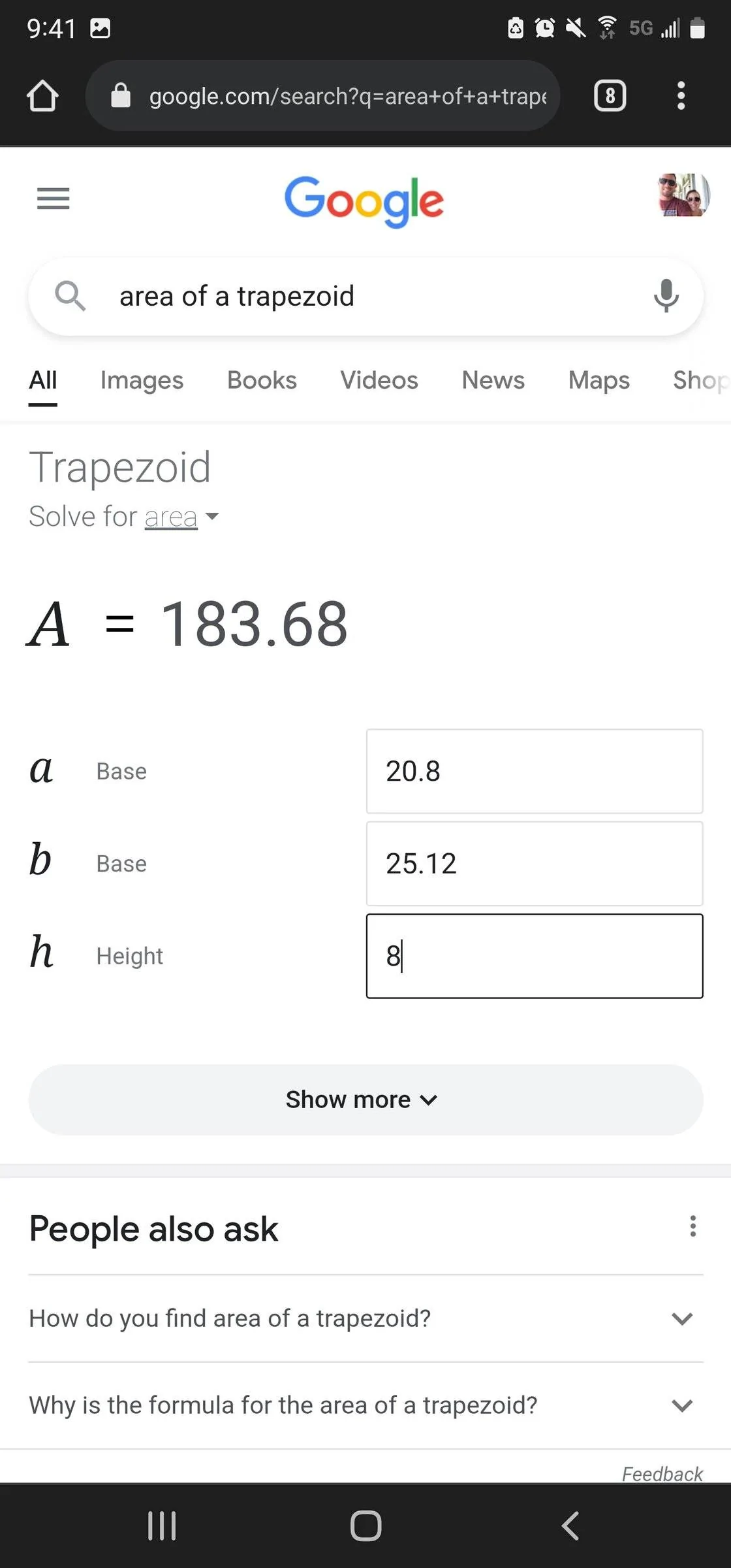

Just going by the measurements listed I got 183.68 sq. in. for the K&N black, and 148.37 sq. in. for the aFe pro. About a 24% difference.

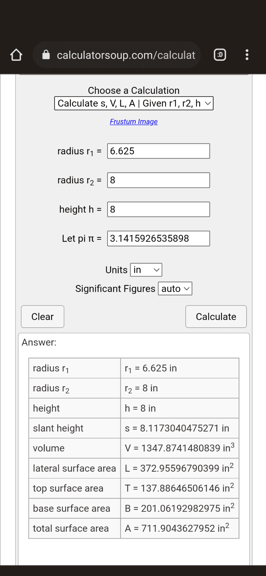

I got 711 square inches and my rough measurements of the stock filter I got 586 square inches.
With the filter I got it was like 611 square inches.
Here's what I put in for the k&n filter you posted.

@Superdannyboy You're inputting diameter in the radius field. Need to halve those numbers.
I multiplied the diameters by 3.14 to find circumferences and then calculated the area of the resulting trapezoid. Not precise but close enough for me.
@Dgc333 More surface area = greater capacity for fouling = longer filter life. Personally I can't be bothered cleaning a filter and certainly can't be bothered oiling one for that matter. Plus this one costs $69 (niiiiiiice). We may just have to agree to disagree.

Hahahaha doh!! I can't believe I did that. Fair enough, thanks.

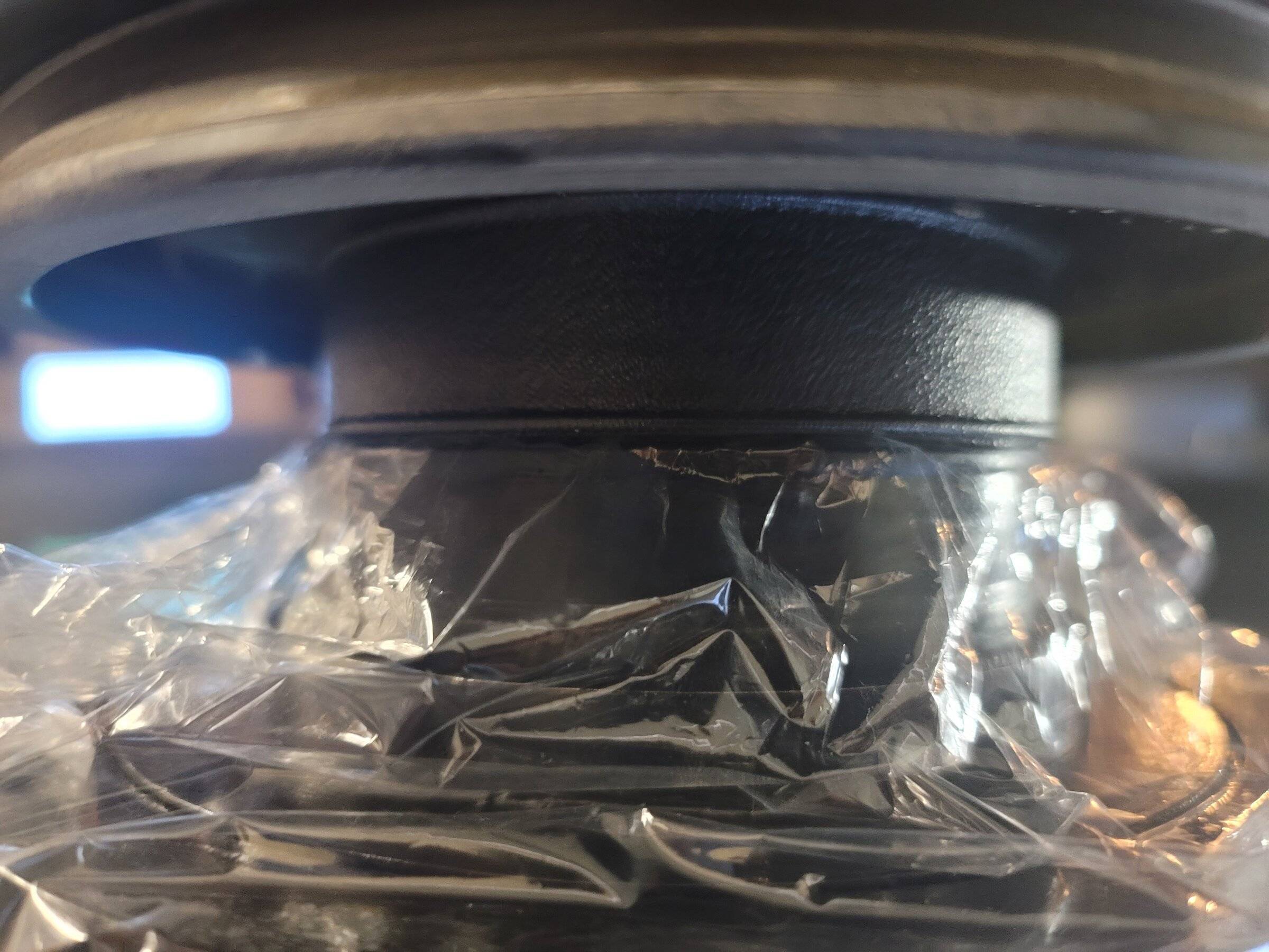

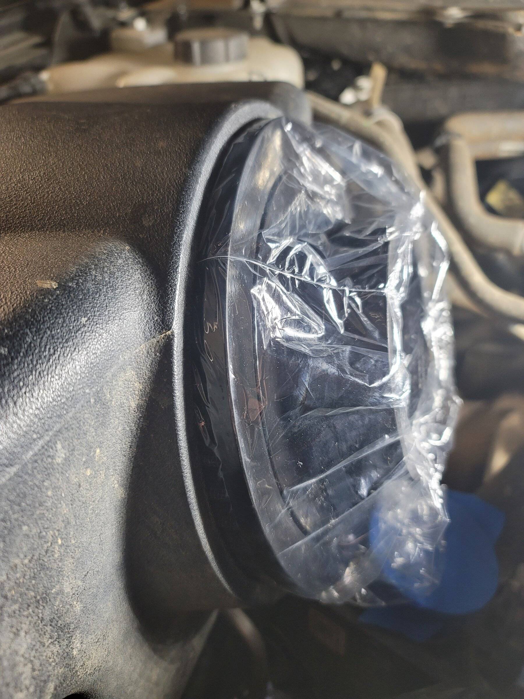

@Superdannyboy heads up the K&N Black doesn't quite fit into the Mishi box, and the inside diameter is also too small (4½" ID Mishi, 4" ID K&N)
I figured the furthest end of the filter being a bigger diameter than stock would be the potential issue.
I used a 4" inlet that's what I measured my mishi filter to be. It was a tight fit but it fit around the 90° elbow.

@Superdannyboy Here are the snags I hit.
Aha the second photo shows the bottom not being able to fit because the diameter at the opposite end is too big! Precisely as I suspected! (I just wanted to sound like doc from back to the future)
Well back to the drawing board. AFE for the win as a cheaper backup so far!

@Superdannyboy Hard to tell because of the shadow but the bottom end (8") was actually too big to fit through the opening (7¾"). So I don't know if the top end would've hit the inside of the airbox or not.
Haha this is what I enjoy. It would've been cool if it fit. Until next time! I only checked the filters that were in stock that day for pickup so there could still be others. I'll probably just stick with the AFE that I got.
