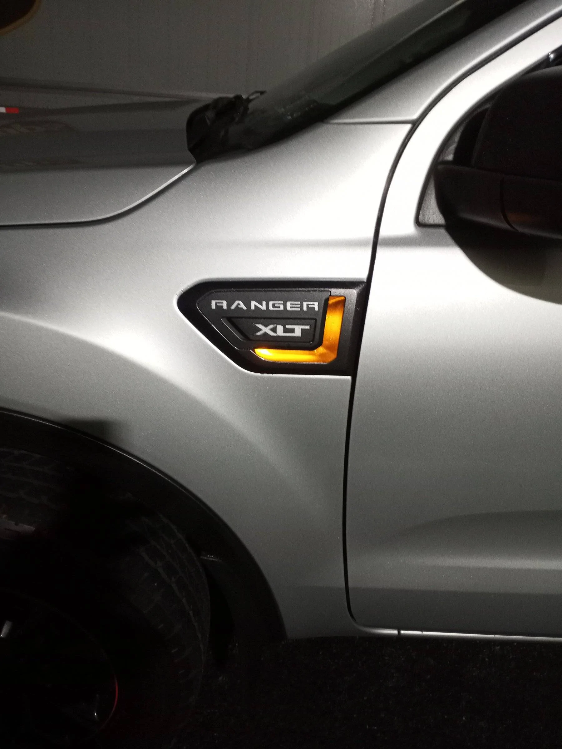

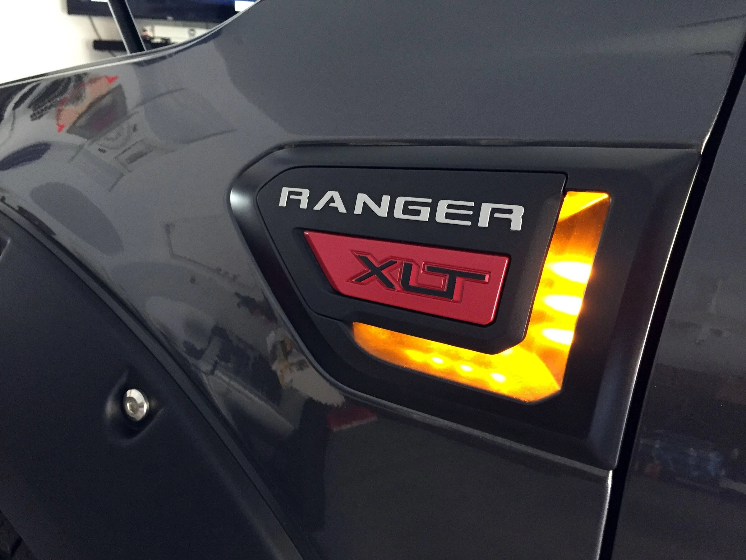

Fender vent parking/turn signal led's.
Nice...I didn't know you can buy these...I made my own...

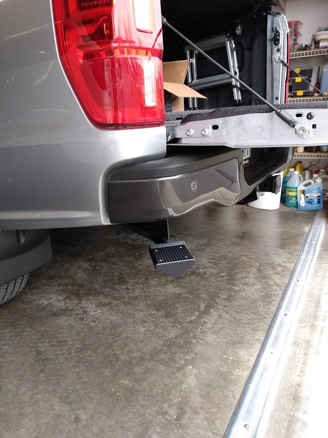

Nice! I had been debating the folding up one from Bestop or Amp, but high price is keeping me from pulling the trigger.
This is reasonable!
Just yesterday I could have used it!

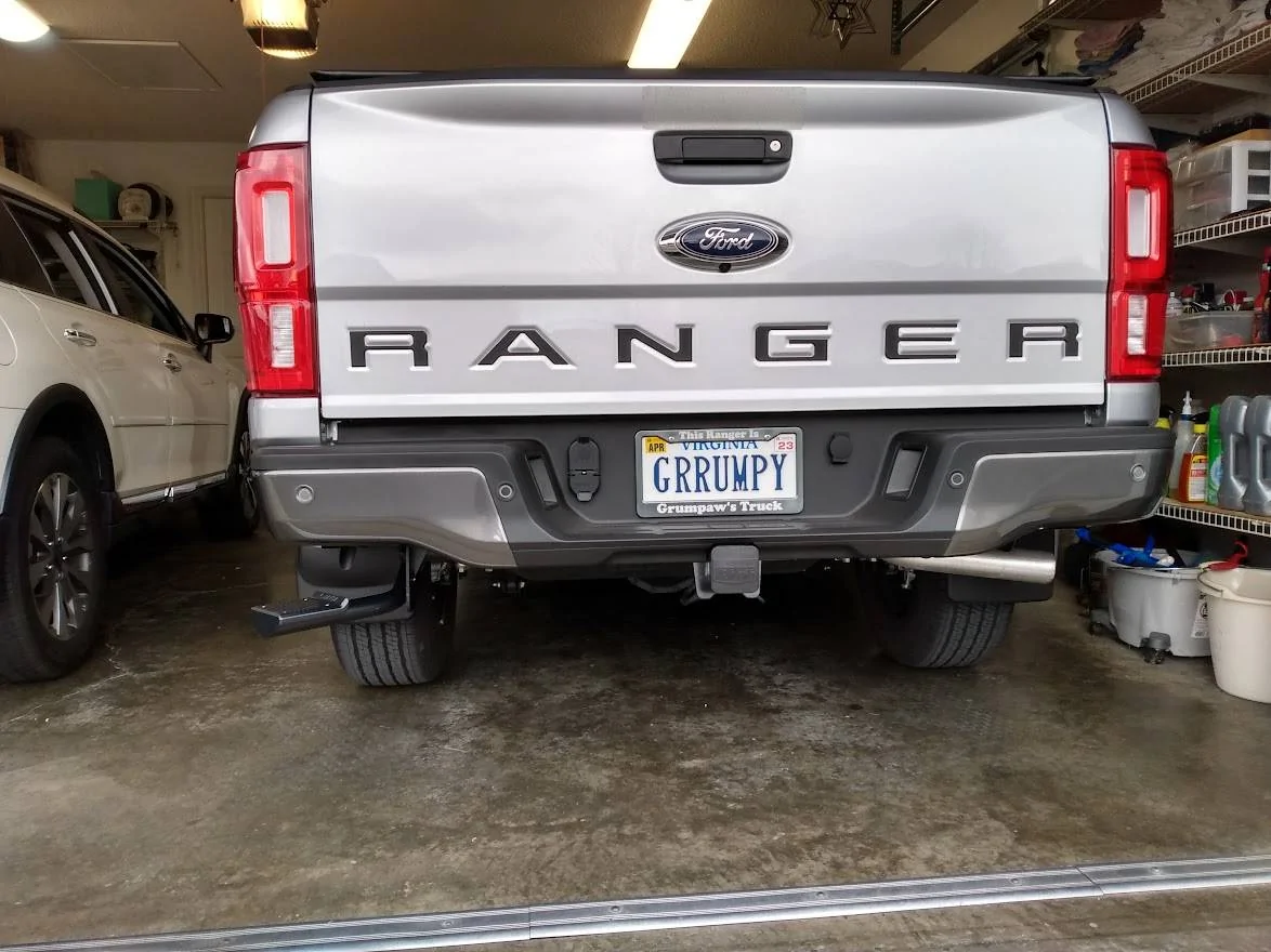

Can you post another pic of a rear view with tailgate up?
Rear view, and view from top corner of bed...step barely protrudes out more than an inch...no way your going to bump yourself unless you try.
Not as "visually" exciting as the lights, add-ons, ect. But for pure functionally this is hard to beat.
5,916
29,487
I like it.
I'm assuming the install is easy, 2 bolts and done?
Yup...two bolts that are holding the trailer hitch on (there are 3). Bolt comes out leaving a captive/welded nut on top of frame. Helps if you have a 1/2 inch impact wrench (I do) cause those bolts are on there TIGHT. Took me 2 minutes to install.
All steel with an aluminum step pad that has a "cheese grated" finish. Powdered coated.
Cheapest I found was Parts Geek...63.98 plus 10.95 shipping. Had it in 4 days.

That's not the same lol...and over budget...
I know. ☹
If I had one of those special printers that cut out any type of font, I'll cover up the top light with a black adhesive that spells out R A N G E R. The middle would be XLT/ LARIAT/ XL. The bottom could be the year. Or left as is.
It'll look as if the letters are lit up. Sadly I don't have such a device.
