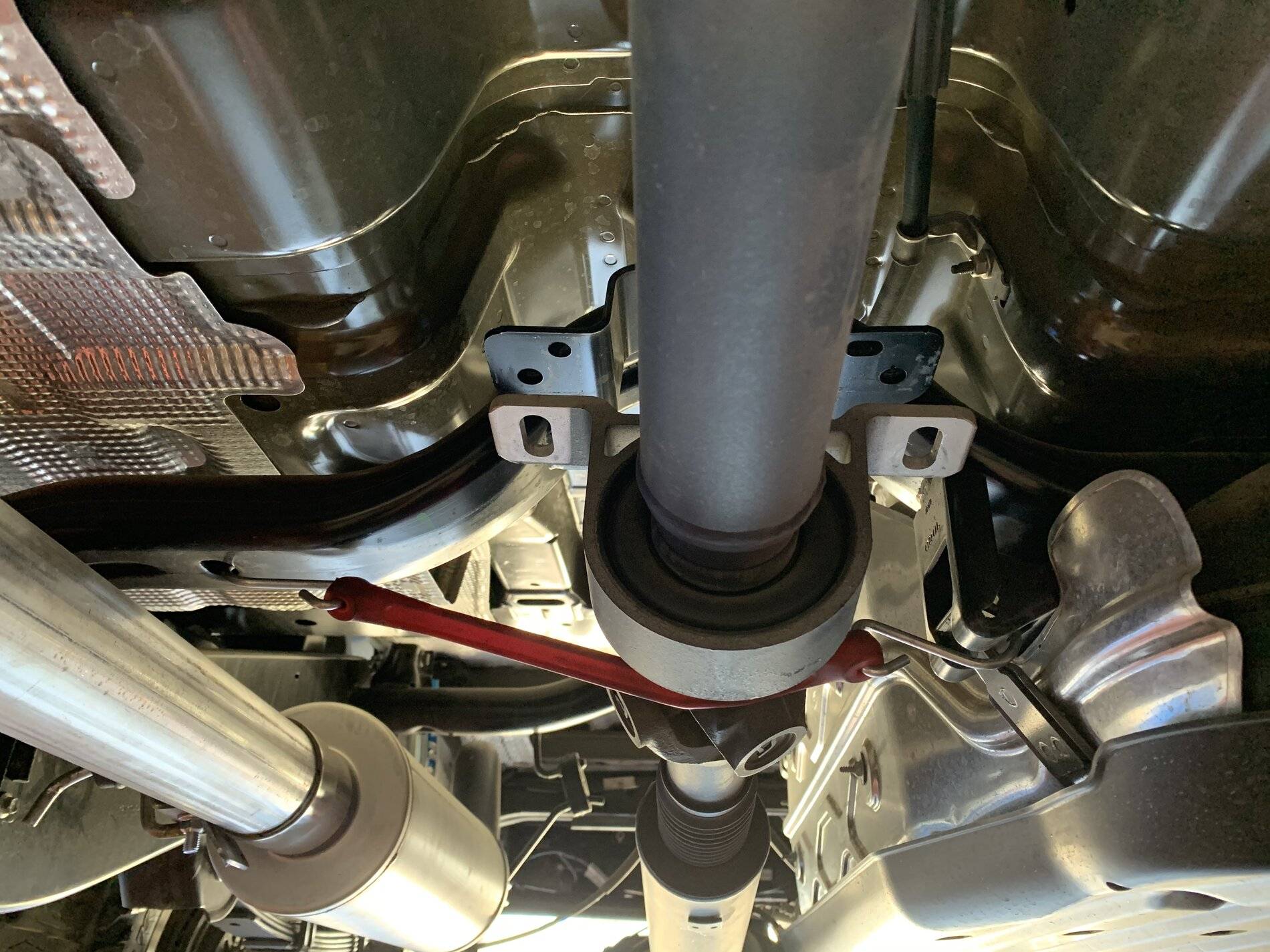

I had the TSB done it helped some but after I shimmed the center bearing 3/4 of an inch it is finally gone..
I'm a bit knowledge and time limited but am very interested in giving this solution a shot. Is there a how-to or helpful info that shows me what I need or how to shim the center bearing?

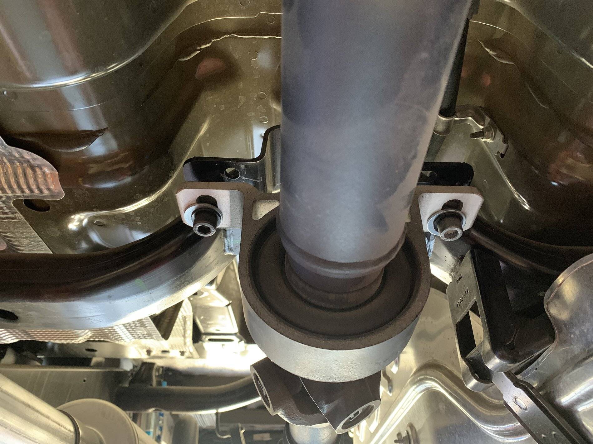

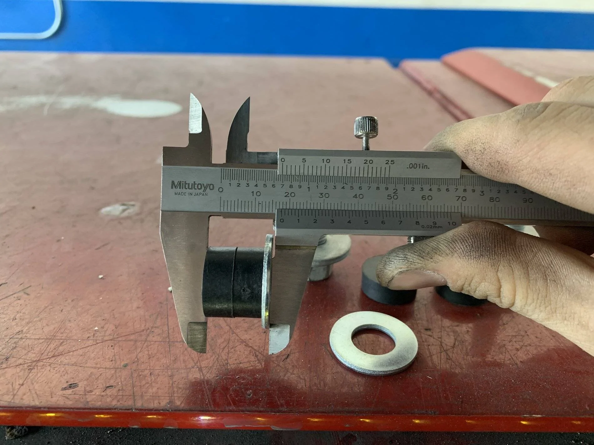

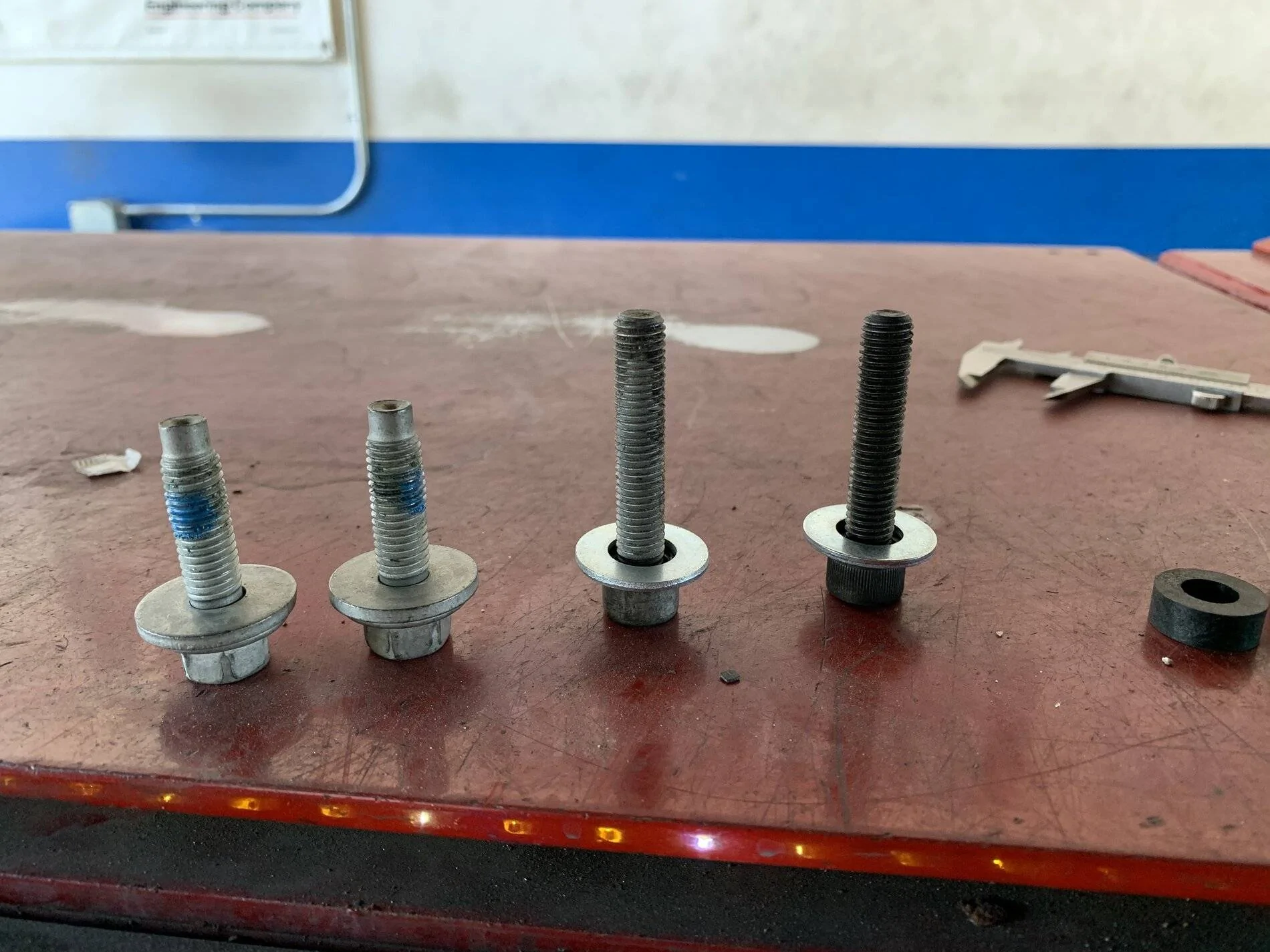

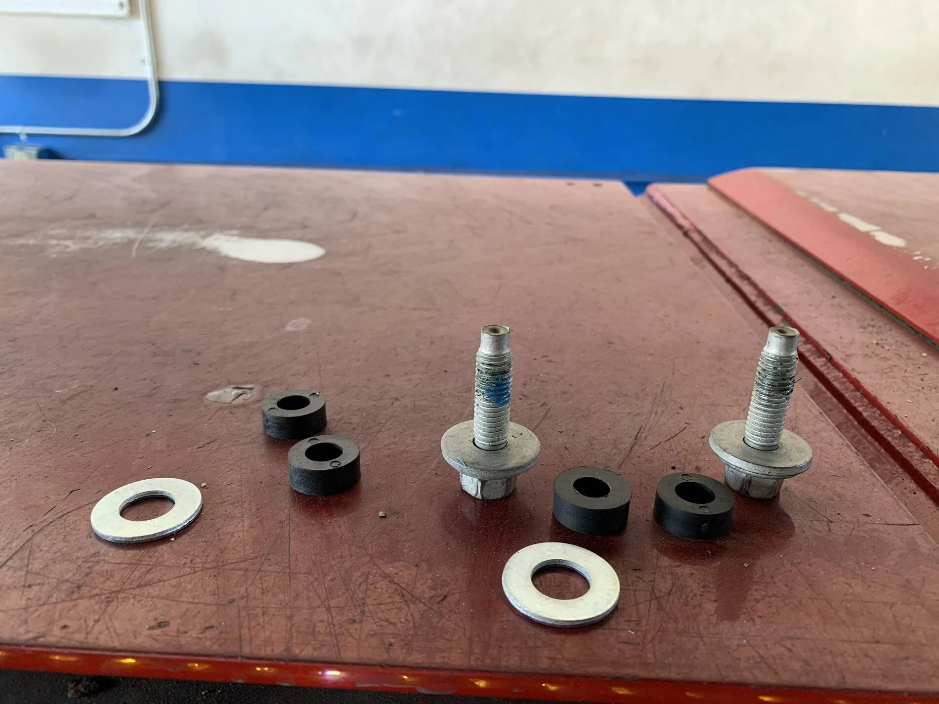

I had the stupid vibration from acceleration so i played around with some spacers and now its fully gone. Had to get longer bolts because the originals were too short once the spacers were on.
What material are those spacers? Some sort of plastic? Anodized metal? Would a stack of stainless washers work as well?
Polaris130
Mar 13, 2021
118
359
Sacramento
2020 ford ranger xlt
Some sort of hard plastic. Smacking it with a hammer wont deform them. You can use anything
