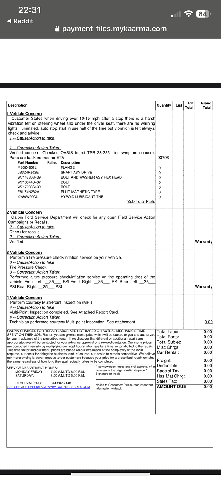

Took my CPO 20’ Ranger 4x4 with 23k miles in to the dealer this last Friday before the holiday weekend. Tech confirmed it needs TSB 23-2251 but that parts are back ordered with not ETA. Might just go the Tom Woods route. Here’s the invoice from the dealer
edit: shudder happens between 10-15mph and don’t notice anything after that even up to 85mph
