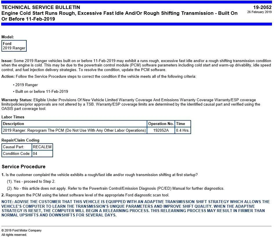

TSB: 19-2052 - 2019 Ranger - Engine Cold Start Runs Rough / Rough Shifting Transmission
Some 2019 Ranger vehicles built on or before 11-Feb-2019 may exhibit a rough, excessive fast idle and/or a rough shifting transmission condition when the engine is cold. This may be due to the powertrain control module (PCM) software parameters including cold start and warm-up drivability, idle speed control, and fuel injection delivery strategies. To resolve the condition, update the PCM software.
APPLICABLE VEHICLES
2019 TRUCK: FG P375N RANGER

Just got my Ranger back from the shop. They had to call Ford Corporate to confirm that my truck was eligible for the TSB (It was made before Feb 11).
They ran a PCM update and then some datalogging to make sure the transmission shift points were within spec.
I’ll drive it for a few days to see if that did anything.

It’s been 4 days since the TSB was done and the difference is night and day. Before the transmission shifting would be rough and overly aggressive, now it’s much smoother and I’m noticing the transmission staying longer in gear.
