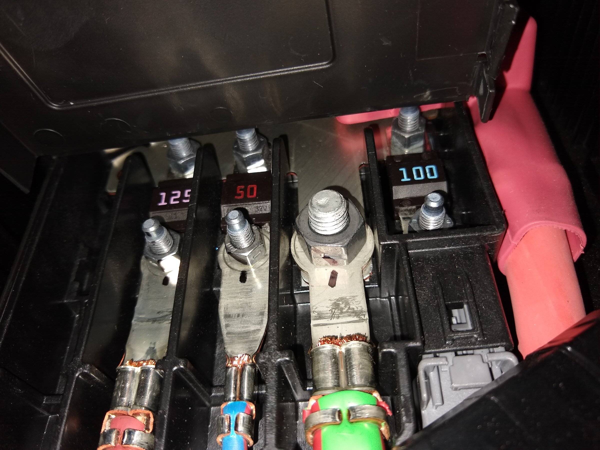

So I took the truck to Smith Cairns Ford and let the mechanic take a look. He had me come in and show him exactly what was wrong, and we confirmed that it is not the green fuse, but it's one of the knife-type fuses that are in the High Current box. There is a 4th power supply that is connected, but there's no fuse installed where the harness pigtail would attach to the power distro plate inside the box. We took a look at another Tremor that they had on the sales lot, and that Tremor had the fuse that I didn't have in mine. He showed me the page in the service manual for the High Current Fuse Box, and the part was labeled "F5" on the screen, but we couldn't find a part number when we spoke to the Parts Dept. I will try and take a pic that next time I am out in the truck. They took a bunch of pics, and are consulting some kinda Engineering Department about getting a number, or if the harness has to be replaced. Do you know of any possible part numbers?

I was looking to see if my tremor had all the towing package fuses and while I had the fuse panel flipped up I took a pic. Maybe this will help. I believe you are referring to the 100 amp fuse on the right.
Yes that's exactly what I was looking at. The 100 amp fuse is missing from mine. Thanks a bunch for the pic!

AWESOME! I had no idea what type of fuse that is, but now I can probably just buy one and install it myself with some spare bolts that I have lying around. I may have to wait on Ford mostly because it's too cold to work outside and I have no garage to the work in. Thanks so much for the help!
