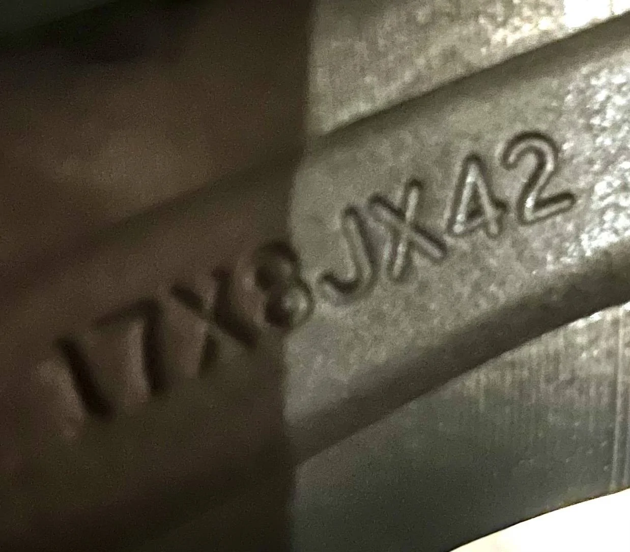

my original wheels are these. and I can assure you, there is a difference. I measured them.

Tremor wheels are 8.5” and +55mm offset.
Aonarch
Alec
Jan 21, 2022
731
1,795
North GA/ Montana
'21 Tremor, '16 Audi TT, '21 Ducati Hyper, '85 E30
I was dead wrong. They are 17x8 with +42mm offset.
Yup the Raptor wheels are 17x8.5 ET55. Aka the ones Ford Performance sells.
I'd rather have the Tremor size anyways. They should look the same poke wise.

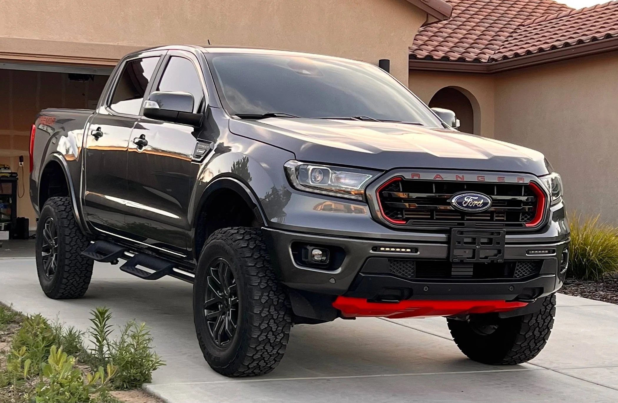

Perfect, so safe to say any Ranger UCA will fit.
Pretty much regular leveling gets for all Rangers do not work at all for the tremor
I actually had to buy what was an awesome piece but it’s a 2 inch spacer from fordrangerlift.com. Robby is the man and I just got it done today and kept the rake because I added 2 inches in the back.
no one will be complaining though when I have my fender flares in 33 x 12 50s!
Who am I kidding, they’ll still say they hate my rake lol
