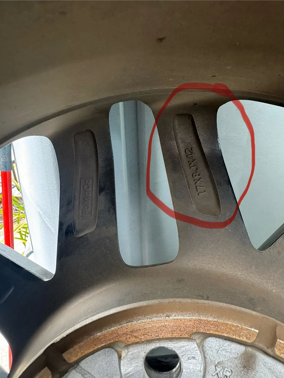

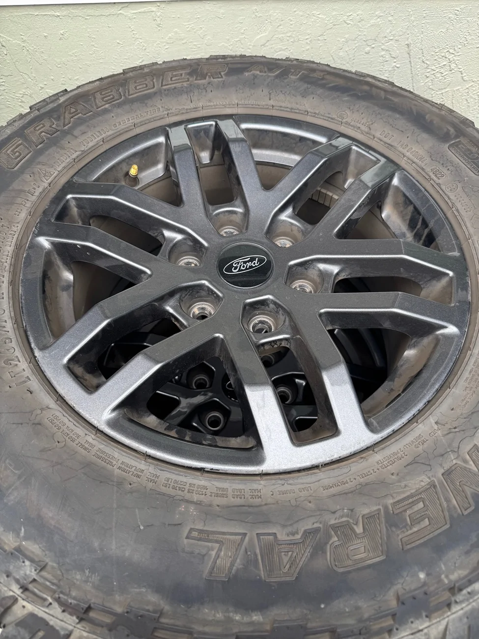

Tremor wheels are 17x8 with 42 offset I believe. (See pics below)

I’d plan to keep the tremor wheels as I really like their look, I’d also keep it simple and go with general grabber 285/70/17, again because they have the same profile as the stock 265/70/17s. Thanks again for the feedback, I’d been told that this setup would not require any high clearance intrusion beams
