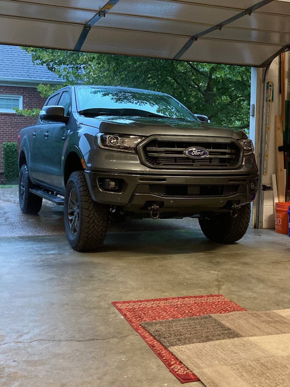

well the Tremor wheels do have a different offset than the Lariat rims mine came with and stick out about an inch farther. I measured both and wrote it someplace, but if you search I am pretty sure the offsets are listed here someplace.
here are tremor wheels and tires on my FX4 package with the Ford/Fox 2.0 shocks front and back

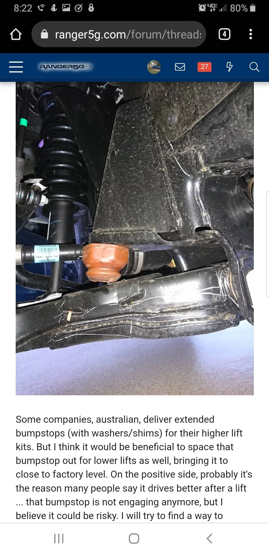

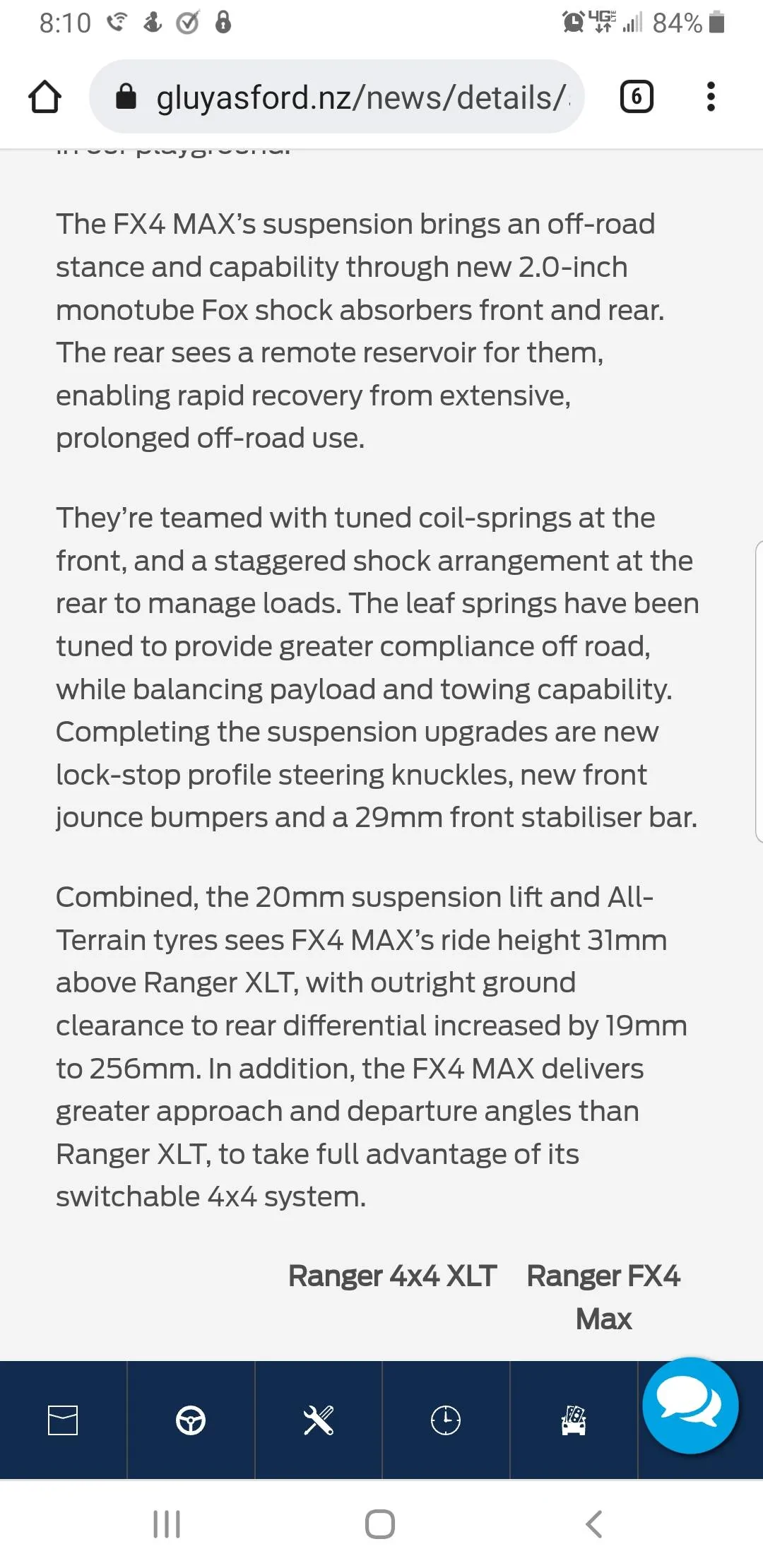

My question is, is the width purely from the different wheel specs and tires, or do the suspension components ( knuckles) make it wider.
Hopes this helps some. The Australian counterpart to the tremor. One of us needs to pull off tire and look for a lock stop and jounce bump stops . I have not noticed either. If anyone has info that proves this I'm very interested.

2021 ranger tremor
This a pic of Australian front suspension. I dont believe ours have this

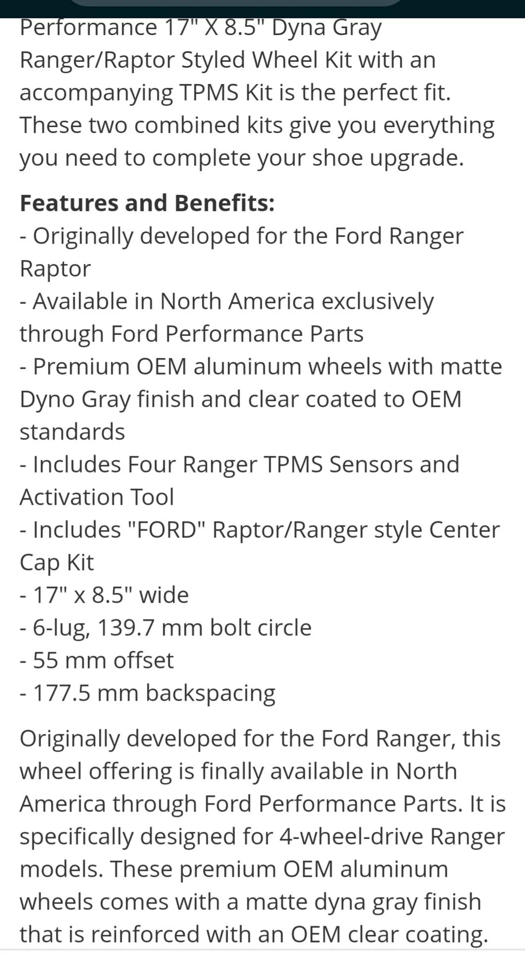

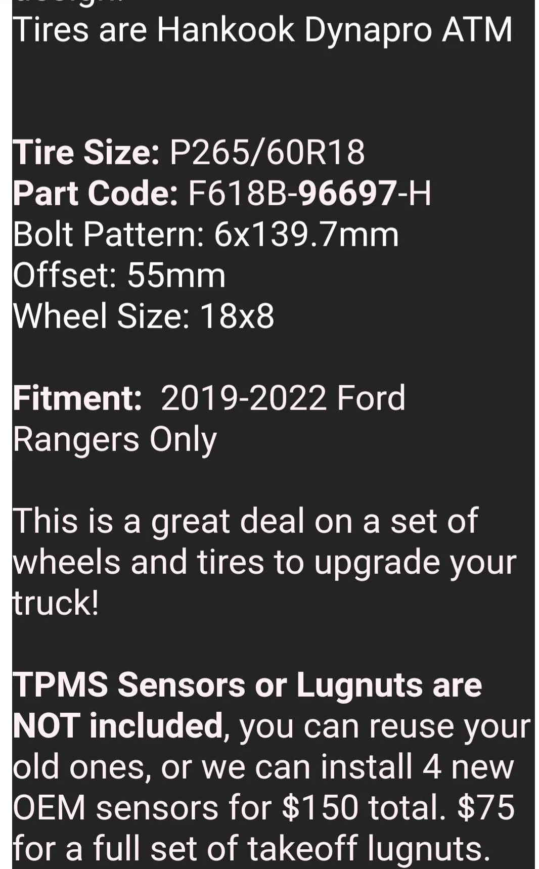

respectfuly disagree, I have both wheels and there is a measurable offset difference
The wheels both are +55. The tremor is .5 inches wider. That's the difference. I thought same as you before I read it. If these are you 18 " wheels? Tremmor is last pic.

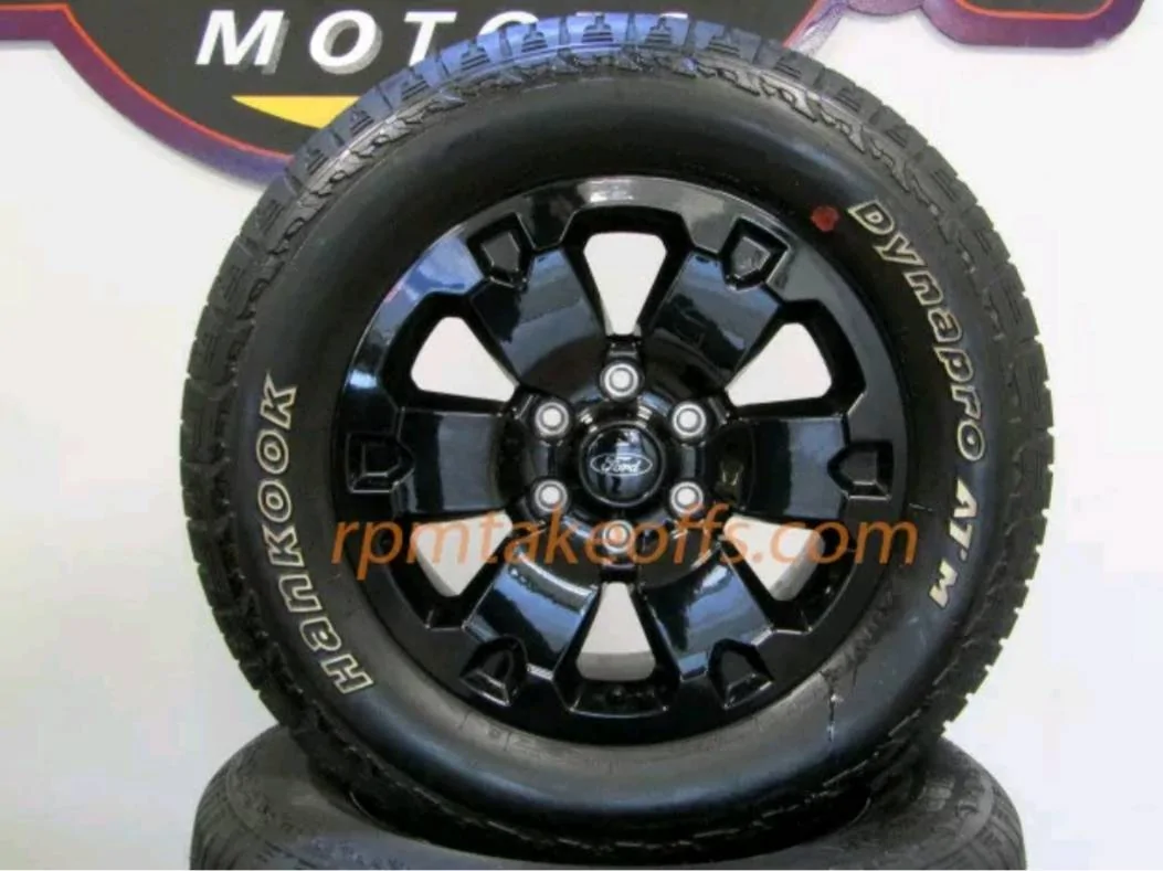

2021 Ranger Lariat
my original wheels are these. and I can assure you, there is a difference. I measured them.
