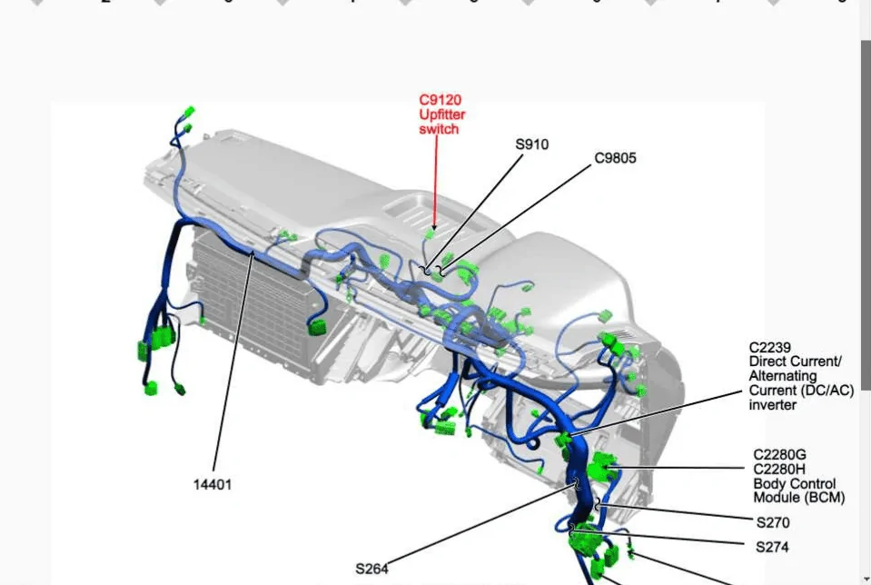

Hi Jeff,
I think we already established to the Ford service part numbers a few posts earlier with this image
As of right now the Tremor is the only model with Accessory Switches so it would be the bottom number.
- Benny

I see that you carry the upfitter switches.
https://parts.levittownfordparts.co...sIwRdbX-j1w2jlXLwXfF2H-6jnbrU50BoC7X4QAvD_BwE
Does this price include the whole wiring harness that supports the switches or is there anything else that is needed with it?
Hi Mike,
That price is just for the switch housing with pigtail. To my knowledge this is not a plug and play upgrade, I would expect custom wiring to be required as this is incorporated into the dash harness from the factory
Please let me know if you have any other questions.
Thanks,
-Benny
Mike in UT
Jul 29, 2019
85
93
Utah
2019 Ranger XLT Super Crew FX4, Hot Pepper Red, Tow pkg, Extang Trifecta 2.0 Tonneau cover, Rhino Liner, Lift Gate Assist, Ford black running boards
IT technician, retired soldier (11B, 19D)
Hi Mike,
Thanks,
-Benny
Thanks for getting back with me.
$1700 is a LOT of money for that, not including supporting wiring. Going to have to think about it.
