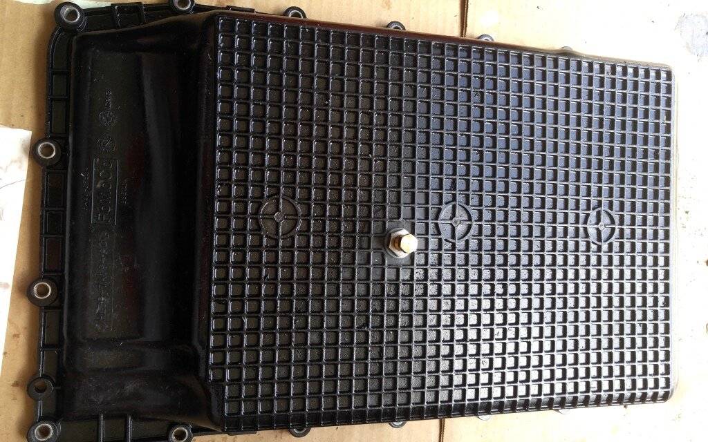

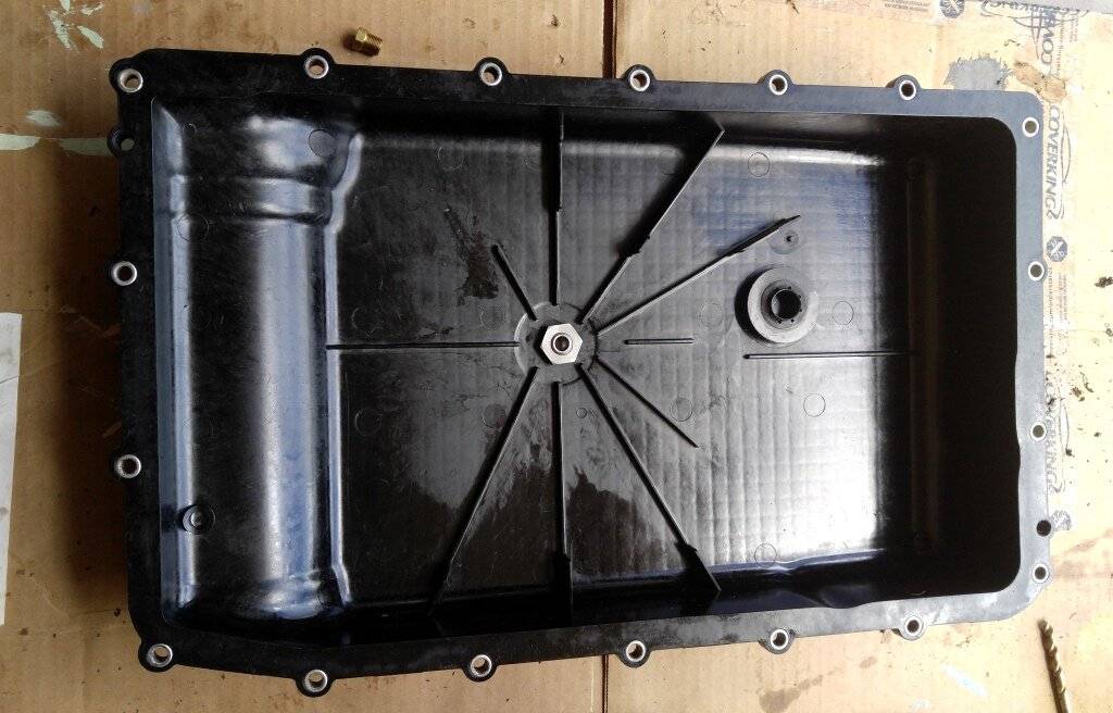

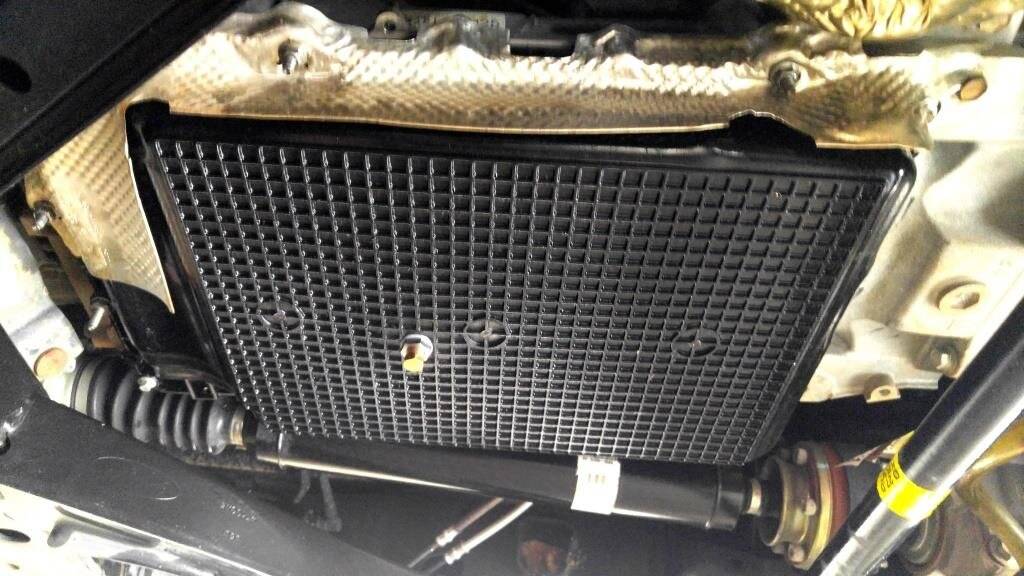

Transmission Plug Kit Installed "$12.95"

Looks Good, but just curious without physically looking at the Pan.
Are the external grid lines - (omitted at that spot) or did you have to level them off with a die grinder?
Also, for those that want to do this (mod) what drill size for the hole?
