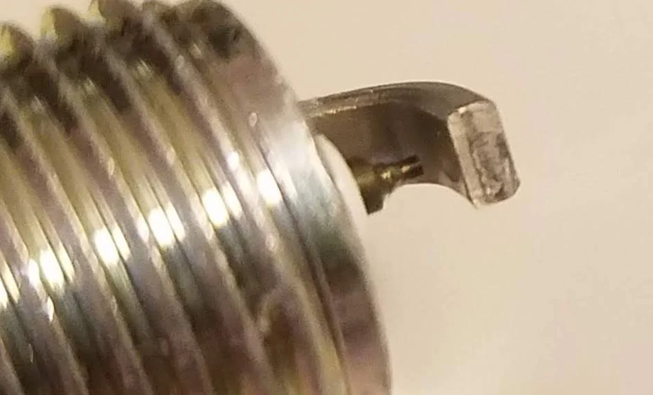

@Frenchy Hmmm, the replacement plugs look different when I zoom in on the electrodes, both in electrode area, and color of both sides.
Did I get the wrong ones? Amazon said these Motorcraft SP578 are compatible with the 2021 ranger, so I assumed the part number was just an alternate Ford designation...
Stage3 also has these same ones here, so now i'm unclear whether the 12405 (per ford manual) or these are the correct ones.
And Advance auto parts has these which calls CYFS12YPT the same as SP578, but doesn't seem to relate to 12405.
The packaging on my new ones say CYFS12YPT.
If not mistaken that is normal on Motocraft plugs
Thanks. Just to check, what is "that" referring to? The fact that the plugs look different, or that the part numbers don't match?
