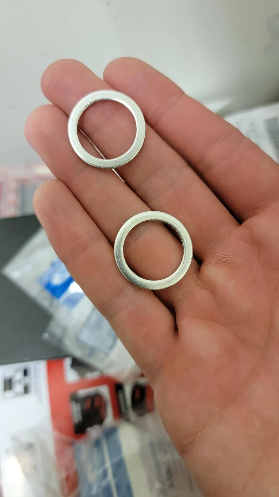

Brett Burke from the “2019+ Ford Ranger Club USA” group on Facebook wrote the following in blue. I thought this would be interesting posted in here.

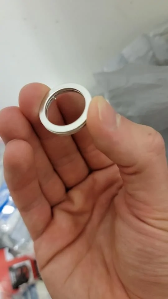

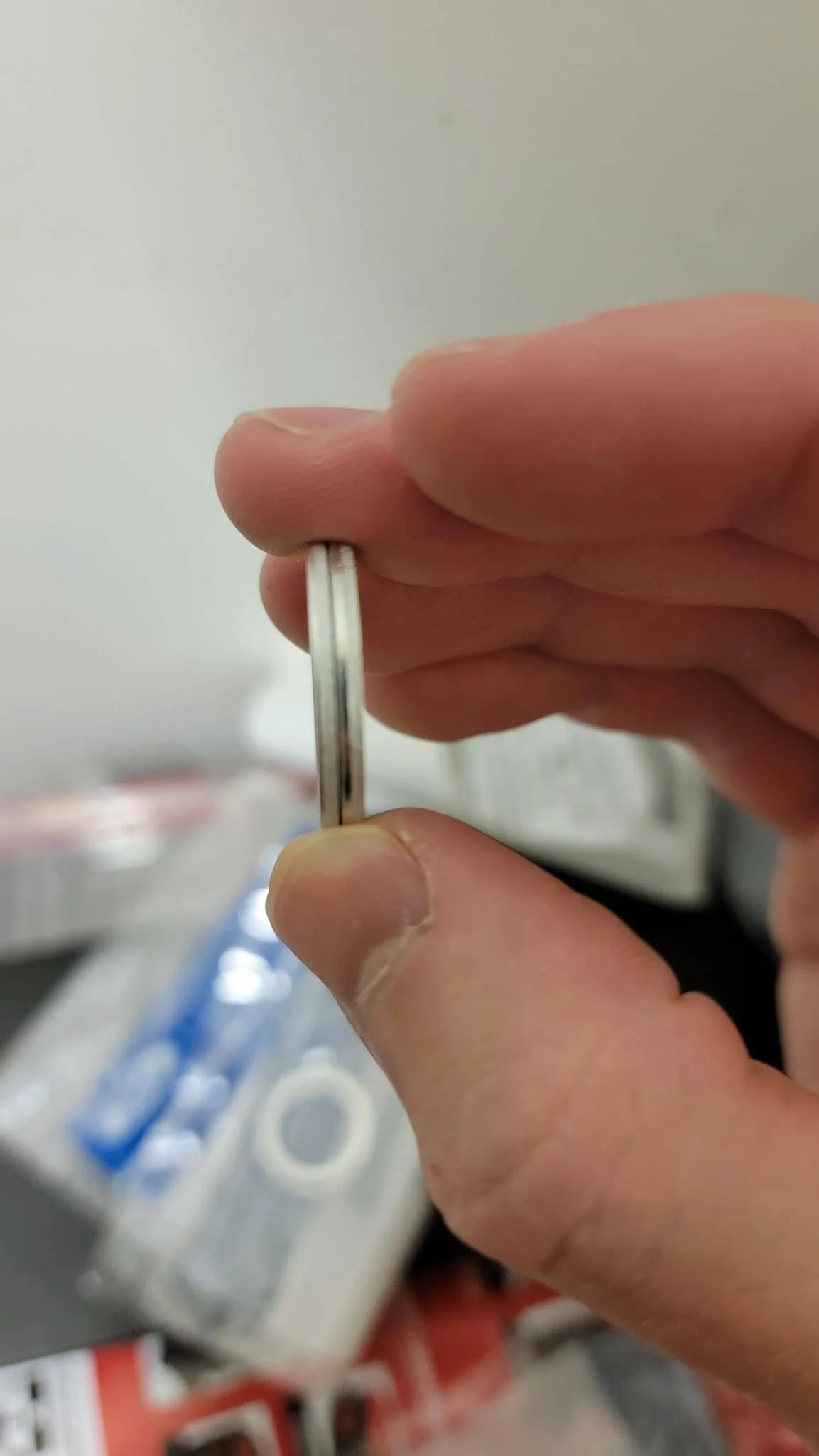

Ford is charging 16 dollars for this stupid washer, EACH. I bought 2 cause i needed them, a micrometer caliper tool and a 470 pack of mixed washers from Amazon to verify if something that is much cheaper will work. Tonight I can safely say that the Amazon kit with M18×24 washers will work.
Don't overpay for these, they do look a TAD thinner but not by much at all. Looks identical to me. Link below for the pack I bought. Your whalecum, excuse my ugly paws
Swpeet 470Pcs Automotive Metric Oil Drain Plug Gasket Aluminum Flat Washer Assortment Kit, Including 18 Different Sizes - M6 M8 M10 M12 M14 M16 M18 M22 M24
Amazon Link
