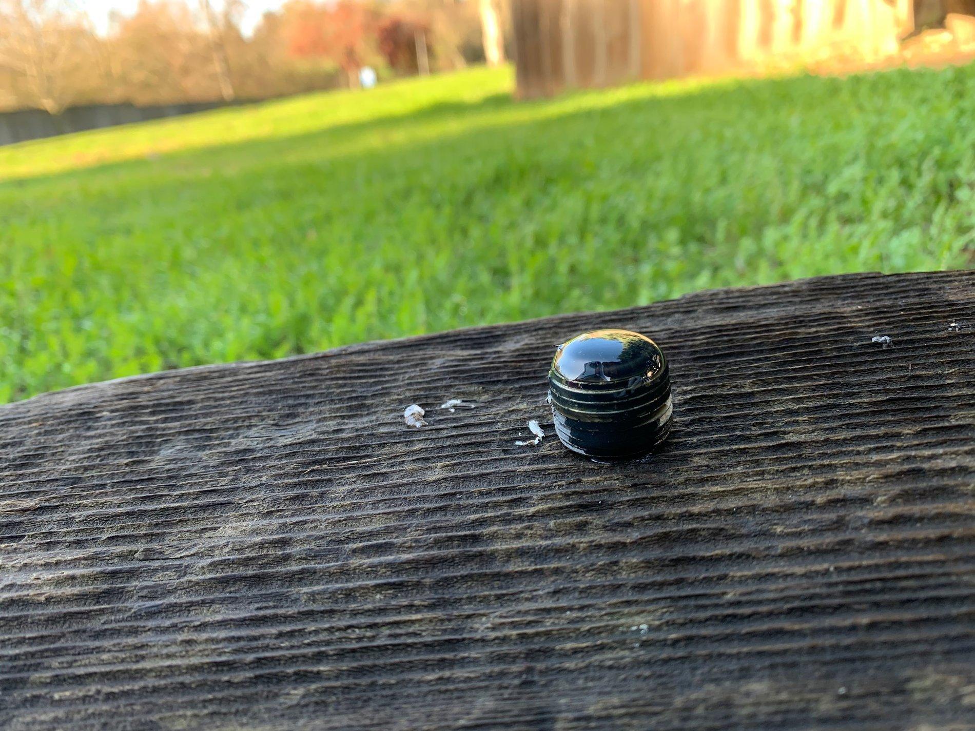

Changed my transfer case fluid yesterday and man it was dark like used motor oil. The fluid didn't have a burned smell or anything like that. The drain plug magnet didn't have a lot of metal on it. Pretty non existent really.
Oh yeah 35k on the clock. Might start doing this every 30k.
Majority of the wear occurs early on. On my old truck I changed the diffs and transfer case every 30k and by 90k they were draining out pretty clean.
