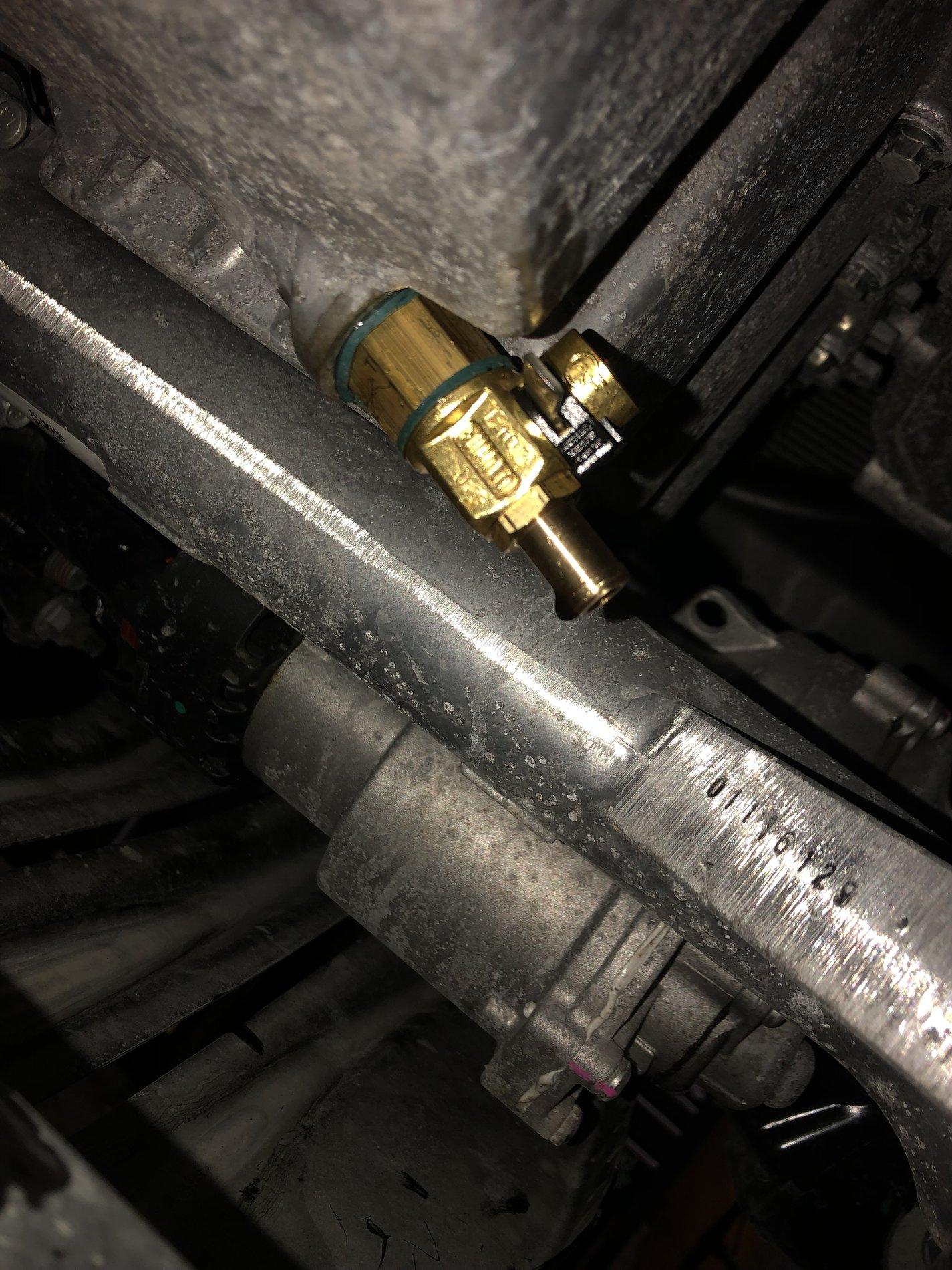

It's a drain valve that replaces the drain plug and you don't need tools to open and close it. I had one with a hose barb on it on my old Rangers because the Superlift cross bars and skid plate were below the oil pan and made one hell of a mess. A piece of hose made it so I could direct it around everything and into a drain pan.

If you do he fumoto, be sure to either get the 107n with the extension or the 107sx. I have the 107n and extension, but didn’t have the extension when I did the oil change, so both of these options are unconfirmed.
Question....by “extension”, do you mean the 3/8” hose that connects to the nipple?
t4thfavor
Chance
Feb 5, 2019
2,593
2,328
No, by "extension", I mean the metric threaded pipe extension with a male on one side and a female on the other that the Fumoto threads into so it clears the bottom of the oil pan.

As an alternative to the Fumoto valve look at the Valvomax valve. Uses a check valve type setup instead of the external lever of the Fumoto. Has a sealed cap and uses the hose connector to open the valve so it's easy to open and close. Last oil change I didn't need to remove skid plate. On other plus, US made.
