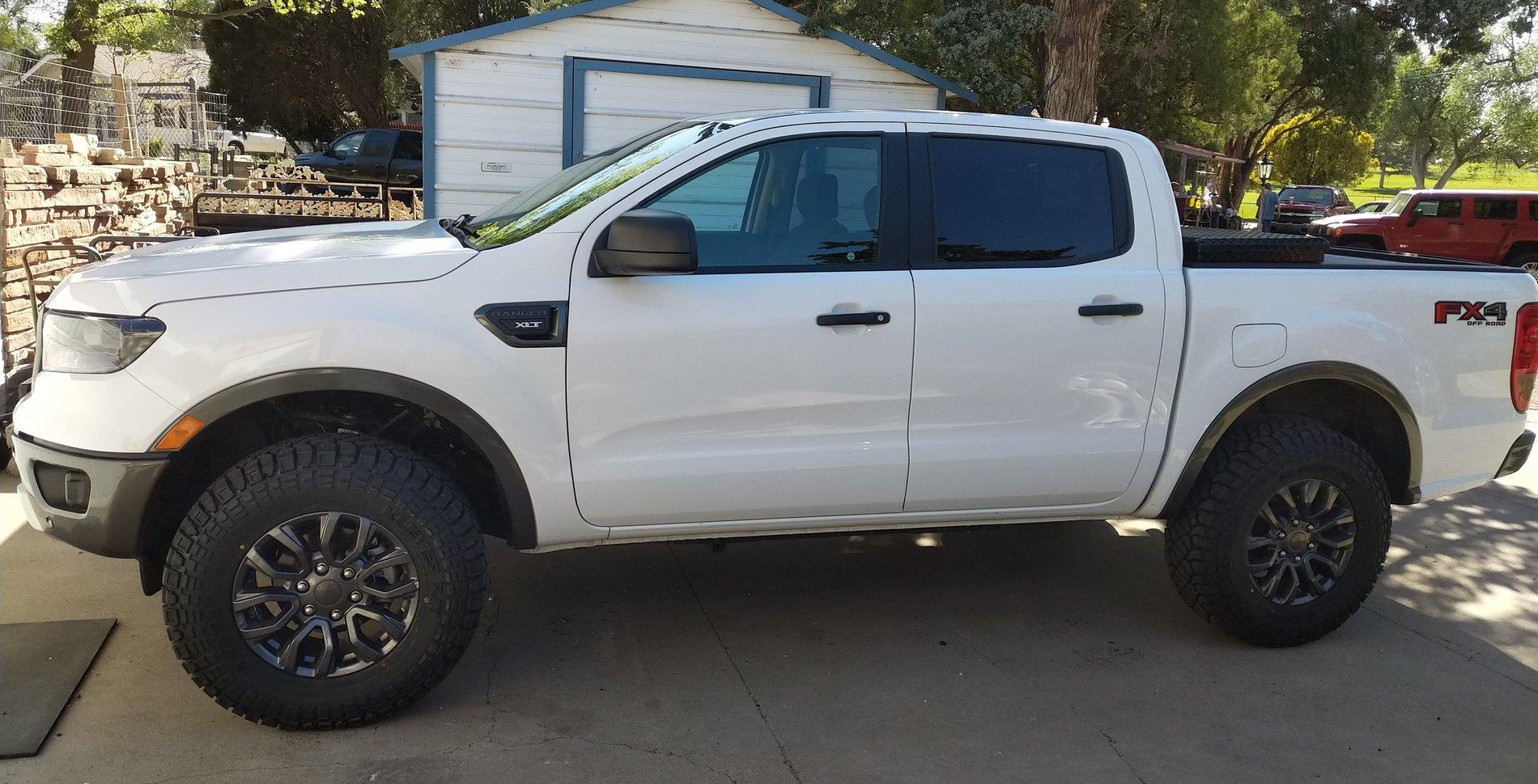

So I'm going to install 33x10.5R17's on stock rims with a 30mm hubcentric spacer and a 2.5 inch level... Thoughts on it working? I think I'll be ok as people have used 255x80 17's with just the level and stock.... so that would be 33.1X10.0R17 so i'm 1/2 wider, but a tiny bit less diameter,
Chris D Hall
Feb 10, 2020
56
Amarillo, Texas
F150 and Edge
Network Operations Manager
I'm tired and hot... 96 here today and I'm too old and used to the AC to handle the sudden change. So put my 33x10.5 17's on today with 1 inch hubcentric spacers. looks great thereviews on the Kenda Klever RT's are BS it's not as quiet as stock... I didn't really think they would be. It's an aggressive tire might take some getting used to. First I'll have to deal with the front crash bar. I was hoping I wouldn't have to replace it, but way to much rub. Best advice on removing/replacing them? Pic is misleading I've got plenty of room in the back

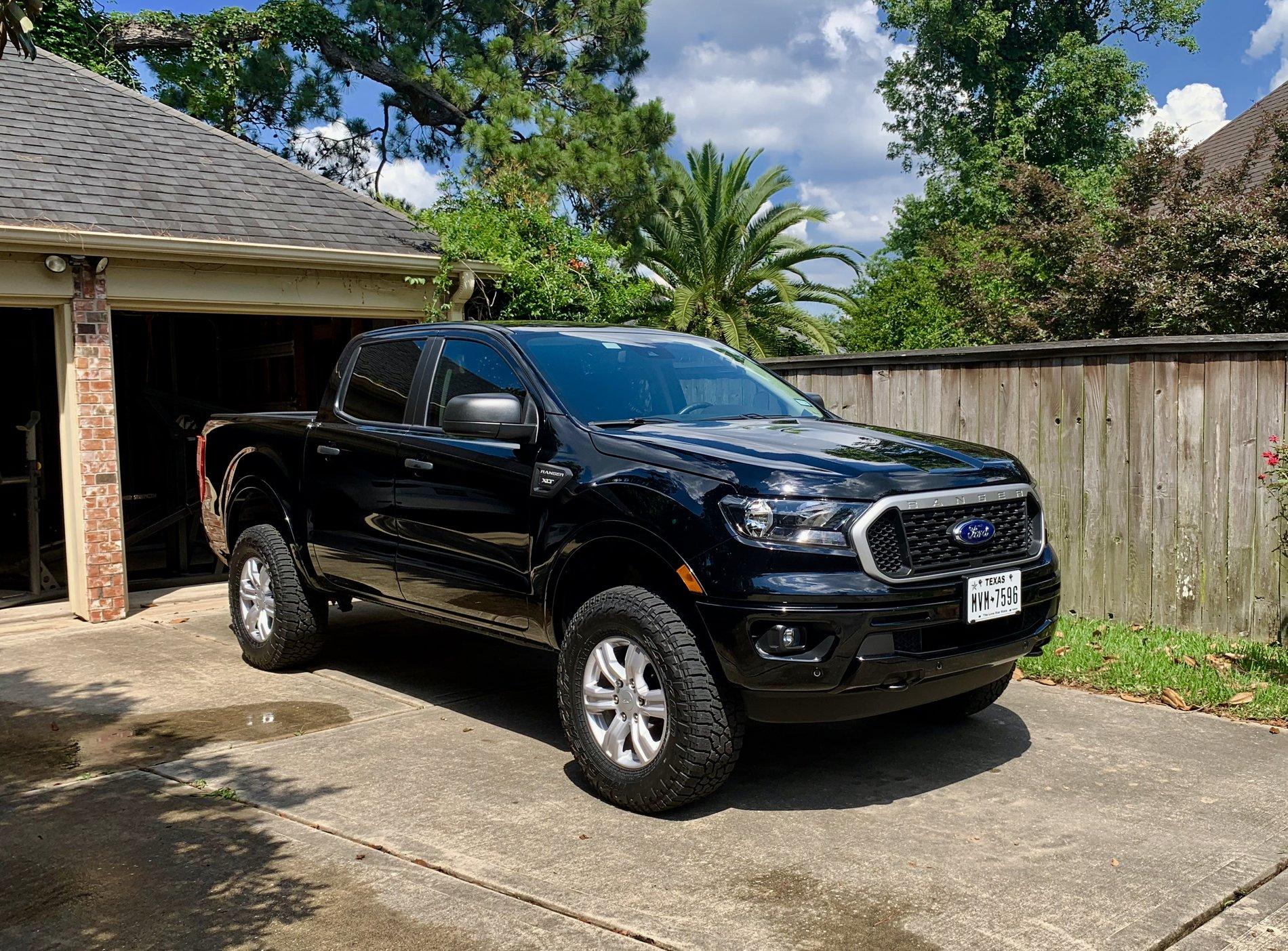

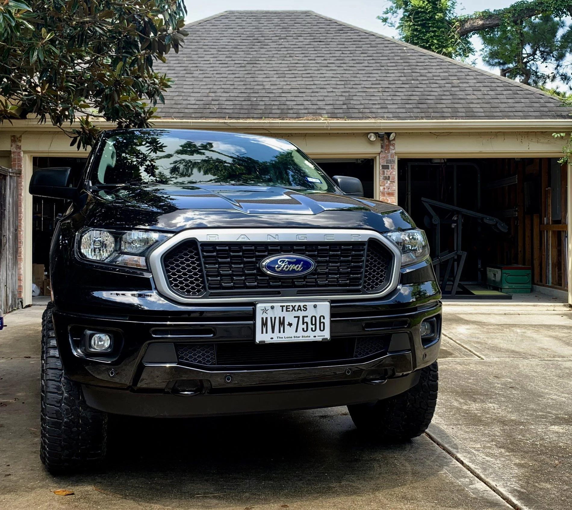

Just this week upgraded my XLT to a set of 265/70R17 from stock. I already had some 17 X8.5 25 offset wheels I had put on last year.
Once the new tires were put on, I noticed I'm getting rub at nearly full-full lock on the front crash bars, seemingly worse in reverse.
I'm getting a 2.5in front level within the next week and I'm wondering if that should clear this rubbing issue. I feel like I've seen differing posts regarding whether leveling alone will resolve this or if it's also an issue with the wheel offset.
Any answers are greatly appreciated.
