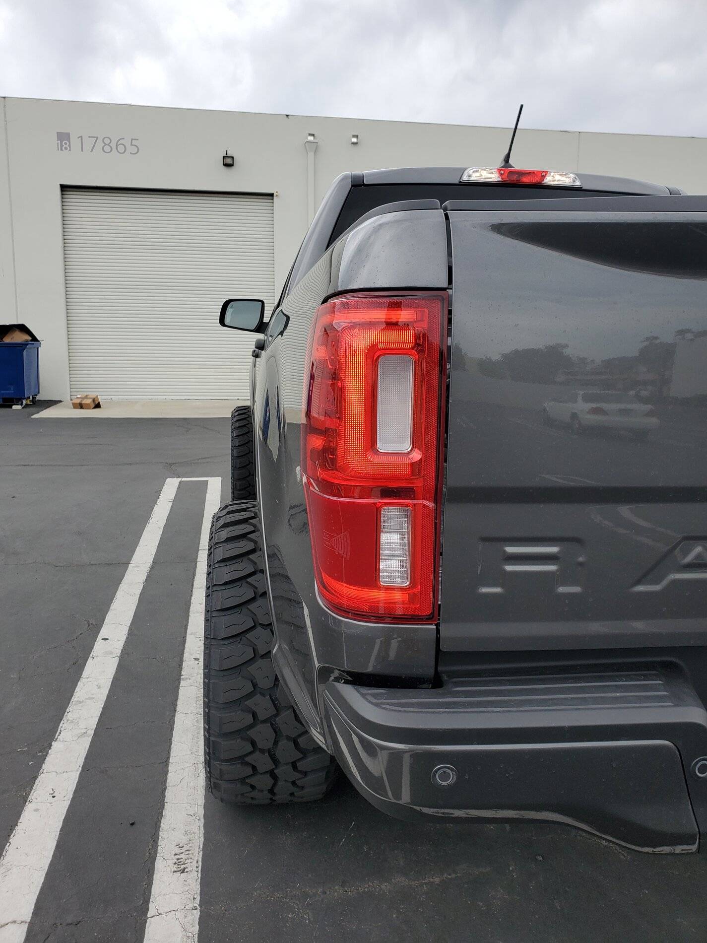

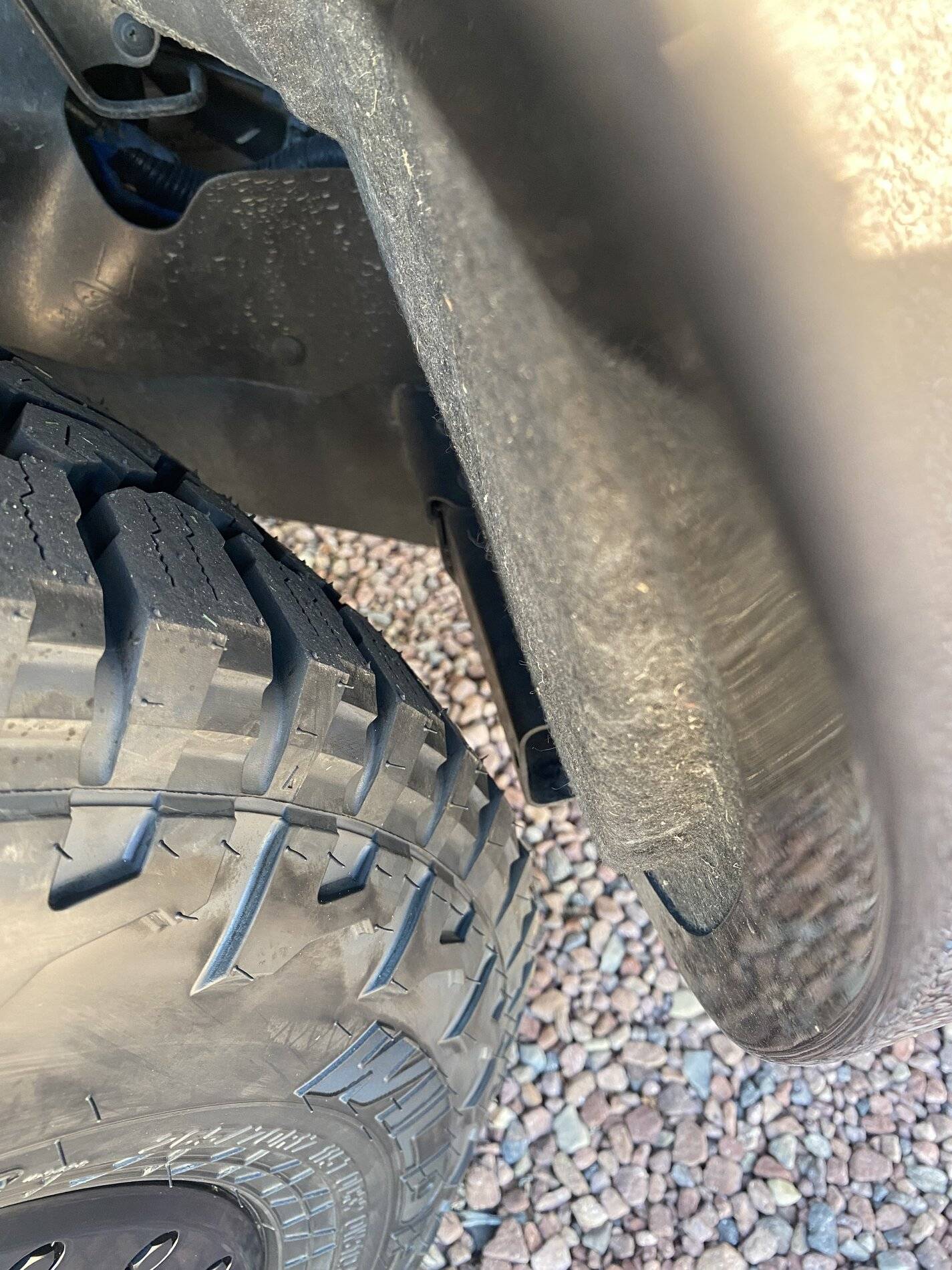

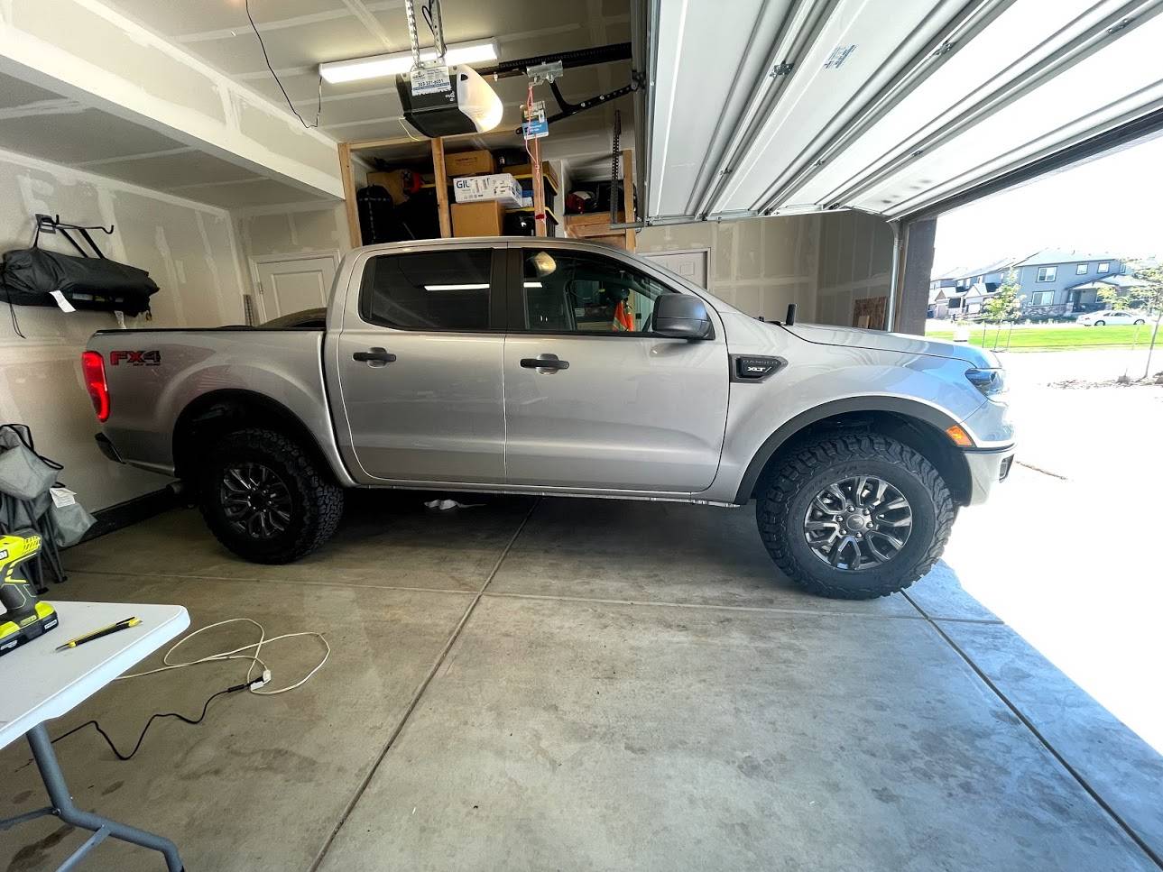

I'm tired and hot... 96 here today and I'm too old and used to the AC to handle the sudden change. So put my 33x10.5 17's on today with 1 inch hubcentric spacers. looks great thereviews on the Kenda Klever RT's are BS it's not as quiet as stock... I didn't really think they would be. It's an aggressive tire might take some getting used to. First I'll have to deal with the front crash bar. I was hoping I wouldn't have to replace it, but way to much rub. Best advice on removing/replacing them? Pic is misleading I've got plenty of room in the back

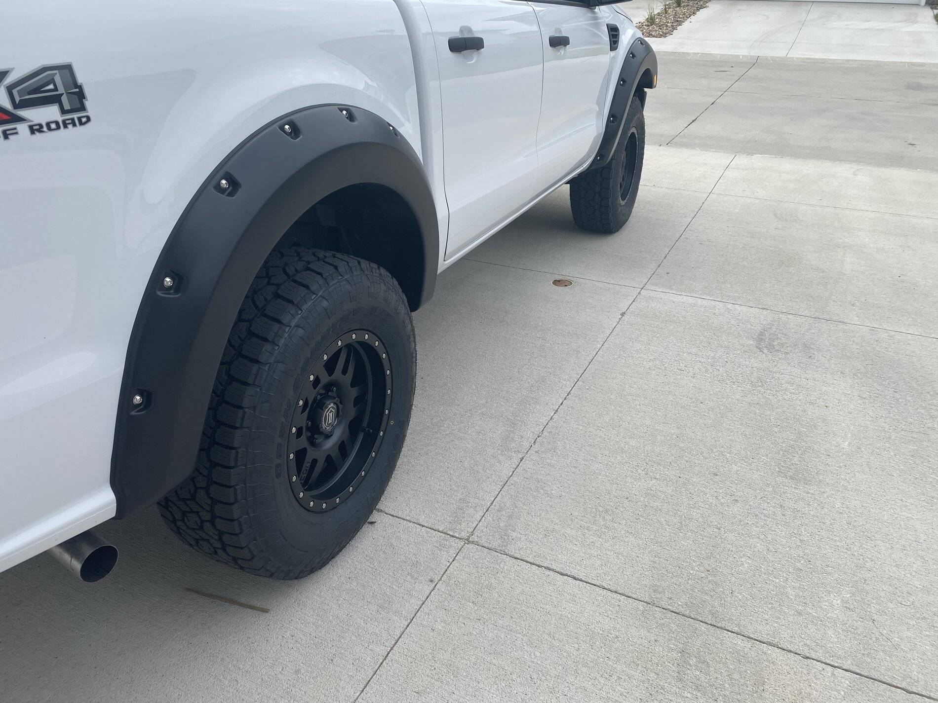

This is what I did to mine. Fox level kit. Fabtech crash bars, 17x8.5 KMC Summit wheels with 18mm offset, and 265/70r17 Nitto ridge grapplers. I originally was going to put 285/70r/17's on, thats why i did the crash bars. But I liked the look of the 265's better, No issues at all. Wheels stick out about 3/4 of an inch past the fenders. Ford performance tune and exhaust are next

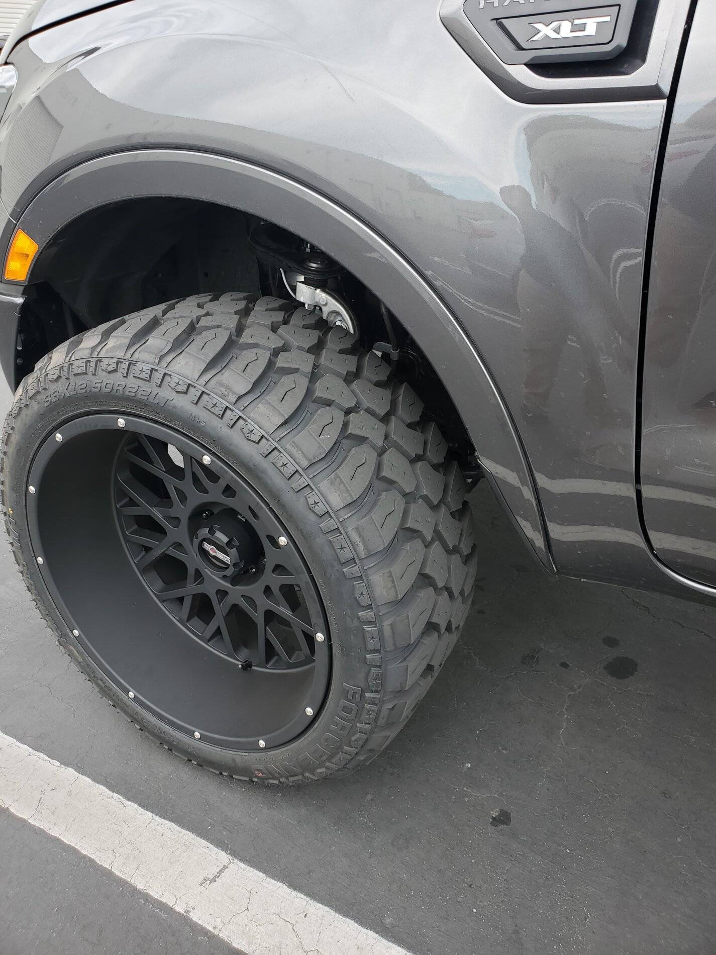

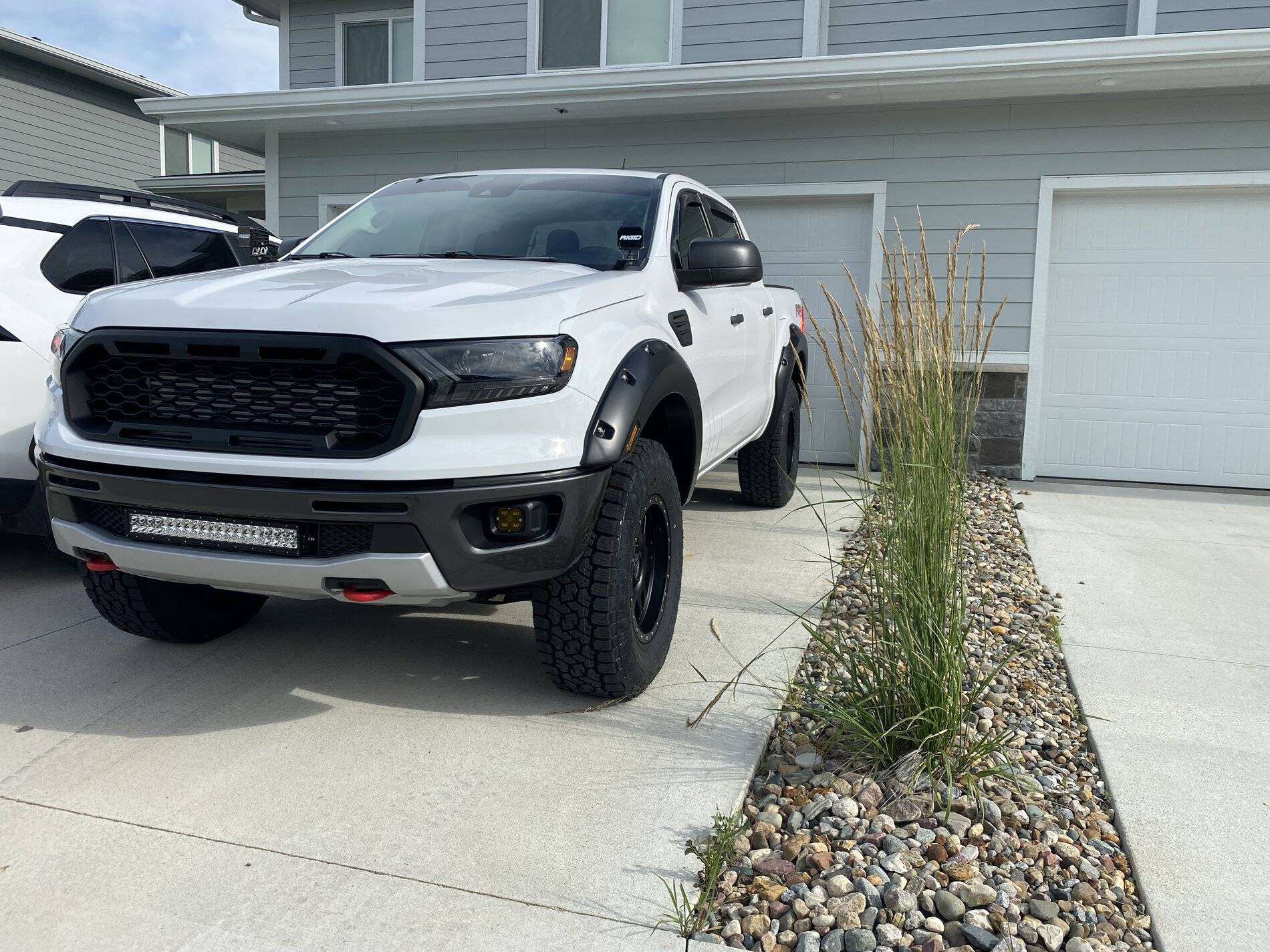

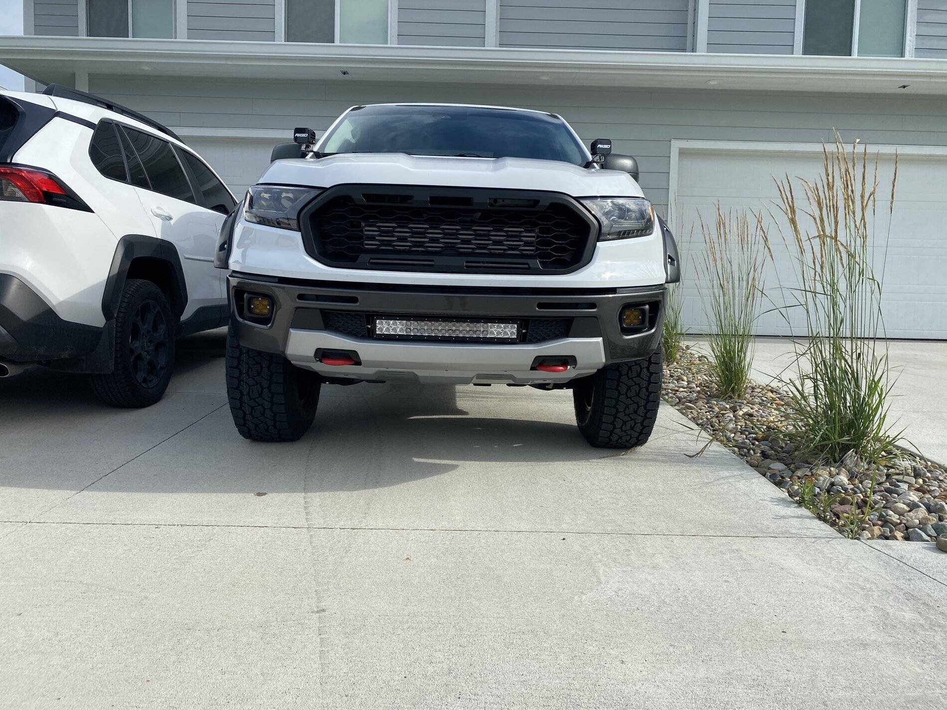

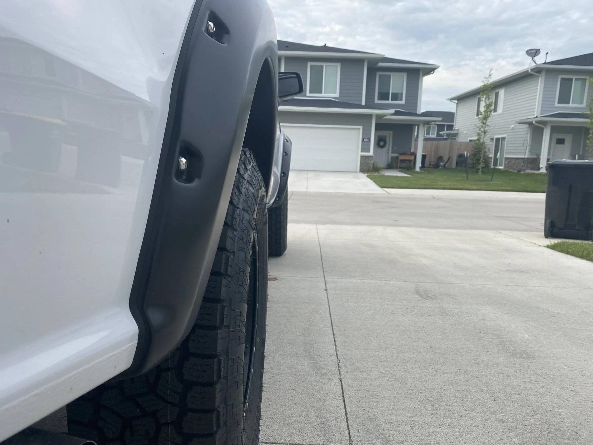

Looking for someone with the same or similar set up as me to answer this question:
mid inadd a 1” or 1.5” spacer to my set up, will I still have clearance? I have some bushwacker fenders on. But they are little wider then my set up and I want the wheels and tires to like a little more. But as of now, I have no running. But I’m worried adding spacers may rub. And I do not want to have to take those fenders off Bc I don’t want to have to put new ones back on lmao PIA
Here’s what I have
fox 2.0
Camburg UCAs
17x8.5 +25 six speed alloys
286/70/17 open countries
High clearance intrusion beams from ready Lyft
No rubbing currently. Even at full crank.

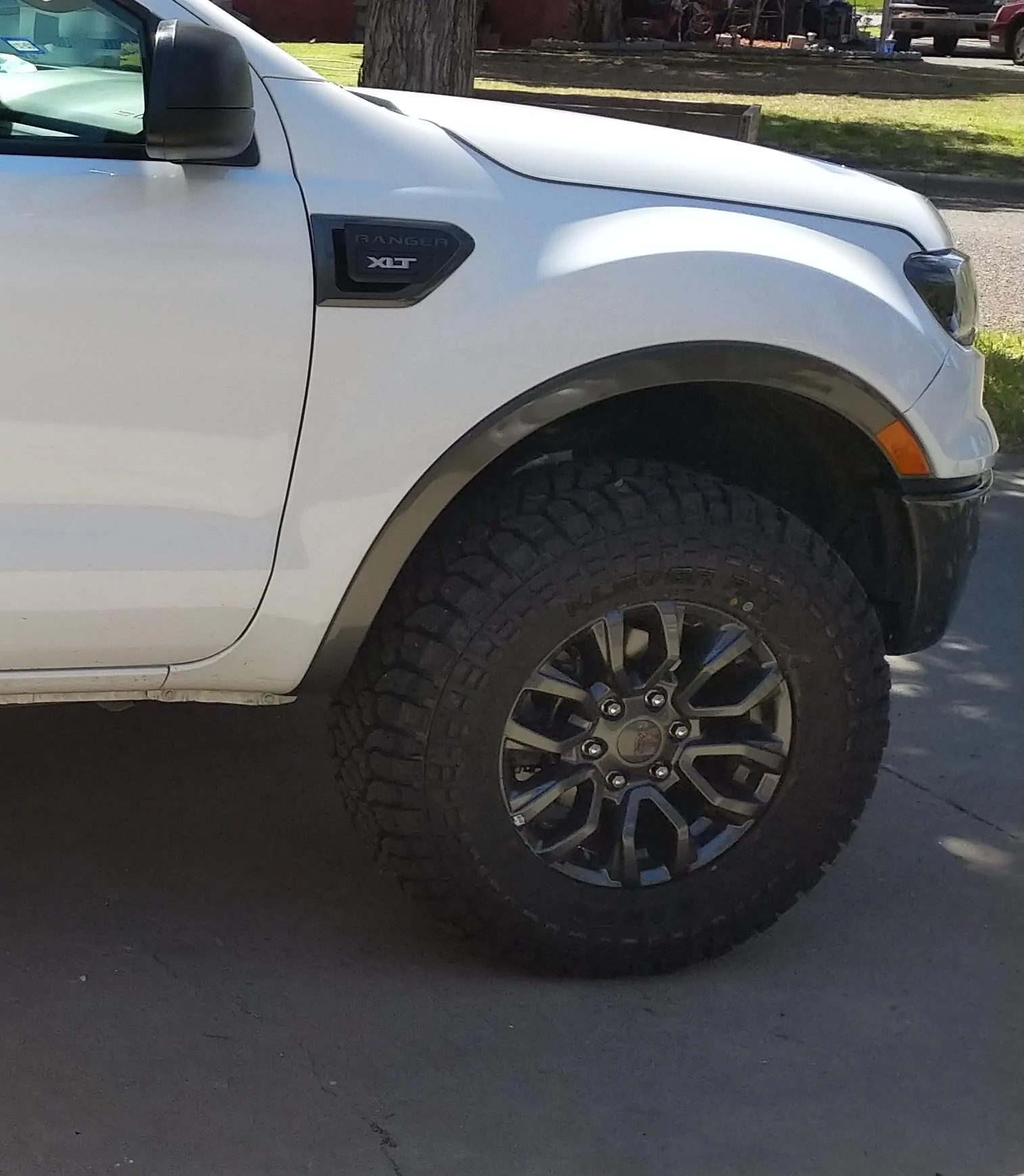

2020 Ford Ranger XLT
Systems Engineer

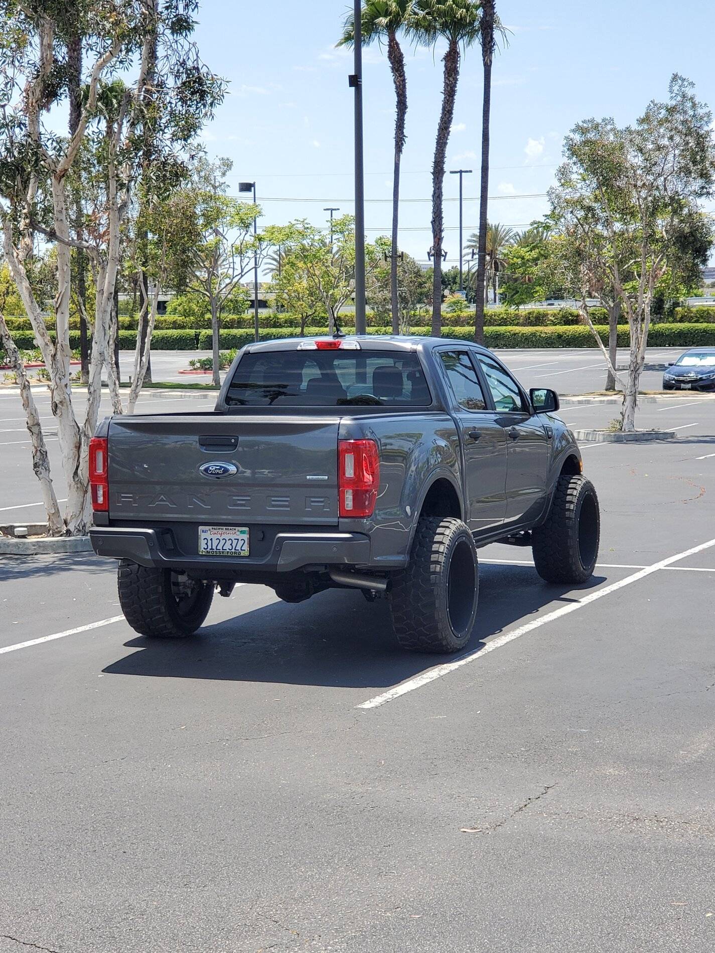

Readylift 3in w/ 1in block. 33x12.5r22 -51 offest. Trimming was definitely required

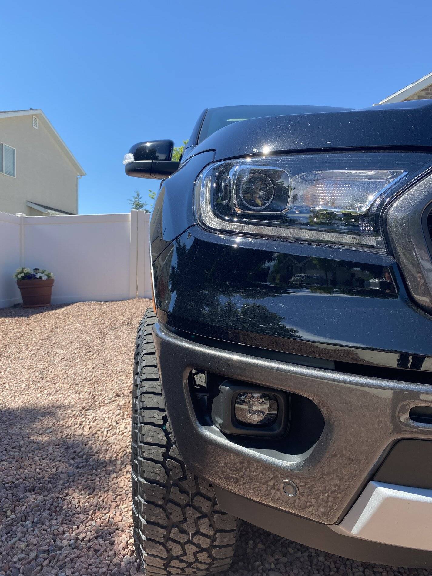

2020 Ford Ranger Lariat

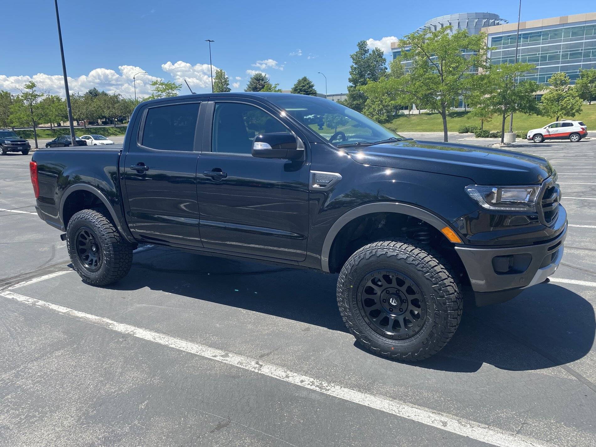

I think I posted in this thread. I went ahead and got the wheels and tires. Turned out exactly as I wanted and it barely clears the Intrusion Beams. I plan on replacing them because it’s a lil to close and runs if I punch it in reverse.
Wheels: Fuel Vector D579 17x8.5” 7mm offset
Tires: Falken WildPeak A/T3W 265/70R17

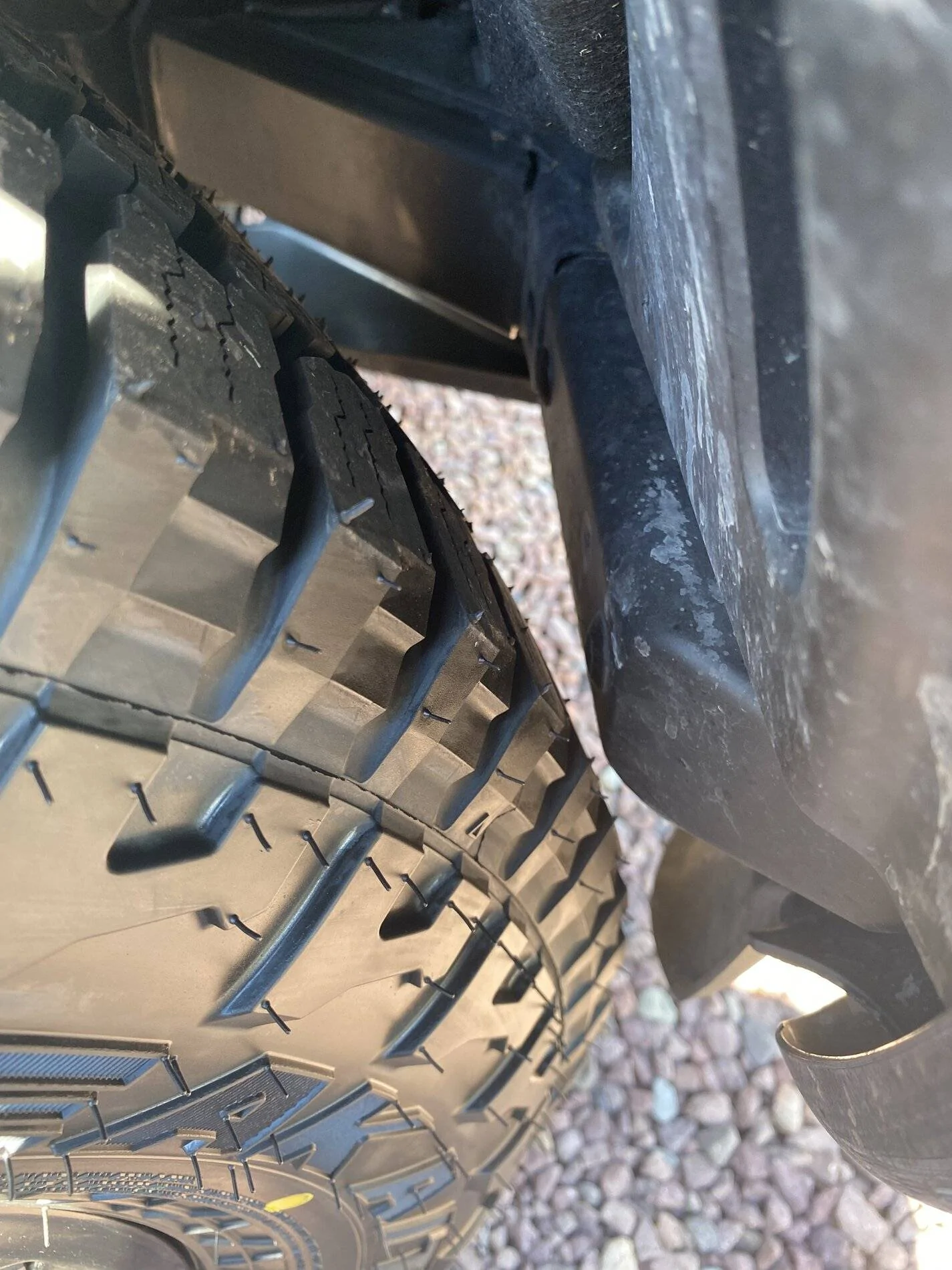

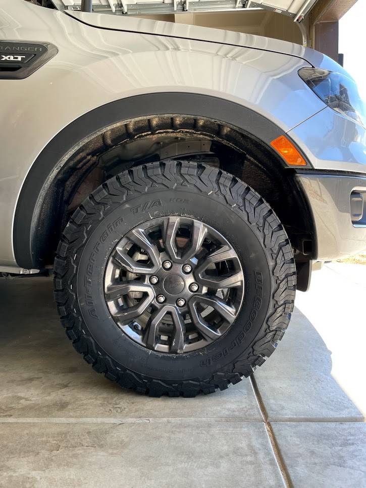

I can confirm that the 285/70r17 BFG AT KO2 will fit on a stock FX4. No lift/level, no spacers.
I have an ever so slight run on the front intrusion bar when cranked over and in reverse. I think this can be solved by adjusting the intrusion bars forward.
