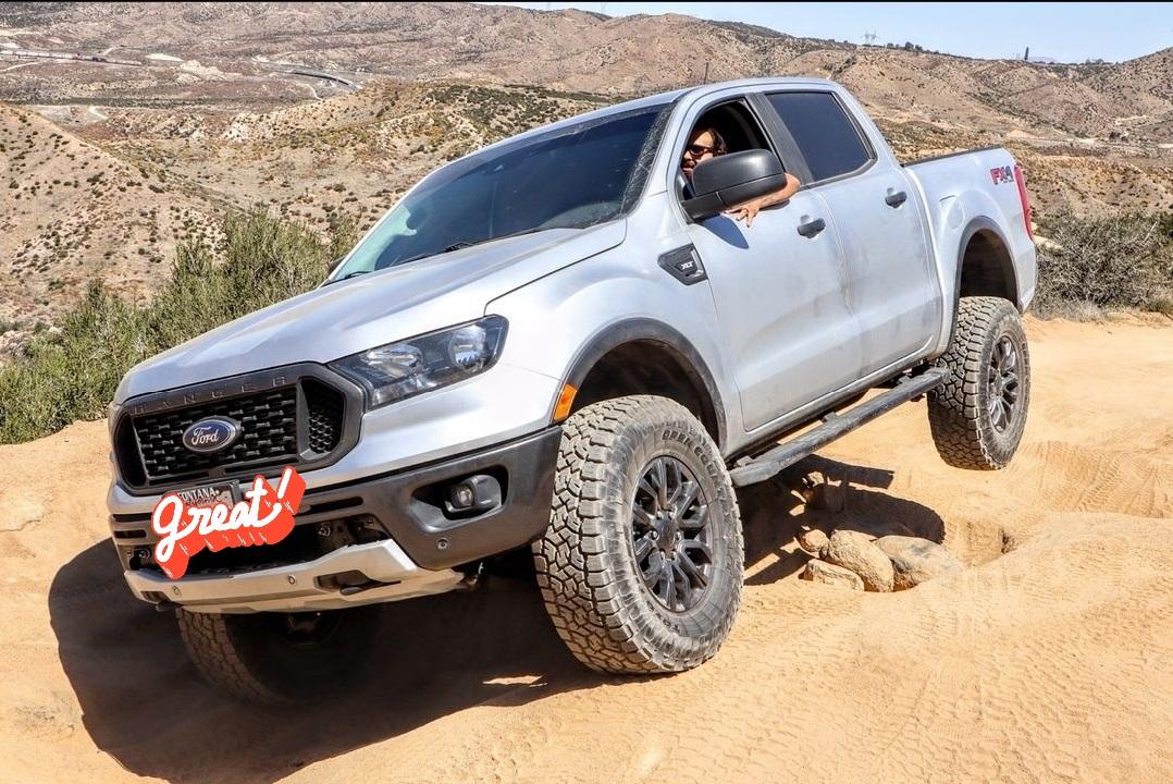

2020FX4
El Jefe
Jan 11, 2020
593
Los Angeles
2020 FX4 Ranger
Another confirmed fit! 2021 Lariat FX4 with 265/70/18 Nitto Ridge Grapplers. Nice smooth ride and no rubbing. 2" Ford Performance / Fox Racing level kit.
Note, Ford Performance was not able to confirm that the current leveling kit works with 2021 Ranger. I checked with Fox and took my chances. No surprise, it fits.
Looks Great!
...and no spacers ???

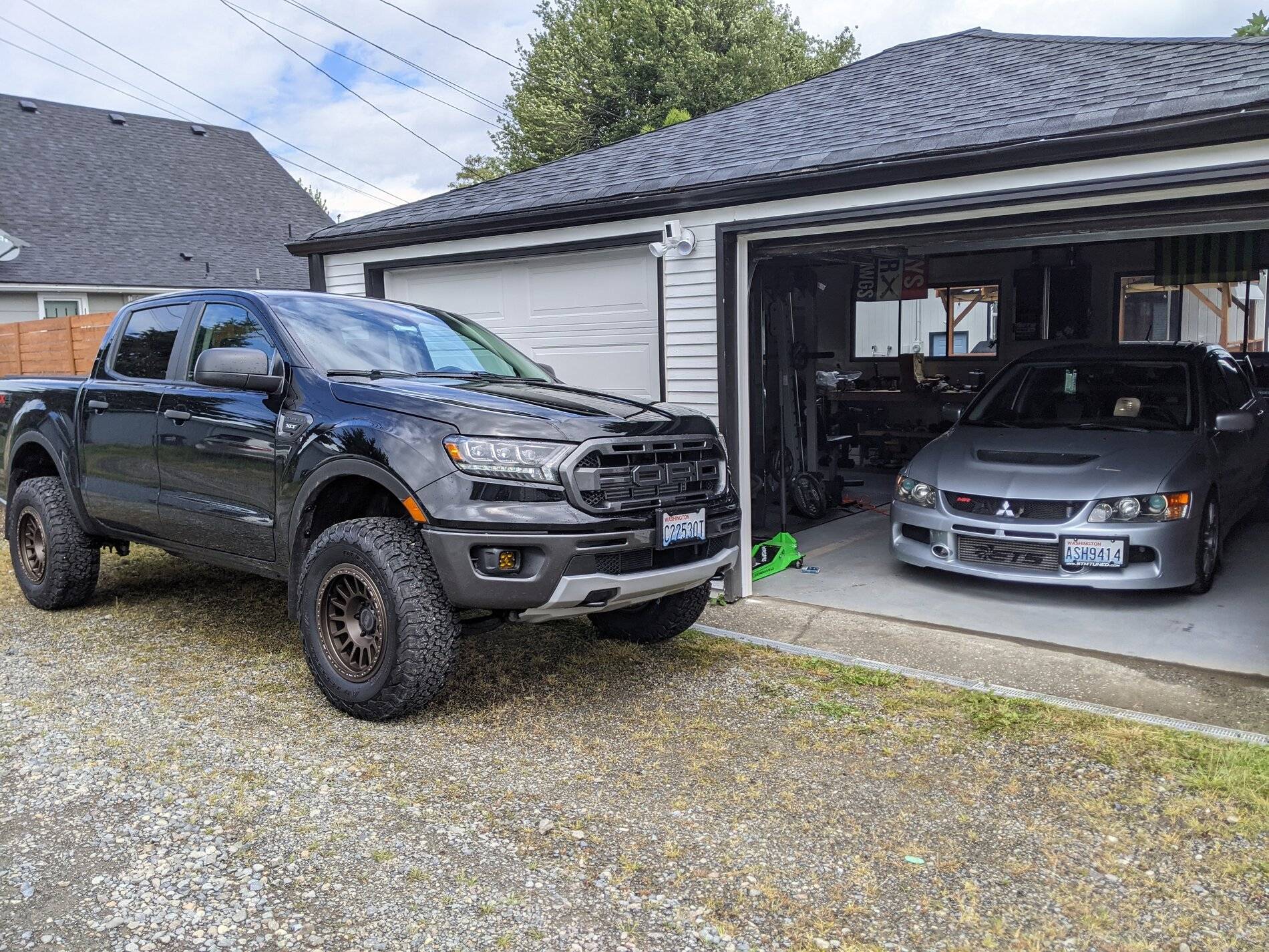

2019 Ford Ranger Supercrew 4X2 5' Box Lariat
I went with 265/70/17

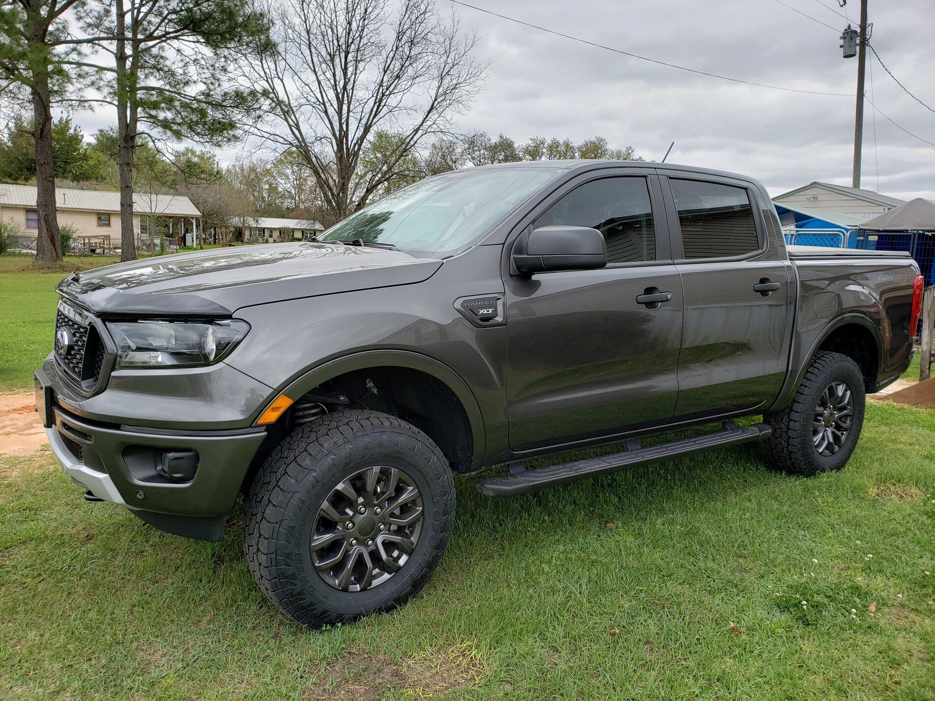

Venom_z89
Edson
Apr 16, 2021
512
1,827
So Cal
2019 Ford Ranger fx4
Forklift technician
I can fully confirm no rubbing with my settings.

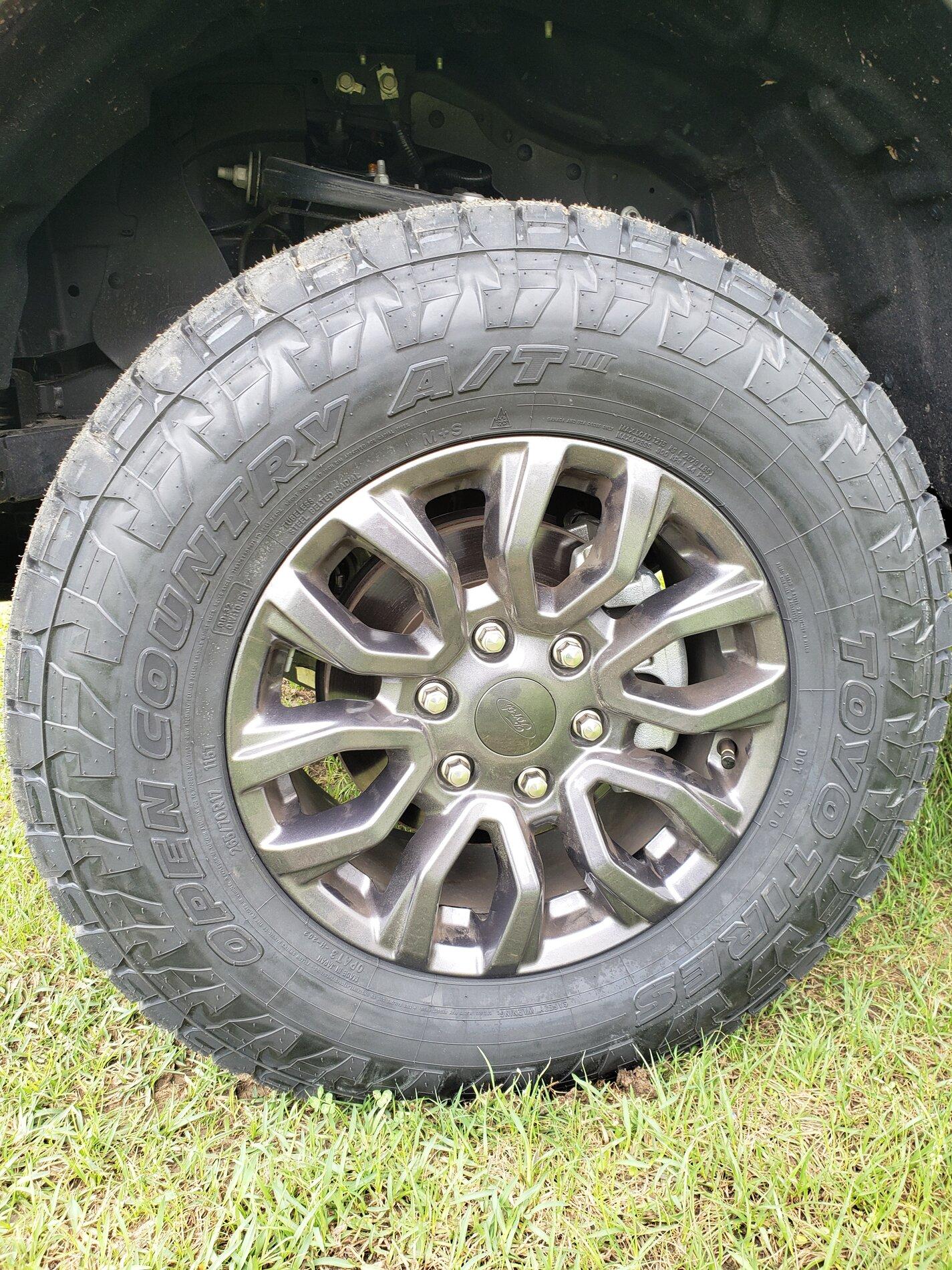

DigiSnapMark
Jan 4, 2021
Fort Collins, CO

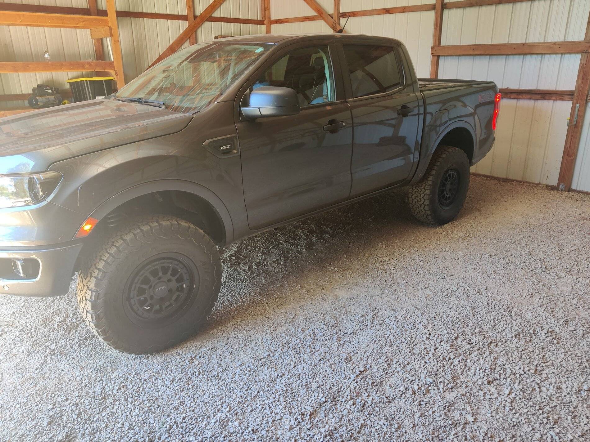

2021 Ranger XLT
Fits fine, no having to move anything.
33" Toyo OC AT3 (255/80R17)

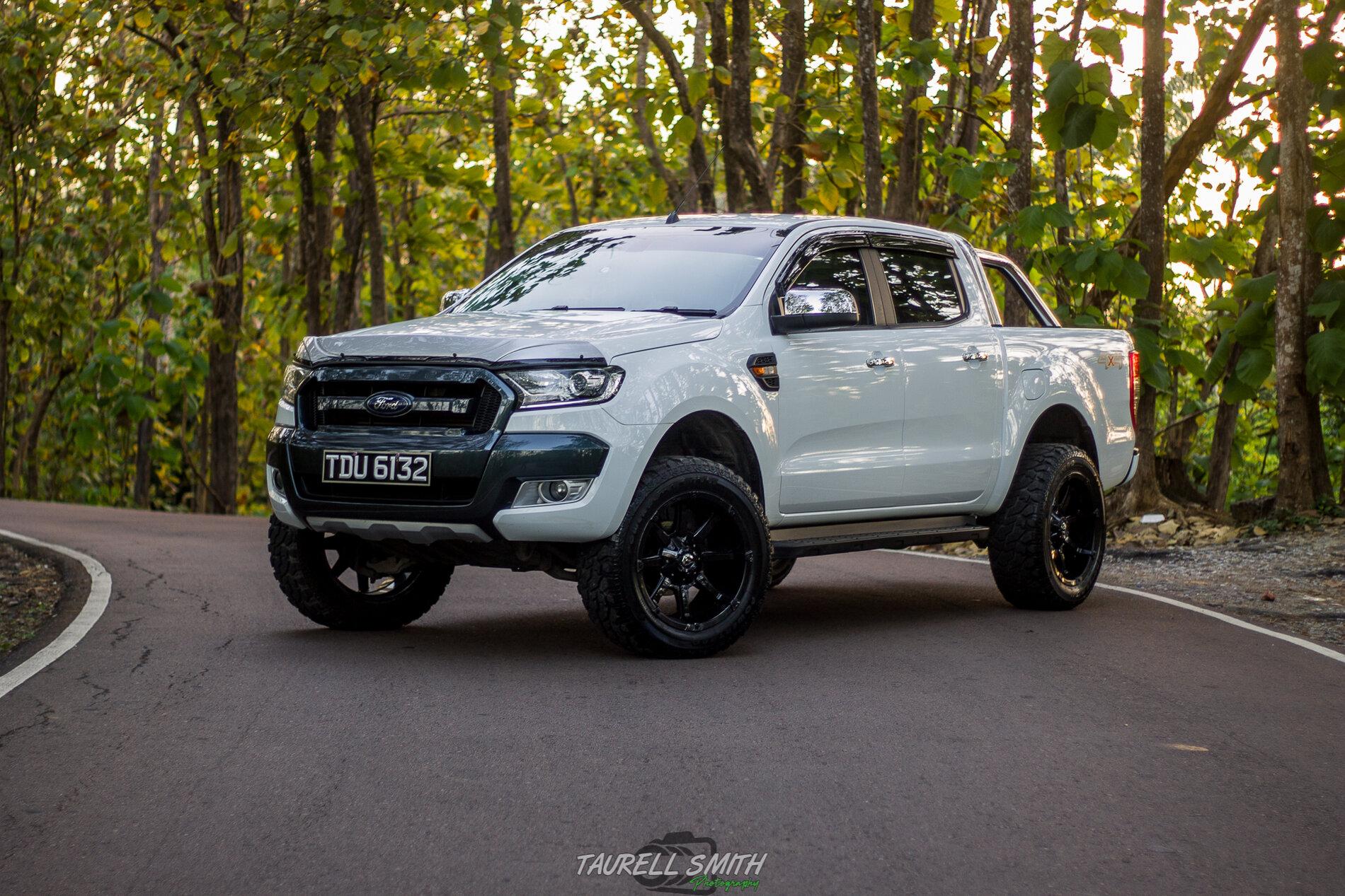

Boosted868
Rene
Apr 22, 2021
Trinidad and Tobago
2018 Ford Ranger T7 South Africa
2018 ford ranger xlt
20x12 Fuel Coupler wheels with 33x12.5 powertrac power rover m/t tires
2"front leveling kit installed, light rubbing on mud guards on full lock
avg 5mm taken off from the bottom of the front bumper
ive been reading this thread a while now glad i can finally add to it

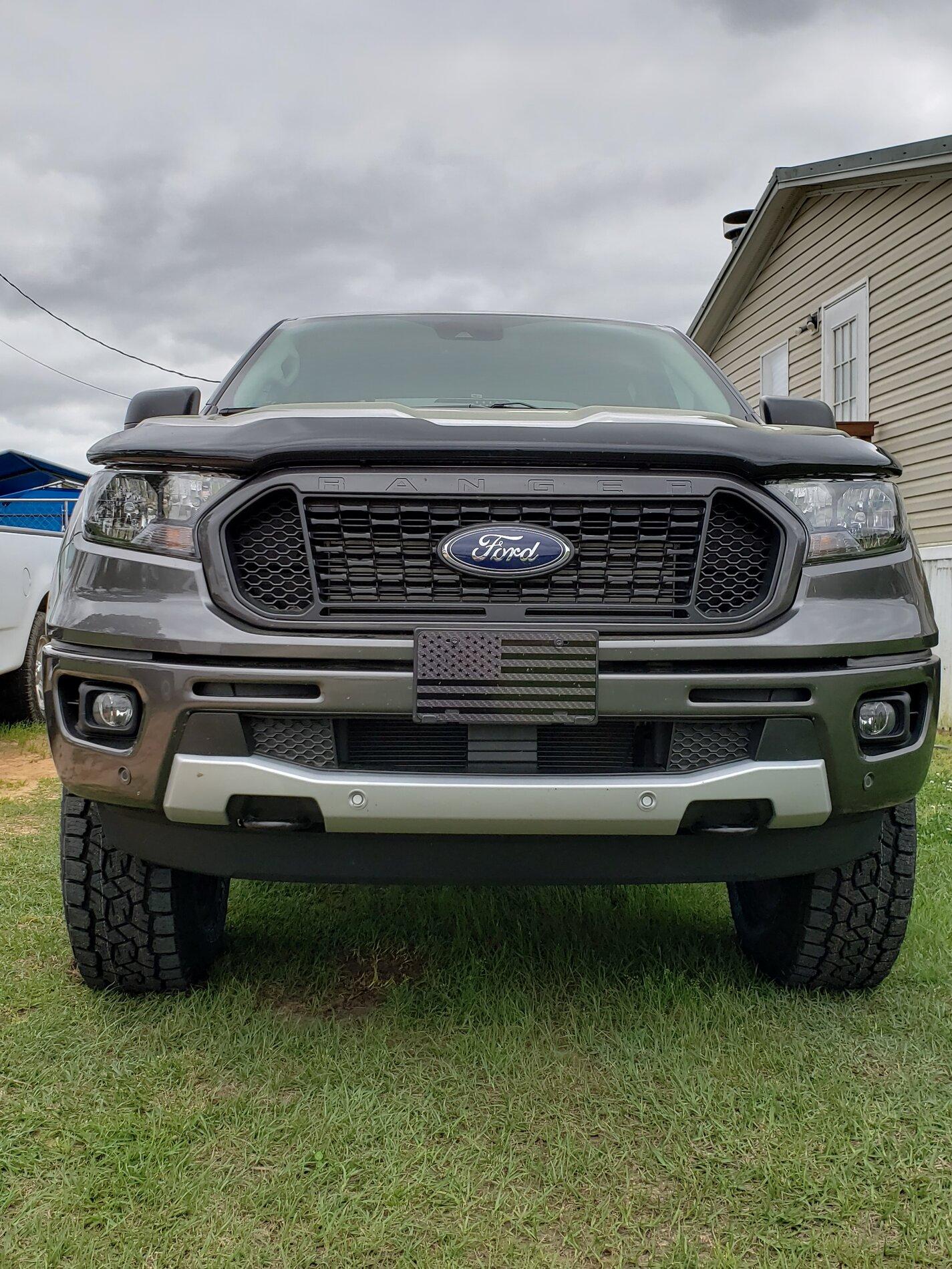

Joyride
Stacey
Apr 22, 2021
338
854
San Diego, CA
21 Ford Ranger Lariat FX4
Proposal Manager, US Navy vet, 2A Supporter
I had a set of Goodyear Wrangler Ultraterrain A/T's in LT275/65R18 installed at Discount Tire today and they do indeed fit. There are also at least one or two other members that have confirmed fitment of the 275/65R18 size here. They fit tight to the knuckle but they seem to be safely do-able. I am also running at Daystar 2 inch front leveling kit. Other than that the truck is all stock, no spacers.
This is similar to what I want to do. You have a front and side picture? Wondering if spacers would be needed or if this setup on the front doesn't look "sucked in".
