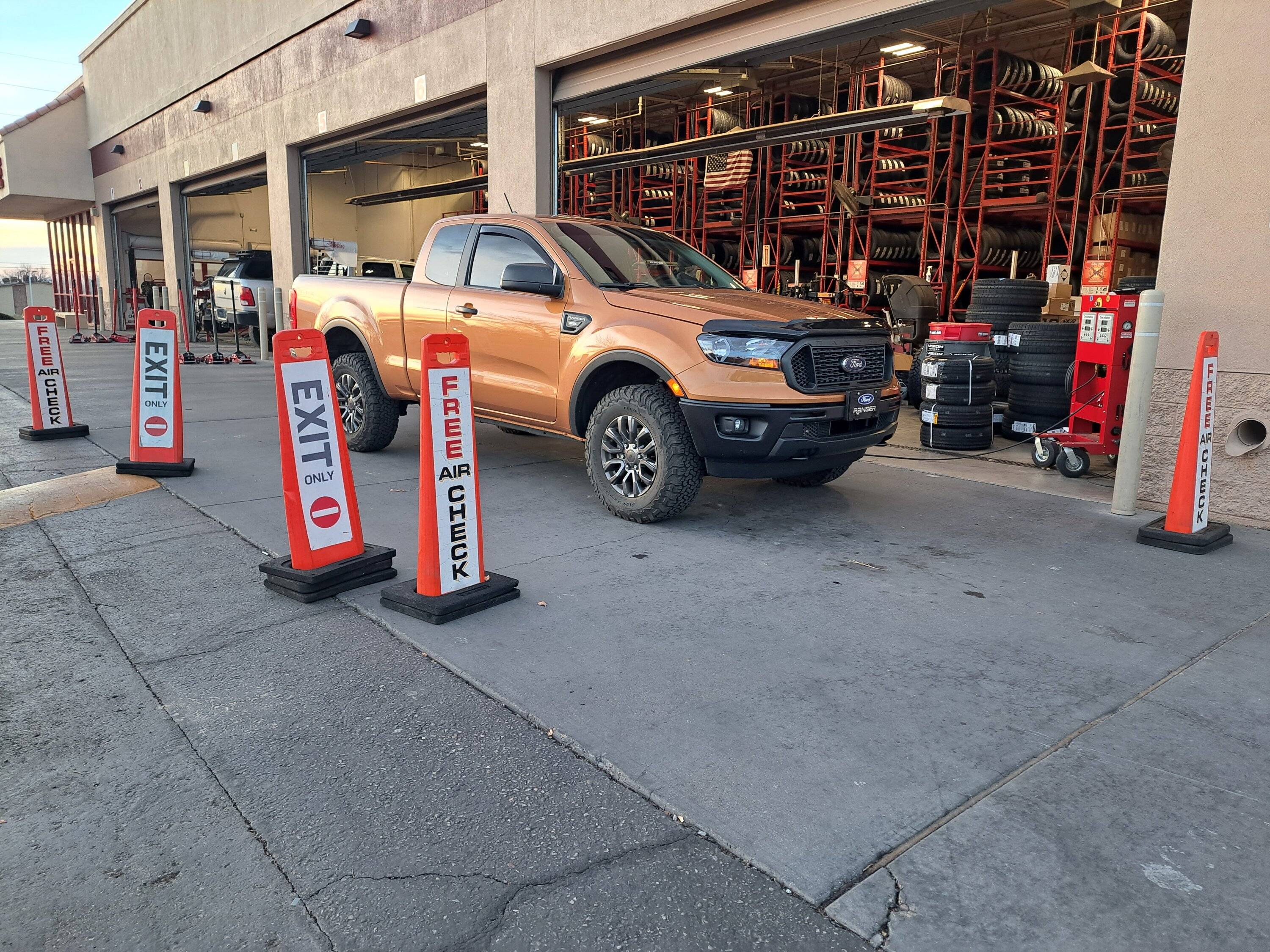

My truck came originally with Bridgestone Dueler 255/65/R17's and the door sticker recommended 30psi cold. I experimented and found 32-33psi cold gave the best ride. I upgraded to Ford OEM charcoals with BFG K02's 265/70/17's. I called BFG corporate, and they ran a calculation factoring in the weight of the Ranger with the K02's and they recommended 35psi cold. Experimented and found that 36psi cold gives the ideal ride. Have the tire pressures checked monthly at Discount...
