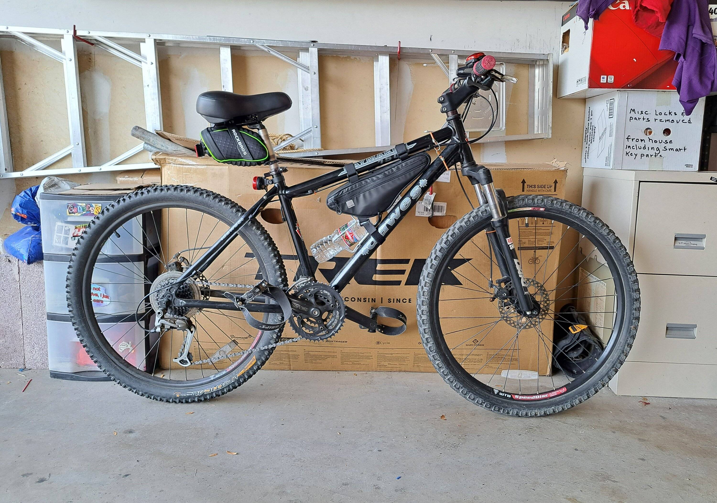

My bike shop recommended 50psi (the rating on the tires is 35-60psi) Like you say some bike tires are rated even higher than that. Run more in them than In the KO2's on the Ranger!
