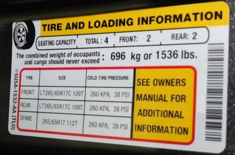

This literally just happened to me this morning. I took it in for its 10,000 mile service (only had 8200, but had 1 year on the clock), and when they gave me back the truck, I noticed that the tires looked taller. Sure enough, I checked the pressure and it was 40 lbs. This was in Pompano Beach FL. There must be something going on that we don't know about and are not being told. How could all these different dealerships, put in the same air pressure when servicing these trucks, regardless of what the door sticker recommendation says? I'm gonna try calling the dealership and ask this question. I'm also gonna leave it at 40 lbs for now. When I took delivery - from a different dealership, not the one that just did the service - the TP was set at 40 then too.
What tires are you running? If they put 40 psi in mine the'd only be off by 2 psi..
Definitely let us know if you get an answer on this. I just had my oil changed this morning per the maintenance plan and got mine back at 38psi when the door tag is 30psi. Interesting thing for me is when I took delivery they actually had the tires at 30psi. My dad has a 2019 F150 and said they always air his tires at 38psi also so apparently 38 is the magic number at my dealership.
