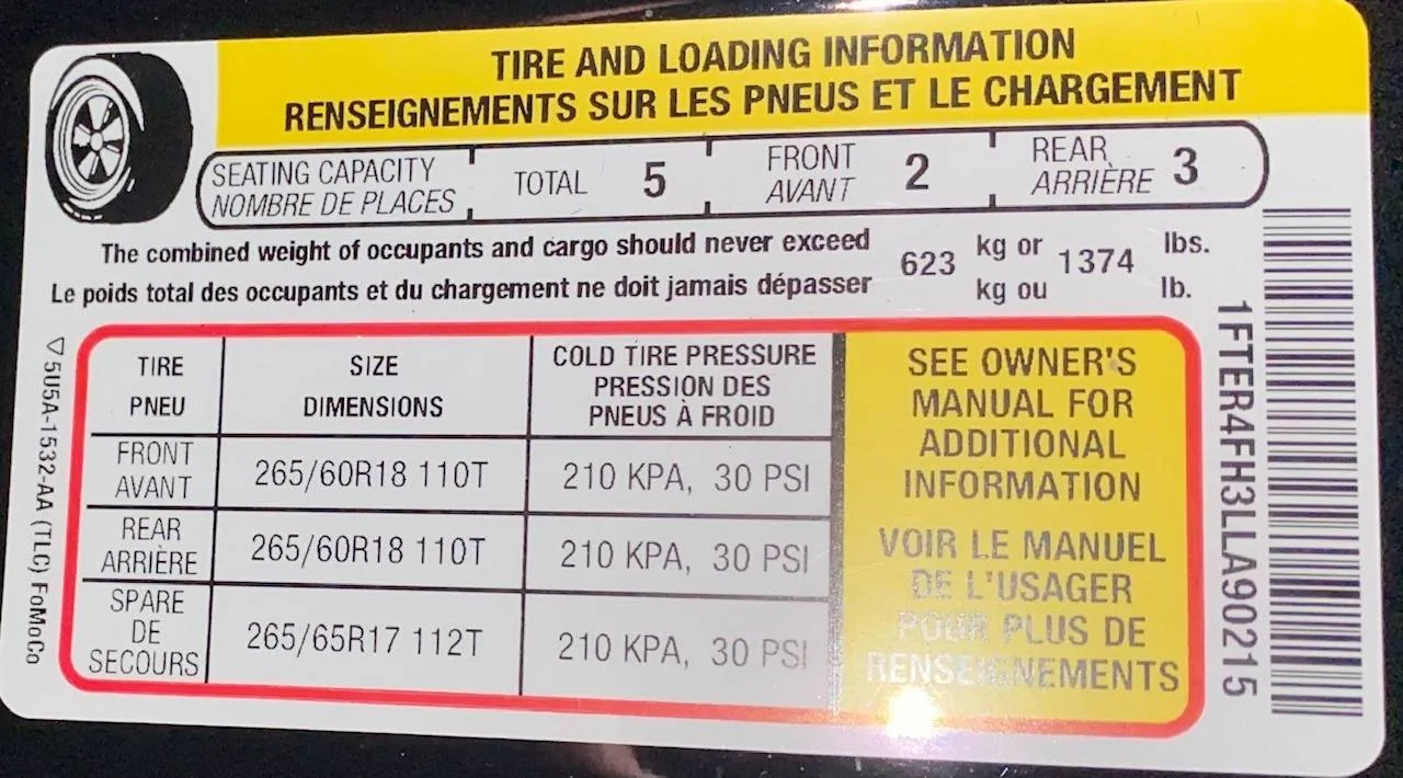

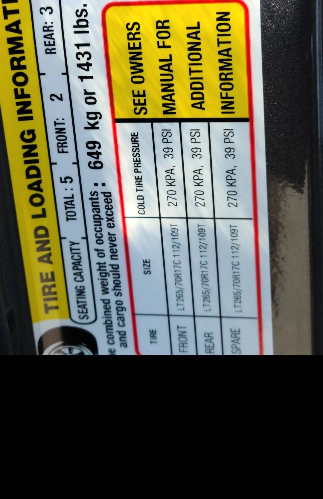

I know many people will know this, but I haven't seen it mentioned lately. When looking at tire pressures for tires other than stock size you need to look at the new size and remember how the sizing works. The first number in the size is normally the width in mm (or cross section of the tire), the second is the height of the sidewall as a percentage of the width. This does not apply to tires listed by diameter and width. So if you go to a wider tire, regardless of sidewall height, you have a larger contact patch with the road (more square inches). This can lead to a lower pressure to carry the same load. Yes LT rated tires tend to call for higher pressures than P rated tires, this is because they are intended for higher loads. As has been said the door sticker only applies to the tire that came with the truck as specified on the sticker. Even then it is a starting point, and based on your usage may need to be adjusted to achieve even wear. Seems like the best way to answer this is to get the axle weights for your truck and go to the manufacturers tables for the tire and size your running and see what they recommend. anything else is trial and error.

I’m running the stock Bridgestone H/T’s in 18”. Door sticker says run 35psi and I’ve done so, I’ve also rotated them every 5k and had them re-balance 3 times.
All four are worn thinner in the center and are now right at the wear bar. I have one tire that is past the wear bar in the center. Coming up on 27K miles.
At 25K I rotated and dropped the psi to 32, rides much better. Two tires have plugs in them too.
I will be getting new tires before winter but probably should replace them now. I would if I were traveling but it’s mostly city driving. I’ll most likely replace them with Michelin’s or similar. I’m 95% on road use.

My factory tires are Hankooks 265/65-18. As noted by others, the door sticker is only relevant to the factory built tires.
Also as noted, recommended PSI is relevant to the load. If you buy a factory built cab/chassis vs a fully built truck on the exact same rim/tire combo, the door sticker will have different PSI listed for both.
My truck is now on LT 285/70-17, the sidewall lists 3195Lbs max load at 65 psi. That's about 2.5x the actual load on my truck, so I run them @ 38psi.
I weighed my truck at a Cat Scale. Full tank of fuel (108 LBS) Nothing else.
Front. 2,629
Rear. 2,000
Total. 4,620 LBS
- the 108 LBS for fuel = 4,512 LBS
That said, I have the Hankook 265/60-18's and keep my pressure at 40 LBS.
Had it at the sticker pressure of 32, and was good, BUT. I use it as a 4 wheel tow vehicle at times.
I usually get 8 MPG with the E450 Class C motorhome when I pulled my Jeep Wrangler (weight was similar) . When I pulled the Ranger, I got 6 MPG. I raised it up to 45 LBS and got back my 8 MPG. Tire is rated for 51 LBS cold pressure so I'm good. Tire is not wearing abnormally and will probably up my MPG too.
I went to a conference a few years back and there was a tech guy from Michelin that told us that the tire and auto companies come up with the tire pressures partially based on ride comfort, so if you was longer tire life go up with the pressures, as long as you don't go higher than the Max tire pressure at cold your OK (as far as tire safety is concerned) . If you want mostly comfort go with the door sticker.
