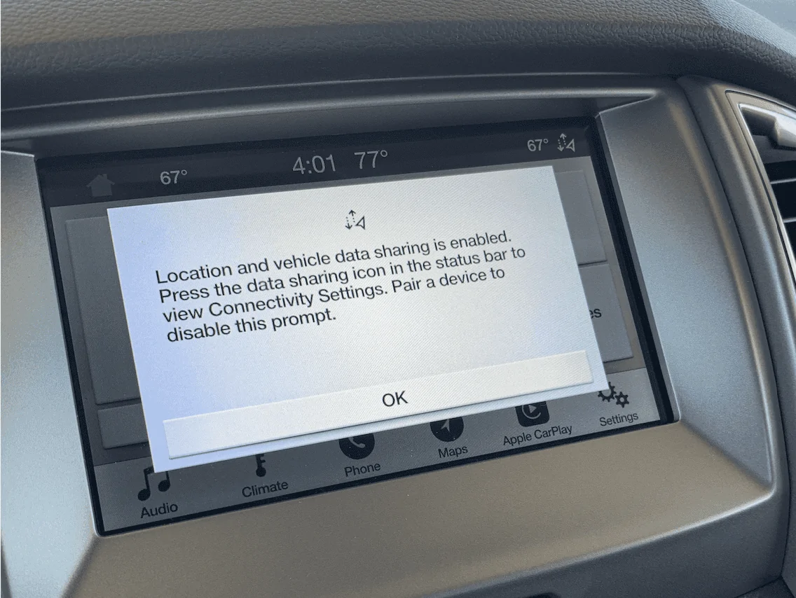

I'm all updated, however I am still getting that annoying pop up "Location and Vehicle data sharing..." Has anyone figured out how to make this go away? @UofMEngineer any tips? haha!
I believe that's supposed to be shown one time per paired device connection. So, if you have your phone paired, it should show it to you once, then not again unless there's no device connected, or a new device is paired that hasn't accepted yet. Do you have a phone paired?
Yup, IphoneXs paired via bluetooth. I connect my phone when I get in the car via USB to use CarPlay and typically about a minute in the message pops up almost every time. Not sure if it's just me or a common issue.

Im not sure if its just you, but the only time I get it is if i dont have my phone with me and it doesn't detect a device.
What about if you don't plug in for CarPlay? Might be a glitch like the other pop-up causing it to come up too often. I haven't run v3.3 in a while though to poke around.

I have the iphone XR and this is not happening to me. Have you tried unpairing / removing your phone and then start over and pair again?

I’ve been updated too. I still get that message. I use car play. If I pair my phone, it uses Bluetooth and won’t start car play. So I unpaired my phone and just use car play. If i could set it so CarPlay took precedence over blue tooth, then I would not see that message anymore. Unfortunately, Ford has set it up so Bluetooth devices will connect and stop,CarPlay from working.

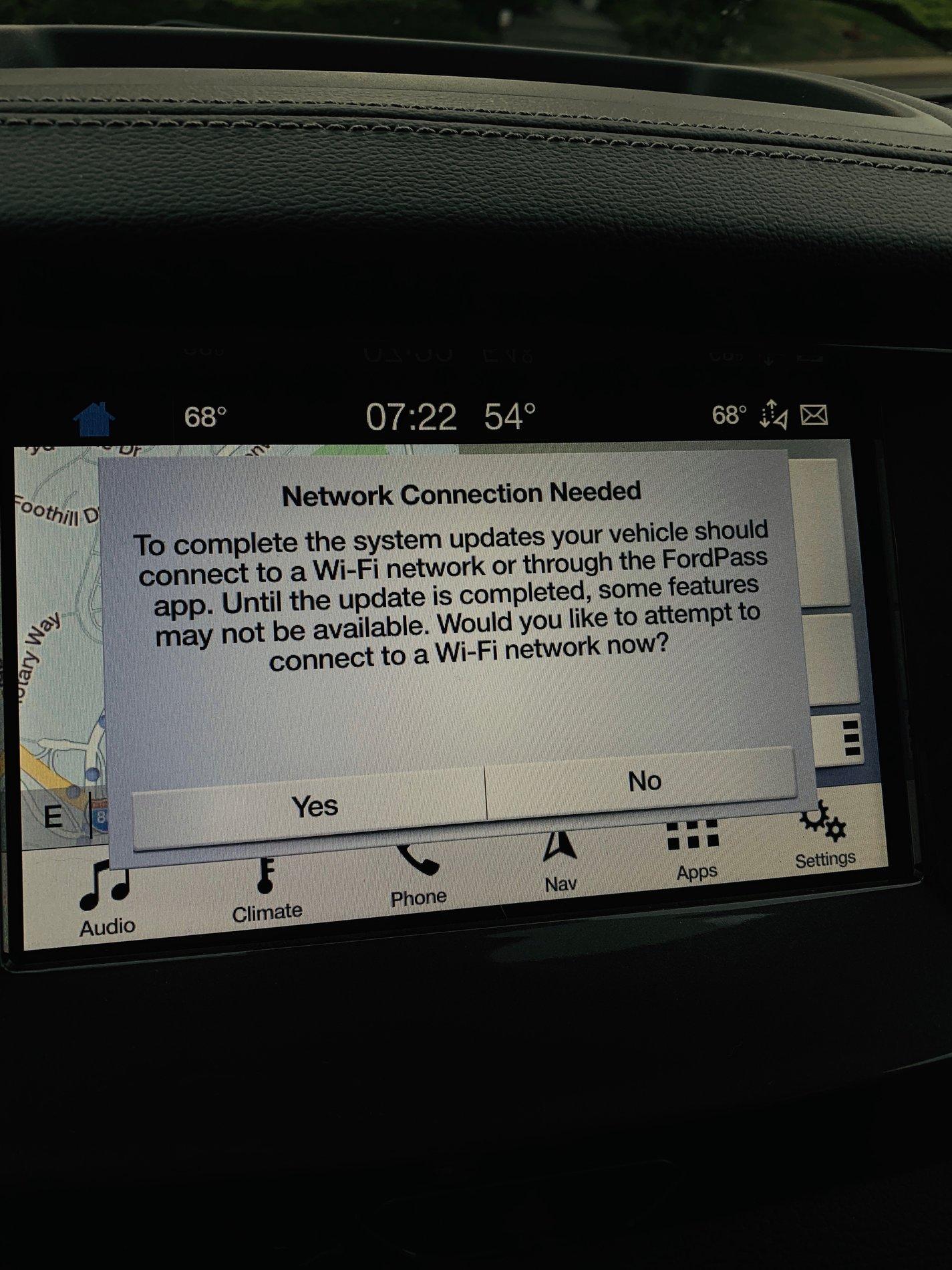

How do I get Sync to update properly? I've been getting this message for a week now every time I get in the car. The system is connected to my HOME wifi.. I've tried to disconnect and re-connect but it doesn't seem to update.
Does the car need to be turned on and at a specific screen? I've also tried going to the "Automatic Updates" page and clicking "Scan for Updates" but it doesn't seem to do anything.
I too have this problem and it drives me nuts. Thanks for posting this.
I updated using the download onto USB from the Ford Owner site. I turned off the Automatic Updates and I haven't turned it back on to see if I still get the message after the update.
Add another person to the list of people having this annoying issue. Thinking of just master resetting my Sync system. I'm already on the newest update.

I did the master reset now I have 2 screens I have to close while driving down the road.
