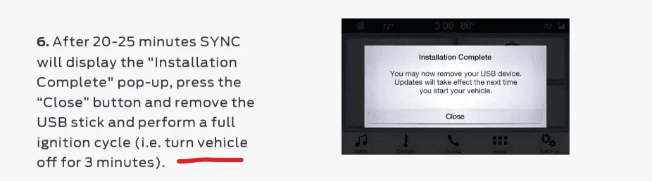

Phil, recheck before restarting. The instructions state to turn off for several minutes for it to finish. I shut the truck off then restarted right away and it did not show the update. I left it overnight and on restart the next day it showed the update, without doing it a second time.

I successfully did the 19052 update tonight using the USB method (could not get it to work over WiFi). Note - that after the USB install said "completed" and the truck was turned off and started again about 10 seconds later - the version number did not change to 19052. I went back to the truck and started it up about 20 minutes later and it appeared to complete the install and bingo...at 19052!
Did this last night and had the same experience. Shut it off for less than a minute and it was the old firmware. Then I let it sit off for ~3mins and when I booted it back up I got an update complete.
If you do a quick off/on, it'll be a warm boot so the new data won't take. That's why they have you wait ~3 minutes to give everything time to fully shut down. Just FYI.

Just got around to checking my USB update today and much to my surprise and delight, I am at 19052 today...no need to redo the update process!

I tried using the auto update with the truck in my garage connected to my wifi and all I got was a looking for update spinning thing for a while so I downloaded the update to a USB drive.
I then plugged the USB in with the truck running and it said it's updating.
I watched this video and at 1:18 seconds it said the truck can be turned off and it still will update. I tried that and a half hour later I started the truck and in a couple of minutes the download complete window came up. I removed the USB and checked the update number and it updated to 19052.
Did I get lucky? I don't know but it did update. I'm not good at this tech stuff.
