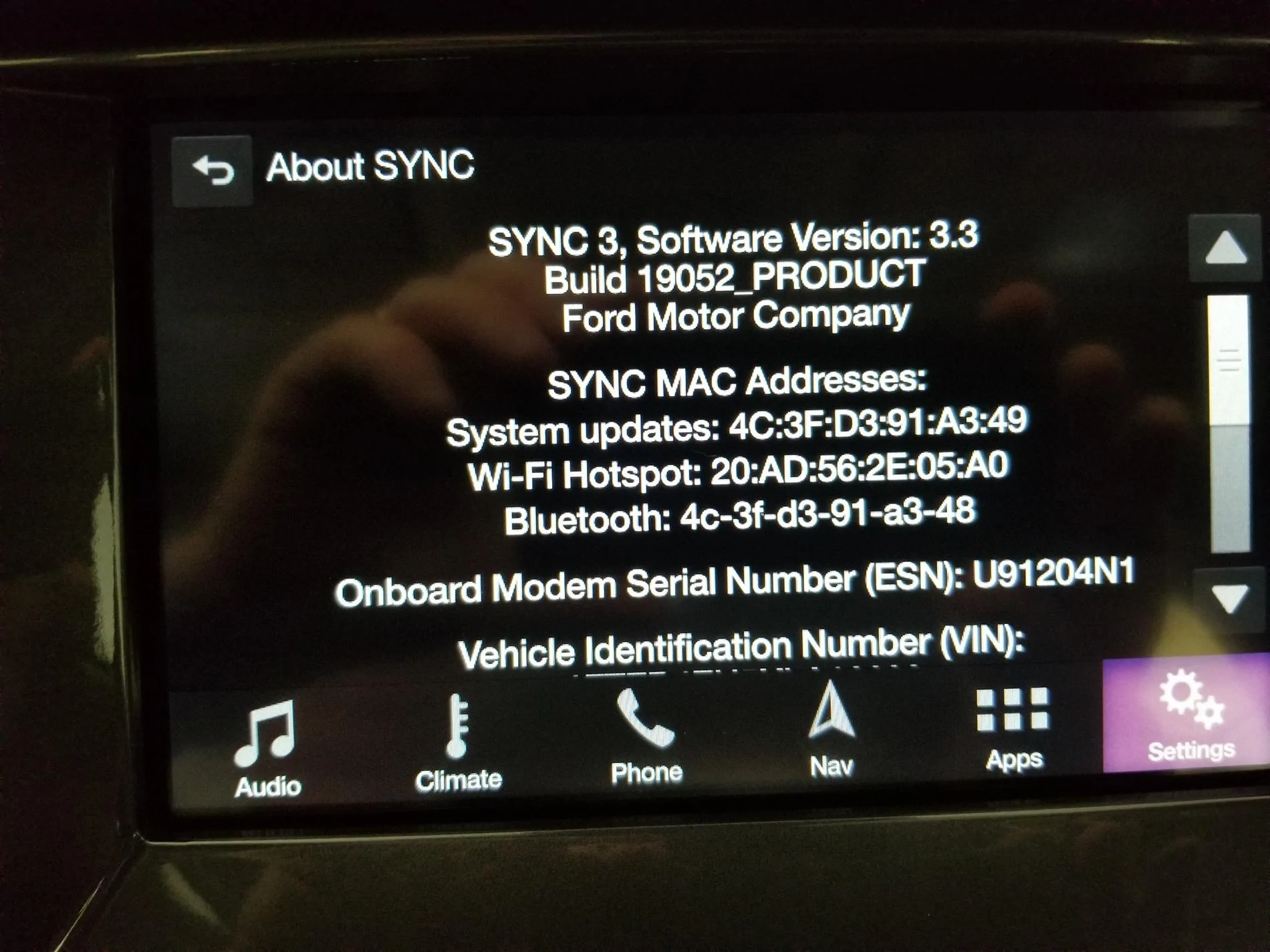

I tried using the auto update with the truck in my garage connected to my wifi and all I got was a looking for update spinning thing for a while so I downloaded the update to a USB drive.
I then plugged the USB in with the truck running and it said it's updating.
I watched this video and at 1:18 seconds it said the truck can be turned off and it still will update. I tried that and a half hour later I started the truck and in a couple of minutes the download complete window came up. I removed the USB and checked the update number and it updated to 19052.
Did I get lucky? I don't know but it did update. I'm not good at this tech stuff.
